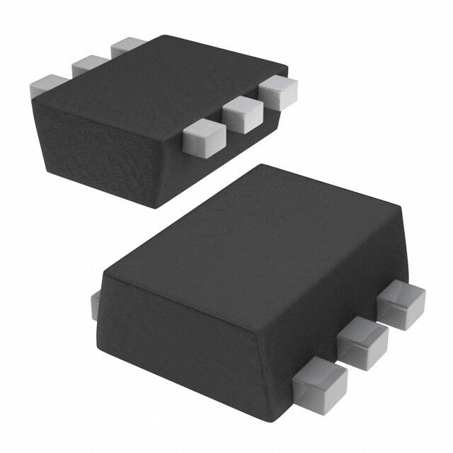

Ordering number : EN8345B SS2003M Schottky Barrier Diode http://onsemi.com 30V, 2.0A, Low VF, Single MCPH6 Applications • • High frequency rectification (switching regulators, converters, choppers) Halogen free compliance Features • • • Small Switching noise Low forward voltage (IF=2A, VF max=0.40V) Small package permitting applied sets to be small and slim Specifications Absolute Maximum Ratings at Ta=25°C Parameter Symbol Repetitive Peak Reverse Voltage Conditions Ratings Unit VRRM VRSM 30 30 V 2.0 A Surge Forward Current IO IFSM 10 A Junction Temperature Tj --55 to +125 °C Storage Temperature Tstg --55 to +125 °C Nonrepetitive Peak Reverse Surge Voltage Average Output Current 50Hz sine wave, 1 cycle V Stresses exceeding Maximum Ratings may damage the device. Maximum Ratings are stress ratings only. Functional operation above the Recommended Operating Conditions is not implied. Extended exposure to stresses above the Recommended Operating Conditions may affect device reliability. Ordering & Package Information Package Dimensions unit : mm (typ) 7022A-014 Device Package SS2003M-TL-W 6 5 Packing Type : TL 4 0.25 0.3 0.85 0.07 TL 3 0.65 SF LOT No. 2 3,000 pcs./reel Marking LOT No. 0 to 0.02 1 memo Pb-Free and Halogen Free SS2003M-TL-W 0.15 2.1 1.6 0.25 2.0 MCPH6 SC-88, SC-70-6, SOT-363 Shipping 1 2 3 1 : Cathode 2 : Cathode 3 : Anode 4 : No Contact 5 : Cathode 6 : Cathode 6 5 4 MCPH6 Semiconductor Components Industries, LLC, 2013 May, 2013 Electrical Connection 6 5 4 1 2 3 52913 TKIM TC-00002896/O0312 TKIM/62005SB MSIM TB-00001370 No.8345-1/5 SS2003M Electrical Characteristics at Ta=25°C Parameter Symbol Reverse Voltage VR Forward Voltage VF Reverse Current Interterminal Capacitance IR C Reverse Recovery Time trr IR=2.0mA IF=1.0A IF=2.0A VR=15V VR=10V, f=1MHz IF=IR=100mA, See specified Test Circuit. When mounted in Cu-foiled area of Rth(j-a)1 Thermal Resistance Conditions 1.44mm2×0.03mm on glass epoxy substrate When mounted on ceramic substrate (500mm2×0.8mm) Rth(j-a)2 Ratings min typ max 30 Unit V 0.30 0.35 0.35 0.40 V 1.25 mA 75 V pF 20 ns 93.4 °C / W 71.4 °C / W trr Test Cicuit 50Ω 100Ω 10μs 10Ω 10mA 100mA 100mA Duty≤10% --5V trr No.8345-2/5 SS2003M IF -- VF 12 10 5°C 0° C 75 °C 50 °C 25° C 1.0 7 5 °C --25 0.1 7 5 3 2 0.01 0 0.05 0.10 0.15 0.20 0.25 0.30 0.35 0.40 0.45 (2)(4)(3) θ 360° Sine wave 0.6 180° 360° 0.4 (1)Rectangular wave θ=60° (2)Rectangular wave θ=120° (3)Rectangular wave θ=180° (4)Sine wave θ=180° 0.2 0 0 50°C 25°C --25°C 0 10 5 15 20 25 30 Reverse Voltage, VR -- V 35 IT08574 C -- VR 5 (1) 1.0 0.8 75°C 7 0.5 1.0 1.5 2.0 Average Forward Current, IO -- A 2.5 IT08575 IFSM -- t 14 Surge Forward Current, IFSM(Peak) -- A 0.50 PF(AV) -- IO Rectangular wave 100°C IT08573 Interterminal Capacitance, C -- pF Average Forward Power Dissipation, PF(AV) -- W Forward Voltage, VF -- V 1.2 °C Ta=125 Reverse Current, IR -- mA 3 2 3 2 IR -- VR 100 7 5 3 2 10 7 5 3 2 1.0 7 5 3 2 0.1 7 5 3 2 0.01 7 5 3 2 0.001 7 5 3 2 0.0001 Ta = Forward Current, IF -- A 10 7 5 3 2 100 7 5 3 2 0.1 2 3 5 7 1.0 2 3 5 7 10 Reverse Voltage, VR -- V 2 3 5 IT08576 Current waveform 50Hz sine wave 12 IS 20ms t 10 8 6 4 2 0 7 0.01 2 3 5 7 0.1 2 Time, t -- s 3 5 7 1.0 2 3 ID00435 No.8345-3/5 SS2003M Outline Drawing SS2003M-TL-W Land Pattern Example Mass (g) Unit 0.008 mm * For reference Unit: mm 2.1 0.6 0.4 0.65 0.65 No.8345-4/5 SS2003M ON Semiconductor and the ON logo are registered trademarks of Semiconductor Components Industries, LLC (SCILLC). SCILLC owns the rights to a number of patents, trademarks, copyrights, trade secrets, and other intellectual property. A listing of SCILLC’s product/patent coverage may be accessed at www.onsemi.com/site/pdf/Patent-Marking.pdf. SCILLC reserves the right to make changes without further notice to any products herein. SCILLC makes no warranty, representation or guarantee regarding the suitability of its products for any particular purpose, nor does SCILLC assume any liability arising out of the application or use of any product or circuit, and specifically disclaims any and all liability, including without limitation special, consequential or incidental damages. “Typical” parameters which may be provided in SCILLC data sheets and/or specifications can and do vary in different applications and actual performance may vary over time. All operating parameters, including “Typicals” must be validated for each customer application by customer’s technical experts. SCILLC does not convey any license under its patent rights nor the rights of others. SCILLC products are not designed, intended, or authorized for use as components in systems intended for surgical implant into the body, or other applications intended to support or sustain life, or for any other application in which the failure of the SCILLC product could create a situation where personal injury or death may occur. Should Buyer purchase or use SCILLC products for any such unintended or unauthorized application, Buyer shall indemnify and hold SCILLC and its officers, employees, subsidiaries, affiliates, and distributors harmless against all claims, costs, damages, and expenses, and reasonable attorney fees arising out of, directly or indirectly, any claim of personal injury or death associated with such unintended or unauthorized use, even if such claim alleges that SCILLC was negligent regarding the design or manufacture of the part. SCILLC is an Equal Opportunity/Affirmative Action Employer. This literature is subject to all applicable copyright laws and is not for resale in any manner. PS No.8345-5/5
