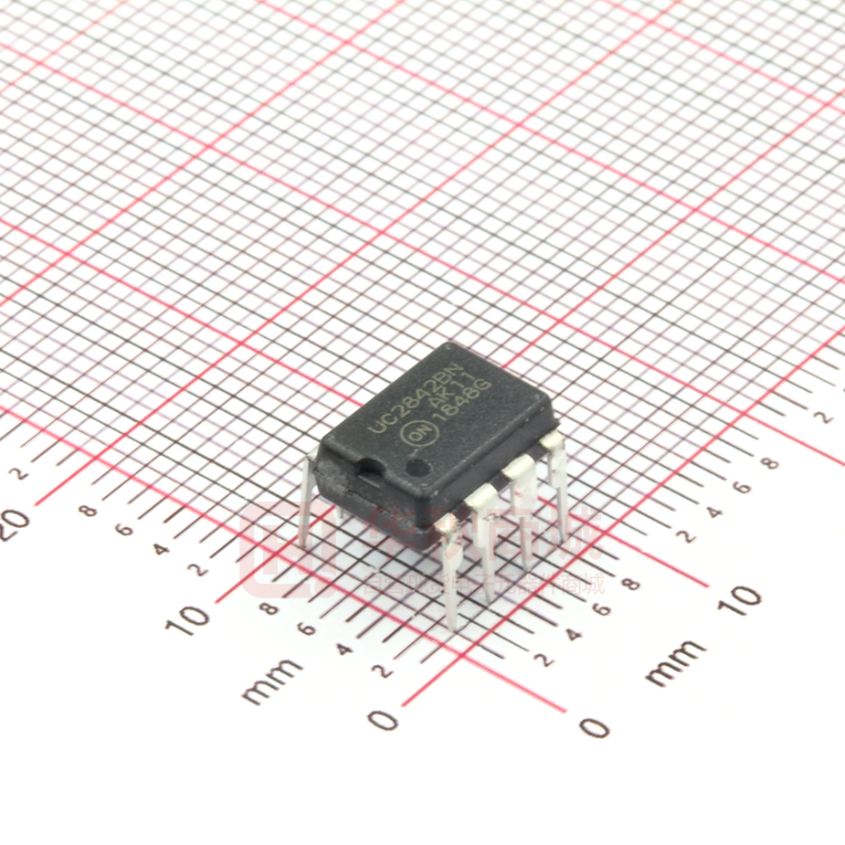

DATA SHEET www.onsemi.com High Performance Current Mode Controllers PDIP−8 N SUFFIX CASE 626 8 UC3842B, UC3843B, UC2842B, UC2843B 1 The UC3842B, UC3843B series are high performance fixed frequency current mode controllers. They are specifically designed for Off−Line and DC−DC converter applications offering the designer a cost−effective solution with minimal external components. These integrated circuits feature a trimmed oscillator for precise duty cycle control, a temperature compensated reference, high gain error amplifier, current sensing comparator, and a high current totem pole output ideally suited for driving a power MOSFET. Also included are protective features consisting of input and reference undervoltage lockouts each with hysteresis, cycle−by−cycle current limiting, programmable output deadtime, and a latch for single pulse metering. These devices are available in an 8−pin dual−in−line and surface mount (SOIC−8) plastic package as well as the 14−pin plastic surface mount (SOIC−14). The SOIC−14 package has separate power and ground pins for the totem pole output stage. The UCX842B has UVLO thresholds of 16 V (on) and 10 V (off), ideally suited for off−line converters. The UCX843B is tailored for lower voltage applications having UVLO thresholds of 8.5 V (on) and 7.6 V (off). Features • • • • • • • • • • Trimmed Oscillator for Precise Frequency Control Oscillator Frequency Guaranteed at 250 kHz Current Mode Operation to 500 kHz Automatic Feed Forward Compensation Latching PWM for Cycle−By−Cycle Current Limiting Internally Trimmed Reference with Undervoltage Lockout High Current Totem Pole Output Undervoltage Lockout with Hysteresis Low Startup and Operating Current This is a Pb−Free and Halide−Free Device VCC Vref 5.0V Reference 8(14) R RT/CT 4(7) Voltage Feedback Input 2(3) Output Compensation 1(1) 1 SOIC−8 D1 SUFFIX CASE 751 8 1 PIN CONNECTIONS Compensation Voltage Feedback Current Sense RT/CT 1 8 2 7 3 6 4 5 Vref VCC Output GND (Top View) Compensation NC Voltage Feedback NC Current Sense NC RT/CT 1 14 2 13 3 12 4 11 5 10 6 9 7 8 Vref NC VCC VC Output GND Power Ground (Top View) ORDERING INFORMATION See detailed ordering and shipping information in the package dimensions section on page 17 of this data sheet. DEVICE MARKING INFORMATION See general marking information in the device marking section on page 19 of this data sheet. 7(12) VCC Undervoltage Lockout Vref Undervoltage Lockout R SOIC−14 D SUFFIX CASE 751A 14 VC 7(11) Output Oscillator 6(10) Power Ground 5(8) Latching PWM + - Error Amplifier Current Sense 3(5) Input GND 5(9) Pin numbers in parenthesis are for the D suffix SOIC−14 package. Figure 1. Simplified Block Diagram © Semiconductor Components Industries, LLC, 2013 August, 2021 − Rev. 18 1 Publication Order Number: UC3842B/D UC3842B, UC3843B, UC2842B, UC2843B MAXIMUM RATINGS Rating Symbol Value Unit Bias and Driver Voltages (Zero Series Impedance, see also Total Device spec) VCC, VC 30 V Total Power Supply and Zener Current (ICC + IZ) 30 mA IO 1.0 A Output Current, Source or Sink Output Energy (Capacitive Load per Cycle) W 5.0 mJ Current Sense, Voltage Feedback, Vref and Rt/Ct Inputs Vin −0.3 to + 5.5 V Vcomp −0.3 to + 7.2 V Output Vo −0.3 to VCC or VC + 0.3 V Error Amp Output Sink Current IO 10 mA PD RqJA 862 145 mW °C/W PD RqJA 702 178 mW °C/W PD RqJA 1.25 100 W °C/W TJ +150 °C Compensation Power Dissipation and Thermal Characteristics D Suffix, Plastic Package, SOIC−14 Case 751A Maximum Power Dissipation @ TA = 25°C Thermal Resistance, Junction−to−Air D1 Suffix, Plastic Package, SOIC−8 Case 751 Maximum Power Dissipation @ TA = 25°C Thermal Resistance, Junction−to−Air N Suffix, Plastic Package, Case 626 Maximum Power Dissipation @ TA = 25°C Thermal Resistance, Junction−to−Air Operating Junction Temperature Operating Ambient Temperature UC3842B, UC3843B UC2842B, UC2843B UC2843D UC3842BV, UC3843BV Storage Temperature Range TA Tstg 0 to 70 −25 to + 85 −40 to +85 −40 to +105 −65 to +150 °C °C Stresses exceeding those listed in the Maximum Ratings table may damage the device. If any of these limits are exceeded, device functionality should not be assumed, damage may occur and reliability may be affected. 1. This device series contains ESD protection and exceeds the following tests: Human Body Model 4000 V per JEDEC Standard JESD22-A114B Machine Model Method 200 V per JEDEC Standard JESD22-A115-A 2. This device contains latch-up protection and exceeds 100 mA per JEDEC Standard JESD78 www.onsemi.com 2 UC3842B, UC3843B, UC2842B, UC2843B ELECTRICAL CHARACTERISTICS (VCC = 15 V [Note 3], RT = 10 k, CT = 3.3 nF. For typical values TA = 25°C, for min/max values TA is the operating ambient temperature range that applies [Note 4], unless otherwise noted.) UC284XB, UC2843D Characteristics UC384XB, XBV Symbol Min Typ Max Min Typ Max Unit REFERENCE SECTION Vref 4.95 5.0 5.05 4.9 5.0 5.1 V Line Regulation (VCC = 12 V to 25 V) Reference Output Voltage (IO = 1.0 mA, TJ = 25°C) Regline − 2.0 20 − 2.0 20 mV Load Regulation (IO = 1.0 mA to 20 mA) Regload − 3.0 25 − 3.0 25 mV Temperature Stability TS − 0.2 − − 0.2 − mV/°C Total Output Variation over Line, Load, and Temperature UC284XB UC2843D Vref 4.9 4.82 − − 5.1 5.18 4.82 − 5.18 Output Noise Voltage (f = 10 Hz to 10 kHz, TJ = 25°C) Vn − 50 − − 50 − mV Long Term Stability (TA = 125°C for 1000 Hours) S − 5.0 − − 5.0 − mV ISC −30 −85 −180 −30 −85 −180 mA 49 48 225 52 − 250 55 56 275 49 48 225 52 − 250 55 56 275 Output Short Circuit Current V OSCILLATOR SECTION Frequency TJ = 25°C TA = Tlow to Thigh TJ = 25°C (RT = 6.2 k, CT = 1.0 nF) fOSC kHz Frequency Change with Voltage (VCC = 12 V to 25 V) DfOSC/DV − 0.2 1.0 − 0.2 1.0 % Frequency Change with Temperature, TA = Tlow to Thigh DfOSC/DT − 1.0 − − 0.5 − % Oscillator Voltage Swing (Peak−to−Peak) VOSC − 1.6 − − 1.6 − V Discharge Current (VOSC = 2.0 V) TJ = 25°C, TA = Tlow to Thigh Idischg 7.8 7.5 − 8.3 − − 8.8 8.8 − 7.8 7.6 7.2 8.3 − − 8.8 8.8 8.8 2.45 2.42 2.5 2.5 2.55 2.58 2.42 2.5 2.58 UC284XB, UC384XB UC2843D, UC384XBV mA ERROR AMPLIFIER SECTION Voltage Feedback Input (VO = 2.5 V) UC284XB UC2843D Input Bias Current (VFB = 5.0 V) Open Loop Voltage Gain (VO = 2.0 V to 4.0 V) Unity Gain Bandwidth (TJ = 25°C) Power Supply Rejection Ratio (VCC = 12 V to 25 V) Output Current Sink (VO = 1.1 V, VFB = 2.7 V) Source (VO = 5.0 V, VFB = 2.3 V) Output Voltage Swing High State (RL = 15 k to ground, VFB = 2.3 V) Low State (RL = 15 k to Vref, VFB = 2.7 V) UC284XB, UC384XB UC2843D, UC384XBV VFB V IIB − −0.1 −1.0 − −0.1 −2.0 mA AVOL 65 90 − 65 90 − dB BW 0.7 1.0 − 0.7 1.0 − MHz PSRR 60 70 − 60 70 − ISink ISource 2.0 −0.5 12 −1.0 − − 2.0 −0.5 12 −1.0 − − VOH VOL 5.0 6.2 − 5.0 6.2 − − − 0.8 − 1.1 − − − 0.8 0.8 1.1 1.2 3. Adjust VCC above the Startup threshold before setting to 15 V. 4. Low duty cycle pulse techniques are used during test to maintain junction temperature as close to ambient as possible. Tlow = 0°C for UC3842B, UC3843B; −25°C for UC2842B, UC2843B; −40°C for UC3842BV, UC3843BV, UC2843D Thigh = +70°C for UC3842B, UC3843B; +85°C for UC2842B, UC2843B, UC2843D; +105°C for UC3842BV, UC3843BV www.onsemi.com 3 dB mA V UC3842B, UC3843B, UC2842B, UC2843B ELECTRICAL CHARACTERISTICS (VCC = 15 V [Note 7], RT = 10 k, CT = 3.3 nF. For typical values TA = 25°C, for min/max values TA is the operating ambient temperature range that applies [Note 8], unless otherwise noted.) UC284XB, UC2843D Characteristics Symbol UC384XB, XBV Min Typ Max Min Typ Max Unit 2.85 − 3.0 − 3.15 − 2.85 2.85 3.0 3.0 3.15 3.25 0.9 − 1.0 − 1.1 − 0.9 0.85 1.0 1.0 1.1 1.1 PSRR − 70 − − 70 − dB IIB − −2.0 −10 − −2.0 −10 mA tPLH(In/Out) − 150 300 − 150 300 ns VOL − − − 13 − 12 0.1 1.6 − 13.5 − 13.4 0.4 2.2 − − − − − − − 13 12.9 12 0.1 1.6 1.6 13.5 13.5 13.4 0.4 2.2 2.3 − − − VOL(UVLO) − 0.1 1.1 − 0.1 1.1 V Output Voltage Rise Time (CL = 1.0 nF, TJ = 25°C) tr − 50 150 − 50 150 ns Output Voltage Fall Time (CL = 1.0 nF, TJ = 25°C) tf − 50 150 − 50 150 ns 15 7.8 16 8.4 17 9.0 14.5 7.8 16 8.4 17.5 9.0 9.0 7.0 10 7.6 11 8.2 8.5 7.0 10 7.6 11.5 8.2 94 − − 96 − − − − 0 94 93 − 96 96 − − − 0 − 0.3 0.5 − 0.3 0.5 − 12 17 − 12 17 30 36 − 30 36 − CURRENT SENSE SECTION Current Sense Input Voltage Gain (Notes 5 and 6) UC2843D, UC284XB, UC384XB UC384XBV AV Maximum Current Sense Input Threshold (Note 5) UC2843D, UC284XB, UC384XB UC384XBV Vth Power Supply Rejection Ratio (VCC = 12 V to 25 V, Note 5) Input Bias Current Propagation Delay (Current Sense Input to Output) V/V V OUTPUT SECTION Output Voltage Low State (ISink = 20 mA) (ISink = 200 mA) High State UC284XB, UC384XB UC384XBV, UC2843D UC284XB, UC384XB UC384XBV, UC2843D (ISource = 20 mA) VOH (ISource = 200 mA) Output Voltage with UVLO Activated (VCC = 6.0 V, ISink = 1.0 mA) V UNDERVOLTAGE LOCKOUT SECTION Startup Threshold (VCC) Vth UCX842B, BV UCX843B, BV, D Minimum Operating Voltage After Turn−On (VCC) UCX842B, BV UCX843B, BV, D VCC(min) V V PWM SECTION Duty Cycle Maximum UC284XB, UC384XB, UC2843D Maximum UC384XBV Minimum DC(max) DC(min) % TOTAL DEVICE ICC + IC Power Supply Current Startup (VCC = 6.5 V for UCX843B, UC2843D Startup VCC 14 V for UCX842B, BV) (Note 7) Power Supply Zener Voltage (ICC = 25 mA) VZ 5. This parameter is measured at the latch trip point with VFB = 0 V. 6. Comparator gain is defined as: AV DV Output Compensation DV Current Sense Input 7. Adjust VCC above the Startup threshold before setting to 15 V. 8. Low duty cycle pulse techniques are used during test to maintain junction temperature as close to ambient as possible. Tlow = 0°C for UC3842B, UC3843B; −25°C for UC2842B, UC2843B; −40°C for UC3842BV, UC3843BV, UC2843D Thigh = +70°C for UC3842B, UC3843B; +85°C for UC2842B, UC2843B, UC2843D; +105°C for UC3842BV, UC3843BV www.onsemi.com 4 mA V UC3842B, UC3843B, UC2842B, UC2843B 80 100 % DT, PERCENT OUTPUT DEADTIME 20 8.0 5.0 2.0 0.8 10 k VCC = 15 V TA = 25°C 20 k 50 k 100 k 200 k 500 k fOSC, OSCILLATOR FREQUENCY (kHz) 1. CT = 10 nF 50 2. CT = 5.0 nF 3. CT = 2.0 nF 4. CT = 1.0 nF 20 5. CT = 500 pF 6. CT = 200 pF 10 7. CT = 100 pF D max , MAXIMUM OUTPUT DUTY CYCLE (%) I dischg , DISCHARGE CURRENT (mA) VCC = 15 V VOSC = 2.0 V 8.5 8.0 7.5 0 25 50 75 TA, AMBIENT TEMPERATURE (°C) 7 VCC = 15 V TA = 25°C 2.0 20 k 50 k 100 k 200 k 500 k fOSC, OSCILLATOR FREQUENCY (kHz) 1.0 M 100 125 100 90 80 60 VCC = 15 V CT = 3.3 nF TA = 25°C 50 40 0.8 1.0 2.0 3.0 4.0 RT, TIMING RESISTOR (kW) 5.0 6.0 7.0 8.0 Figure 5. Maximum Output Duty Cycle versus Timing Resistor VCC = 15 V AV = -1.0 TA = 25°C VCC = 15 V AV = -1.0 TA = 25°C 3.0 V 20 mV/DIV 2.50 V Idischg = 8.54 mA 70 Figure 4. Oscillator Discharge Current versus Temperature 2.55 V 6 Figure 3. Output Deadtime versus Oscillator Frequency 9.0 -25 1 5 Figure 2. Timing Resistor versus Oscillator Frequency 7.0 -55 3 2 5.0 1.0 10 k 1.0 M 4 20 mV/DIV R T, TIMING RESISTOR (k Ω) 50 2.5 V 2.45 V 2.0 V 0.5 ms/DIV 1.0 ms/DIV Figure 6. Error Amp Small Signal Transient Response Figure 7. Error Amp Large Signal Transient Response www.onsemi.com 5 Gain 60 0 30 60 40 90 Phase 20 120 0 150 100 1.0 k 10 k 100 k 180 10 M 1.0 M 0.8 TA = 25°C 0.6 TA = 125°C 0.4 TA = -55°C 0.2 0 0 Figure 8. Error Amp Open Loop Gain and Phase versus Frequency Figure 9. Current Sense Input Threshold versus Error Amp Output Voltage ÄÄÄÄ -4.0 -8.0 -12 ÄÄÄÄ ÄÄÄÄ ÄÄÄÄ TA = 125°C -16 -20 ÄÄÄ ÄÄÄ TA = -55°C TA = 25°C 20 40 60 80 100 120 8.0 ÄÄÄ ÄÄÄ 110 VCC = 15 V RL ≤ 0.1 W 90 70 50 -55 -25 0 25 50 75 100 Iref, REFERENCE SOURCE CURRENT (mA) TA, AMBIENT TEMPERATURE (°C) Figure 10. Reference Voltage Change versus Source Current Figure 11. Reference Short Circuit Current versus Temperature Δ V O , OUTPUT VOLTAGE CHANGE (2.0 mV/DIV) Δ V O , OUTPUT VOLTAGE CHANGE (2.0 mV/DIV) VCC = 15 V 1.0 2.0 4.0 6.0 VO, ERROR AMP OUTPUT VOLTAGE (V) VCC = 15 V 0 1.2 f, FREQUENCY (Hz) 0 -24 Vth, CURRENT SENSE INPUT THRESHOLD (V) 80 -20 10 Δ Vref , REFERENCE VOLTAGE CHANGE (mV) VCC = 15 V VO = 2.0 V to 4.0 V RL = 100 K TA = 25°C φ, EXCESS PHASE (DEGREES) 100 I SC , REFERENCE SHORT CIRCUIT CURRENT (mA) A VOL , OPEN LOOP VOLTAGE GAIN (dB) UC3842B, UC3843B, UC2842B, UC2843B VCC = 15 V IO = 1.0 mA to 20 mA TA = 25°C 2.0 ms/DIV Figure 12. Reference Load Regulation VCC = 12 V to 25 TA = 25°C 2.0 ms/DIV Figure 13. Reference Line Regulation www.onsemi.com 6 125 0 -1.0 -2.0 Source Saturation (Load to Ground) VCC = 15 V 80 ms Pulsed Load 120 Hz Rate VCC = 15 V CL = 1.0 nF TA = 25°C 90% TA = -55°C 3.0 TA = -55°C 2.0 TA = 25°C GND 400 600 200 10% 800 IO, OUTPUT LOAD CURRENT (mA) 50 ns/DIV Figure 14. Output Saturation Voltage versus Load Current Figure 15. Output Waveform 25 20 V/DIV 100 mA/DIV I CC , SUPPLY CURRENT 20 15 10 5 0 0 10 100 ns/DIV ÄÄÄÄ ÄÄÄÄ ÄÄÄÄ ÄÄÄÄ RT = 10 k CT = 3.3 nF VFB = 0 V ISense = 0 V TA = 25°C UCX842B VCC = 30 V CL = 15 pF TA = 25°C UCX843B 0 Sink Saturation (Load to VCC) I CC , SUPPLY CURRENT (mA) 1.0 0 ÄÄÄÄÄÄÄÄÄÄ ÄÄÄ ÄÄÄÄÄÄÄÄÄÄÄÄÄÄ ÄÄÄÄÄ ÄÄÄÄ ÄÄÄÄ ÄÄÄÄ ÄÄÄ ÄÄÄ ÄÄÄ ÄÄÄÄ ÄÄÄ ÄÄÄÄ ÄÄ VCC TA = 25°C V O , OUTPUT VOLTAGE Vsat, OUTPUT SATURATION VOLTAGE (V) UC3842B, UC3843B, UC2842B, UC2843B 20 30 40 VCC, SUPPLY VOLTAGE (V) Figure 16. Output Cross Conduction Figure 17. Supply Current versus Supply Voltage PIN FUNCTION DESCRIPTION 8−Pin 14−Pin Function 1 1 Compensation 2 3 Voltage Feedback 3 5 Current Sense 4 7 RT/CT The Oscillator frequency and maximum Output duty cycle are programmed by connecting resistor RT to Vref and capacitor CT to ground. Operation to 500 kHz is possible. GND This pin is the combined control circuitry and power ground. 6 10 Output 7 12 VCC This pin is the positive supply of the control IC. 8 14 Vref This is the reference output. It provides charging current for capacitor CT through resistor RT. 8 Power Ground 11 VC The Output high state (VOH) is set by the voltage applied to this pin. With a separate power source connection, it can reduce the effects of switching transient noise on the control circuitry. 9 GND This pin is the control circuitry ground return and is connected back to the power source ground. 2,4,6,1 3 NC 5 Description This pin is the Error Amplifier output and is made available for loop compensation. This is the inverting input of the Error Amplifier. It is normally connected to the switching power supply output through a resistor divider. A voltage proportional to inductor current is connected to this input. The PWM uses this information to terminate the output switch conduction. This output directly drives the gate of a power MOSFET. Peak currents up to 1.0 A are sourced and sunk by this pin. This pin is a separate power ground return that is connected back to the power source. It is used to reduce the effects of switching transient noise on the control circuitry. No connection. These pins are not internally connected. www.onsemi.com 7 UC3842B, UC3843B, UC2842B, UC2843B OPERATING DESCRIPTION The UC3842B, UC3843B series are high performance, fixed frequency, current mode controllers. They are specifically designed for Off−Line and DC−to−DC converter applications offering the designer a cost−effective solution with minimal external components. A representative block diagram is shown in Figure 19. D max + ǒ ǒ t RTńCT(dischg) + R TC T ln V RTńCT(peak) * V ref Ǔ V Ǔ V *V ref RTńCT(valley) V *V ref RTńCT(peak) *V ref RTńCT(valley) V *V ref RTńCT(peak) Clearly, the maximum duty ratio is determined by the timing resistor RT. Therefore, RT is chosen such as to achieve a desired maximum duty ratio. Once RT has been selected, CT can now be chosen to obtain the desired switching frequency as per Equation 5. f+ ǒ R TC T ln 1 V *V ref RTńCT(valley) V *V ref RTńCT(peak) Ǔ R I )V *V T dischg ref RTńCT(peak) I )V *V T dischg ref RTńCT(valley) @R (eq. 5) Figure 2 shows the frequency and maximum duty ratio variation versus RT for given values of CT. Care should be taken to ensure that the absolute minimum value of RT should not be less than 542 W. However, considering a 10% tolerance for the timing resistor, the nearest available standard resistor of 680 W is the absolute minimum that can be used to guarantee normal oscillator operation. If a timing resistor smaller than this value is used, then the charging current through the RT, CT path will exceed the pulldown (discharge) current and the oscillator will get permanently locked/latched to an undefined state. In many noise-sensitive applications it may be desirable to frequency-lock the converter to an external system clock. This can be accomplished by applying a clock signal to the circuit shown in Figure 22. For reliable synchronization, the free-running oscillator frequency should be set about 10% less than the clock frequency. A method for multi-unit synchronization is shown in Figure 23. By tailoring the clock waveform, accurate Output duty ratio clamping can be achieved. Vref (eq. 1) R TI dischg ) V RTńCT(peak) * V ref Ǔ R I )V *V T dischg ref RTńCT(peak) I )V *V T dischg ref RTńCT(valley) @R (eq. 4) The oscillator frequency is programmed by the values chosen for the timing components RT and CT. It must also be noted that the value of RT uniquely determines the maximum duty ratio of UC384xx. The oscillator configuration depicting the connection of the timing components to the RT/CT pin of the controller is shown in Figure 18. Capacitor CT gets charged from the Vref source, through resistor RT to its peak threshold VRT/CT(peak), typically 2.8 V. Upon reaching this peak threshold volage, an internal 8.3 mA current source, Idischg, is enabled and the voltage across CT begins to decrease. Once the voltage across CT reaches its valley threshold, VRT/CT(valley), typically 1.2 V, Idischg turns off. This allows capacitor CT to charge up again from Vref. This entire cycle repeats, and the resulting waveform on the RT/CT pin has a sawtooth shape. Typical waveforms are shown in Figure 20. The oscillator thresholds are temperature compensated to within ±6% at 50 kHz. Considering the general industry trend of operating switching controllers at higher frequencies, the UC384xx is guaranteed to operate within ±10% at 250 kHz. These internal circuit refinements minimize variations of oscillator frequency and maximum duty ratio. The charging and discharging times of the timing capacitor CT are calculated using Equations 1 and 2. These equations do not take into account the propagation delays of the internal comparator. Hence, at higher frequencies, the calculated value of the oscillator frequency differs from the actual value. t RTńCT(chg) + R TC T ln ǒ ln Oscillator V RTńCT(valley) * V ref ǒ ln RT Ǔ 2.8 V RT/CT 1.2 V R TI dischg ) V RTńCT(valley) * V ref Enable (eq. 2) Idischg CT The maximum duty ratio, Dmax is given by Equation 3. D max + t RTńCT(chg) t RTńCT(chg) ) t RTńCT(dischg) Figure 18. Oscillator Configuration (eq. 3) Substituting Equations 1 and 2 into Equation 3, and after algebraic simplification, we obtain www.onsemi.com 8 UC3842B, UC3843B, UC2842B, UC2843B Error Amplifier appears at the Output during any given oscillator cycle. The inductor current is converted to a voltage by inserting the ground−referenced sense resistor RS in series with the source of output switch Q1. This voltage is monitored by the Current Sense Input (Pin 3) and compared to a level derived from the Error Amp Output. The peak inductor current under normal operating conditions is controlled by the voltage at pin 1 where: A fully compensated Error Amplifier with access to the inverting input and output is provided. It features a typical DC voltage gain of 90 dB, and a unity gain bandwidth of 1.0 MHz with 57 degrees of phase margin (Figure 8). The non−inverting input is internally biased at 2.5 V and is not pinned out. The converter output voltage is typically divided down and monitored by the inverting input. The maximum input bias current is −2.0 mA which can cause an output voltage error that is equal to the product of the input bias current and the equivalent input divider source resistance. The Error Amp Output (Pin 1) is provided for external loop compensation (Figure 33). The output voltage is offset by two diode drops (≈1.4 V) and divided by three before it connects to the non−inverting input of the Current Sense Comparator. This guarantees that no drive pulses appear at the Output (Pin 6) when pin 1 is at its lowest state (VOL). This occurs when the power supply is operating and the load is removed, or at the beginning of a soft−start interval (Figures 25, 26). The Error Amp minimum feedback resistance is limited by the amplifier’s source current (0.5 mA) and the required output voltage (VOH) to reach the comparator’s 1.0 V clamp level: Rf(min) ≈ Ipk = V(Pin 1) − 1.4 V 3 RS Abnormal operating conditions occur when the power supply output is overloaded or if output voltage sensing is lost. Under these conditions, the Current Sense Comparator threshold will be internally clamped to 1.0 V. Therefore the maximum peak switch current is: Ipk(max) = 1.0 V RS When designing a high power switching regulator it becomes desirable to reduce the internal clamp voltage in order to keep the power dissipation of RS to a reasonable level. A simple method to adjust this voltage is shown in Figure 24. The two external diodes are used to compensate the internal diodes, yielding a constant clamp voltage over temperature. Erratic operation due to noise pickup can result if there is an excessive reduction of the Ipk(max) clamp voltage. A narrow spike on the leading edge of the current waveform can usually be observed and may cause the power supply to exhibit an instability when the output is lightly loaded. This spike is due to the power transformer interwinding capacitance and output rectifier recovery time. The addition of an RC filter on the Current Sense Input with a time constant that approximates the spike duration will usually eliminate the instability (refer to Figure 28). 3.0 (1.0 V) + 1.4 V = 8800 W 0.5 mA Current Sense Comparator and PWM Latch The UC3842B, UC3843B operate as a current mode controller, whereby output switch conduction is initiated by the oscillator and terminated when the peak inductor current reaches the threshold level established by the Error Amplifier Output/Compensation (Pin 1). Thus the error signal controls the peak inductor current on a cycle−by−cycle basis. The Current Sense Comparator PWM Latch configuration used ensures that only a single pulse www.onsemi.com 9 UC3842B, UC3843B, UC2842B, UC2843B VCC VCC 7(12) 36V Vref Reference Regulator 8(14) R 2.5V RT Vin + - VCC UVLO Internal Bias R + - 3.6V (See Text) VC 7(11) Vref UVLO Output Q1 Oscillator CT 4(7) 6(10) + 1.0mA S Voltage Feedback Input 2(3) Output/ Compensation 1(1) 2R Q R R Error Amplifier Power Ground PWM Latch 1.0V Current Sense Comparator GND 5(8) Current Sense Input 3(5) 5(9) Pin numbers adjacent to terminals are for the 8-pin dual-in-line package. Pin numbers in parenthesis are for the D suffix SOIC-14 package. = Sink Only Positive True Logic Figure 19. Representative Block Diagram Capacitor CT Latch “Set" Input Output/ Compensation Current Sense Input Latch “Reset" Input Output Small RT/Large CT Large RT/Small CT Figure 20. Timing Diagram www.onsemi.com 10 RS UC3842B, UC3843B, UC2842B, UC2843B Undervoltage Lockout Design Considerations Two undervoltage lockout comparators have been incorporated to guarantee that the IC is fully functional before the output stage is enabled. The positive power supply terminal (VCC) and the reference output (Vref) are each monitored by separate comparators. Each has built−in hysteresis to prevent erratic output behavior as their respective thresholds are crossed. The VCC comparator upper and lower thresholds are 16 V/10 V for the UCX842B, and 8.4 V/7.6 V for the UCX843B. The Vref comparator upper and lower thresholds are 3.6 V/3.4 V. The large hysteresis and low startup current of the UCX842B makes it ideally suited in off−line converter applications where efficient bootstrap startup techniques are required (Figure 35). The UCX843B is intended for lower voltage DC−to−DC converter applications. A 36 V Zener is connected as a shunt regulator from VCC to ground. Its purpose is to protect the IC from excessive voltage that can occur during system startup. The minimum operating voltage (VCC) for the UCX842B is 11 V and 8.2 V for the UCX843B. These devices contain a single totem pole output stage that was specifically designed for direct drive of power MOSFETs. It is capable of up to ±1.0 A peak drive current and has a typical rise and fall time of 50 ns with a 1.0 nF load. Additional internal circuitry has been added to keep the Output in a sinking mode whenever an undervoltage lockout is active. This characteristic eliminates the need for an external pull−down resistor. The SOIC−14 surface mount package provides separate pins for VC (output supply) and Power Ground. Proper implementation will significantly reduce the level of switching transient noise imposed on the control circuitry. This becomes particularly useful when reducing the Ipk(max) clamp level. The separate VC supply input allows the designer added flexibility in tailoring the drive voltage independent of VCC. A Zener clamp is typically connected to this input when driving power MOSFETs in systems where VCC is greater than 20 V. Figure 27 shows proper power and control ground connections in a current−sensing power MOSFET application. Do not attempt to construct the converter on wire−wrap or plug−in prototype boards. High frequency circuit layout techniques are imperative to prevent pulse−width jitter. This is usually caused by excessive noise pick−up imposed on the Current Sense or Voltage Feedback inputs. Noise immunity can be improved by lowering circuit impedances at these points. The printed circuit layout should contain a ground plane with low−current signal and high−current switch and output grounds returning on separate paths back to the input filter capacitor. Ceramic bypass capacitors (0.1 mF) connected directly to VCC, VC, and Vref may be required depending upon circuit layout. This provides a low impedance path for filtering the high frequency noise. All high current loops should be kept as short as possible using heavy copper runs to minimize radiated EMI. The Error Amp compensation circuitry and the converter output voltage divider should be located close to the IC and as far as possible from the power switch and other noise−generating components. Current mode converters can exhibit subharmonic oscillations when operating at a duty cycle greater than 50% with continuous inductor current. This instability is independent of the regulator’s closed loop characteristics and is caused by the simultaneous operating conditions of fixed frequency and peak current detecting. Figure 21A shows the phenomenon graphically. At t0, switch conduction begins, causing the inductor current to rise at a slope of m1. This slope is a function of the input voltage divided by the inductance. At t1, the Current Sense Input reaches the threshold established by the control voltage. This causes the switch to turn off and the current to decay at a slope of m2, until the next oscillator cycle. The unstable condition can be shown if a perturbation is added to the control voltage, resulting in a small DI (dashed line). With a fixed oscillator period, the current decay time is reduced, and the minimum current at switch turn−on (t2) is increased by DI + DI m2/m1. The minimum current at the next cycle (t3) decreases to (DI + DI m2/m1) (m2/m1). This perturbation is multiplied by m2/m1 on each succeeding cycle, alternately increasing and decreasing the inductor current at switch turn−on. Several oscillator cycles may be required before the inductor current reaches zero causing the process to commence again. If m2/m1 is greater than 1, the converter will be unstable. Figure 21B shows that by adding an artificial ramp that is synchronized with the PWM clock to the control voltage, the DI perturbation will decrease to zero on succeeding cycles. This compensating ramp (m3) must have a slope equal to or slightly greater than m2/2 for stability. With m2/2 slope compensation, the average inductor current follows the control voltage, yielding true current mode operation. The compensating ramp can be derived from the oscillator and added to either the Voltage Feedback or Current Sense inputs (Figure 34). Reference The 5.0 V bandgap reference is trimmed to ±1.0% tolerance at TJ = 25°C on the UC284XB, and ±2.0% on the UC384XB. Its primary purpose is to supply charging current to the oscillator timing capacitor. The reference has short− circuit protection and is capable of providing in excess of 20 mA for powering additional control system circuitry. www.onsemi.com 11 UC3842B, UC3843B, UC2842B, UC2843B (A) DI Control Voltage m2 m1 Inductor Current Dl ) Dl m2 m1 Dl ) Dl m2 m2 m1 m1 Vref 8(14) Oscillator Period t0 t1 t2 External Sync Input m3 DI Bias RT t3 (B) Control Voltage R R Osc 4(7) CT + 0.01 2R m1 2(3) 47 m2 Inductor Current R EA 1(1) 5(9) Oscillator Period t4 t5 The diode clamp is required if the Sync amplitude is large enough to cause the bottom side of CT to go more than 300 mV below ground. t6 Figure 21. Continuous Current Waveforms Figure 22. External Clock Synchronization VCC Vin 7(12) 5.0V Ref 8(14) 8(14) 6 Q1 Osc 5.0k 3 5.0k 2 7(11) + - R 4 4(7) Osc R 5 R Bias 8 + - Bias R RA RB R 4(7) Q Q 2R S S 1.0 mA + 7 R 2R R EA 2(3) 1.0V C 5.0k MC1455 2(3) EA 6(10) VClamp + R2 5(8) Comp/Latch R 3(5) 1(1) 1 R1 5(9) 1(1) f + 1.44 (RA ) 2RB)C D(max) + RB RA ) 2RB 5(9) To Additional UCX84XBs Figure 23. External Duty Cycle Clamp and Multi−Unit Synchronization VClamp ≈ 1.67 ǒ Ǔ R2 )1 R1 + 0.33x10-3 ǒR1R)1R2R2Ǔ Where: 0 ≤ VClamp ≤ 1.0 V Ipk(max) [ VClamp RS Figure 24. Adjustable Reduction of Clamp Level www.onsemi.com 12 RS UC3842B, UC3843B, UC2842B, UC2843B VCC Vin 7(12) 5.0V Ref 8(14) + - R Bias 5.0V Ref 8(14) R 7(11) + - R Bias Q1 Osc R 4(7) Q Q EA C 1.0V R1 3(5) MPSA63 VClamp [ tSoftStart + * In 1 * Figure 25. Soft−Start Circuit VCC 1.67 ǒRR21 ) 1Ǔ ƪ C 5(9) Where: 0 ≤ VClamp ≤ 1.0 V ƫ R1R2 VC C R1 ) R2 3VClamp Ipk(max) [ VClamp RS Figure 26. Adjustable Buffered Reduction of Clamp Level with Soft−Start Vin VPin 5 [ (12) RS Ipk rDS(on) rDM(on) ) RS VCC If: SENSEFET = MTP10N10M RS = 200 5.0V Ref Vin 7(12) Then : VPin5 [ 0.075Ipk + - 5.0V Ref D (11) + - RS 5(9) 1(1) tSoft-Start ≈ 3600C in mF 5(8) Comp/Latch 1(1) R 2R R 1.0V R2 S 1.0mA 2(3) R 2R R EA 2(3) + 1.0M S 1.0 mA Osc 4(7) 6(10) VClamp + + - + - SENSEFET S K (10) 7(11) + - G Q1 M 6(10) S Q R S (8) Q 5(8) R Comp/Latch (5) RS 1/4 W Power Ground: To Input Source Return Comp/Latch 3(5) R C RS Control Circuitry Ground: To Pin (9) Virtually lossless current sensing can be achieved with the implementation of a SENSEFET power switch. For proper operation during over-current conditions, a reduction of the Ipk(max) clamp level must be implemented. Refer to Figures 24 and 26. The addition of the RC filter will eliminate instability caused by the leading edge spike on the current waveform. Figure 27. Current Sensing Power MOSFET Figure 28. Current Waveform Spike Suppression www.onsemi.com 13 UC3842B, UC3843B, UC2842B, UC2843B VCC Vin IB 7(12) Vin + 0 5.0V Ref + - Base Charge Removal 7(11) + - C1 Rg Q1 Q1 6(10) 6(10) S Q R 5(8) 5(8) Comp/Latch 3(5) RS 3(5) RS Series gate resistor Rg will damp any high frequency parasitic oscillations caused by the MOSFET input capacitance and any series wiring inductance in the gate-source circuit. The totem pole output can furnish negative base current for enhanced transistor turn-off, with the addition of capacitor C1. Figure 29. MOSFET Parasitic Oscillations Figure 30. Bipolar Transistor Drive Vin VCC 8(14) R Bias 7(12) R Isolation Boundary Osc 5.0V Ref 4(7) + 7(11) + - Q1 + 50% DC Q 5(8) Ipk + R Comp/Latch 2(3) 0 - 6(10) 25% DC ǒ Ǔ V(Pin1) * 1.4 NS  Np 3RS R 3(5) C RS NS 1.0 mA 2R + 0 S + VGS Waveforms EA R 1(1) MCR 101 2N 3905 5(9) 2N 3903 NP The MCR101 SCR must be selected for a holding of < 0.5 mA @ TA(min). The simple two transistor circuit can be used in place of the SCR as shown. All resistors are 10 k. Figure 31. Isolated MOSFET Drive Figure 32. Latched Shutdown www.onsemi.com 14 UC3842B, UC3843B, UC2842B, UC2843B From VO 2.5V + Ri 1.0mA 2R 2(3) Cf Rd EA Rf R 1(1) Rf ≥ 8.8 k 5(9) Error Amp compensation circuit for stabilizing any current mode topology except for boost and flyback converters operating with continuous inductor current. From VO 2.5V + Rp Cp 1.0mA Ri 2(3) Cf Rd 2R R EA Rf 1(1) 5(9) Error Amp compensation circuit for stabilizing current mode boost and flyback topologies operating with continuous inductor current. Figure 33. Error Amplifier Compensation VCC Vin 7(12) 36V 8(14) RT RSlope CT Rd + + 2(3) Cf Rf 1(1) 7(11) Osc 4(7) 1.0mA Ri + - Bias R MPS3904 From VO 5.0V Ref R -m R EA R 1.0V 6(10) S 2R Q m - 3.0m 5(9) The buffered oscillator ramp can be resistively summed with either the voltage feedback or current sense inputs to provide slope compensation. Figure 34. Slope Compensation www.onsemi.com 15 5(8) Comp/Latch 3(5) RS UC3842B, UC3843B, UC2842B, UC2843B L1 MBR1635 4.7W + MDA 202 4.7k 250 3300 pF 56k 115 Vac T1 2200 + 1000 + 5.0V RTN MUR110 1N4935 7(12) + 1N4935 68 1000 + 1000 8(14) 0.01 R R 10 + 10 + -12V/0.3A + - Bias 10k 12V/0.3A + ±12V RTN 1N4937 5.0V Ref + L2 47 100 5.0V/4.0A MUR110 680pF L3 7(11) + - 2.7k 22 1N4937 Osc 4(7) 4700pF 1N5819 S 2(3) 4.7k 100 pF MTP 4N50 6(10) + 18k Q R EA 150k 5(8) 1.0k Comp/Latch 3(5) 1(1) 0.5 470pF 5(9) Figure 35. 27 W Off−Line Flyback Regulator Test Conditions Results Line Regulation: 5.0 V ±12 V Vin = 95 to 130 Vac D = 50 mV or ± 0.5% D = 24 mV or ± 0.1% Load Regulation: 5.0 V Vin = 115 Vac, Iout = 1.0 A to 4.0 A Vin = 115 Vac, Iout = 100 mA to 300 mA D = 300 mV or ± 3.0% ±12 V Output Ripple: Efficiency 5.0 V ±12 V L1 - 15 mH at 5.0 A, Coilcraft Z7156 L2, L3 - 25 mH at 5.0 A, Coilcraft Z7157 D = 60 mV or ± 0.25% Vin = 115 Vac 40 mVpp 80 mVpp Vin = 115 Vac 70% All outputs are at nominal load currents, unless otherwise noted www.onsemi.com 16 T1 - Primary: 45 Turns #26 AWG Secondary ±12 V: 9 Turns #30 AWG (2 Strands) Bifiliar Wound Secondary 5.0 V: 4 Turns (six strands) #26 Hexfiliar Wound Secondary Feedback: 10 Turns #30 AWG (2 strands) Bifiliar Wound Core: Ferroxcube EC35-3C8 Bobbin: Ferroxcube EC35PCB1 Gap: ≈ 0.10" for a primary inductance of 1.0 mH UC3842B, UC3843B, UC2842B, UC2843B ORDERING INFORMATION Operating Temperature Range Package Shipping† TA = −25° to +85°C SOIC−14 (Pb−Free) 55 Units/Rail UC2842BD1G SOIC−8 (Pb−Free) 98 Units/Rail UC2842BD1R2G SOIC−8 (Pb−Free) 2500 Tape & Reel UC2842BNG PDIP−8 (Pb−Free) 1000 Units/Rail PDIP−8 (Pb−Free) 1000 Units/Rail UC3842BDG SOIC−14 (Pb−Free) 55 Units/Rail UC3842BDR2G SOIC−14 (Pb−Free) 2500 Tape & Reel UC3842BD1G SOIC−8 (Pb−Free) 98 Units/Rail UC3842BD1R2G SOIC−8 (Pb−Free) 2500 Tape & Reel SOIC−14 (Pb−Free) 2500 Tape & Reel UC3842BVD1G SOIC−8 (Pb−Free) 98 Units/Rail UC3842BVD1R2G SOIC−8 (Pb−Free) 2500 Tape & Reel SOIC−14 (Pb−Free) 55 Units/Rail UC2843BDR2G SOIC−14 (Pb−Free) 2500 Tape & Reel UC2843BD1G SOIC−8 (Pb−Free) 98 Units/Rail SOIC−8 (Pb−Free) 2500 Tape & Reel PDIP−8 (Pb−Free) 1000 Units/Rail SOIC−8 (Pb−Free) 2500 Tape & Reel SOIC−8 (Pb−Free) 2500 Tape & Reel Device UC2842BDG UC3842BNG UC3842BVDR2G UC2843BDG UC2843BD1R2G TA = 0° to +70°C TA = −40° to +105°C TA = −25° to +85°C TA = −25° to +85°C UC2843BNG UC2843DD1R2G TA = −40° to +85°C UC2843DDR2G †For information on tape and reel specifications, including part orientation and tape sizes, please refer to our Tape and Reel Packaging Specifications Brochure, BRD8011/D. www.onsemi.com 17 UC3842B, UC3843B, UC2842B, UC2843B ORDERING INFORMATION Operating Temperature Range Package Shipping† TA = 0° to +70°C SOIC−14 (Pb−Free) 55 Units/Rail UC3843BDR2G SOIC−14 (Pb−Free) 2500 Tape & Reel UC3843BD1G SOIC−8 (Pb−Free) 98 Units/Rail UC3843BD1R2G SOIC−8 (Pb−Free) 2500 Tape & Reel UC3843BDR2G SOIC−14 (Pb−Free) 2500 Tape & Reel UC3843BNG PDIP−8 (Pb−Free) 1000 Units/Rail SOIC−14 (Pb−Free) 55 Units/Rail UC3843BVDR2G SOIC−14 (Pb−Free) 2500 Tape & Reel UC3843BVD1G SOIC−8 (Pb−Free) 98 Units/Rail UC3843BVD1R2G SOIC−8 (Pb−Free) 2500 Tape & Reel UC3843BVNG PDIP−8 (Pb−Free) 1000 Units/Rail Device UC3843BDG UC3843BVDG TA = −40° to +105°C †For information on tape and reel specifications, including part orientation and tape sizes, please refer to our Tape and Reel Packaging Specifications Brochure, BRD8011/D. www.onsemi.com 18 UC3842B, UC3843B, UC2842B, UC2843B MARKING DIAGRAMS PDIP−8 N SUFFIX CASE 626 8 8 UC384xBN AWL YYWWG 8 UC3843BVN AWL YYWWG 1 UC284xBN AWL YYWWG 1 1 SOIC−14 D SUFFIX CASE 751A 14 14 UC384xBDG AWLYWW 14 UC384xBVDG AWLYWW 1 14 UC284xBDG AWLYWW 1 UC2843DDG AWLYWW 1 1 SOIC−8 D1 SUFFIX CASE 751 8 8 384xB ALYW G 1 8 384xB ALYWV G 8 284xB ALYW G 1 1 x A WL, L YY, Y WW, W G or G 2843D ALYW G 1 = 2 or 3 = Assembly Location = Wafer Lot = Year = Work Week = Pb−Free Package SENSEFET is a trademark of Semiconductor Components Industries, LLC dba “onsemi” or its affiliates and/or subsidiaries in the United States and/or other countries. www.onsemi.com 19 MECHANICAL CASE OUTLINE PACKAGE DIMENSIONS PDIP−8 CASE 626−05 ISSUE P DATE 22 APR 2015 SCALE 1:1 D A E H 8 5 E1 1 4 NOTE 8 b2 c B END VIEW TOP VIEW WITH LEADS CONSTRAINED NOTE 5 A2 A e/2 NOTE 3 L SEATING PLANE A1 C D1 M e 8X SIDE VIEW b 0.010 eB END VIEW M C A M B M NOTES: 1. DIMENSIONING AND TOLERANCING PER ASME Y14.5M, 1994. 2. CONTROLLING DIMENSION: INCHES. 3. DIMENSIONS A, A1 AND L ARE MEASURED WITH THE PACKAGE SEATED IN JEDEC SEATING PLANE GAUGE GS−3. 4. DIMENSIONS D, D1 AND E1 DO NOT INCLUDE MOLD FLASH OR PROTRUSIONS. MOLD FLASH OR PROTRUSIONS ARE NOT TO EXCEED 0.10 INCH. 5. DIMENSION E IS MEASURED AT A POINT 0.015 BELOW DATUM PLANE H WITH THE LEADS CONSTRAINED PERPENDICULAR TO DATUM C. 6. DIMENSION eB IS MEASURED AT THE LEAD TIPS WITH THE LEADS UNCONSTRAINED. 7. DATUM PLANE H IS COINCIDENT WITH THE BOTTOM OF THE LEADS, WHERE THE LEADS EXIT THE BODY. 8. PACKAGE CONTOUR IS OPTIONAL (ROUNDED OR SQUARE CORNERS). DIM A A1 A2 b b2 C D D1 E E1 e eB L M INCHES MIN MAX −−−− 0.210 0.015 −−−− 0.115 0.195 0.014 0.022 0.060 TYP 0.008 0.014 0.355 0.400 0.005 −−−− 0.300 0.325 0.240 0.280 0.100 BSC −−−− 0.430 0.115 0.150 −−−− 10 ° MILLIMETERS MIN MAX −−− 5.33 0.38 −−− 2.92 4.95 0.35 0.56 1.52 TYP 0.20 0.36 9.02 10.16 0.13 −−− 7.62 8.26 6.10 7.11 2.54 BSC −−− 10.92 2.92 3.81 −−− 10 ° NOTE 6 GENERIC MARKING DIAGRAM* STYLE 1: PIN 1. AC IN 2. DC + IN 3. DC − IN 4. AC IN 5. GROUND 6. OUTPUT 7. AUXILIARY 8. VCC XXXXXXXXX AWL YYWWG XXXX A WL YY WW G = Specific Device Code = Assembly Location = Wafer Lot = Year = Work Week = Pb−Free Package *This information is generic. Please refer to device data sheet for actual part marking. Pb−Free indicator, “G” or microdot “ G”, may or may not be present. DOCUMENT NUMBER: DESCRIPTION: 98ASB42420B PDIP−8 Electronic versions are uncontrolled except when accessed directly from the Document Repository. Printed versions are uncontrolled except when stamped “CONTROLLED COPY” in red. PAGE 1 OF 1 ON Semiconductor and are trademarks of Semiconductor Components Industries, LLC dba ON Semiconductor or its subsidiaries in the United States and/or other countries. ON Semiconductor reserves the right to make changes without further notice to any products herein. ON Semiconductor makes no warranty, representation or guarantee regarding the suitability of its products for any particular purpose, nor does ON Semiconductor assume any liability arising out of the application or use of any product or circuit, and specifically disclaims any and all liability, including without limitation special, consequential or incidental damages. ON Semiconductor does not convey any license under its patent rights nor the rights of others. © Semiconductor Components Industries, LLC, 2019 www.onsemi.com MECHANICAL CASE OUTLINE PACKAGE DIMENSIONS SOIC−8 NB CASE 751−07 ISSUE AK 8 1 SCALE 1:1 −X− DATE 16 FEB 2011 NOTES: 1. DIMENSIONING AND TOLERANCING PER ANSI Y14.5M, 1982. 2. CONTROLLING DIMENSION: MILLIMETER. 3. DIMENSION A AND B DO NOT INCLUDE MOLD PROTRUSION. 4. MAXIMUM MOLD PROTRUSION 0.15 (0.006) PER SIDE. 5. DIMENSION D DOES NOT INCLUDE DAMBAR PROTRUSION. ALLOWABLE DAMBAR PROTRUSION SHALL BE 0.127 (0.005) TOTAL IN EXCESS OF THE D DIMENSION AT MAXIMUM MATERIAL CONDITION. 6. 751−01 THRU 751−06 ARE OBSOLETE. NEW STANDARD IS 751−07. A 8 5 S B 0.25 (0.010) M Y M 1 4 −Y− K G C N X 45 _ SEATING PLANE −Z− 0.10 (0.004) H M D 0.25 (0.010) M Z Y S X J S 8 8 1 1 IC 4.0 0.155 XXXXX A L Y W G IC (Pb−Free) = Specific Device Code = Assembly Location = Wafer Lot = Year = Work Week = Pb−Free Package XXXXXX AYWW 1 1 Discrete XXXXXX AYWW G Discrete (Pb−Free) XXXXXX = Specific Device Code A = Assembly Location Y = Year WW = Work Week G = Pb−Free Package *This information is generic. Please refer to device data sheet for actual part marking. Pb−Free indicator, “G” or microdot “G”, may or may not be present. Some products may not follow the Generic Marking. 1.270 0.050 SCALE 6:1 INCHES MIN MAX 0.189 0.197 0.150 0.157 0.053 0.069 0.013 0.020 0.050 BSC 0.004 0.010 0.007 0.010 0.016 0.050 0 _ 8 _ 0.010 0.020 0.228 0.244 8 8 XXXXX ALYWX G XXXXX ALYWX 1.52 0.060 0.6 0.024 MILLIMETERS MIN MAX 4.80 5.00 3.80 4.00 1.35 1.75 0.33 0.51 1.27 BSC 0.10 0.25 0.19 0.25 0.40 1.27 0_ 8_ 0.25 0.50 5.80 6.20 GENERIC MARKING DIAGRAM* SOLDERING FOOTPRINT* 7.0 0.275 DIM A B C D G H J K M N S mm Ǔ ǒinches *For additional information on our Pb−Free strategy and soldering details, please download the ON Semiconductor Soldering and Mounting Techniques Reference Manual, SOLDERRM/D. STYLES ON PAGE 2 DOCUMENT NUMBER: DESCRIPTION: 98ASB42564B SOIC−8 NB Electronic versions are uncontrolled except when accessed directly from the Document Repository. Printed versions are uncontrolled except when stamped “CONTROLLED COPY” in red. PAGE 1 OF 2 onsemi and are trademarks of Semiconductor Components Industries, LLC dba onsemi or its subsidiaries in the United States and/or other countries. onsemi reserves the right to make changes without further notice to any products herein. onsemi makes no warranty, representation or guarantee regarding the suitability of its products for any particular purpose, nor does onsemi assume any liability arising out of the application or use of any product or circuit, and specifically disclaims any and all liability, including without limitation special, consequential or incidental damages. onsemi does not convey any license under its patent rights nor the rights of others. © Semiconductor Components Industries, LLC, 2019 www.onsemi.com SOIC−8 NB CASE 751−07 ISSUE AK DATE 16 FEB 2011 STYLE 1: PIN 1. EMITTER 2. COLLECTOR 3. COLLECTOR 4. EMITTER 5. EMITTER 6. BASE 7. BASE 8. EMITTER STYLE 2: PIN 1. COLLECTOR, DIE, #1 2. COLLECTOR, #1 3. COLLECTOR, #2 4. COLLECTOR, #2 5. BASE, #2 6. EMITTER, #2 7. BASE, #1 8. EMITTER, #1 STYLE 3: PIN 1. DRAIN, DIE #1 2. DRAIN, #1 3. DRAIN, #2 4. DRAIN, #2 5. GATE, #2 6. SOURCE, #2 7. GATE, #1 8. SOURCE, #1 STYLE 4: PIN 1. ANODE 2. ANODE 3. ANODE 4. ANODE 5. ANODE 6. ANODE 7. ANODE 8. COMMON CATHODE STYLE 5: PIN 1. DRAIN 2. DRAIN 3. DRAIN 4. DRAIN 5. GATE 6. GATE 7. SOURCE 8. SOURCE STYLE 6: PIN 1. SOURCE 2. DRAIN 3. DRAIN 4. SOURCE 5. SOURCE 6. GATE 7. GATE 8. SOURCE STYLE 7: PIN 1. INPUT 2. EXTERNAL BYPASS 3. THIRD STAGE SOURCE 4. GROUND 5. DRAIN 6. GATE 3 7. SECOND STAGE Vd 8. FIRST STAGE Vd STYLE 8: PIN 1. COLLECTOR, DIE #1 2. BASE, #1 3. BASE, #2 4. COLLECTOR, #2 5. COLLECTOR, #2 6. EMITTER, #2 7. EMITTER, #1 8. COLLECTOR, #1 STYLE 9: PIN 1. EMITTER, COMMON 2. COLLECTOR, DIE #1 3. COLLECTOR, DIE #2 4. EMITTER, COMMON 5. EMITTER, COMMON 6. BASE, DIE #2 7. BASE, DIE #1 8. EMITTER, COMMON STYLE 10: PIN 1. GROUND 2. BIAS 1 3. OUTPUT 4. GROUND 5. GROUND 6. BIAS 2 7. INPUT 8. GROUND STYLE 11: PIN 1. SOURCE 1 2. GATE 1 3. SOURCE 2 4. GATE 2 5. DRAIN 2 6. DRAIN 2 7. DRAIN 1 8. DRAIN 1 STYLE 12: PIN 1. SOURCE 2. SOURCE 3. SOURCE 4. GATE 5. DRAIN 6. DRAIN 7. DRAIN 8. DRAIN STYLE 13: PIN 1. N.C. 2. SOURCE 3. SOURCE 4. GATE 5. DRAIN 6. DRAIN 7. DRAIN 8. DRAIN STYLE 14: PIN 1. N−SOURCE 2. N−GATE 3. P−SOURCE 4. P−GATE 5. P−DRAIN 6. P−DRAIN 7. N−DRAIN 8. N−DRAIN STYLE 15: PIN 1. ANODE 1 2. ANODE 1 3. ANODE 1 4. ANODE 1 5. CATHODE, COMMON 6. CATHODE, COMMON 7. CATHODE, COMMON 8. CATHODE, COMMON STYLE 16: PIN 1. EMITTER, DIE #1 2. BASE, DIE #1 3. EMITTER, DIE #2 4. BASE, DIE #2 5. COLLECTOR, DIE #2 6. COLLECTOR, DIE #2 7. COLLECTOR, DIE #1 8. COLLECTOR, DIE #1 STYLE 17: PIN 1. VCC 2. V2OUT 3. V1OUT 4. TXE 5. RXE 6. VEE 7. GND 8. ACC STYLE 18: PIN 1. ANODE 2. ANODE 3. SOURCE 4. GATE 5. DRAIN 6. DRAIN 7. CATHODE 8. CATHODE STYLE 19: PIN 1. SOURCE 1 2. GATE 1 3. SOURCE 2 4. GATE 2 5. DRAIN 2 6. MIRROR 2 7. DRAIN 1 8. MIRROR 1 STYLE 20: PIN 1. SOURCE (N) 2. GATE (N) 3. SOURCE (P) 4. GATE (P) 5. DRAIN 6. DRAIN 7. DRAIN 8. DRAIN STYLE 21: PIN 1. CATHODE 1 2. CATHODE 2 3. CATHODE 3 4. CATHODE 4 5. CATHODE 5 6. COMMON ANODE 7. COMMON ANODE 8. CATHODE 6 STYLE 22: PIN 1. I/O LINE 1 2. COMMON CATHODE/VCC 3. COMMON CATHODE/VCC 4. I/O LINE 3 5. COMMON ANODE/GND 6. I/O LINE 4 7. I/O LINE 5 8. COMMON ANODE/GND STYLE 23: PIN 1. LINE 1 IN 2. COMMON ANODE/GND 3. COMMON ANODE/GND 4. LINE 2 IN 5. LINE 2 OUT 6. COMMON ANODE/GND 7. COMMON ANODE/GND 8. LINE 1 OUT STYLE 24: PIN 1. BASE 2. EMITTER 3. COLLECTOR/ANODE 4. COLLECTOR/ANODE 5. CATHODE 6. CATHODE 7. COLLECTOR/ANODE 8. COLLECTOR/ANODE STYLE 25: PIN 1. VIN 2. N/C 3. REXT 4. GND 5. IOUT 6. IOUT 7. IOUT 8. IOUT STYLE 26: PIN 1. GND 2. dv/dt 3. ENABLE 4. ILIMIT 5. SOURCE 6. SOURCE 7. SOURCE 8. VCC STYLE 29: PIN 1. BASE, DIE #1 2. EMITTER, #1 3. BASE, #2 4. EMITTER, #2 5. COLLECTOR, #2 6. COLLECTOR, #2 7. COLLECTOR, #1 8. COLLECTOR, #1 STYLE 30: PIN 1. DRAIN 1 2. DRAIN 1 3. GATE 2 4. SOURCE 2 5. SOURCE 1/DRAIN 2 6. SOURCE 1/DRAIN 2 7. SOURCE 1/DRAIN 2 8. GATE 1 DOCUMENT NUMBER: DESCRIPTION: 98ASB42564B SOIC−8 NB STYLE 27: PIN 1. ILIMIT 2. OVLO 3. UVLO 4. INPUT+ 5. SOURCE 6. SOURCE 7. SOURCE 8. DRAIN STYLE 28: PIN 1. SW_TO_GND 2. DASIC_OFF 3. DASIC_SW_DET 4. GND 5. V_MON 6. VBULK 7. VBULK 8. VIN Electronic versions are uncontrolled except when accessed directly from the Document Repository. Printed versions are uncontrolled except when stamped “CONTROLLED COPY” in red. PAGE 2 OF 2 onsemi and are trademarks of Semiconductor Components Industries, LLC dba onsemi or its subsidiaries in the United States and/or other countries. onsemi reserves the right to make changes without further notice to any products herein. onsemi makes no warranty, representation or guarantee regarding the suitability of its products for any particular purpose, nor does onsemi assume any liability arising out of the application or use of any product or circuit, and specifically disclaims any and all liability, including without limitation special, consequential or incidental damages. onsemi does not convey any license under its patent rights nor the rights of others. © Semiconductor Components Industries, LLC, 2019 www.onsemi.com MECHANICAL CASE OUTLINE PACKAGE DIMENSIONS SOIC−14 NB CASE 751A−03 ISSUE L 14 1 SCALE 1:1 D DATE 03 FEB 2016 A B 14 8 A3 E H L 1 0.25 B M DETAIL A 7 13X M b 0.25 M C A S B S 0.10 X 45 _ M A1 e DETAIL A h A C SEATING PLANE DIM A A1 A3 b D E e H h L M MILLIMETERS MIN MAX 1.35 1.75 0.10 0.25 0.19 0.25 0.35 0.49 8.55 8.75 3.80 4.00 1.27 BSC 5.80 6.20 0.25 0.50 0.40 1.25 0_ 7_ INCHES MIN MAX 0.054 0.068 0.004 0.010 0.008 0.010 0.014 0.019 0.337 0.344 0.150 0.157 0.050 BSC 0.228 0.244 0.010 0.019 0.016 0.049 0_ 7_ GENERIC MARKING DIAGRAM* SOLDERING FOOTPRINT* 6.50 NOTES: 1. DIMENSIONING AND TOLERANCING PER ASME Y14.5M, 1994. 2. CONTROLLING DIMENSION: MILLIMETERS. 3. DIMENSION b DOES NOT INCLUDE DAMBAR PROTRUSION. ALLOWABLE PROTRUSION SHALL BE 0.13 TOTAL IN EXCESS OF AT MAXIMUM MATERIAL CONDITION. 4. DIMENSIONS D AND E DO NOT INCLUDE MOLD PROTRUSIONS. 5. MAXIMUM MOLD PROTRUSION 0.15 PER SIDE. 14 14X 1.18 XXXXXXXXXG AWLYWW 1 1 1.27 PITCH XXXXX A WL Y WW G = Specific Device Code = Assembly Location = Wafer Lot = Year = Work Week = Pb−Free Package *This information is generic. Please refer to device data sheet for actual part marking. Pb−Free indicator, “G” or microdot “G”, may or may not be present. Some products may not follow the Generic Marking. 14X 0.58 DIMENSIONS: MILLIMETERS *For additional information on our Pb−Free strategy and soldering details, please download the ON Semiconductor Soldering and Mounting Techniques Reference Manual, SOLDERRM/D. STYLES ON PAGE 2 DOCUMENT NUMBER: DESCRIPTION: 98ASB42565B SOIC−14 NB Electronic versions are uncontrolled except when accessed directly from the Document Repository. Printed versions are uncontrolled except when stamped “CONTROLLED COPY” in red. PAGE 1 OF 2 onsemi and are trademarks of Semiconductor Components Industries, LLC dba onsemi or its subsidiaries in the United States and/or other countries. onsemi reserves the right to make changes without further notice to any products herein. onsemi makes no warranty, representation or guarantee regarding the suitability of its products for any particular purpose, nor does onsemi assume any liability arising out of the application or use of any product or circuit, and specifically disclaims any and all liability, including without limitation special, consequential or incidental damages. onsemi does not convey any license under its patent rights nor the rights of others. © Semiconductor Components Industries, LLC, 2019 www.onsemi.com SOIC−14 CASE 751A−03 ISSUE L DATE 03 FEB 2016 STYLE 1: PIN 1. COMMON CATHODE 2. ANODE/CATHODE 3. ANODE/CATHODE 4. NO CONNECTION 5. ANODE/CATHODE 6. NO CONNECTION 7. ANODE/CATHODE 8. ANODE/CATHODE 9. ANODE/CATHODE 10. NO CONNECTION 11. ANODE/CATHODE 12. ANODE/CATHODE 13. NO CONNECTION 14. COMMON ANODE STYLE 2: CANCELLED STYLE 3: PIN 1. NO CONNECTION 2. ANODE 3. ANODE 4. NO CONNECTION 5. ANODE 6. NO CONNECTION 7. ANODE 8. ANODE 9. ANODE 10. NO CONNECTION 11. ANODE 12. ANODE 13. NO CONNECTION 14. COMMON CATHODE STYLE 4: PIN 1. NO CONNECTION 2. CATHODE 3. CATHODE 4. NO CONNECTION 5. CATHODE 6. NO CONNECTION 7. CATHODE 8. CATHODE 9. CATHODE 10. NO CONNECTION 11. CATHODE 12. CATHODE 13. NO CONNECTION 14. COMMON ANODE STYLE 5: PIN 1. COMMON CATHODE 2. ANODE/CATHODE 3. ANODE/CATHODE 4. ANODE/CATHODE 5. ANODE/CATHODE 6. NO CONNECTION 7. COMMON ANODE 8. COMMON CATHODE 9. ANODE/CATHODE 10. ANODE/CATHODE 11. ANODE/CATHODE 12. ANODE/CATHODE 13. NO CONNECTION 14. COMMON ANODE STYLE 6: PIN 1. CATHODE 2. CATHODE 3. CATHODE 4. CATHODE 5. CATHODE 6. CATHODE 7. CATHODE 8. ANODE 9. ANODE 10. ANODE 11. ANODE 12. ANODE 13. ANODE 14. ANODE STYLE 7: PIN 1. ANODE/CATHODE 2. COMMON ANODE 3. COMMON CATHODE 4. ANODE/CATHODE 5. ANODE/CATHODE 6. ANODE/CATHODE 7. ANODE/CATHODE 8. ANODE/CATHODE 9. ANODE/CATHODE 10. ANODE/CATHODE 11. COMMON CATHODE 12. COMMON ANODE 13. ANODE/CATHODE 14. ANODE/CATHODE STYLE 8: PIN 1. COMMON CATHODE 2. ANODE/CATHODE 3. ANODE/CATHODE 4. NO CONNECTION 5. ANODE/CATHODE 6. ANODE/CATHODE 7. COMMON ANODE 8. COMMON ANODE 9. ANODE/CATHODE 10. ANODE/CATHODE 11. NO CONNECTION 12. ANODE/CATHODE 13. ANODE/CATHODE 14. COMMON CATHODE DOCUMENT NUMBER: DESCRIPTION: 98ASB42565B SOIC−14 NB Electronic versions are uncontrolled except when accessed directly from the Document Repository. Printed versions are uncontrolled except when stamped “CONTROLLED COPY” in red. PAGE 2 OF 2 onsemi and are trademarks of Semiconductor Components Industries, LLC dba onsemi or its subsidiaries in the United States and/or other countries. onsemi reserves the right to make changes without further notice to any products herein. onsemi makes no warranty, representation or guarantee regarding the suitability of its products for any particular purpose, nor does onsemi assume any liability arising out of the application or use of any product or circuit, and specifically disclaims any and all liability, including without limitation special, consequential or incidental damages. onsemi does not convey any license under its patent rights nor the rights of others. © Semiconductor Components Industries, LLC, 2019 www.onsemi.com onsemi, , and other names, marks, and brands are registered and/or common law trademarks of Semiconductor Components Industries, LLC dba “onsemi” or its affiliates and/or subsidiaries in the United States and/or other countries. onsemi owns the rights to a number of patents, trademarks, copyrights, trade secrets, and other intellectual property. A listing of onsemi’s product/patent coverage may be accessed at www.onsemi.com/site/pdf/Patent−Marking.pdf. onsemi reserves the right to make changes at any time to any products or information herein, without notice. The information herein is provided “as−is” and onsemi makes no warranty, representation or guarantee regarding the accuracy of the information, product features, availability, functionality, or suitability of its products for any particular purpose, nor does onsemi assume any liability arising out of the application or use of any product or circuit, and specifically disclaims any and all liability, including without limitation special, consequential or incidental damages. Buyer is responsible for its products and applications using onsemi products, including compliance with all laws, regulations and safety requirements or standards, regardless of any support or applications information provided by onsemi. “Typical” parameters which may be provided in onsemi data sheets and/or specifications can and do vary in different applications and actual performance may vary over time. All operating parameters, including “Typicals” must be validated for each customer application by customer’s technical experts. onsemi does not convey any license under any of its intellectual property rights nor the rights of others. onsemi products are not designed, intended, or authorized for use as a critical component in life support systems or any FDA Class 3 medical devices or medical devices with a same or similar classification in a foreign jurisdiction or any devices intended for implantation in the human body. Should Buyer purchase or use onsemi products for any such unintended or unauthorized application, Buyer shall indemnify and hold onsemi and its officers, employees, subsidiaries, affiliates, and distributors harmless against all claims, costs, damages, and expenses, and reasonable attorney fees arising out of, directly or indirectly, any claim of personal injury or death associated with such unintended or unauthorized use, even if such claim alleges that onsemi was negligent regarding the design or manufacture of the part. onsemi is an Equal Opportunity/Affirmative Action Employer. This literature is subject to all applicable copyright laws and is not for resale in any manner. PUBLICATION ORDERING INFORMATION LITERATURE FULFILLMENT: Email Requests to: orderlit@onsemi.com onsemi Website: www.onsemi.com ◊ TECHNICAL SUPPORT North American Technical Support: Voice Mail: 1 800−282−9855 Toll Free USA/Canada Phone: 011 421 33 790 2910 Europe, Middle East and Africa Technical Support: Phone: 00421 33 790 2910 For additional information, please contact your local Sales Representative
