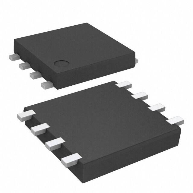

    MOSFET N/P-CH 60V 3A/2.5A VEC8
VEC2616-TL-H-Z 数据手册
VEC2616 Power MOSFET 60V, 80mΩ, 3A, –60V, 137mΩ, –2.5A, Complementary www.onsemi.com This Power MOSFET is produced using ON Semiconductor’s trench technology, which is specifically designed to minimize gate charge and low on resistance. This device is suitable for applications with low gate charge driving or low on resistance requirements. Features • Low On-Resistance • 4V drive • Low-Profile Package • Complementary N-Channel and P-Channel MOSFET • ESD Diode-Protected Gate • Pb-Free, Halogen Free and RoHS compliance VDSS N-Ch 60V ELECTRICAL CONNECTION N-Channel and P-Channel Symbol 8 N-Channel P-Channel −60 Gate to Source Voltage VGSS ID ±20 ±20 V 3 −2.5 A 12 −10 A IDP 7 6 5 1 : Source1 2 : Gate1 3 : Source2 4 : Gate2 5 : Drain2 6 : Drain2 7 : Drain1 8 : Drain1 Unit 60 Junction Temperature −2.5A 194mΩ@ −4V VDSS Power Dissipation When mounted on ceramic substrate 2 (900mm × 0.8mm) 1unit Total Dissipation When mounted on ceramic substrate 2 (900mm × 0.8mm) 3A 180mΩ@ −4.5V −60V Drain to Source Voltage Drain Current (Pulse) PW ≤ 10μs, duty cycle ≤ 1% 106mΩ@ 4.5V 137mΩ@ −10V P-Ch SPECIFICATIONS ABSOLUTE MAXIMUM RATING at Ta = 25°C (Note 1) Drain Current (DC) ID Max 116mΩ@ 4V Typical Applications • Motor Driver Parameter RDS(on) Max 80mΩ@ 10V V PD 0.9 W PT 1.0 W Tj 150 °C 1 2 3 PACKING TYPE : TL 4 MARKING UP LOT No. Storage Temperature Tstg −55 to +150 °C Note 1 : Stresses exceeding those listed in the Maximum Ratings table may damage the device. If any of these limits are exceeded, device functionality should not be assumed, damage may occur and reliability may be affected. TL ORDERING INFORMATION See detailed ordering and shipping information on page 7 of this data sheet. THERMAL RESISTANCE RATINGS Parameter Junction to Ambient When mounted on ceramic substrate 2 (900mm × 0.8mm) 1unit Symbol RθJA © Semiconductor Components Industries, LLC, 2015 October 2015 - Rev. 1 Value 138.8 1 Unit °C/W Publication Order Number : VEC2616/D VEC2616 ELECTRICAL CHARACTERISTICS at Ta = 25°C (Note 2) Conditions Value Parameter Symbol Drain to Source Breakdown Voltage V(BR)DSS Zero-Gate Voltage Drain Current IDSS ID=1mA, VGS=0V VDS=60V, VGS=0V Gate to Source Leakage Current IGSS VGS=±16V, VDS=0V Gate Threshold Voltage VGS(th) VDS=10V, ID=1mA Forward Transconductance gFS VDS=10V, ID=1.5A ID=1.5A, VGS=10V 2.6 min typ max Unit [N-Channel] Static Drain to Source On-State Resistance RDS(on)1 RDS(on)2 60 V 1 μA ±10 μA 2.6 V 62 80 mΩ 1.2 S ID=0.75A, VGS=4.5V 76 106 mΩ ID=0.75A, VGS=4V 83 116 mΩ Input Capacitance RDS(on)3 Ciss Output Capacitance Coss VDS=20V, f=1MHz Reverse Transfer Capacitance Crss Turn-ON Delay Time td(on) 7.3 ns Rise Time tr 7.5 ns Turn-OFF Delay Time td(off) 41 ns Fall Time tf Qg Total Gate Charge 505 See specified Test Circuit Gate to Source Charge Qgs Gate to Drain “Miller” Charge Qgd Forward Diode Voltage VSD IS=3A, VGS=0V Drain to Source Breakdown Voltage V(BR)DSS IDSS Gate to Source Leakage Current IGSS VGS(th) gFS ID=−1mA, VGS=0V VDS=−60V, VGS=0V VGS=±16V, VDS=0V −60 Zero-Gate Voltage Drain Current VDS=−10V, ID=−1mA −1.2 VDS=30V, VGS=10V, ID=3A pF 57 pF 37 pF 22 ns 10 nC 1.6 nC 2.1 nC 0.81 1.2 V −1 μA [P-Channel] Gate Threshold Voltage Forward Transconductance Static Drain to Source On-State Resistance RDS(on)1 RDS(on)2 RDS(on)3 Input Capacitance Ciss Output Capacitance Coss V ±10 μA −2.6 V VDS=−10V, ID=−1.5A ID=−1.5A, VGS=−10V 105 137 mΩ ID=−0.75A, VGS=−4.5V 128 180 mΩ ID=−0.75A, VGS=−4V 138 194 mΩ VDS=−20V, f=1MHz 3.9 S 420 pF 54 pF pF Reverse Transfer Capacitance Crss 44 Turn-ON Delay Time 6.4 ns Rise Time td(on) tr 9.8 ns Turn-OFF Delay Time td(off) 65 ns Fall Time tf 36 ns Total Gate Charge Qg 11 nC Gate to Source Charge Qgs 1.4 nC Gate to Drain “Miller” Charge Qgd See specified Test Circuit VDS=−30V, VGS=−10V, ID=−2.5A 2 nC VSD Forward Diode Voltage IS=−2.5A, VGS=0V −0.83 −1.2 V Note 2 : Product parametric performance is indicated in the Electrical Characteristics for the listed test conditions, unless otherwise noted. Product performance may not be indicated by the Electrical Characteristics if operated under different conditions. www.onsemi.com 2 VEC2616 Switching Time Test Circuit [N-Channel] 10V 0V [P-Channel] VDD=30V VIN 0V --10V ID=1.5A RL=20Ω VIN D PW=10μs D.C.≤1% 50Ω ID= --1.5A RL=20Ω VIN VOUT D PW=10μs D.C.≤1% VOUT G G P.G VDD= --30V VIN VEC2616 S P.G www.onsemi.com 3 50Ω VEC2616 S VEC2616 www.onsemi.com 4 VEC2616 www.onsemi.com 5 VEC2616 www.onsemi.com 6 VEC2616 PACKAGE DIMENSIONS unit : mm SOT-28FL / VEC8 CASE 318AH ISSUE O 1 : Source1 2 : Gate1 3 : Source2 4 : Gate2 5 : Drain2 6 : Drain2 7 : Drain1 8 : Drain1 Recommended Soldering Footprint 2.8 0.6 0.4 0.65 ORDERING INFORMATION Device Marking Package Shipping (Qty / Packing) UP SOT-28FL / VEC8 (Pb-Free / Halogen Free) 3,000 / Tape & Reel VEC2616-TL-H VEC2616-TL-W † For information on tape and reel specifications, including part orientation and tape sizes, please refer to our Tape and Reel Packaging Specifications Brochure, BRD8011/D. http://www.onsemi.com/pub_link/Collateral/BRD8011-D.PDF Note on usage : Since the VEC2616 is a MOSFET product, please avoid using this device in the vicinity of highly charged objects. ON Semiconductor and the ON logo are registered trademarks of Semiconductor Components Industries, LLC (SCILLC) or its subsidiaries in the United States and/or other countries. SCILLC owns the rights to a number of patents, trademarks, copyrights, trade secrets, and other intellectual property. A listing of SCILLC’s product/patent coverage may be accessed at www.onsemi.com/site/pdf/Patent-Marking.pdf . SCILLC reserves the right to make changes without further notice to any products herein. SCILLC makes no warranty, representation or guarantee regarding the suitability of its products for any particular purpose, nor does SCILLC assume any liability arising out of the application or use of any product or circuit, and specifically disclaims any and all liability, including without limitation special, consequential or incidental damages. “Typical” parameters which may be provided in SCILLC data sheets and/or specifications can and do vary in different applications and actual performance may vary over time. All operating parameters, including “Typicals” must be validated for each customer application by customer’s technical experts. SCILLC does not convey any license under its patent rights nor the rights of others. SCILLC products are not designed, intended, or authorized for use as components in systems intended for surgical implant into the body, or other applications intended to support or sustain life, or for any other application in which the failure of the SCILLC product could create a situation where personal injury or death may occur. Should Buyer purchase or use SCILLC products for any such unintended or unauthorized application, Buyer shall indemnify and hold SCILLC and its officers, employees, subsidiaries, affiliates, and distributors harmless against all claims, costs, damages, and expenses, and reasonable attorney fees arising out of, directly or indirectly, any claim of personal injury or death associated with such unintended or unauthorized use, even if such claim alleges that SCILLC was negligent regarding the design or manufacture of the part. SCILLC is an Equal Opportunity/Affirmative Action Employer. This literature is subject to all applicable copyright laws and is not for resale in any manner. www.onsemi.com 7
VEC2616-TL-H-Z
- 物料型号: VEC2616 - 器件简介: 使用ON Semiconductor的沟槽技术生产,旨在最小化栅极电荷并降低导通电阻。适合需要低栅极驱动或低导通电阻要求的应用。 - 引脚分配: N-Channel和P-Channel MOSFET的电气连接有明确的引脚分配图,包括源极(Source1, Source2)、栅极(Gate1, Gate2)和漏极(Drain1, Drain2)。 - 参数特性: 包括漏源电压(VDSS)、栅源电压(VGSS)、漏电流(IDC)、漏电流脉冲(IDP)、功耗(PD, PT)、结温(Tj)和存储温度(Tstg)等。 - 功能详解: 提供了详细的电气特性表,包括击穿电压、栅源漏电流、栅阈值电压、跨导、导通电阻、输入/输出/反向转移电容、开关时间等。 - 应用信息: 主要应用于电机驱动器。 - 封装信息: 提供了SOT-28FL/VEC8的封装尺寸和推荐的焊接足迹。
