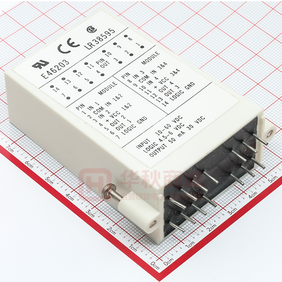

I/O MODULES QUAD AC INPUT DATA SHEET page 1/5 Form 485-040927 Part Number Description Quad Pak modules contain the equivalent of four single-channel I/O circuits in a single high-density package. Each Quad Pak module can be divided into two pairs, with each pair sharing a common connection. The Quad Pak modules are designed to plug into the Quad Pak high-density I/O mounting racks only and cannot be plugged into single-channel racks. Quad Pak modules are designed to work with a 5 VDC logic voltage only. These modules can be used with Optomux, Pamux, and Mistic protocol brain boards and mounting racks as well as racks using a direct cable connection to a computer. AC input modules are used for sensing ON/OFF AC voltages. All AC input modules are designed with filtering on the input and a hysteresis amplifier for high noise rejection and transient-free “clean” switching. Each module provides up to 4,000 Vrms of optical isolation between field inputs and the logic side of the circuit. Typical uses and applications include sensing the presence or absence of voltage or sensing contact closures from sources such as: • Proximity Switches • Limit Switches • Selector Switches • Push Buttons • Toggle Switches • Thermostats Description IDC5Q 4-Channel AC Input 12–32 VAC, 5 VDC Logic IAC5Q 4-Channel AC Input 90–140 VAC, 5 VDC Logic IAC5AQ 4-Channel AC Input 180–280 VAC, 5 VDC Logic Specifications General Operating Ambient Temperature -30° to 70° C Isolation Input-to-Output 4,000 Vrms Output Voltage Drop 0.4 volts @ 50 milliamperes Output Current 50 milliamperes Output Leakage With No Input 100 microamperes maximum @ 5 VDC Output Transistor 30 volts breakdown Specifications are continued on the next page. Opto 22 • 43044 Business Park Drive • Temecula, CA 92590-3614 • Phone: (951) 695-3000 • (800) 321-OPTO • Fax: (951) 695-3095 • www.opto22.com Inside Sales: (800) 321-OPTO • Product Support: (800) TEK-OPTO • (951) 695-3080 • Fax: (951) 695-3017 • Email: sales@opto22.com © 2004 Opto 22. All rights reserved. All trademarks, trade names, logos, and service marks referenced herein belong to their respective companies. I/O MODULES QUAD AC INPUT DATA SHEET page 2/5 Form 485-040927 Specifications (continued) Units IDC5Q IAC5Q IAC5AQ Input Voltage Range VAC 12–32 90–140 180–280 Input Current @ Maximum Line mA 29 5 5 Turn-on Time msec 5 20 20 Turn-off Time msec 5 20 20 Input Allowed For No Output mA, V 1, 3 3, 45 1.7, 80 Logic Supply Voltage - Nominal VDC 5 5 5 Logic Supply Voltage - Nominal VDC 4.5–6 4.5–6 4.5–6 Logic Supply Voltage - Nominal mA 12 12 12 Input Resistance Ohms 1.5K 24K 66K Control Resistance Ohms 220 220 220 Dimensions Opto 22 • 43044 Business Park Drive • Temecula, CA 92590-3614 • Phone: (951) 695-3000 • (800) 321-OPTO • Fax: (951) 695-3095 • www.opto22.com Inside Sales: (800) 321-OPTO • Product Support: (800) TEK-OPTO • (951) 695-3080 • Fax: (951) 695-3017 • Email: sales@opto22.com © 2004 Opto 22. All rights reserved. All trademarks, trade names, logos, and service marks referenced herein belong to their respective companies. I/O MODULES QUAD AC INPUT DATA SHEET page 3/5 Form 485-040927 Schematics Opto 22 • 43044 Business Park Drive • Temecula, CA 92590-3614 • Phone: (951) 695-3000 • (800) 321-OPTO • Fax: (951) 695-3095 • www.opto22.com Inside Sales: (800) 321-OPTO • Product Support: (800) TEK-OPTO • (951) 695-3080 • Fax: (951) 695-3017 • Email: sales@opto22.com © 2004 Opto 22. All rights reserved. All trademarks, trade names, logos, and service marks referenced herein belong to their respective companies. I/O MODULES QUAD AC INPUT DATA SHEET page 4/5 Form 485-040927 Connection Diagram Opto 22 • 43044 Business Park Drive • Temecula, CA 92590-3614 • Phone: (951) 695-3000 • (800) 321-OPTO • Fax: (951) 695-3095 • www.opto22.com Inside Sales: (800) 321-OPTO • Product Support: (800) TEK-OPTO • (951) 695-3080 • Fax: (951) 695-3017 • Email: sales@opto22.com © 2004 Opto Opto 22. 22. All trademarks, trade names, logos, and service marksmarks referenced herein belong their respective companies. © 1991–2004 Allrights rightsreserved. reserved.AllAll trademarks, trade names, logos, and service referenced herein to belong to their respective companies. LATEST PRODUCTS PRODUCT SUPPORT COMPANY INFORMATION I/O MODULES QUAD AC INPUT Products DATA SHEET Opto 22 produces a broad array of reliable, flexible hardware and Form 485-040927 software products for industrial automation, remote monitoring, enterprise data acquisition, and machine-to-machine (M2M) applications. SNAP Ethernet Systems Based on the Internet Protocol (IP), SNAP Ethernet systems offer flexibility in their network connectivity and in the software applications they work with. The physical network may be a wired Ethernet network, a cellular wireless network, or a modem. A wide variety of software applications can exchange data with SNAP Ethernet systems, including: • Opto 22’s own ioProject™ suite of control and HMI software • Manufacturing resource planning (MRP), enterprise management, and other enterprise systems • Human-machine interfaces (HMIs) • Databases • Email systems • OPC client software • Custom applications • Modbus/TCP software and hardware. SNAP Ethernet system hardware consists of controllers and I/O units. Controllers provide central control and data distribution. I/O units provide local connection to sensors and equipment. SNAP OEM Systems Opto 22 SNAP OEM I/O systems are highly configurable, programmable processors intended for OEMs, IT professionals, and others who need to use custom software with Opto 22 SNAP I/O modules. Linux® applications running on these systems can read and write to analog, simple digital, and serial I/O points on SNAP I/O modules using easily implemented file-based operations. Applications can be developed using several common development tools and environments, including C or C++, Java, and shell scripts. M2M Systems Machine-to-machine (M2M) systems connect your business computer systems to the machines, devices, and environments you want to monitor, control, or collect data from. M2M systems often use wireless cellular communications to link remote facilities to central systems over the Internet, or to provide monitoring and control capability via a cellular phone. Opto 22’s Nvio™ systems include everything you need for M2M— interface and communications hardware, data service plan, and Web portal—in one easy-to-use package. Visit nvio.opto22.com for more information. Opto 22 Software Opto 22’s ioProject and FactoryFloor® software suites provide full-featured and cost-effective control, HMI, and OPC software to power your Opto 22 hardware. These software applications help you develop control automation solutions, build easy-to-use operator interfaces, and expand your manufacturing systems’ connectivity. page 5/5 Quality In delivering hardware and software solutions for worldwide device management and control, Opto 22 retains the highest commitment to quality. We do no statistical testing; each product is made in the U.S.A. and is tested twice before leaving our 160,000 square-foot manufacturing facility in Temecula, California. That’s why we can guarantee solid-state relays and optically-isolated I/O modules for life. Product Support Opto 22’s Product Support Group offers comprehensive technical support for Opto 22 products. The staff of support engineers represents years of training and experience, and can assist with a variety of project implementation questions. Product support is available in English and Spanish from Monday through Friday, 7 a.m. to 5 p.m. PST. Opto 22 Web Sites • www.opto22.com • nvio.opto22.com • www.internetio.com (live Internet I/O demo) Other Resources • OptoInfo CDs • Custom integration and development • Hands-on customer training classes. About Opto 22 Opto 22 manufactures and develops hardware and software products for industrial automation, remote monitoring, enterprise data acquisition, and machine-to-machine (M2M) applications. Using standard, commercially available Internet, networking, and computer technologies, Opto 22’s input/output and control systems allow customers to monitor, control, and acquire data from all of the mechanical, electrical, and electronic assets that are key to their business operations. Opto 22’s products and services support automation end users, OEMs, and information technology and operations personnel. Founded in 1974 and with over 85 million Opto 22-connected devices deployed worldwide, the company has an established reputation for quality and reliability. Opto 22 • 43044 Business Park Drive • Temecula, CA 92590-3614 • Phone: (951) 695-3000 • (800) 321-OPTO • Fax: (951) 695-3095 • www.opto22.com Inside Sales: Inside (800) Sales: 321-OPTO (800) 321-OPTO • Product Support: • Product(800) Support: TEK-OPTO (800) TEK-OPTO • (951) 695-3080 • (951)•695-3080 Fax: (951)• Fax: 695-3017 (951)•695-3017 Email: sales@opto22.com • Email: sales@opto22.com • Form 1335-050601 © 2004-2005 © 2004 Opto Opto 22.22. All All rights rights reserved. reserved. All All trademarks, trademarks, trade trade names, names, logos, logos, andand service service marks marks referenced referenced herein herein belong belong to their to their respective respective companies. companies.
