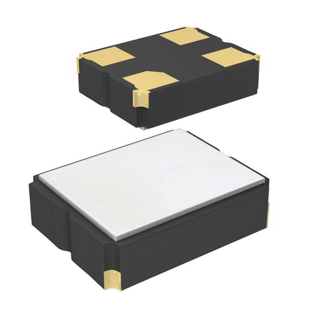

    有源晶振 80.000000MHz 1.6V~3.63V-40℃~+85℃ CMOS
KC2016K80.0000C1GE00 数据手册
Clock Oscillators Surface Mount Type Clock “K” Series CMOS/ 1.8V, 2.5V, 3.3V Compatible/ 2.0×1.6, 2.5×2.0, 3.2×2.5, 5.0×3.2, 7.0×5.0mm Features How to Order KC2520K 25.0000 C 1 0 E 00 • Frequency Range 1.5 to 80MHz • CMOS output • Wide Supply Voltage 1.6 to 3.63V • Low current consumption • Option: Low Phase Noise Version ① Operating Freq. Tol. Temperature Note Code × 10−6 Range (°C) ± 50 0 Standard specifications ± 30 −10 to +70 S ± 25 U With only certain ± 50 −40 to +85 frequencies G ± 50 −40 to +105 6 Packaging Tape & Reel KC7050K/ KC5032K : 1000 pcs/ reel KC3225K/ KC2520K/ KC2016K : 2000 pcs/ reel Dimensions (Unit: mm) KC2016K KC2520K 2.5×2.0mm: KC2520K 3.2×2.5mm: KC3225K 5.0×3.2mm: KC5032K 7.0×5.0mm: KC7050K ② Output Frequency (25.0000: 25MHz) ③ Output Type (C: CMOS) ④ Supply Voltage   1 : 1.8V/ 2.5V/ 3.3V Multi Voltage   (Version E : Standard)   2 : 2.5V (Version N : Low Phase Noise)   3 : 3.3V (Version N : Low Phase Noise) ⑤ Frequency Tolerance (See Table 1) ⑥ Symmetry/ INH Function   E : 45/ 55%, Stand-by   N : 45/ 55%, Stand-by, Low Phase Noise ⑦ Customer Special Model Suffix (STD Specification is “00”) Recommended Land Pattern KC2016K 1.85 2.5 #2 0.7 0.8 max. Tolerance : ±0.2mm #1 0.9 0.7 Tolerance : ±0.1mm 0.95 #1 0.3 0.4 2.0 0.5 0.8 max. 0.24 1.2 0.24 #2 0.3 0.8 0.6 0.6 0.6 #4 Marking Area 1.6 Marking Area 0.4 #3 1.45 #4 0.5 #3 0.6 1.2 1.05 0.6 #4 #2 #1 0.9 1.2 KC3225K 0.65 1.0 0.65 #3 2.2 1.75 0.9 Tolerance : ±0.1mm 0.95 0.8 max. 0.24 Marking Area 2.5±0.15 3.2±0.15 KC3225K KC5032K 1.2 1.2 #4 #2 #1 KC5032K 2.5 1.2 #3 2.2 2.54 Tolerance : ±0.2mm 1.4 1.2 max. 0.5 3.2 0.9 5.0 Marking Area KC7050K 1.6 7.0 1.4 KC7050K 1.1 5.08 #4 #2 #1 2.0 4.2 2.6 #3 5.0 Marking Area 1.2 max. 5.08 0.5 (Unit: mm) KC2520K 0.8 2.0 ③④⑤⑥ ⑦ ① Type 2.0×1.6mm: KC2016K Table 1 RoHS Compliant ② Tolerance : ±0.2mm 1.8 Clock Oscillators Surface Mount Type Clock “K” Series CMOS/ 1.8V, 2.5V, 3.3V Compatible/ 2.0×1.6, 2.5×2.0, 3.2×2.5, 5.0×3.2, 7.0×5.0mm Specifications Item Symbol Output Frequency RangeNote1 fo Conditions Op. Temp.: −10 to +70°C/ −40 to +85°C/ −40 to +105°C Frequency Tolerance f_tol Frequency Aging Storage Temperature Range f_age T_stg Operating Temperature Range T_use Max. Supply Voltage Supply Voltage Initial tolerance, Operating temperature range, Rated power supply voltage change, Op. Temp.: −10 to +70°C Load change, Aging (1 year @25°C), Shock and vibration Op. Temp.: −10 to +70°C @25°C First year — VCC Current Consumption (Maximum Loaded/ 1.5≤F0
物料型号: - 2.0×1.6mm: KC2016K - 2.5×2.0mm: KC2520K - 3.2×2.5mm: KC3225K - 5.0×3.2mm: KC5032K - 7.0×5.0mm: KC7050K
器件简介: - 兼容1.8V、2.5V、3.3V的CMOS输出 - 频率范围1.5至80MHz - 宽电源电压范围1.6至3.63V - 低电流消耗 - 提供低相位噪声版本选项
引脚分配: - #1: 使能/禁用 - #2: 外壳地 - #3: 输出 - #4: Voc
参数特性: - 工作温度范围:-10至+70°C(标准规格)、-40至+85°C、-40至+105°C - 频率容差:±50ppm至±50ppm,具体取决于温度范围和频率代码 - 供电电压:1.6V至3.63V - 最大电流消耗:根据供电电压和频率不同,范围从2.5mA至18mA - 待机电流:5μA - 上升/下降时间:6ns至5ns(取决于供电电压) - 输出电压水平:低电平10%Vcc,高电平90%Vcc - 输入电压电平:低电平30%Vcc,高电平70%Vcc - 启动时间:3ms至5ms - 抖动和相位噪声:1σ抖动5ps至4ps,峰峰抖动50ps至40ps,相位噪声在不同频率偏移下有不同的值
功能详解: - 提供CMOS输出,具有低相位噪声版本 - 具有使能/禁用功能,通过引脚1控制 - 提供不同的频率容差选项
应用信息: - 符合RoHS标准 - 封装采用胶带和卷轴,不同型号的卷轴容量不同
封装信息: - 提供了不同尺寸的封装,包括2.0×1.6mm至7.0×5.0mm - 推荐焊盘图案尺寸
