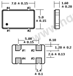

### 封装信息 PDF文档中提供了封装尺寸图,具体尺寸如下: - ![Package Dimensions](https://p9-flow-imagex-sign.byteimg.com/ocean-cloud-tos/pdf/40ed7190f7a7843d3a54a1813559e357_1_1200.jpg~tplv-a9rns2rl98-resize-crop:88:117:401:441:313:324.jpeg?rk3s=1567c5c4&x-expires=1770906353&x-signature=TID5lsWzaP8OAfIH22ZkfmZsJM0%3D)
