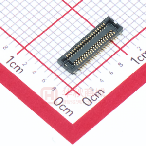

AXT5, 6 NARROW PITCH (0.4 mm) CONNECTORS F4S SERIES 3. The simple lock structure gives tactile feedback that ensures a superior mating/unmating operation feel. FEATURES 1. Space-saving (3.6 mm widthwise) The required space is smaller than our F4 series (40-contact type): Socket — 27% smaller, Header — 38% smaller The small size contributes to the miniaturization of target equipment. Socket Header Compliance with RoHS Directive Socket (4 o 0c nta cts ) Simple lock structure 10 3.6 0 .50 Clips (soldering terminal)* at the four corners Pickup width: 0.8mm Clips (soldering terminal)* at the four corners Header 0( 4 o 0c nta cts ) 4. Gull-wing type terminals The gull-wing type terminals facilitate automatic mounting inspections. 5. Connectors for inspection available Connectors for inspection are available that are ideal for modular unit inspection and inspection in device assembly processes. 2.6 0 9.8 APPLICATIONS Compact portable devices “Cellular phones, DVC, Digital cameras, etc” Example of Board-to-FPC connections Before mating After mating FPC Narrow-pitch connectors F4S Reinforcing plate Reinforcing plate (with FPC) PCB 1.0mm * Clips for preventing the solder joints from being removed 2. Highly reliable has strong resistance to adverse environments. (See Page 6 for details of the structure) Note: If extra resistance to shock caused by dropping is required, we recommend using our previous F4 Series. The simple lock mechanism ensures that the connector clicks into position when it is inserted for reliable single-action insertion on the PCB. ORDERING INFORMATION AXT 5: Narrow Pitch Connector F4S (0.4 mm pitch) Socket 6: Narrow Pitch Connector F4S (0.4 mm pitch) Header Number of contacts (2 digits) Mated height 1: For mated height 1.0 mm 2: For mated height 1.2 mm 1: For mated height 1.0 mm 2: For mated height 1.2 mm Functions 2: Without positioning bosses Surface treatment (Contact portion / Terminal portion) 4: Base: Ni plating Surface: Au plating (for Ni barrier available) 4: Base: Ni plating Surface: Au plating Note: Please note that models with a mated height of 1.0 mm (7th digit of part number is “1”) and 1.2 mm (7th digit of part number is “2”) are not compatible. 4 panasonic-electric-works.net/ac Narrow-pitch connectors NARROW-PITCH, THIN AND SLIM CONNECTOR FOR BOARD-TO-FPC CONNECTION AXT5, 6 Narrow-pitch connectors PRODUCT TYPES Mated height Number of contacts 10 12 14 16 18 20 22 24 26 28 30 32 34 36 38 40 42 44 46 48 50 54 60 64 70 80 10 30 40 50 80 Part number Socket AXT510124 AXT512124 AXT514124 AXT516124 AXT518124 AXT520124 AXT522124 AXT524124 AXT526124 AXT528124 AXT530124 AXT532124 AXT534124 AXT536124 AXT538124 AXT540124 AXT542124 AXT544124 AXT546124 AXT548124 AXT550124 AXT554124 AXT560124 AXT564124 AXT570124 AXT580124 AXT510224 AXT530224 AXT540224 AXT550224 AXT580224 Header AXT610124 AXT612124 AXT614124 AXT616124 AXT618124 AXT620124 AXT622124 AXT624124 AXT626124 AXT628124 AXT630124 AXT632124 AXT634124 AXT636124 AXT638124 AXT640124 AXT642124 AXT644124 AXT646124 AXT648124 AXT650124 AXT654124 AXT660124 AXT664124 AXT670124 AXT680124 AXT610224 AXT630224 AXT640224 AXT650224 AXT680224 Inner carton Packing Outer carton 1.0mm 3,000 pieces 6,000 pieces 1.2mm Notes: 1. Order unit: For mass production: in 1-inner-box (1-reel) units Samples for mounting check: in 50-connector units. Please contact our sales office. Samples: Small lot orders are possible. Please contact our sales office. 2. The above part numbers are for connectors without positioning bosses, which are standard. When ordering connectors with positioning bosses, please contact our sales office. 3. Please contact us for connectors having a number of contacts other than those listed above. panasonic-electric-works.net/ac AXT5, 6 1. Characteristics Item Rated current Rated voltage Electrical characteristics Breakdown voltage Insulation resistance Contact resistance Composite insertion force Composite removal force Contact holding force (Socket contact) Ambient temperature Soldering heat resistance Storage temperature Specifications 0.3A/contact (Max. 5 A at total contacts) 60V AC/DC 150V AC for 1 min. Min. 1,000MΩ (initial) Max. 90mΩ Max. 0.981N/contacts × contacts (initial) Min. 0.165N/contacts × contacts Min. 0.49N/contacts –55°C to +85°C Peak temperature: 260°C or less (on the surface of the PC board around the connector terminals) 300°C within 5 sec. 350°C within 3 sec. –55°C to +85°C (product only) –40°C to +50°C (emboss packing) 5 cycles, insulation resistance min. 100MΩ, contact resistance max. 90mΩ 120 hours, insulation resistance min. 100MΩ, contact resistance max. 90mΩ 24 hours, insulation resistance min. 100MΩ, contact resistance max. 90mΩ 48 hours, contact resistance max. 90mΩ 50 times 20-contact type: Socket: 0.03 g Header: 0.01 g Measuring the maximum force. As the contact is axially pull out. No freezing at low temperatures. No dew condensation. Infrared reflow soldering Soldering iron No freezing at low temperatures. No dew condensation. Sequence 1. –55 −0 °C, 30 minutes 3 2. ~ , Max. 5 minutes +3 3. 85 0 °C, 30 minutes 4. ~ , Max. 5 minutes Bath temperature 40±2°C, humidity 90 to 95% R.H. Bath temperature 35±2°C, saltwater concentration 5±1% Bath temperature 40±2°C, gas concentration 3±1 ppm, humidity 75 to 80% R.H. Repeated insertion and removal speed of max. 200 times/ hours Conditions No short-circuiting or damage at a detection current of 1 mA when the specified voltage is applied for one minute. Using 250V DC megger (applied for 1 min.) Based on the contact resistance measurement method specified by JIS C 5402. Mechanical characteristics Environmental characteristics Thermal shock resistance (header and socket mated) Humidity resistance (header and socket mated) Saltwater spray resistance (header and socket mated) H2S resistance (header and socket mated) Lifetime characteristics Unit weight Insertion and removal life 2. Material and surface treatment Part name Molded portion Contact and Post Material LCP resin (UL94V-0) Surface treatment — Contact portion: Base: Ni plating Surface: Au plating Terminal portion: Base: Ni plating Surface: Au plating (except the terminal tips) The socket terminals close to the portion to be soldered have nickel barriers (exposed nickel portions). Metal clips: Sockets: Base: Ni plating Surface: Pd+Au flash plating (except the terminal tips) Headers: Base: Ni plating Surface: Au plating (except the terminal tips) Copper alloy panasonic-electric-works.net/ac Narrow-pitch connectors SPECIFICATIONS AXT5, 6 Narrow-pitch connectors DIMENSIONS (Unit: mm) 0.80 (Suction face) The CAD data of the products with a CAD Data mark can be downloaded from: http://panasonic-electric-works.net/ac Socket (Mated height: 1.0 mm and 1.2 mm) CAD Data A B±0.1 0.40±0.05 0.15±0.03 Terminal coplanarity D (0.62) Dimension table (mm) 0.08 (Contact and clips (soldering terminal)*) C0.15 Y note General tolerance: ±0.2 Z note 0.45 C±0.1 (0.80) 0.30±0.03 Note: Since the clip (soldering terminal)* has a single-piece construction, sections Y and Z are electrically connected. Mated height/ dimension 1.0mm 1.2mm D 0.97 1.17 Number of contacts/ dimension 10 12 14 16 18 20 22 24 26 28 30 32 34 36 38 40 42 44 46 48 50 54 60 64 70 80 A 4.5 4.9 5.3 5.7 6.1 6.5 6.9 7.3 7.7 8.1 8.5 8.9 9.3 9.7 10.1 10.5 10.9 11.3 11.7 12.1 12.5 13.3 14.5 15.3 16.5 18.5 B 1.6 2.0 2.4 2.8 3.2 3.6 4.0 4.4 4.8 5.2 5.6 6.0 6.4 6.8 7.2 7.6 8.0 8.4 8.8 9.2 9.6 10.4 11.6 12.4 13.6 15.6 C 3.4 3.8 4.2 4.6 5.0 5.4 5.8 6.2 6.6 7.0 7.4 7.8 8.2 8.6 9.0 9.4 9.8 10.2 10.6 11.0 11.4 12.2 13.4 14.2 15.4 17.4 2.36 2.00 3.60 (0.62) Header (Mated height: 1.0 mm and 1.2 mm) 0.80 (Suction face) 3.00 3.60 Dimension table (mm) D Terminal coplanarity CAD Data R0 A B±0.1 0.40±0.05 0.15±0.03 0.08 (Post and clips (soldering terminal)*) Clip (soldering terminal)* 0.15±0.03 C±0.1 General tolerance: ±0.2 Mated height/ dimension 1.0mm 1.2mm D 0.83 1.01 Number of contacts/ dimension 10 12 14 16 18 20 22 24 26 28 30 32 34 36 38 40 42 44 46 48 50 54 60 64 70 80 A 3.8 4.2 4.6 5.0 5.4 5.8 6.2 6.6 7.0 7.4 7.8 8.2 8.6 9.0 9.4 9.8 10.2 10.6 11.0 11.4 11.8 12.6 13.8 14.6 15.8 17.8 B 1.6 2.0 2.4 2.8 3.2 3.6 4.0 4.4 4.8 5.2 5.6 6.0 6.4 6.8 7.2 7.6 8.0 8.4 8.8 9.2 9.6 10.4 11.6 12.4 13.6 15.6 C 3.2 3.6 4.0 4.4 4.8 5.2 5.6 6.0 6.4 6.8 7.2 7.6 8.0 8.4 8.8 9.2 9.6 10.0 10.4 10.8 11.2 12.0 13.2 14.0 15.2 17.2 .1 5 1.86 13 • Socket and Header are mated 1.00±0.15 1.20±0.15 Header Socket Header Socket Mated height: 1.0 mm Mated height: 1.2 mm 1.90 Clip (soldering terminal)* (0.48) 0.94 (0.46) C 0. 1.68 C 1 0. 3 2.60 panasonic-electric-works.net/ac AXT5, 6 • Specifications for taping (In accordance with JIS C 0806-1990. However, not applied to the mounting-hole pitch of some connectors.) Tape I Tape II A±0.3 C 1.75 Leading direction after packaging Leading direction after packaging A±0.3 B C 1.75 380 dia. • Specifications for the plastic reel (In accordance with EIAJET-7200B.) D±1 Taping reel Top cover tape 4 2 4 2 Embossed carrier tape Embossed mounting-hole 8.0 8.0 1.5+0.1 dia. 0 1.5+0.1 dia. 0 • Dimension table (Unit: mm) Type/Mated height Common for sockets and headers: 1.0mm, 1.2mm Number of contacts 24 or less 26 to 70 80 Type of taping Tape I Tape I Tape II A 16.0 24.0 32.0 B — — 28.4 C 7.5 11.5 14.2 D 17.4 25.4 33.4 Quantity per reel 3,000 3,000 3,000 • Connector orientation with respect to embossed tape feeding direction Type Direction of tape progress Socket Common for F4S Header Note: There is no indication on this product regarding top-bottom or left-right orientation. panasonic-electric-works.net/ac Narrow-pitch connectors EMBOSSED TAPE DIMENSIONS (Unit: mm) (Common to all sockets and headers) AXT5, 6 Narrow-pitch connectors CONNECTOR FOR INSPECTION USAGE APPLICATIONS WITH 3,000 INSERTION AND (0.4 mm PITCHES) REMOVAL TIMES NARROW PITCH CONNECTOR F4S FOR INSPECTION USAGE FEATURES 1. 3,000 insertion and removals (when as recommended) 2. Same external dimensions and foot pattern as standard type. 3. Improved mating Insertion and removal have become easier due to a reduction in the mating retention force required by the simple locking structure and also in the amount of force needed for insertion and removal. (We cannot warrant anything regarding mating retention.) APPLICATIONS Ideal for module unit inspection and equipment assembly inspection Socket Header Compliance with RoHS Directive TABLE OF PRODUT TYPES ✩: Available for sale Product name F4S for inspection 10 ✩ 12 ✩ 14 ✩ 16 ✩ 18 ✩ 20 ✩ 22 ✩ 24 ✩ 26 ✩ 28 ✩ 30 ✩ Number of contacts 32 34 36 38 ✩ ✩ ✩ ✩ 40 ✩ 42 ✩ 44 ✩ 46 ✩ 48 ✩ 50 ✩ 54 ✩ 60 ✩ 64 ✩ 70 ✩ 80 ✩ Notes: 1. Please inquire about numbers of contacts other than those given above. 2. Please inquire with us regarding delivery times. 3. Please keep the minimum unit for ordering no less than 50 pieces per lot. 4. Please inquire for further information. PRODUCT TYPES Socket Specifications Without positioning bosses Part No. AXT5E∗∗26 Header Specifications Without positioning bosses Part No. AXT6E∗∗26 Notes: 1. When placing an order, substitute the “∗” (asterisk) in the above part number with the number of contacts for the required connector. 2. The above part numbers are for connectors without positioning bosses, which are standard. When ordering connectors with positioning bosses, please contact our sales office. panasonic-electric-works.net/ac AXT5, 6 1. If extra resistance to drop impact is required, we recommend using our F4 series. 2. Recommended PC board and metal mask patterns Appropriate control of solder amount is required to minimize solder bridges and other defects for connectors with 0.4-mm or 0.5-mm pitch terminals, which require high-density mounting. Refer to the righthand drawing for recommended patterns. • Socket Recommended PC board pattern (TOP VIEW) (0.92) 2.36±0.03 4.20±0.03 0.90±0.03 0.70±0.03 • Header Recommended PC board pattern (TOP VIEW) 0.80±0.03 0.45±0.03 Max. 1.00 (0.75) 1.70±0.03 3.20±0.03 1.80±0.03 (1.20) 2.06±0.03 0.75±0.03 (0.655) 0.23±0.03 0.40±0.03 : Insulation area 0.23±0.03 0.40±0.03 : Insulation area Recommended metal mask opening pattern Metal mask thickness: When 150µm (Terminal opening ratio: 48%) (Metal-part opening ratio: 100%) (0.51) 2.98±0.01 4.00±0.01 0.90±0.01 0.70±0.01 Recommended metal mask opening pattern Metal mask thickness: When 150µm (Terminal opening ratio: 48%) (Metal-part opening ratio: 100%) 0.80±0.01 0.45±0.01 (0.41) 2.18±0.01 3.00±0.01 4.20±0.01 1.80±0.01 (1.20) 0.20±0.01 0.40±0.01 2.06±0.01 0.75±0.01 (0.655) 0.20±0.01 0.40±0.01 Recommended metal mask opening pattern Metal mask thickness: When 120µm (Terminal opening ratio: 60%) (Metal-part opening ratio: 100%) (0.63) 2.74±0.01 4.00±0.01 0.90±0.01 0.70±0.01 Recommended metal mask opening pattern Metal mask thickness: When 120µm (Terminal opening ratio: 60%) (Metal-part opening ratio: 100%) 0.80±0.01 0.45±0.01 (0.52) 1.96±0.01 3.00±0.01 4.20±0.01 1.80±0.01 (1.20) 2.06±0.01 0.75±0.01 (0.655) 0.20±0.01 0.40±0.01 0.20±0.01 0.40±0.01 For other details, please verify with the product specification sheets. panasonic-electric-works.net/ac Narrow-pitch connectors NOTES
