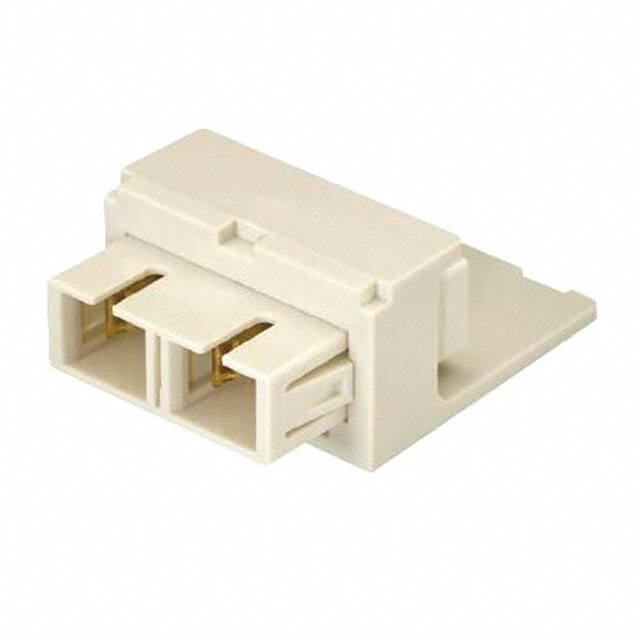

SC Fiber Optic Adapters SPECIFICATION SHEET specifications SC fiber optic adapters with integrated panel retention clips are TIA/EIA-604 FOCIS-3 compliant. Each SC simplex adapter shall connect one SC connector pair in one module space. Each SC duplex adapter shall connect two SC connector pairs in two module spaces. SC adapters and adapter modules shall include phosphor bronze split sleeves for multimode applications or zirconia ceramic split sleeves for singlemode applications. technical information SC Fiber Optic Adapters Simplex MM: FASSCEI-L Duplex MM: FADSCEI-L ™ Simplex 10Gig  : FASSCAQ-L Duplex 10Gig ™ FADSCAQ-L Simplex 10Gig ™ (zirc.): FASSCZAQ-L Duplex 10Gig ™ (zirc.): FADSCZAQ-L Simplex SM (zirc.): FASSCZBU-L Duplex SM (zirc.): FADSCZBU-L Simplex APC (zirc.): FASSCZAG-L Duplex APC (zirc.): FADSCZAG-L L = Bag of 50 adapters; 100 per carton. Standards requirements: TIA/EIA-604 FOCIS-3 compliant; exceeds TIA/EIA-568-B.3 requirements Split sleeve material: Phosphor bronze or zirconia ceramic (required for singlemode applications) Insertion loss: 0.1dB average (multimode), 0.15dB average (singlemode); supports the performance of FOCIS-3 compliant connectors/patch cords Return loss: Supports singlemode (>40dB for SPC and >55dB for UPC) and multimode (>20dB) connector polish performance •Panduit LC Connector/Adapter connection key features and benefits Integrated panel retention clips: No metal clips to become bent, damaged or lost; clips automatically adjust for FOCIS-3 compliant panel thickness variations for improved mounting High glass transition temperature latch material (Tg>100°C) Meets Telcordia GR-326-CORE, Issue 3; maintains latch integrity/geometry in high temperature environments for improved reliability Improved adapter protective cap design Maximum protection from contamination; protective cap fully surrounds split sleeve opening Short flange design Improved modularity and higher density usage Choice of phosphor bronze or zirconia ceramic split sleeves Provides an adapter split sleeve material option to fit specific network requirements Q.C. number and split sleeve material laser marked on every adapter Assures 100% traceability; quick and easy identification of split sleeve material: SC-P = Phosphor Bronze and SC-Z = Zirconia Ceramic Adapters available in Mini-Com ® Modules System flexibility; adapter modules can be used in all Mini-Com® Closet Products and Work Area Outlets Adapters available in patch panels, fiber adapter panels (FAPs) and Opticom ® QuickNet ™ Pre-Terminated MTP* Cassettes Provides a complete SC system solution Adapters and modules available in multiple colors Allows color-coding for network segregation Mini-Com ® SC Adapter Modules Simplex MM: CMSEISCEI Duplex MM: CMDEISCEI ™ Simplex 10Gig : CMSAQSCBL   Duplex 10Gig ™: CMDAQSCBL Simplex 10Gig ™(zirc.): CMSAQSCZBL Duplex 10Gig ™(zirc.): CMDAQSCZBL Simplex SM (zirc.): CMSBUSCZBU Duplex SM (zirc.): CMDBUSCZBU Simplex APC (zirc.): CMSAGSCZBL Duplex APC (zirc.): CMDAGSCZBL Opticom ® SC Fiber Adapter Panels 6 duplex MM: FAP6WEIDSC 6 duplex 10Gig ™: FAP6WAQDSCZ 6 duplex SM (zirc.): FAP6WBUDSCZ 12 simplex SM (zirc.): FAP12WBUSCZ Opticom ® QuickNet ™ Pre-Terminated MTP* Cassettes 12 SC to MTP* (12f): FC^-12-3S 6 SC to MTP* (12f): FC^-12-3 SC Simplex Fiber Optic Connectors MM (900µm/3mm, black): FSCMBL MM (900µm/3mm, red): FSCMRD SM (900µm/3mm, blue): FSCSBU MM (900µm/2mm, black): FSCM2.0BL MM (900µm/2mm, red): FSCM2.0RD SM (900µm/2mm, blue): FSCS2.0BU SC Duplex Fiber Optic Connectors Multimode (3mm only): FSCDM Opti-Core ® Fiber Optic Patch Cords Duplex SC to SC: F^D3-3M‡ Simplex SC to SC: F^S3-3M‡ Simplex SC to pigtail: F^B3-NM‡ HD Connector Removal Tool For LC and SC: HDCRT ^Substitute for fiber type: X (OM3/OM4 – 10Gig™ 50/125µm), 5 (OM2 – 50/125µm), 6 (OM1 – 62.5/125µm) or 9 (OS1 – 9/125µm). applications Panduit SC Fiber Optic Adapters can be used with Mini-Com® Modules, Patch Panels, Faceplates and Surface Mount Boxes for a complete SC system solution. SC adapters provide a robust solution for LANs, public networks, storage area networks *MTP is a registered trademark of US Conec Ltd. w w w . pa n d u it.c o m **Substitute for module color: EI = Electric Ivory BU = Blue IG = International Gray WH = White TG = Technical Gray BL = Black AW = Arctic White IW = Off White EW = European White and fiber-to-the-desk applications. SC adapters can also be mounted in high-density applications within Opticom ® QuickNet™ Pre-Terminated MTP * Cassettes and Fiber Enclosures, and Opticom ® Fiber Adapter Panels (FAPs) and Enclosures. ‡Substitute for length in meters: 1, 2, 3, 5 or 10 for patch cords, and 1, 2 or 3 for pigtails; singlemode patch cords are also available in 12, 15, 25 or 30 meter lengths. Contact Customer Service for other available lengths. SC Fiber Optic Adapters selection information Part Number Split Sleeve Material Adapter Type Adapter Color Module Color N/A SC Adapters FASSCEI-L Multimode Simplex Phosphor Bronze Electric Ivory FASSCAQ-L 10Gig™ Multimode Simplex Phosphor Bronze Aqua N/A N/A 10Gig™ Multimode Simplex Zirconia Ceramic Aqua N/A FADSCEI-L FADSCAQ-L FASSCZAQ-L FADSCZAQ-L FASSCZBU-L FADSCZBU-L FASSCZAG-L FADSCZAG-L Multimode Duplex 10Gig™ Multimode Duplex 10Gig™ Multimode Duplex Singlemode Simplex Singlemode Duplex APC Singlemode Simplex APC Singlemode Duplex SC Adapter Modules Phosphor Bronze Phosphor Bronze Zirconia Ceramic Zirconia Ceramic Zirconia Ceramic Electric Ivory Aqua Aqua N/A Green Electric Ivory Various** CMSAQSCBL 10Gig™ Multimode Simplex Phosphor Bronze Aqua Black 10Gig™ Multimode Simplex Zirconia Ceramic CMSAQSCZBL CMDAQSCZBL CMSBUSCZBU CMDBUSCZBU CMSAGSCZBL CMDAGSCZBL 10Gig™ Multimode Duplex 10Gig™ Multimode Duplex Singlemode Simplex Singlemode Duplex APC Singlemode Simplex APC Singlemode Duplex Phosphor Bronze Zirconia Ceramic Zirconia Ceramic Zirconia Ceramic Zirconia Ceramic Zirconia Ceramic >40dB 0.1dB >20dB 0.15dB >40dB N/A Phosphor Bronze CMDAQSCBL 0.15dB N/A Green Phosphor Bronze >20dB N/A Blue Multimode Simplex Multimode Duplex 0.1dB N/A Blue CMSEISCEI CMDEISCEI Return Loss^ N/A Zirconia Ceramic Zirconia Ceramic Average Insertion Loss^ Electric Ivory Various** Aqua Black Aqua Black Aqua Black Blue Various** Green Black Blue Various** Green Black ^Panduit SC Connector/Adapter connection **For other colors, replace suffix EI or BU with EI (Electric Ivory), BU (Blue), IG (International Gray), WH (White), TG (Technical Gray), BL (Black), AW (Arctic White), IW (Off White) or EW (European White). Mini-Com® SC Simplex Adapter Module Mini-Com® SC Duplex Adapter Module 0.62 [15.8] 0.71 [18.0] 1.24 [31.5] 1.37 [34.8] SC Simplex Adapter SC Duplex Adapter 0.120 [3.0] 0.076 [1.9] 1.37 [34.8] 0.71 [18.0] 0.120 [3.0] 0.076 [1.9] 0.51 [12.9] 1.02 [25.9] 0.37 [9.3] 1.08 [27.4] 1.08 [27.4] 0.37 [9.3] Dimensions are in inches [Dimensions in brackets are in millimeters] WORLDWIDE SUBSIDIARIES AND SALES OFFICES PANDUIT CANADA Markham, Ontario cs-cdn@panduit.com Phone: 800.777.3300 PANDUIT EUROPE LTD. London, UK cs-emea@panduit.com Phone: 44.20.8601.7200 PANDUIT SINGAPORE PTE. LTD. Republic of Singapore cs-ap@panduit.com Phone: 65.6305.7575 PANDUIT JAPAN Tokyo, Japan cs-japan@panduit.com Phone: 81.3.6863.6000 PANDUIT LATIN AMERICA Jalisco, Mexico cs-la@panduit.com Phone: 52.33.3777.6000 PANDUIT AUSTRALIA PTY. LTD. Victoria, Australia cs-aus@panduit.com Phone: 61.3.9794.9020 For a copy of Panduit product warranties, log on to www.panduit.com/warranty For more information Visit us at www.panduit.com Contact Customer Service by email: cs@panduit.com or by phone: 800-777-3300 ©2016 Panduit Corp. ALL RIGHTS RESERVED. FBSP121--WW-ENG 2016-06-22
