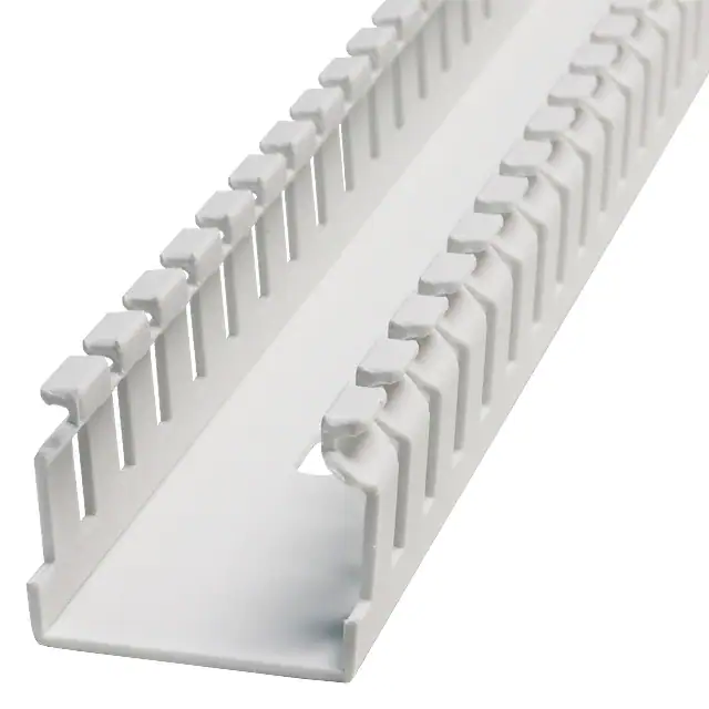

ELECTRICAL SOLUTIONS A. System Overview Panduct ® Type F Narrow Slot Wiring Duct • Narrow slot/finger design provides more slots to fit the spacing of high-density terminal blocks and other hardware • Material: Lead-free PVC • UL recognized continuous use temperature: 122°F (50°C) • UL 94 flammability rating of V-0 W H .50 TYP [12.7] .20 TYP [5.0] Multiple slot restrictors present with 2" and greater duct wall height. To order cover with protective film add “-F” to part number. 6" cover not available with film. • Conforms with NFPA 79-2007 section 13.3.1 requirement for flame retardant material • Provided with mounting holes • Base and cover length is 6 feet B1. Cable Ties Std. Base Cover Cover Pkg. Ctn. Ctn. Part Number Qty. Qty. Qty. C.5LG6 6 120 120 C.5LG6 6 120 120 C.75LG6 6 120 120 C.75LG6 6 120 120 Base Part Number F.5X.5LG6 F.5X1LG6 F.75X.75LG6 F.75X1.5LG6 Duct Size In. 0.69 x 0.60 0.69 x 1.06 0.93 x 0.82 0.93 x 1.57 (W x H)* mm 17.5 x 15.2 17.5 x 26.9 23.6 x 20.9 23.6 x 39.9 Slot Width In. mm 0.20 5.0 0.20 5.0 0.20 5.0 0.20 5.0 F1X1LG6 F1X1.5LG6 F1X2LG6 1.26 x 1.13 1.26 x 1.62 1.26 x 2.12 32.0 x 28.7 32.0 x 41.1 32.0 x 53.8 0.20 0.20 0.20 5.0 5.0 5.0 C1LG6 C1LG6 C1LG6 6 6 6 120 120 120 120 120 120 F1X3LG6 F1X4LG6 F1.5X1LG6 F1.5X1.5LG6 F1.5X2LG6 1.26 1.26 1.75 1.75 1.75 x x x x x 3.12 4.10 1.12 1.62 2.12 32.0 x 79.2 32.0 x 104.1 44.5 x 28.4 44.5 x 41.1 44.5 x 53.8 0.20 0.20 0.20 0.20 0.20 5.0 5.0 5.0 5.0 5.0 C1LG6 C1LG6 C1.5LG6 C1.5LG6 C1.5LG6 6 6 6 6 6 120 60 120 120 120 120 120 120 120 120 F1.5X3LG6 F1.5X4LG6 F2X1LG6 F2X1.5LG6 F2X2LG6 1.75 1.75 2.25 2.25 2.25 x x x x x 3.12 4.10 1.12 1.62 2.12 44.5 x 79.2 44.5 x 104.1 57.2 x 28.4 57.2 x 41.1 57.2 x 53.8 0.20 0.20 0.20 0.20 0.20 5.0 5.0 5.0 5.0 5.0 C1.5LG6 C1.5LG6 C2LG6 C2LG6 C2LG6 6 6 6 6 6 120 60 120 120 120 120 120 120 120 120 F2X3LG6 F2X4LG6 F2X5LG6 F2.5X3LG6 2.25 2.25 2.25 2.75 x x x x 3.12 4.10 5.10 3.12 57.2 x 79.2 57.2 x 104.1 57.2 x 129.5 69.9 x 79.2 0.20 0.20 0.20 0.20 5.0 5.0 5.0 5.0 C2LG6 C2LG6 C2LG6 C2.5LG6 6 6 6 6 60 60 60 120 120 120 120 120 F3X1LG6 F3X2LG6 F3X3LG6 F3X4LG6 F3X5LG6 F4X2LG6 3.25 3.25 3.25 3.25 3.25 4.25 x x x x x x 1.12 2.12 3.12 4.10 5.10 2.12 82.6 x 28.4 82.6 x 53.8 82.6 x 79.2 82.6 x 104.1 82.6 x 129.5 108.0 x 53.8 0.20 0.20 0.20 0.20 0.20 0.20 5.0 5.0 5.0 5.0 5.0 5.0 C3LG6 C3LG6 C3LG6 C3LG6 C3LG6 C4LG6 6 6 6 6 6 6 120 120 60 60 60 60 120 120 120 120 120 120 F4X3LG6 F4X4LG6 F4X5LG6 F6X4LG6 4.25 4.25 4.25 6.25 x x x x 3.12 4.10 5.10 4.15 108.0 x 79.2 108.0 x 104.1 108.0 x 129.5 158.8 x 105.4 0.20 0.20 0.20 0.20 5.0 5.0 5.0 5.0 C4LG6 C4LG6 C4LG6 C6LG6 6 6 6 6 60 60 60 60 120 120 120 120 Part number shown for LG (Light Gray). For other color availability see color selection guide, page C1.48. Base and cover sold separately. *“H” dimension includes duct and cover. B2. Cable Accessories B3. Stainless Steel Ties C1. Wiring Duct C2. Surface Raceway C3. Abrasion Protection C4. Cable Management D1. Terminals D2. Power Connectors D3. Grounding Connectors E1. Labeling Systems E2. Labels E3. Pre-Printed & Write-On Markers E4. Permanent Identification E5. Lockout/ Tagout & Safety Solutions F. Index For technical assistance in the U.S., call 866-405-6654 (outside the U.S., see inside back cover for directory)

器件简介:Panduct® Type F Narrow Slot Wiring Duct具有窄槽/指形设计,提供更多槽位以适应高密度端子排和其他硬件的间距。材质为无铅PVC,UL认可的连续使用温度为122°F(50°C),UL 94阻燃等级为V-0,符合NFPA 79-2007第13.3.1条对阻燃材料的要求。
引脚分配:文档中没有明确提到引脚分配,但提到了多槽限制器在2英寸及更大的导管壁高度上存在。
参数特性:材料为无铅PVC,UL认可的连续使用温度为122°F(50°C),UL 94阻燃等级为V-0。
功能详解:文档提供了Panduct® Type F Narrow Slot Wiring Duct的详细尺寸和规格,包括宽度、高度、槽宽等。
应用信息:文档中没有提供具体的应用信息,但可以推断该产品适用于需要高密度布线的电气系统。
封装信息:文档提供了Panduct® Type F Narrow Slot Wiring Duct的封装信息,包括基础部件和盖子的长度为6英尺,以及提供了安装孔。
