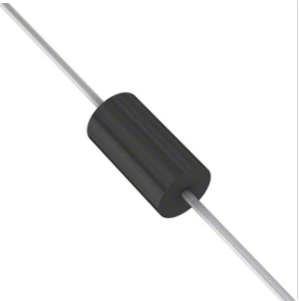

    直流反向耐压(Vr):1kV 平均整流电流(Io):3A 正向压降(Vf):1.2V@3A 反向电流(Ir):5uA@1kV
1N5408 数据手册
1N5400~1N5408 HIGH CURRENT PLASTIC SILICON RECTIFIER VOLTAGE FEATURES • Plastic package has Underwriters Laboratories Flammability Classification 94V-O utilizing Flame Retardant Epoxy Molding Compound. • High current capability • Low leakage • Exceeds environmental standards of MIL-S-19500/228 • In compliance with EU RoHS 2002/95/EC directives .375(9.5) 1.0(25.4)MIN. .052(1.3) .048(1.2) 50 to 1000 Volts CURRENT 3.0 Ampere DO-201AD Unit: inch(mm) MECHANICALDATA • Case: DO-201AD Molded plastic • Lead: Axial leads, solderable per MIL-STD-750,Method 2026 guaranteed • Polarity: Color band denotes cathode end • Mounting Position: Any • Weight: 0.04 ounces, 1.1 gram .285(7.2) MAXIMUM RATINGS AND ELECTRICAL CHARACTERISTICS Ratings at 25°C ambient temperature unless otherwise specified. Single phase, half wave, 60 Hz, resistive or inductive load. For capacitive load,derate current by 20%. PAR AME T E R M a xi m um R e c ur r e nt P e a k R e ve r s e V o l t a g e M a xi m um R M S V o l t a g e M a xi m um D C B l o c k i ng V o l t a g e M a xi m um A ve r a g e F o r w a r d C ur r e nt . 3 7 5 " ( 9 . 5 m m ) l e a d l e ng t h a t TA = 5 5 O C P e a k F o r w a r d S ur g e C ur r e nt : 8 . 3 m s s i ng l e ha l f s i ne - w a ve s up e r i m p o s e d o n r a t e d l o a d ( J E D E C m e t ho d ) M a xi m um F o r w a r d V o l t a g e a t 3 . 0 A M a xi m um D C R e ve r s e C ur r e nt a t TJ = 2 5 O C R a t e d D C B l o c k i ng Vo l t a g e TJ = 1 0 0 O C Ty p i c a l J u n c t i o n c a p a c i t a n c e ( N o t e 1 ) Ty p i c a l T h e r m a l R e s i s t a n c e ( N o t e 2 ) O p e r a t i n g J u n c t i o n a n d S t o r a g e Te m p e r a t u r e R a n g e S YM B OL 1 N 5 4 0 0 1 N 5 4 0 1 1 N 5 4 0 2 1 N 5 4 0 3 1 N 5 4 0 4 1 N 5 4 0 5 1 N 5 4 0 6 1 N 5 4 0 7 1 N 5 4 0 8 U N IT S VRRM VRMS VD C IF ( A V ) IF S M VF IR CJ RθJ A TJ , TS T G 50 35 50 100 70 100 200 140 200 300 210 300 400 280 400 3 .0 200 1 .2 5 .0 1000 30 20 - 5 5 TO + 1 5 0 O 1.0(25.4)MIN. .210(5.3) .188(4.8) 500 350 500 600 420 600 800 560 800 1000 700 1000 V V V A A V uA pF C/W O C NOTES: 1. Measured at 1 MHz and applied reverse voltage of 4.0 VDC. 2. Thermal Resistance from Junction to Ambient and from junction to lead at 0.375”(9.5mm)lead length P.C.B.mounted. STAD-APR.09.2007 PAGE . 1 1N5400~1N5408 RATING AND CHARACTERISTIC CURVES A VERAGEFORWARDRECITIFIED CURRENTAMPERES 4 3 2 1 0 0 20 40 60 80 100 120 O PEAK FORWARD SURGE CURRENT, AMPERES 5 240 200 160 120 80 40 140 160 0 1 10 100 AMBIENT TEMPERAURE, C Fig.1- FORWARD CURRENT DERATING CURVE NO. OF CYCLE AT 60HZ Fig.2- MAXIMUM NON - REPETITIVE SURGE CURRENT INSTANTANEOUS REVERSE CURRENT, uA 100 100 TJ = 150 C O INSTANTANEOUS FORWARD CURRENT AMPERES 120 140 10 10 1.0 TJ = 100 C O 1.0 TJ = 25 C O 0.1 0.1 0.01 20 40 60 80 100 0 .01 0.5 0.7 0.9 1.1 1.3 1.5 1.7 PERCENTAGE OF PEAK REVERSE VOLTAGE,% INSTANTANEOUS FORWARD VOLTAGE, VOLTS Fig.3- TYPICAL REVERSE CHARACTERISTIC Fig.4- TYPICAL INSTANTANEOUS FORWARD CHARACTERISTIC 100 CAPACITANCE, pF 10 1 .1 1 10 100 REVERSE VOLTAGE, VOLTS Fig.5- TYPICAL JUNCTION CAPACITANCE STAD-APR.09.2007 PAGE . 2
