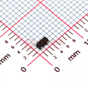

DATA SHEET BAV70 SURFACE MOUNT SWITCHING DIODES VOLTAGE FEATURES • Surface mount package Ideally Suited for Automatic insertion .056(1.40) .119(3.00) .110(2.80) 75 Volts POW ER 250mWatts SOT- 23 Unit: inch (mm) • Electrically Identical to Standard JEDEC • High Conductance • Pb free product are available : 99% Sn above can meet Rohs environment substance directive request .047(1.20) .007(.20)MIN • Fast sw itching speed. .103(2.60) .083(2.10) .066(1.70) .006(.15) .002(.05) MECHANICAL DATA .044(1.10) Cas e: SOT- 23, Plas tic Ter minals : Solder able per MIL- STD- 202G, Method 208 A ppr ox . Weight: 0.008 gram Mar king Code: JA .006(.15)MAX .020(.50) .013(.35) MAXIMUM RATINGS AND ELECTRICAL CHARACTERISTICS Ratings at 25OC ambient temperature unless otherwise specified. For capacitive load, derate current by 20%. PARAMETER Reverse Voltage Peak Reverse Voltage Recti fi ed C urrent (Average), Half Wave Recti fi cati on wi th Resi sti ve Load and f >=50 Hz Peak Forward Surge C urrent,1.0us Power D i ssi pati on D erate Above 25O C SYMBOL VR VRM IO IFSM PTOT BAV70 75 100 150 2.0 250 0.715 @ IF=0.001A 0.855 @ IF=0.01A 1.0 @ IF=0.05A 1.25 @ IF=0.15A 0.03 2.5 1.5 4.0 625 -55 TO +150 .035(0.90) .086(2.20) UNITS V V mA A mW Maxi mum Forward Voltage Maxi mum D C Reverse C urrent at 25V 75V Maxi mum Juncti on C apaci tance( Notes 1) Maxi mum Reverse Recovery Ti me (Notes 2) Maxi mum Thermal Resi stance Juncti on Temperature Range VF V IR CJ TRR RθJA TJ µA pF ns O C/W O C COMMON CATHODE NOTE: 1. CJ at VR=0, f=1MHZ 2.From IF=10mA to IR=1mA, VR=6Volts, RL=100Ω STAD-JAN.06.2004JAN.06.2005 PAGE . 1 1000 10 TJ =125 OC FORWARD CURRENT, mA 100 REVERSE CURRENT, u A 1.0 10 0.1 TJ =75 OC 1 0.01 TJ =25 OC 0.1 0.2 0 . 00 1 0.4 0.6 0.8 1.0 1.2 1.4 0 20 40 60 80 100 FORWARD VOLTAGE, Volts REVERSE VOLTAGE, Volts FIG. 1-TYPICAL FORWARD CHARACTERISTIC FIG. 2-TYPICAL REVERSE CHARACTERISTICS 3.0 P D , POWER DISSIPATION (mW) 0 2 4 6 8 DIODE CAPACIT ANCE, pF 4.0 400 300 2.0 200 1.0 100 0 0 50 100 150 200 REVERSE VOLTAGE, Volts AMBIENT TEMPERATURE( OC) FIG. 4 POWER DERATING CURVE FIG. 3 TYPICAL JUNCTION CAPACITANCE STAD-JAN.06.2004AN.06.2005 PAGE . 2 MOUNTING PAD LAYOUT SOT-23 Unit: inch (mm) 0.035(0.9) 0.031(0.8) 0.037(0.95) ORDER INFORMATION • Packing information T/R - 12K per 13" plastic Reel T/R - 3.0K per 7" plastic Reel LEGAL STATEMENT IMPORTANT NOTICE This information is intended to unambiguously characterize the product in order to facilitate the customer's evaluation of the device in the application. The information will help the customer's technical experts determine that the device is compatible and interchangeable with similar devices made by other vendors. The information in this data sheet is believed to be reliable and accurate. The specifications and information herein are subject to change without notice. New products and improvements in products and product characterization are constantly in process. Therefore, the factory should be consulted for the most recent information and for any special characteristics not described or specified. Copyright Pan Jit International Inc. 2003 All rights reserved. Reproduction in whole or in part is prohibited without the prior written consent of the copyright owner. The information presented in this document does not form part of any quotation or contract. The information presented is believed to be accurate and reliable, and may change without notice in advance. No liability will be accepted by the publisher for any consequence of use.Publication thereof does not convey nor imply any license under patent or other industrial or intellectual property rights. STAD-NOV.10.2004 0.078(2.0) PAGE . 3 3

### 物料型号 - 型号:BAV70
### 器件简介 - 描述:BAV70是一款表面贴装开关二极管,具有75V的反向电压和250mW的功率。它具有快速开关速度,适合自动插入安装,并且与标准JEDEC电气相同。
### 引脚分配 - 封装:SOT-23,塑料封装。 - 引脚:可焊性符合MIL-STD-202G, 方法208。
### 参数特性 - 反向电压(VR):75V - 峰值反向电压(VRM):100V - 整流电流(平均值),半波整流与电阻负载且f>=50 Hz(Io):150mA - 峰值正向浪涌电流,1.0us(IFSM):2.0A - 功率耗散,25°C以上降额(PTOT):250mW - 最大正向电压(VF):0.715V @ IF=0.001A,0.855V @ IF=0.01A,1.0V @ IF=0.05A,1.25V @ IF=0.15A - 最大直流反向电流在25V 75V(IR):0.03uA,2.5uA - 最大结电容(CJ):1.5pF - 最大反向恢复时间(TRR):4.0ns - 最大热阻(ROJA):625°C/W - 结温范围(TJ):-55至+150℃
### 功能详解 - 特点:快速开关速度,表面贴装封装,适合自动插入,与标准JEDEC电气相同,高导电性,无铅产品可满足RoHS环境物质指令要求。
### 应用信息 - 应用:适用于需要快速开关和高导电性的场合,如电源整流、信号处理等。
### 封装信息 - 封装类型:SOT-23 - 重量:约0.008克 - 标记代码:JA
