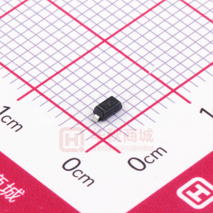

BZT52-B2V4 SERIES SURFACE MOUNT SILICON ZENER DIODES VOLTAGE 2.4 to 75 Volts POWER 410 mWatts SOD-123 Unit: inch (mm) FEATURES • Planar Die construction • 410mW Power Dissipation • Zener Voltages from 2.4~75V • Ideally Suited for Automated Assembly Processes • In compliance with EU RoHS 2002/95/EC directives .028(0.7) .019(0.5) .154(3.90) .141(3.60) .110(2.8) .098(2.5) • Case: SOD-123, Molded Plastic • Terminals: Solderable per MIL-STD-750, Method 2026 • Polarity: See Diagram Below • Approx. Weight: 0.01 grams • Mounting Position: Any .008(.20)MAX .005(.12)MAX .016(.40)MIN MAXIMUM RATINGS AND ELECTRICAL CHARACTERISTICS Parameter Maximum Power Dissipation (Notes A) at 25OC Operating Junction and StorageTemperature Range Symbol Value 410 -55 to +150 Units mW O PD TJ NOTES: A. Mounted on 5.0mm2(.013mm thick) land areas. REV.0.2-OCT.1.2009 .053(1.35) .037(0.95) MECHANICAL DATA .071(1.8) .055(1.4) C PAGE . 1 BZT52-B2V4 SERIES Nominal Zener Voltage Part Number Nom. V 410 mWatts Zener Diodes BZT52-B2V4 BZT52-B2V7 BZT52-B3 BZT52-B3V3 BZT52-B3V6 BZT52-B3V9 BZT52-B4V3 BZT52-B4V7 BZT52-B5V1 BZT52-B5V6 BZT52-B6V2 BZT52-B6V8 BZT52-B7V5 BZT52-B8V2 BZT52-B8V7 BZT52-B9V1 BZT52-B10 BZT52-B11 BZT52-B12 BZT52-B13 BZT52-B14 BZT52-B15 BZT52-B16 BZT52-B17 BZT52-B18 BZT52-B20 BZT52-B22 BZT52-B24 BZT52-B27 BZT52-B28 BZT52-B30 BZT52-B33 BZT52-B36 BZT52-B39 BZT52-B43 BZT52-B47 BZT52-B51 BZT52-B56 BZT52-B62 BZT52-B68 BZT52-B75 2.4 2.7 3.0 3.3 3.6 3.9 4.3 4.7 5.1 5.6 6.2 6.8 7.5 8.2 8.7 9.1 10 11 12 13 14 15 16 17 18 20 22 24 27 28 30 33 36 39 43 47 51 56 62 68 75 2.35 2.64 2.94 3.23 3.52 3.82 4.21 4.61 5.00 5.49 6.08 6.66 7.35 8.04 8.53 8.92 9.80 10.78 11.76 12.74 13.72 14.70 15.68 16.66 17.64 19.60 21.56 23.52 26.46 27.44 29.40 32.34 35.28 38.22 42.14 46.06 49.98 54.88 60.76 66.64 73.50 2.45 2.75 3.06 3.37 3.67 3.98 4.39 4.79 5.20 5.71 6.32 6.94 7.65 8.36 8.87 9.28 10.20 11.22 12.24 13.26 14.28 15.30 16.32 17.34 18.36 20.40 22.44 24.48 27.54 28.56 30.60 33.66 36.72 39.78 43.86 47.94 52.02 57.12 63.24 69.36 76.50 85 83 95 95 95 95 95 78 60 40 10 8 7 7 7 10 15 20 20 25 25 30 40 40 50 50 55 80 80 80 80 80 90 90 100 100 100 135 150 200 250 5.0 5.0 5.0 5.0 5.0 5.0 5.0 5.0 5.0 5.0 5.0 5.0 5.0 5.0 5.0 5.0 5.0 5.0 5.0 5.0 5.0 5.0 5.0 5.0 5.0 5.0 5.0 5.0 5.0 5.0 5.0 5.0 5.0 5.0 5.0 5.0 5.0 2.5 2.5 2.5 2.5 600 600 600 600 600 600 600 500 480 400 150 80 80 80 100 100 150 150 150 170 170 200 200 200 225 225 250 250 300 300 300 325 350 350 375 375 400 1000 1000 1000 1000 1.00 1.00 1.00 1.00 1.00 1.00 1.00 1.00 1.00 1.00 1.00 1.00 1.00 1.00 1.00 1.00 1.00 1.00 1.00 1.00 1.00 1.00 1.00 1.00 1.00 1.00 1.00 1.00 1.00 1.00 1.00 1.00 1.00 1.00 1.00 1.00 1.00 1.00 1.00 1.00 1.00 100 75 50 25 15 10 5.0 5.0 0.1 0.1 0.1 0.1 0.1 0.1 0.1 0.1 0.1 0.1 0.1 0.1 0.1 0.1 0.1 0.1 0.1 0.1 0.1 0.1 0.1 0.1 0.1 0.1 0.1 0.1 0.1 0.1 0.1 0.1 0.1 0.1 0.1 1.0 1.0 1.0 1.0 1.0 1.0 1.0 1.0 0.8 1.0 2.0 3.0 5.0 6.0 6.5 7.0 7.5 8.5 9.0 10.0 10.5 11.0 12.0 13.0 14.0 15.0 17.0 18.0 20.0 22.0 22.5 25.0 27.0 29.0 32.0 35.0 38.0 42.0 46.0 51.0 56.0 W1 W2 W3 W4 W5 W6 W7 W8 W9 WA WB WC WD WE 87C WF WG WH WI WK WJ WL WM 17C WN WO WP WR WS 28C WT WU WW WX WY WZ XA X2 X3 X4 X5 VZ @ IZT Min. V Max. V Ω Max. Zener Impedance ZZT @ IZT mA Ω ZZK @ IZK mA μA Max Reverse Leakage Current IR @ VR V Marking C ode REV.0.2-OCT.1.2009 PAGE . 2 BZT52-B2V4 SERIES TEMPERATURE COEFFICIENT,(mV/ OC) 0.6 100 POWER DISSIPATION, Watts 0.5 0.4 0.3 0.2 0.1 0 T A =25 OC 10 0 25 50 75 100 125 150 1 10 100 TEMPERATURE ( OC) NOMINAL ZENER VOLTAGE,VOLTS Fig.1 STEADY STATE POWER DERATING Fig.2 TEMPERATURE COEFFICENTS 1000 1000 FORWARD CURRENT,mA LEAKAGE CURRENT,uA 100 10 1 0.1 0.01 0.001 0.0001 0.00001 0 10 20 30 40 50 60 70 100 +150 C O +25 C -55 C 80 90 O O 10 150OC 75 C O 25OC 5C O 1 0.4 0.5 0.6 0.7 0.8 0.9 1.0 1.1 1.2 NORMAL ZENER VOLTAGE, VOLTS FORWARD VOLTAGE, VOLTS Fig.3 TYPICAL LEAKAGE CURRENT Fig.4 TYPICAL FORWARD VOLTAGE REV.0.2-OCT.1.2009 PAGE . 3 BZT52-B2V4 SERIES MOUNTING PAD LAYOUT ORDER INFORMATION • Packing information T/R - 10K per 13" plastic Reel T/R - 3K per 7" plastic Reel LEGAL STATEMENT Copyright PanJit International, Inc 2008 The information presented in this document is believed to be accurate and reliable. The specifications and information herein are subject to change without notice. Pan Jit makes no warranty, representation or guarantee regarding the suitability of its products for any particular purpose. Pan Jit products are not authorized for use in life support devices or systems. Pan Jit does not convey any license under its patent rights or rights of others. REV.0.2-OCT.1.2009 PAGE . 4
