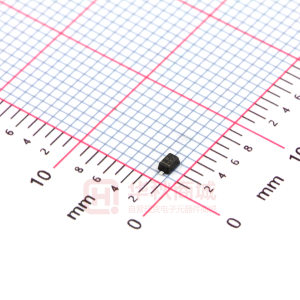

BZT52-B6V8S 数据手册
BZT52-B2V4S SERIES SURFACE MOUNT SILICON ZENER DIODES VOLTAGE 2.4 to 75 Volts POWER 200 mWatts SOD-323 Unit: inch (mm) FEATURES • Planar Die construction .054(1.35) .045(1.15) .078(1.95) .068(1.75) .014(.35) .009(.25) • 200mW Power Dissipation • Zener Voltages from 2.4~75V • Ideally Suited for Automated Assembly Processes • In compliance with EU RoHS 2002/95/EC directives .038(.95) .027(.70) .006(.15) MECHANICAL DATA • Case: SOD-323, Molded Plastic • Terminals: Solderable per MIL-STD-750, Method 2026 • Polarity: See Diagram Below • Approx. Weight: 0.0041 grams • Mounting Position: Any .107(2.7) .090(2.3) .012(.30)MIN. MAXIMUM RATINGS AND ELECTRICAL CHARACTERISTICS Parameter Power Dissipation @TA=25oC(Note A) Operating Junction and Storage Temperature Range Symbol PD TJ Value 200 -55 to +150 .002(.05) Units mW O C NOTES: A. Mounted on 5.0mm2(.013mm thick) land areas. REV.0.2-FEB.23.2010 PAGE . 1 BZT52-B2V4S SERIES Nominal Zener Voltage Part Number Nom. V 200 mWatts Zener Diodes BZT52-B2V4S BZT52-B2V7S BZT52-B3S BZT52-B3V3S BZT52-B3V6S BZT52-B3V9S BZT52-B4V3S BZT52-B4V7S BZT52-B5V1S BZT52-B5V6S BZT52-B5V8S BZT52-B6V2S BZT52-B6V8S BZT52-B7V5S BZT52-B8V2S BZT52-B8V7S BZT52-B9V1S BZT52-B10S BZT52-B11S BZT52-B12S BZT52-B13S BZT52-B14S BZT52-B15S BZT52-B16S BZT52-B17S BZT52-B18S BZT52-B20S BZT52-B22S BZT52-B24S BZT52-B27S BZT52-B28S BZT52-B30S BZT52-B33S BZT52-B36S BZT52-B39S BZT52-B43S BZT52-B47S BZT52-B51S BZT52-B56S BZT52-B62S BZT52-B68S BZT52-B75S 2.4 2.7 3.0 3.3 3.6 3.9 4.3 4.7 5.1 5.6 5.8 6.2 6.8 7.5 8.2 8.7 9.1 10 11 12 13 14 15 16 17 18 20 22 24 27 28 30 33 36 39 43 47 51 56 62 68 75 2.35 2.64 2.94 3.23 3.52 3.82 4.21 4.61 5.00 5.49 5.68 6.08 6.66 7.35 8.04 8.53 8.92 9.80 10.78 11.76 12.74 13.72 14.70 15.68 16.66 17.64 19.60 21.56 23.52 26.46 27.44 29.40 32.34 35.28 38.22 42.14 46.06 49.98 54.88 60.76 66.64 73.50 2.45 2.75 3.06 3.37 3.67 3.98 4.39 4.79 5.20 5.71 5.92 6.32 6.94 7.65 8.36 8.87 9.28 10.20 11.22 12.24 13.26 14.28 15.30 16.32 17.34 18.36 20.40 22.44 24.48 27.54 28.56 30.60 33.66 36.72 39.78 43.86 47.94 52.02 57.12 63.24 69.36 76.50 85 83 95 95 95 95 95 78 60 40 30 10 8 7 7 7 10 15 20 20 25 25 30 40 40 50 50 55 80 80 80 80 80 90 90 100 100 100 135 150 200 250 5.0 5.0 5.0 5.0 5.0 5.0 5.0 5.0 5.0 5.0 5.0 5.0 5.0 5.0 5.0 5.0 5.0 5.0 5.0 5.0 5.0 5.0 5.0 5.0 5.0 5.0 5.0 5.0 5.0 5.0 5.0 5.0 5.0 5.0 5.0 5.0 5.0 5.0 2.5 2.5 2.5 2.5 600 600 600 600 600 600 600 500 480 400 300 150 80 80 80 100 100 150 150 150 170 170 200 200 200 225 225 250 250 300 300 300 325 350 350 375 375 400 1000 1000 1000 1000 1.00 1.00 1.00 1.00 1.00 1.00 1.00 1.00 1.00 1.00 1.00 1.00 1.00 1.00 1.00 1.00 1.00 1.00 1.00 1.00 1.00 1.00 1.00 1.00 1.00 1.00 1.00 1.00 1.00 1.00 1.00 1.00 1.00 1.00 1.00 1.00 1.00 1.00 1.00 1.00 1.00 1.00 100 75 50 25 15 10 5.0 5.0 0.1 0.1 0.1 0.1 0.1 0.1 0.1 0.1 0.1 0.1 0.1 0.1 0.1 0.1 0.1 0.1 0.1 0.1 0.1 0.1 0.1 0.1 0.1 0.1 0.1 0.1 0.1 0.1 0.1 0.1 0.1 0.1 0.1 0.1 1.0 1.0 1.0 1.0 1.0 1.0 1.0 1.0 0.8 1.0 1.5 2.0 3.0 5.0 6.0 6.5 7.0 7.5 8.5 9.0 10.0 10.5 11.0 12.0 13.0 14.0 15.0 17.0 18.0 20.0 22.0 22.5 25.0 27.0 29.0 32.0 35.0 38.0 42.0 46.0 51.0 56.0 W1 W2 W3 W4 W5 W6 W7 W8 W9 WA 85C WB WC WD WE 87C WF WG WH WI WK WJ WL WM 17C WN WO WP WR WS 28C WT WU WW WX WY WZ XA X2 X3 X4 X5 VZ @ IZT Min. V Max. V Ω Max. Zener Impedance ZZT @ IZT mA Ω ZZK @ IZK mA μA Max Reverse Leakage Current IR @ VR V Marking Code REV.0.2-FEB.23.2010 PAGE . 2 BZT52-B2V4S SERIES TEMPERATURE COEFFICIENT,(mV/ OC) 0.6 100 POWER DISSIPATION, Watts 0.5 0.4 0.3 0.2 0.1 0 10 0 25 50 75 100 125 150 1 10 100 TEMPERATURE ( OC) NOMINAL ZENER VOLTAGE,VOLTS Fig.1 STEADY STATE POWER DERATING Fig.2 TEMPERATURE COEFFICENTS 1000 1000 FORWARD CURRENT,mA LEAKAGE CURRENT,uA 100 10 1 0.1 0.01 0.001 0.0001 0.00001 0 10 20 30 40 50 60 70 100 +150 C O +25 C -55 C 80 90 O O 10 150OC 75 C O 25OC 5C O 1 0.4 0.5 0.6 0.7 0.8 0.9 1.0 1.1 1.2 NORMAL ZENER VOLTAGE, VOLTS FORWARD VOLTAGE, VOLTS Fig.3 TYPICAL LEAKAGE CURRENT Fig.4 TYPICAL FORWARD VOLTAGE REV.0.2-FEB.23.2010 PAGE . 3 BZT52-B2V4S SERIES MOUNTING PAD LAYOUT ORDER INFORMATION • Packing information T/R - 12K per 13" plastic Reel T/R - 5K per 7" plastic Reel LEGAL STATEMENT Copyright PanJit International, Inc 2010 The information presented in this document is believed to be accurate and reliable. The specifications and information herein are subject to change without notice. Pan Jit makes no warranty, representation or guarantee regarding the suitability of its products for any particular purpose. Pan Jit products are not authorized for use in life support devices or systems. Pan Jit does not convey any license under its patent rights or rights of others. REV.0.2-FEB.23.2010 PAGE . 4
