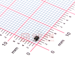

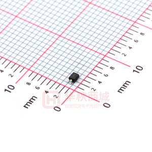

BZT52-C2V4S SERIES SURFACE MOUNT SILICON ZENER DIODES VOLTAGE 2.4 to 75 Volts POWER 200 mWatts SOD-323 Unit: inch (mm) FEATURES • Planar Die construction .054(1.35) .045(1.15) .078(1.95) .068(1.75) .009(.25) .014(.35) • 200mW Power Dissipation • Zener Voltages from 2.4~75V • Ideally Suited for Automated Assembly Processes • Pb free product : 99% Sn above can meet RoHS .038(.95) .027(.70) .006(.15) .107(2.7) .090(2.3) MECHANICAL DATA • Case: SOD-323, Molded Plastic • Terminals: Solderable per MIL-STD-750, Method 2026 • Polarity: See Diagram Below • Approx. Weight: 0.0041 grams • Mounting Position: Any .012(.30)MIN. MAXIMUM RATINGS AND ELECTRICAL CHARACTERISTICS Parameter Power Dissipation @ TA = 25O C(Note A) Operating Junction and StorageTemperature Range Symbol PD TJ Value 200 -55 to +150 Units .002(.05) environment substance diective request mW O C NOTE : A. Mounted on 5.0mm2(.013mm thick) land areas. STAD-DEC.22.2005 PAGE . 1 BZT52-C2V4S SERIES N ominal Zener Voltage Part N umber No m. V Max. Zener Impedance Z ZT @ I ZT Z ZK @ I ZK Ω mA Max R everse Leakage C urrent IR @ V R µA V V Z @ IZT M i n. V M a x. V Marking C ode W1 W2 W3 W4 W5 W6 W7 W8 W9 WA WB WC WD WE WF WG WH WI WK WJ WL WM 17C WN WO WP WR WS 28C WT WU WW WX WY WZ XA X2 X3 X4 X5 Pac kag e Ω mA BZT52-C 2V4S BZT52-C 2V7S BZT52-C 3S BZT52-C 3V3S BZT52-C 3V6S BZT52-C 3V9S BZT52-C 4V3S BZT52-C 4V7S BZT52-C 5V1S BZT52-C 5V6S BZT52-C 6V2S BZT52-C 6V8S BZT52-C 7V5S BZT52-C 8V2S BZT52-C 9V1S BZT52-C 10S BZT52-C 11S BZT52-C 12S BZT52-C 13S BZT52-C 14S BZT52-C 15S BZT52-C 16S BZT52-C 17S BZT52-C 18S BZT52-C 20S BZT52-C 22S BZT52-C 24S BZT52-C 27S BZT52-C 28S BZT52-C 30S BZT52-C 33S BZT52-C 36S BZT52-C 39S BZT52-C 43S BZT52-C 47S BZT52-C 51S BZT52-C 56S BZT52-C 62S BZT52-C 68S BZT52-C 75S 2.4 2.7 3.0 3.3 3.6 3.9 4.3 4.7 5.1 5.6 6.2 6.8 7.5 8.2 9.1 10 11 12 13 14 15 16 17 18 20 22 24 27 28 30 33 36 39 43 47 51 56 62 68 75 2.28 2.57 2.85 3.14 3.42 3.71 4.09 4.47 4.85 5.32 5.89 6.46 7.13 7.79 8.65 9.50 10.45 11.40 12.35 13.30 14.25 15.20 16.15 17.10 19.00 20.90 22.80 25.65 26.60 28.50 31.35 34.20 37.05 40.85 44.65 48.45 53.20 58.90 64.60 71.25 2.52 2.84 3.15 3.47 3.78 4.10 4.52 4.94 5.36 5.88 6.51 7.14 7.88 8.61 9.56 10.50 11.55 12.60 13.65 14.70 15.75 16.80 17.85 18.90 21.00 23.10 25.20 28.35 29.40 31.50 34.65 37.80 40.95 45.15 49.35 53.55 58.80 65.10 71.40 78.75 85 83 95 95 95 95 95 78 60 40 10 8 7 7 10 15 20 20 25 25 30 40 40 50 50 55 80 80 80 80 80 90 90 100 100 100 135 150 200 250 5.0 5.0 5.0 5.0 5.0 5.0 5.0 5.0 5.0 5.0 5.0 5.0 5.0 5.0 5.0 5.0 5.0 5.0 5.0 5.0 5.0 5.0 5.0 5.0 5.0 5.0 5.0 5.0 5.0 5.0 5.0 5.0 5.0 5.0 5.0 5.0 5.0 5.0 5.0 5.0 600 600 600 600 600 600 600 500 480 400 150 80 80 80 100 150 150 150 170 170 200 200 200 225 225 250 250 300 300 300 325 350 350 700 750 750 1000 1000 1000 1000 1.00 1.00 1.00 1.00 1.00 1.00 1.00 1.00 1.00 1.00 1.00 1.00 1.00 1.00 1.00 1.00 1.00 1.00 1.00 1.00 1.00 1.00 1.00 1.00 1.00 1.00 1.00 1.00 1.00 1.00 1.00 1.00 1.00 1.00 1.00 1.00 1.00 1.00 1.00 1.00 100 75 50 25 15 10 5.0 5.0 0.1 0.1 0.1 0.1 0.1 0.1 0.1 0.1 0.1 0.1 0.1 0.1 0.1 0.1 0.1 0.1 0.1 0.1 0.1 0.1 0.1 0.1 0.1 0.1 0.1 0.1 0.1 0.1 0.1 0.1 0.1 0.1 1.0 1.0 1.0 1.0 1.0 1.0 1.0 2.0 0.8 1.0 2.0 3.0 5.0 6.0 7.0 7.5 8.5 9.0 10.0 10.5 11.0 12.0 13.0 14.0 15.0 17.0 18.0 20.0 22.0 22.5 25.0 27.0 29.0 32.0 35.0 38.0 42 46 51 56 SOD -323 SOD -323 SOD -323 SOD -323 SOD -323 SOD -323 SOD -323 SOD -323 SOD -323 SOD -323 SOD -323 SOD -323 SOD -323 SOD -323 SOD -323 SOD -323 SOD -323 SOD -323 SOD -323 SOD -323 SOD -323 SOD -323 SOD -323 SOD -323 SOD -323 SOD -323 SOD -323 SOD -323 SOD -323 SOD -323 SOD -323 SOD -323 SOD -323 SOD -323 SOD -323 SOD -323 SOD -323 SOD -323 SOD -323 SOD -323 STAD-DEC.22.2005 PAGE . 2 BZT52-C2V4S SERIES TEMPERATURE COEFFICIENT,(mA/ OC) 100 0.6 POWER DISSIPATION, Watts 0.5 0.4 0.3 10 0.2 0.1 0 0 25 50 75 100 125 150 1 10 100 TEMPERATURE ( OC) NOMINAL ZENER VOLTAGE,VOLTS Fig.1 STEADY STATE POWER DERATING Fig.2 TEMPERATURE COEFFICENTS 1000 1000 LEAKAGE CURRENT,uA 10 1 0.1 0.01 0.001 0.0001 0.00001 0 10 20 30 40 50 60 70 FORWARD CURRENT,mA 100 100 +150 C O +25 C -55 C 80 90 O O 10 150OC 75OC 25OC 5OC 1 0.4 0.5 0.6 0.7 0.8 0.9 1.0 1.1 1.2 NORMAL ZENER VOLTAGE, VOLTS FORWARD VOLTAGE, VOLTS Fig.3 TYPICAL LEAKAGE CURRENT Fig.4 TYPICAL FORWARD VOLTAGE STAD-DEC.22.2005 PAGE . 3 BZT52-C2V4S SERIES MOUNTING PAD LAYOUT ORDER INFORMATION • Packing information T/R - 12K per 13" plastic Reel T/R - 5K per 7" plastic Reel LEGAL STATEMENT Copyright PanJit International, Inc 2005 The information presented in this document is believed to be accurate and reliable. The specifications and information herein are subject to change without notice. Pan Jit makes no warranty, representation or guarantee regarding the suitability of its products for any particular purpose. Pan Jit products are not authorized for use in life support devices or systems. Pan Jit does not convey any license under its patent rights or rights of others. STAD-DEC.22.2005 PAGE . 4

1. 物料型号: - 系列名称:BZT52-C2V4S - 型号包括:BZT52-C2V4S、BZT52-C2V7S、BZT52-C3S、BZT52-C3V3S、BZT52-C3V6S、BZT52-C4V3S、BZT52-C5V1S、BZT52-C5V6S、BZT52-C6V2S、BZT52-C6V8S、BZT52-C7V5S、BZT52-C8V2S、BZT52-C9V1S、BZT52-C10S、BZT52-C11S、BZT52-C12S、BZT52-C13S、BZT52-C14S、BZT52-C15S、BZT52-C16S、BZT52-C17S、BZT52-C18S、BZT52-C20S、BZT52-C22S、BZT52-C24S、BZT52-C27S、BZT52-C28S、BZT52-C30S、BZT52-C33S、BZT52-C36S、BZT52-C39S、BZT52-C43S、BZT52-C47S、BZT52-C51S、BZT52-C56S、BZT52-C62S、BZT52-C68S、BZT52-C75S等。
2. 器件简介: - 表面安装硅齐纳二极管,电压范围2.4至75伏特,功率200毫瓦。
3. 引脚分配: - 封装类型:SOD-323,塑封塑料。 - 引脚可焊性符合MIL-STD-750方法2026。 - 极性:见下图。
4. 参数特性: - 最大额定值和电气特性包括工作功率200毫瓦,齐纳电压从2.4V至75V,最大反向漏电流等。
5. 功能详解: - 器件采用平面芯片结构,适用于自动化装配过程,无铅产品,符合RoHS环保要求。
6. 应用信息: - 器件适用于需要表面安装和特定电压稳定的场景。
7. 封装信息: - 封装类型:SOD-323,塑封塑料。 - 重量约为0.0041克,可安装在任何位置。
