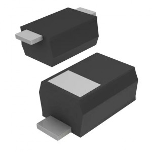

BZT52-C2V4 SERIES SURFACE MOUNT SILICON ZENER DIODES VOLTAGE 2.4 to 75 Volts POWER 500 mWatts SOD-123 Unit: inch (mm) FEATURES • Planar Die construction • 500mW Power Dissipation • Zener Voltages from 2.4~75V • Ideally Suited for Automated Assembly Processes • Pb free product : 99% Sn above can meet RoHS environment substance diective request .008(.20)MAX .053(1.35) .037(0.95) .016(.40)MIN .154(3.90) .141(3.60) .110(2.8) .098(2.5) MECHANICAL DATA • Case: SOD-123, Molded Plastic • Terminals: Solderable per MIL-STD-750, Method 2026 • Polarity: See Diagram Below • Approx. Weight: 0.01 grams • Mounting Position: Any .005(.12)MAX MAXIMUM RATINGS AND ELECTRICAL CHARACTERISTICS Parameter Maximum Forward Voltage Drop at IF=100mA Maximum Power Dissipation (Notes A) at 25OC Peak Forward Surge Current, 8.3ms single half sine-wave superimposed on rated load (JEDEC method) (Notes B) Operating Junction and StorageTemperature Range Symbol VF .028(0.7) .019(0.5) Value 1.0 500 4.0 -50 to +150 Units V mW Amps O PD IFSM TJ C NOTES: A. Mounted on 5.0mm 2(.013mm thick) land areas. B. Measured on 8.3ms, single half sine-wave or equivalent square wave, duty cycle = 4 pulses per minute maximum. V010-DEC.29.2005 .071(1.8) .055(1.4) PAGE . 1 BZT52-C2V4 SERIES N ominal Zener Voltage Part N umber No m. V Max. Zener Impedance Z ZT @ I ZT Z ZK @ I ZK Ω mA Max R everse Leakage C urrent IR @ V R µA V V Z @ IZT M i n. V M a x. V Marking C ode W1 W2 W3 W4 W5 W6 W7 W8 W9 WA WB WC WD WE WF WG WH WI WK WJ WL WM 17C WN WO WP WR WS 28C WT WU WW WX WY WZ XA X2 X3 X4 X5 Pac k ag e Ω mA BZT52-C 2V4 BZT52-C 2V7 BZT52-C 3 BZT52-C 3V3 BZT52-C 3V6 BZT52-C 3V9 BZT52-C 4V3 BZT52-C 4V7 BZT52-C 5V1 BZT52-C 5V6 BZT52-C 6V2 BZT52-C 6V8 BZT52-C 7V5 BZT52-C 8V2 BZT52-C 9V1 BZT52-C 10 BZT52-C 11 BZT52-C 12 BZT52-C 13 BZT52-C 14 BZT52-C 15 BZT52-C 16 BZT52-C 17 BZT52-C 18 BZT52-C 20 BZT52-C 22 BZT52-C 24 BZT52-C 27 BZT52-C 28 BZT52-C 30 BZT52-C 33 BZT52-C 36 BZT52-C 39 BZT52-C 43 BZT52-C 47 BZT52-C 51 BZT52-C 56 BZT52-C 62 BZT52-C 68 BZT52-C 75 2.4 2.7 3.0 3.3 3.6 3.9 4.3 4.7 5.1 5.6 6.2 6.8 7.5 8.2 9.1 10 11 12 13 14 15 16 17 18 20 22 24 27 28 30 33 36 39 43 47 51 56 62 68 75 2.28 2.57 2.85 3.14 3.42 3.71 4.09 4.47 4.85 5.32 5.89 6.46 7.13 7.79 8.65 9.50 10.45 11.40 12.35 13.30 14.25 15.20 16.15 17.10 19.00 20.90 22.80 25.65 26.60 28.50 31.35 34.20 37.05 40.85 44.65 48.45 53.20 58.90 64.60 71.25 2.52 2.84 3.15 3.47 3.78 4.10 4.52 4.94 5.36 5.88 6.51 7.14 7.88 8.61 9.56 10.50 11.55 12.60 13.65 14.70 15.75 16.80 17.85 18.90 21.00 23.10 25.20 28.35 29.40 31.50 34.65 37.80 40.95 45.15 49.35 53.55 58.80 65.10 71.40 78.75 85 83 95 95 95 95 95 78 60 40 10 8 7 7 10 15 20 20 25 25 30 40 40 50 50 55 80 80 80 80 80 90 90 100 100 100 135 150 200 250 5.0 5.0 5.0 5.0 5.0 5.0 5.0 5.0 5.0 5.0 5.0 5.0 5.0 5.0 5.0 5.0 5.0 5.0 5.0 5.0 5.0 5.0 5.0 5.0 5.0 5.0 5.0 5.0 5.0 5.0 5.0 5.0 5.0 5.0 5.0 5.0 2.5 2.5 2.5 2.5 600 600 600 600 600 600 600 500 480 400 150 80 80 80 100 150 150 150 170 170 200 200 200 225 225 250 250 300 300 300 325 350 350 700 750 750 1000 1000 1000 1000 1.00 1.00 1.00 1.00 1.00 1.00 1.00 1.00 1.00 1.00 1.00 1.00 1.00 1.00 1.00 1.00 1.00 1.00 1.00 1.00 1.00 1.00 1.00 1.00 1.00 1.00 1.00 1.00 1.00 1.00 1.00 1.00 1.00 1.00 1.00 1.00 1.00 1.00 1.00 1.00 100 75 50 25 15 10 5.0 5.0 0.1 0.1 0.1 0.1 0.1 0.1 0.1 0.1 0.1 0.1 0.1 0.1 0.1 0.1 0.1 0.1 0.1 0.1 0.1 0.1 0.1 0.1 0.1 0.1 0.1 0.1 0.1 0.1 0.1 0.1 0.1 0.1 1.0 1.0 1.0 1.0 1.0 1.0 1.0 2.0 0.8 1.0 2.0 3.0 5.0 6.0 7.0 7.5 8.5 9.0 10.0 10.5 11.0 12.0 13.0 14.0 15.0 17.0 18.0 20.0 22.0 22.5 25.0 27.0 29.0 32.0 35.0 38.0 42.0 46.0 51.0 56 SOD -123 SOD -123 SOD -123 SOD -123 SOD -123 SOD -123 SOD -123 SOD -123 SOD -123 SOD -123 SOD -123 SOD -123 SOD -123 SOD -123 SOD -123 SOD -123 SOD -123 SOD -123 SOD -123 SOD -123 SOD -123 SOD -123 SOD -123 SOD -123 SOD -123 SOD -123 SOD -123 SOD -123 SOD -123 SOD -123 SOD -123 SOD -123 SOD -123 SOD -123 SOD -123 SOD -123 SOD -123 SOD -123 SOD -123 SOD -123 V010-DEC.29.2005 PAGE . 2 BZT52-C2V4 SERIES TEMPERATURE COEFFICIENT,(mA/ OC) 8 7 6 5 4 3 2 1 TEMPERATURE COEFFICIENT,(mA/ OC) 100 10 0 -1 -2 -3 2 3 4 5 6 7 8 9 10 11 12 1 10 100 NOMINAL ZENER VOLTAGE,VOLTS NOMINAL ZENER VOLTAGE,VOLTS Fig.1 TEMPERATURE COEFFICENTS Fig.2 TEMPERATURE COEFFICENTS 1000 DYNAMIC IMPEDANCE, W IZ = 1 mA FORWARD CURRENT,mA TJ=25 C IZ(AC)=0.1 IZ(DC) F=1 kHZ O 1000 100 5 mA 20 mA 100 10 10 150OC 75 C O 25OC 5OC 1 1 10 NORMAL ZENER VOLTAGE, VOLTS 100 1 0.4 0.5 0.6 0.7 0.8 0.9 1.0 1.1 1.2 FORWARD VOLTAGE, VOLTS Fig.3 EFFECT OF ZENER VOLTAGE ON ZENER IMPEDANCE Fig.4 TYPICAL FORWARD VOLTAGE 1000 0.6 POWER DISSIPATION, Watts 0 V BIAS 1 V BIAS T A =25 C O TA=25 oC 0.5 0.4 0.3 0.2 0.1 0 CAPACITANCE,pF 100 BIASAT 50% OF VZ NOM 10 1 0 25 50 75 100 125 150 1 10 NORMAL ZENER VOLTAGE, VOLTS 100 TEMPERATURE ( O C) Fig.5 STEADY STATE POWER DERATING Fig.6 TYPICAL CAPACITANCE V010-DEC.29.2005 PAGE . 3 BZT52-C2V4 SERIES 10 -1 10 0 ZENER CURRENT, Amperes ZENER CURRENT, Amperes 10 -1 10 -2 10 -2 10 -3 10 -3 10 -4 10 -5 10 -4 10 -6 10 -7 10 -5 10 -8 0 2 4 6 8 10 12 10 15 20 25 30 35 40 45 ZENER VOLTAGE, VOLTS Fig.7 ZENER VOLTAGE VERSUS ZENER CURRENT ZENER VOLTAGE, VOLTS Fig.8 ZENER VOLTAGE VERSUS ZENER CURRENT 1000 LEAKAGE CURRENT,uA 100 10 1 0.1 0.01 0.001 0.0001 0.00001 0 10 20 30 40 50 60 70 +150 C O +25 C -55 C 80 90 O O NORMAL ZENER VOLTAGE, VOLTS Fig.9 TYPICAL LEAKAGE CURRENT V010-DEC.29.2005 PAGE . 4 BZT52-C2V4 SERIES MOUNTING PAD LAYOUT ORDER INFORMATION • Packing information T/R - 10K per 13" plastic Reel T/R - 3K per 7" plastic Reel LEGAL STATEMENT Copyright PanJit International, Inc 2005 The information presented in this document is believed to be accurate and reliable. The specifications and information herein are subject to change without notice. Pan Jit makes no warranty, representation or guarantee regarding the suitability of its products for any particular purpose. Pan Jit products are not authorized for use in life support devices or systems. Pan Jit does not convey any license under its patent rights or rights of others. V010-DEC.29.2005 PAGE . 5
