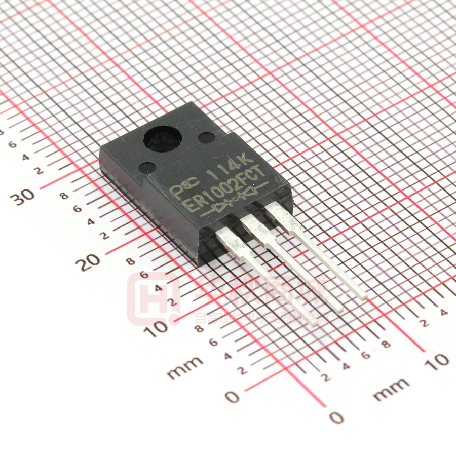

ER1000FCT~ER1006FCT
SUPERFAST RECOVERY RECTIFIERS
VOLTAGE
50 to 600 Volt
10 Ampere
CURRENT
FEATURES
• Plastic package has Underwriters Laboratory
Flammability Classification 94V-O.
Flame Retardant Epoxy Molding Compound.
• Low power loss, high efficiency.
• Low forward voltge, high current capability
• High surge capacity.
• Super fast recovery times, high voltage.
• Lead free in compliance with EU RoHS 2.0
• Green molding compound as per IEC 61249 standard
MECHANICAL DATA
• Case: ITO-220AB Molded plastic
• Terminals: Lead solderable per MIL-STD-750, Method 2026
• Polarity: As marked.
• Standard packaging: Any
• Weight: 0.056 ounces, 1.6 grams.
