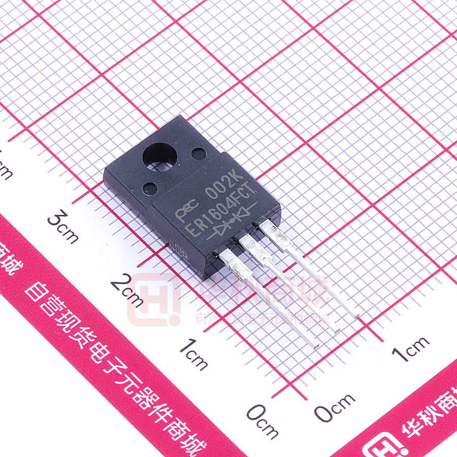

    快恢复二极管 VRRM=400V If=16A VF=1.3V CJ=62pF trr=35ns ITO220AB
ER1604FCT_TO_00001 数据手册
ER1600FCT~ER1606FCT ISOLATION SUPERFAST RECOVERY RECTIFIER VOLTAGE 50 to 600 Volt CURRENT 16 Ampere FEATURES • Plastic package has Underwriters Laboratory Flammability Classification 94V-O. Flame Retardant Epoxy Molding Compound. • Low power loss, high efficiency. • Low forward voltge, high current capability • High surge capacity. • Super fast recovery times, high voltage. • Epitaxial chip construction. • Lead free in compliance with EU RoHS 2011/65/EU directive • Green molding compound as per IEC61249 Std. . (Halogen Free) MECHANICAL DATA • Case: ITO-220AB Molded plastic • Terminals: Lead solderable per MIL-STD-750, Method 2026 • Polarity: As marked. • Standard packaging: Any • Weight: 0.056 ounces, 1.6 grams. MAXIMUM RATING AND ELECTRICAL CHARACTERISTICSS Ratings at 25°C ambient temperature unless otherwise specified. Single phase, half wave, 60 Hz, resistive or inductive load. For capacitive load, derate current by 20% PA RA M ET ER SY M BO L ER 1 6 0 0 FC T ER 1 6 0 1 FC T E R1 6 0 1 A FC T E R1 6 0 2 F CT E R1 6 0 3 F CT ER 1 6 04 F C T E R 1 60 6 F C T UNI TS M a ximum Re c ur r e nt P e a k Re ve r s e Vo lt a g e V RRM 50 10 0 150 200 300 400 600 V M a ximum RM S Vo lt a g e V RM S 35 70 10 5 140 210 280 420 V M a ximum DC Blo c k ing Vo lt a g e V DC 50 10 0 150 200 300 400 600 V M a ximum Ave r a g e Fo r w a r d Cur r e nt a t T C = 9 0 O C I F ( AV) 16 A P ea k Fo r w a r d Sur g e Cur r e nt , 8 . 3 ms s ing le half s ine w a ve s up e r imp o s e d o n r a t e d lo a d I F SM 125 A M a ximum Fo r w a r d Vo lt a g e a t 8 A VF M a ximum DC Re ve r s e Cur r e nt a t T J = 2 5 O C Ra t e d DC B lo c k ing Vo lt a g e T J = 1 0 0 O C IR 1 500 μA M a ximum Re ve r s e Re c o ve r y Time ( No t e 2 ) t rr 35 ns Ty p ic a l J unc t io n Ca p a c it a nc e ( No t e 1 ) CJ 62 pF R θJ C 3 T J, T STG -50 to +150 0.95 1.3 1.7 V O Ty p ic a l The r ma l Re s is t a nc e O p e r a t ing a nd St o r a ge Te mp e r a t ur e Ra ng e C / W O C NOTES : 1. Measured at 1 MHz and applied reverse voltage of 4 VDC. 2. Reverse Recovery Test Conditions: IF=0.5A, IR=1A, Irr=0.25A. 3. Both Bonding and Chip structure are available. October 13,2016-REV.09 PAGE . 1 ER1600FCT~ER1606FCT 40 INSTANTANEOUS FORWARD CURRENT AMPERES AVERAGE FORWARD CURRENT, AMPERES RATING AND CHARACTERISTIC CURVES 20 16 12 6 LEADLENGHTS RESISTIVEORINDUCTIVE LOAD 4 200V 300-400V 10 600V 1 O T J =25 C Pulse Width=300us 0 0 20 40 60 80 100 120 140 160 .1 .6 .8 1.0 1.2 1.4 1.6 1.8 2.0 O CASE TEMPERATURE, C INSTANTANEOUS FORWARD VOLTAGE, VOLTS Fig.2- TYPICAL INSTANTANEOUS FORWARD CHARACTERISTIC Fig.1- FORWARD CURRENT DERATING CURVE O TJ= 125 C 100 O TJ= 75 C 10 1.0 150 PEAK FORWARD SURGE CURRENT, INVSTANTANEOUS REVERSE CURRENT, MICROAMPERES 1000 125 8.3ms Single Half Since-Wave JEDEC Method 100 75 50 25 0 1 2 O TJ= 25 C 5 10 20 50 100 NO. OF CYCLE AT 60HZ Fig.4- MAXIMUM NON - REPETITIVE SURGE CURRENT 0.1 20 40 60 80 100 120 80 FIG.3 TYPICAL REVERSE CHARACTERISTICS CAPACITANCE, pF PERCENT OF RATED PEAK INVERSE VOLTGE, VOLTS 70 O TJ = 25 C 60 50 40 20 10 1 2 5 10 20 50 100 200 500 REVERSE VOLTAGE, VOLTS Fig.5- TYPICAL JUNCTION CAPACITANCE October 13,2016-REV.09 PAGE . 2 ER1600FCT~ER1606FCT Part No_packing code_Version ER1600FCT_T0_00001 For example : RB500V-40_R2_00001 Serial number Part No. Version code means HF Packing size code means 13" Packing type means T/R Packing Code XX Packing type Tape and Ammunition Box (T/B) Tape and Reel (T/R) Bulk Packing (B/P) Tube Packing (T/P) Tape and Reel (Right Oriented) (TRR) Tape and Reel (Left Oriented) (TRL) FORMING October 13,2016-REV.09 Version Code XXXXX 1st Code Packing size code A N/A 0 HF 0 serial number R 7" 1 RoHS 1 serial number B 13" 2 T 26mm X S 52mm Y L F PANASERT T/B CATHODE UP (PBCU) PANASERT T/B CATHODE DOWN (PBCD) 2nd Code HF or RoHS 1st Code 2nd~5th Code U D PAGE . 3 ER1600FCT~ER1606FCT Disclaimer • Reproducing and modifying information of the document is prohibited without permission from Panjit International Inc.. • Panjit International Inc. reserves the rights to make changes of the content herein the document anytime without notification. Please refer to our website for the latest document. • Panjit International Inc. disclaims any and all liability arising out of the application or use of any product including damages incidentally and consequentially occurred. • Panjit International Inc. does not assume any and all implied warranties, including warranties of fitness for particular purpose, non-infringement and merchantability. • Applications shown on the herein document are examples of standard use and operation. Customers are responsible in comprehending the suitable use in particular applications. Panjit International Inc. makes no representation or warranty that such applications will be suitable for the specified use without further testing or modification. • The products shown herein are not designed and authorized for equipments requiring high level of reliability or relating to human life and for any applications concerning life-saving or life-sustaining, such as medical instruments, transportation equipment, aerospace machinery et cetera. Customers using or selling these products for use in such applications do so at their own risk and agree to fully indemnify Panjit International Inc. for any damages resulting from such improper use or sale. • Since Panjit uses lot number as the tracking base, please provide the lot number for tracking when complaining. October 13,2016-REV.09 PAGE . 4
