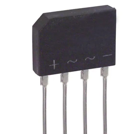

    PANJIT(强茂)
    DB-22X3.6MM_TM
    6A 5uA@1kV 175A 1kV 1.1V@6A -55℃~+150℃@(Tj) 玻璃钝化桥式整流器
GBU6M_B0_10001 数据手册
...GBU6G~GBU6M Glass Passivated Bridge Rectifiers VOLTAGE 400 to 1000 Volt CURRENT 6 Ampere GBU Unit: Inch(mm) FEATURES • UL Recognized File #E228882 • Plastic material has Underwriters Laboratory Flammability Classification 94V-O • Ideal for printed circuit board • Reliable low cost construction utilizing molded plastic technique. • Lead free in compliance with EU RoHS 2.0 • Glass passivated chip junction MECHANICAL DATA • Case: GBU •Terminals: Leads solderable per MIL-STD-750, Method 2026 • Polarity: As marked on body • Mounting torque: 5 inch-lbs. Max. • Weight: 4g MAXIMUM RATINGS AND ELECTRICAL CHARACTERISTICS Rating at 25°Cambient temperature unless otherwise specified. SYMBOL GBU 6G GBU 6J GBU 6K GBU 6M UNIT Maximum repetitive peak reverse voltage VRRM 400 600 800 1000 V Maximum RMS voltage VRMS 280 420 560 700 V Maximum DC blocking voltage VDC 400 600 800 1000 V Maximum average forward rectified current IF(AV) 6 A Peak forward surge current, 8.3 ms single half sine-wave IFSM 175 A It 2 127 As VF 1 1.1 V PARAMETER Rating of fusing ( t
