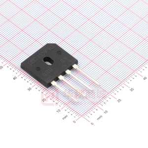

    GBU8K - GLASS PASSIVATED SINGLE-PHASE BRIDGE RECTIFIER - Pan Jit International Inc.
GBU8K 数据手册
DATA SHEET G BU8A thru GBU8K GLASS PASSIVATED SINGLE-PHASE BRIDGE RECTIFIER VOLTAGE 50 to 800 Volts POWER 8.0 Amperes GBU Unit: inch (mm) Recongized File #E111753 FEATURES • Plastic material has Underwriters Laboratory Flammability Classification 94V-O • Ideal for printed circuit board • Reliable low cost construction utilizing molded plastic technique • Pb free product are available : 99% Sn above can meet Rohs environment substance directive request .310(7.90) .290(7.40) .880(22.3) .860(21.8) .160(4.1) .140(3.5) .140(3.56) .130(3.30) .740(18.8) .720(18.3) .085(2.16) .065(1.65) .080(2.03) .060(1.52) MECHANICALDATA Case: Reliable low cost construction utilizing molded plastic technique Terminals: Leads solderable per MIL-STD-202G, Method 208 Mounting position: Any Mounting torque: 5 in. lb. Max. Weight: 0.15 ounce, 4.0 grams .190(4.83) .210(5.33) .100(2.54) .085(2.16) .080(2.03) .065(1.65) .075(1.90)R .710(18.0) .690(17.5) .040(1.02) .030(0.76) .030(0.75) .017(0.45) .050(1.27) .040(1.02) MAXIMUM RATINGS AND ELECTRICAL CHARACTERISTICS Rating at 25°Cambient temperature unless otherwise specified. Resistive or inductive load, 60Hz. For Capacitive load derate current by 20%. P A R A M E TE R M a xi um R e curre nt P e a k R e ve rse V o l a g e m t M a xi um R M S B ri g e I p ut V o l a g e m d n t M a xi um D C B l cki g V o l a g e m o n t M a xi um A ve ra g e F o rw a rd T C = 1 0 0 O C m R e ct f e d O ut ut C urre nt a t T A = 4 0 O C ii p 2 I t R a t ng f r f si g ( t 8 . m s) i oun
