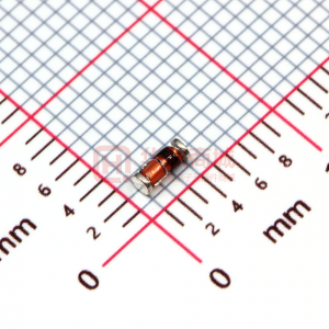

LL4448
FAST SWITCHING SURFACE MOUNT DIODES
VOLTAGE
100 Volts
POWER
500 mW
MINI-MELF/LL-34
Unit : inch (mm)
FEATURES
• Fast switching Speed. • Surface Mount Package Ideally Suited For Automatic Insertion. • Silicon Epitaxal Planar Construction. • In compliance with EU RoHS 2002/95/EC directives
MECHANICAL DATA
• Case: Mini MELF • Terminals: Solderable per MIL-STD-750, Method 2026 • Polarity: Cathode Band • Marking: Cathode Band Only • Weight: 0.05 grams(approx)
