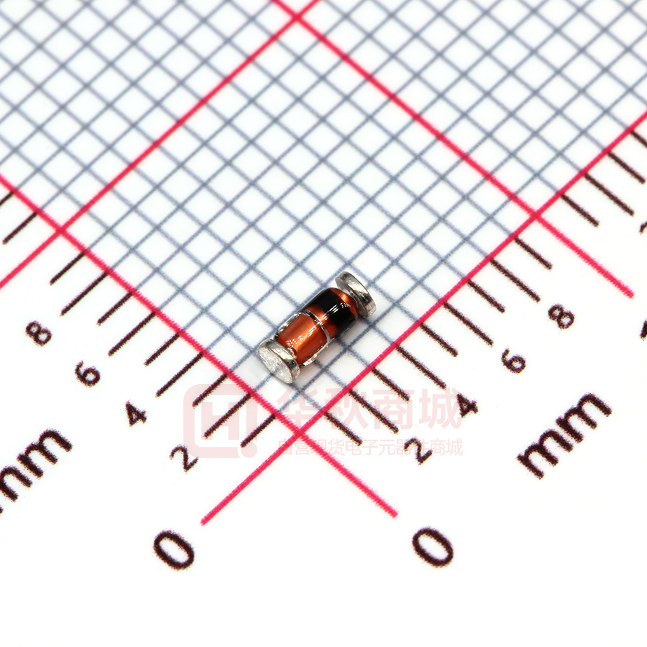

LL4448 FAST SWITCHING SURFACE MOUNT DIODES POWER 100 Volts VOLTAGE 500 mW MECHANICAL DATA 0.063(1.6) • Fast switching Speed. • Surface Mount Package Ideally Suited For Automatic Insertion. • Silicon Epitaxal Planar Construction. • Lead free in comply with EU RoHS 2011/65/EU directives 0.020(0.5) 0.012(0.3) • Case: MINI MELF • Terminals: Solderable per MIL-STD-750, Method 2026 • Polarity: Cathode Band • Marking: Cathode Band Only • Weight: 0.03 grams(approx) 0.055(1.4)DIA. FEATURES 0.020(0.5) 0.012(0.3) 0.146(3.7) 0.130(3.3) MAXIMUM RATINGS AND ELECTRICAL CHARACTERISTICS (TJ =25°C unless otherwise noted) PARAMETER SYMBOL VALUE UNITS VRM 100 V VDC 75 V Maximum Average Forward Current at TA =25 C And f >50Hz I F(AV) 150 mA Surge Forward Current at t < 1s and TJ=25OC I FSM 500 mA Power Dissipation at TA= 25OC P TOT 500 mW Maximum Forward Voltage at IF =100mA VF 1.0 V Maximum Leakage Current at V R=20V at V R=20V ,TJ= 150OC IR 25 50 nA μA Maximum Capacitance at V F =V R=0 CJ 4 pF Maximum Reverse Recovery Time From IF = - IR =10mA to IRR= -1mA ,VR=6V RL=100 Ω trr 4 ns RΘJA 350 TJ,TSTG -65 to +175 Peak Reverse Voltage Maximum DC Blocking Voltage O Typical Maximum Thermal Resistance Operating Junction Temperature and Storage Temperature Range C/W O C O NOTE: 1. CJ at VR=0, f=1MHZ 2. From IF=10mA to IR=1mA, VR=6Volts, RL=100Ω May 16,2012-REV.07 PAGE . 1 LL4448 10 REVERSE CURRENT, mA FORWARD CURRENT, mA 100 10 1.0 TA=150 OC TA=125 OC 1.0 TA=85 OC 0.1 TA=55 OC 0.01 TA=25 OC 0.1 0.2 0.6 0.4 0.8 1.0 1.2 0.001 0 20 30 40 50 REVERSE VOLTAGE, Volts FORWARD VOLTAGE, Volts LEAKAGE CURRENT FORWARD VOLTAGE DIODE CAPACITANCE, pF 10 6.0 4.5 60 W 3.5 VRF=2V 2nF 5k W Vo 1.5 0 0 2 4 6 8 RECTIFICATION EFFCIENCY MEASUREMENT CIRCUIT REVERSE VOLTAGE, Volts TYPICAL CAPATICANCE May 16,2012-REV.07 PAGE . 2 LL4448 MOUNTING PAD LAYOUT ORDER INFORMATION • Packing information T/R - 10K per 13" plastic Reel T/R - 2.5K per 7" plastic Reel May 16,2012-REV.07 PAGE . 3 LL4448 Part No_packing code_Version LL4448_R1_10001 LL4448_R2_10001 For example : RB500V-40_R2_00001 Serial number Part No. Version code means HF Packing size code means 13" Packing type means T/R Packing Code XX Packing type Tape and Ammunition Box (T/B) Tape and Reel (T/R) Bulk Packing (B/P) Tube Packing (T/P) Tape and Reel (Right Oriented) (TRR) Tape and Reel (Left Oriented) (TRL) FORMING May 16,2012-REV.07 Version Code XXXXX 1st Code Packing size code A N/A 0 HF 0 serial number R 7" 1 RoHS 1 serial number B 13" 2 T 26mm X S 52mm Y L F PANASERT T/B CATHODE UP (PBCU) PANASERT T/B CATHODE DOWN (PBCD) 2nd Code HF or RoHS 1st Code 2nd~5th Code U D PAGE . 4 LL4448 Disclaimer • Reproducing and modifying information of the document is prohibited without permission from Panjit International Inc.. • Panjit International Inc. reserves the rights to make changes of the content herein the document anytime without notification. Please refer to our website for the latest document. • Panjit International Inc. disclaims any and all liability arising out of the application or use of any product including damages incidentally and consequentially occurred. • Panjit International Inc. does not assume any and all implied warranties, including warranties of fitness for particular purpose, non-infringement and merchantability. • Applications shown on the herein document are examples of standard use and operation. Customers are responsible in comprehending the suitable use in particular applications. Panjit International Inc. makes no representation or warranty that such applications will be suitable for the specified use without further testing or modification. • The products shown herein are not designed and authorized for equipments requiring high level of reliability or relating to human life and for any applications concerning life-saving or life-sustaining, such as medical instruments, transportation equipment, aerospace machinery et cetera. Customers using or selling these products for use in such applications do so at their own risk and agree to fully indemnify Panjit International Inc. for any damages resulting from such improper use or sale. • Since Panjit uses lot number as the tracking base, please provide the lot number for tracking when complaining. May 16,2012-REV.07 PAGE . 5
LL4448_R1_10001
物料型号:LL4448
器件简介: - 快速开关表面安装二极管,电压100伏,功率500毫瓦。 - 特点包括快速开关速度、适合自动插入的表面安装封装、硅外延平面结构、符合欧盟RoHS 2011/65/EU指令的无铅。
引脚分配: - 极性:带有色带的阴极。 - 标记:仅在阴极色带上。
参数特性: - 最大反向峰值电压:100伏 - 最大直流阻断电压:75伏 - 最大平均正向电流在25°C和频率大于50赫兹时:150毫安 - 正向浪涌电流在小于1秒且结温25°C时:500毫安 - 25°C时的功率耗散:500毫瓦 - 在100毫安正向电流下的最大正向电压:1.0伏 - 在20伏反向电压下的最大漏电流:25纳安(25°C)、50纳安(150°C) - 在0伏反向电压下的最大电容:4皮法 - 从10毫安到1毫安反向恢复时间(在6伏下):4纳秒 - 典型的最大热阻:350°C/W - 工作结温和存储温度范围:-65至+175°C
