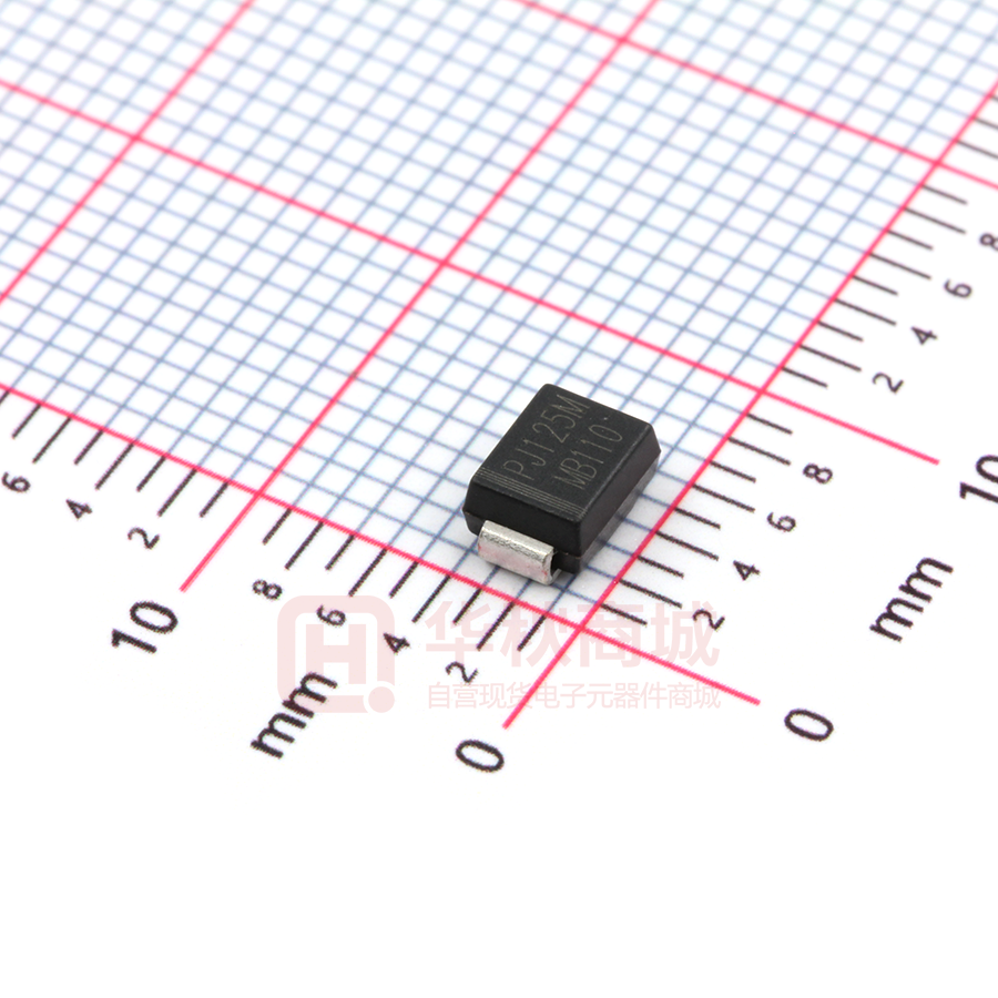

MB14~MB120
SURFACE MOUNT SCHOTTKY BARRIER RECTIFIER
VOLTAGE
40 to 200 Volt
1 Ampere
CURRENT
FEATURES
• Plastic package has Underwriters Laboratory
Flammability Classification 94V-O
• For surface mounted applications in order to optimize board space
• Low power loss,high efficiency
• High surge capacity
• High current capacity ,low VF
• For use in low voltage high frequency inverters, free wheeling,
and polarity protection applications.
• Lead free in compliance with EU RoHS 2.0
• Green molding compound as per IEC 61249 standard
MECHANICAL DATA
Case: JEDEC DO-214AA molded plastic
Terminals:Solder plated, solderable per MIL-STD-750, Method 2026
Polarity : Color band denotes cathode end
Standard packaging: 12mm tape (EIA-481)
Weight: 0.0032 ounces, 0.092 grams
