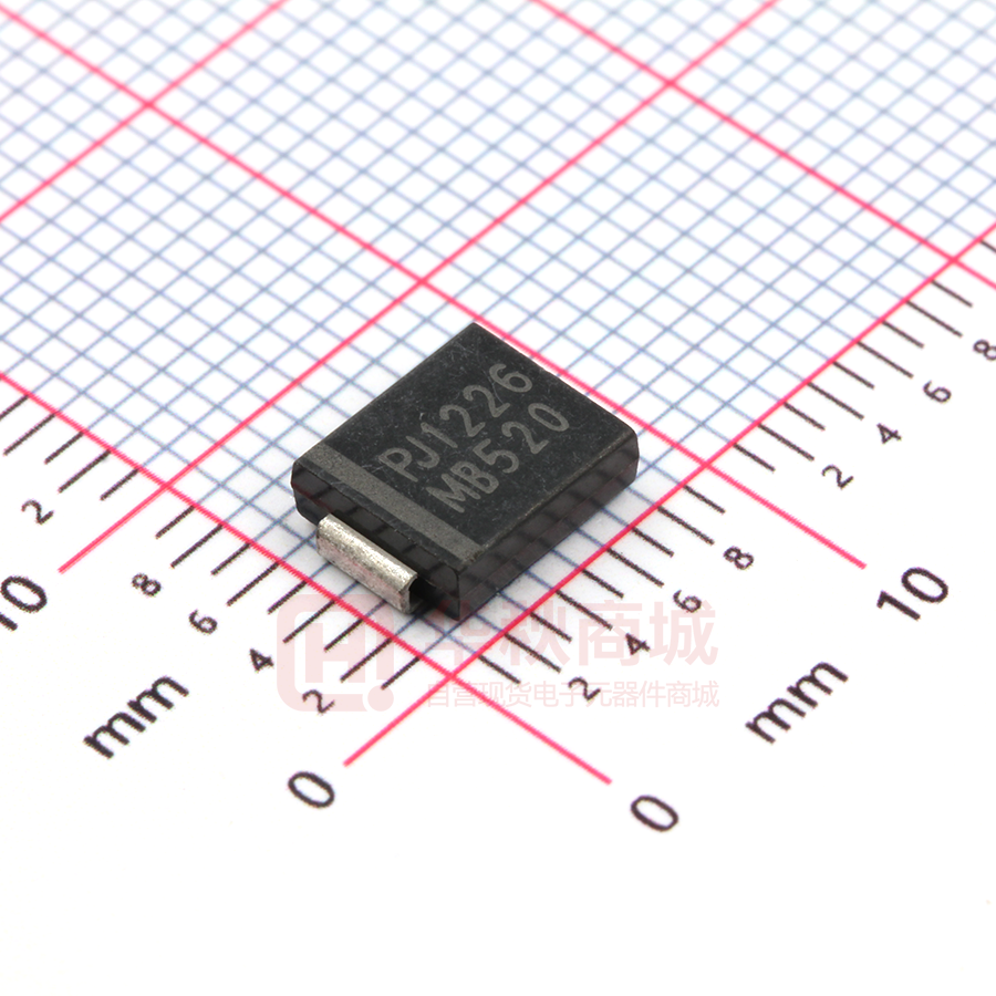

MB54~MB520
SURFACE MOUNT SCHOTTKY BARRIER RECTIFIER
VOLTAGE
40 to 200 Volt
CURRENT
5 Ampere
FEATURES
• Plastic package has Underwriters Laboratory
Flammability Classification 94V-O
• For surface mounted applications in order to optimize board space
• Low power loss,high efficiency
• High surge capacity
• Lead free in compliance with EU RoHS 2.0
• Green molding compound as per IEC 61249 standard
MECHANICAL DATA
• Case: JEDEC DO-214AB molded plastic
• Terminals: Solder plated, solderable per MIL-STD-750, Method 2026
• Polarity: Color band denotes cathode end
• Standard packaging: 16mm tape (EIA-481)
• Weight: 0.0082 ounces, 0.2325 grams
• Marking : Part number
