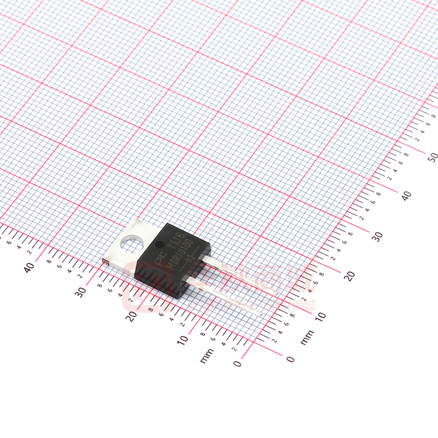

    PANJIT(强茂)
    TO-220AC
    肖特基二极管 Single VR=100V Io=10A IR=50µA TO220AC
MBR10100_T0_00001 数据手册
MBR1040~MBR10200 10 AMPERES SCHOTTKY BARRIER RECTIFIERS VOLTAGE 40 to 200 Volt CURRENT 10 Ampere FEATURES • Plastic package has Underwriters Laboratory Flammability Classification 94V-O. Flame Retardant Epoxy Molding Compound. • Low power loss, high efficiency. • High current capability • For use in low voltage, high frequency inverters free wheeling, and polarlity protection applications. • Lead free in compliance with EU RoHS 2011/65/EU directive • Green molding compound as per IEC61249 Std. . (Halogen Free) MECHANICAL DATA • Case: TO-220AC molded plastic • Terminals: solder plated, solderable per MIL-STD-750, Method 2026 • Polarity: As marked. • Weight: 0.067 ounces, 1.89 grams. MAXIMUM RATINGS AND ELECTRICAL CHARACTERISTICS Ratings at 25°C ambient temperature unless otherwise specified. Single phase, half wave, 60 Hz, resistive or inductive load. For capacitive load, derate current by 20% PARAM ETER SY M BO L M B R1040 M BR1045 M BR1050 M BR1060 M BR1080 M BR 1090 M BR10100 M B R10150 M BR10200 UNI TS M aximum Rec ur r ent Peak Re ver se Vo lt age V RRM 40 45 50 60 80 90 10 0 1 50 200 V M aximum RM S Volt age V RM S 28 31. 5 35 42 56 63 70 105 140 V M aximum DC Block ing Volt age V DC 40 45 50 60 80 90 10 0 1 50 200 V M aximum Aver a ge For w ar d Cur r ent I F( AV) 10 A Peak Fo r w ar d Sur ge Cur r ent : 8. 3ms s ing le half s inew ave super impos ed on r at ed loa d I FSM 150 A M aximum For w a r d Volt age a t 10A, per leg M aximum DC Rever s e Cur r ent at Ra t ed DC Bloc k ing Volt a ge VF T J= 2 5 OC T J = 1 25 O C Ty pic al Ther mal Res ist ance O per at ing and St or age J unct ion Tempe r at ur e Range 0.7 0. 75 0. 8 IR 0. 05 20 R θ JC 3 T J , T STG - 55 t o + 150 - 65 t o + 1 75 0.9 V mA O C / W O C Notes : Both Bonding and Chip structure are available. October 3,2016-REV.06 PAGE . 1 MBR1040~MBR10200 100000 TJ = 150°C 10000 TJ = 125°C 40~45V 1000 100 TJ = 75°C 10 TJ = 25°C 1 20 40 60 80 IR, Leakage Current (μA) IR, Leakage Current (μA) 100000 1000 TJ = 125°C 50~60V 100 TJ = 75°C 10 1 TJ = 25°C 0.1 20 100 Percent of Rated Peak Reverse Voltage (%) 40 60 80 100 Percent of Rated Peak Reverse Voltage (%) 10000 10000 IR, Leakage Current (μA) IR, Leakage Current (μA) TJ = 150°C 10000 1000 100 TJ = 125°C TJ = 150°C 10 TJ = 75°C 1 80~100V 0.1 TJ = 25°C 0.01 20 40 60 80 100 Percent of Rated Peak Reverse Voltage (%) October 3,2016­REV.06 1000 100 TJ = 125°C TJ = 150°C 10 TJ = 75°C 150~200V 1 TJ = 25°C 0.1 0.01 20 40 60 80 100 Percent of Rated Peak Reverse Voltage (%) PAGE . 2 IF,FORWARD CURRENT (A) 100 TJ=25°C 40~45V 10 50~60V 150~200V 1 80~100V 0.1 0.2 0.3 0.4 0.5 0.6 0.7 0.8 VF, FORWARD VOLTAGE (V) 0.9 1 Percent of Reverse Voltage (%) MBR1040~MBR10200 120 100 80 60 40V 40 45~200V 20 0 0 25 50 75 100 125 150 175 TJ, Junction Temperature (°C) Fig.Operating Temperature Derating Curve October 3,2016­REV.06 PAGE . 3 MBR1040~MBR10200 Part No_packing code_Version MBR1040_T0_00001 For example : RB500V-40_R2_00001 Serial number Version code means HF Packing size code means 13" Part No. Packing type means T/R Packing Code XX Packing type Tape and Ammunition Box (T/B) Tape and Reel (T/R) Bulk Packing (B/P) Tube Packing (T/P) Tape and Reel (Right Oriented) (TRR) Tape and Reel (Left Oriented) (TRL) FORMING October 3,2016-REV.06 Version Code XXXXX 1st Code Packing size code A N/A 0 HF 0 serial number R 7" 1 RoHS 1 serial number B 13" 2 T 26mm X S 52mm Y L F PANASERT T/B CATHODE UP (PBCU) PANASERT T/B CATHODE DOWN (PBCD) 2nd Code HF or RoHS 1st Code 2nd~5th Code U D PAGE . 4 MBR1040~MBR10200 Disclaimer • Reproducing and modifying information of the document is prohibited without permission from Panjit International Inc.. • Panjit International Inc. reserves the rights to make changes of the content herein the document anytime without notification. Please refer to our website for the latest document. • Panjit International Inc. disclaims any and all liability arising out of the application or use of any product including damages incidentally and consequentially occurred. • Panjit International Inc. does not assume any and all implied warranties, including warranties of fitness for particular purpose, non-infringement and merchantability. • Applications shown on the herein document are examples of standard use and operation. Customers are responsible in comprehending the suitable use in particular applications. Panjit International Inc. makes no representation or warranty that such applications will be suitable for the specified use without further testing or modification. • The products shown herein are not designed and authorized for equipments requiring high level of reliability or relating to human life and for any applications concerning life-saving or life-sustaining, such as medical instruments, transportation equipment, aerospace machinery et cetera. Customers using or selling these products for use in such applications do so at their own risk and agree to fully indemnify Panjit International Inc. for any damages resulting from such improper use or sale. • Since Panjit uses lot number as the tracking base, please provide the lot number for tracking when complaining. October 3,2016-REV.06 PAGE . 5
