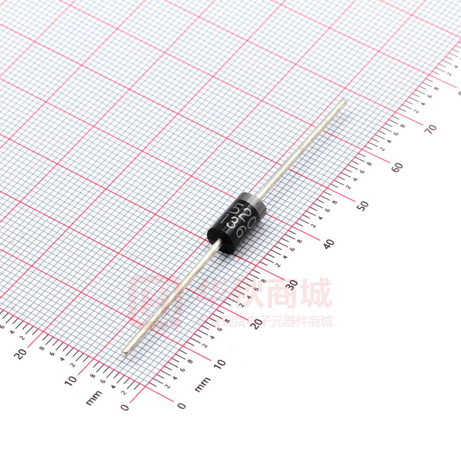

MBR540 SERIES
SCHOTTKY BARRIER RECTIFIERS
VOLTAGE
40 to 200 Volt
CURRENT
5 Ampere
FEATURES
• Epitaxial Construction
0.052(1.3)
0.048(1.2)
1.0(25.4)MIN.
• Guard Ring Die Construction for Transient Protection
• Low Power Loss, High Efficiency
• High Surge Capability
• High Current Capability and Low Forward Voltage Drop
• Surge Overload Rating to 150A Peak
0.375(9.5)
0.285(7.2)
• For Use in Low Voltage, High Frequency Inverters, Free Wheeling,
and Polarity Protection Applications
• Lead free in compliance with EU RoHS 2011/65/EU directive
MECHANICAL DATA
0.210(5.3)
0.188(4.8)
1.0(25.4)MIN.
• Case: DO-201AD Molded plastic
• Terminals: Axial leads, solderable per MIL-STD-750,Method 2026
• Polarity: Color band denotes cathode
• Weight: 0.0402 ounces, 1.142 grams
