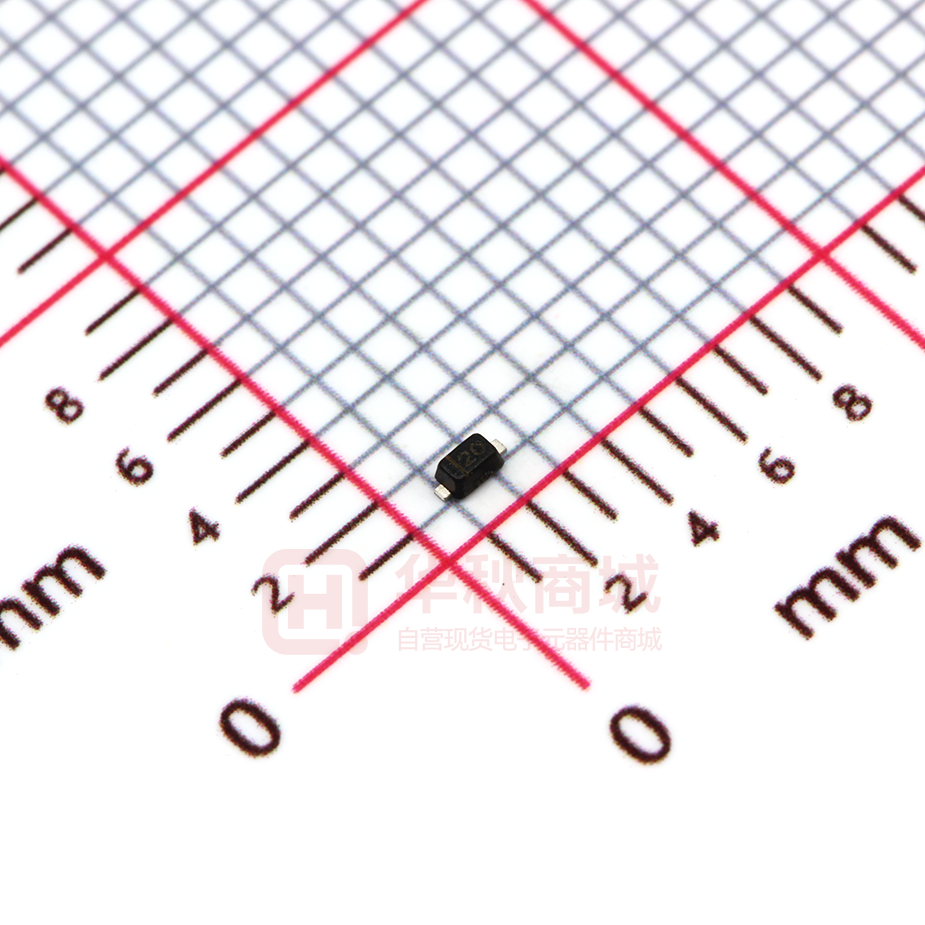

    肖特基二极管 Single VR=30V IF=200mA IR=1μA Cj=30pF SOD523

RB520S30 SURFACE MOUNT SCHOTTKY DIODES VOLTAGE 200 mA CURRENT 30 Volt FEATURES • Extremely High Switching Speed 0.050(1.25) 0.045(1.15) • Surface mount package ideally suited for autmatic insertion • Lead free in compliance with EU RoHS 2011/65/EU directive • Green molding compound as per IEC61249 Std. . (Halogen Free) 0.014(0.35) 0.009(0.25) 0.034(0.85) 0.029(0.75) 0.026(0.65) 0.021(0.55) MECHANICAL DATA 0.006(0.15) 0.002(0.05) 0.067(1.70) 0.059(1.50) • Case: SOD-523, Plastic • Terminals: Solderable per MIL-STD-750, Method 2026 0.20 MIN. • Appox Weight : 0.0001 ounces,0.0014 grams • Marking : 20 ABSOLUTE RATINGS PA RA ME TE R S ymb o l Value Units Peak Reverse Voltage VR 30 V Maximum Forward Current IO 0.2 A I FSM 1 A T J,T STG -5 5 to +1 2 5 oC Peak Forward Surge Current 1000ms Single half sine-wave superimposed on rate load Op e ra ti ng J unc ti o n a nd S to ra g e Te mp e ra ture Ra ng e ELECTRICAL CHARACTERISTICS ( TJ = 25OC unless otherwise noted ) PA RA M E TE R S ym b o l Te s t C o n d i t i o n M IN . T YP. MA X . U ni t s V R= 1 0 V - - 1 .0 μA R e ve r s e L e a k a g e C ur r e nt I F o rwa rd Vo lta g e V F1 I F=2 0 mA - - 0.40 V F o rwa rd Vo lta g e V F2 I F=2 0 0 mA - - 0.60 V To t a l C a p a c i t a n c e CJ V R= 0 V , F = 1 M H z - 30 - pF May 17,2016-REV.06 R PAGE . 1 RB520S30 RATING AND CHARACTERISTIC CURVES 100 0.35 O AVERAGE FORWARD RECIFIED CURRENT AMPERES CAPACITANCE, pF T J = 25 C f = 1.0MHz Vsig = 50mVp-p 10 1 0.1 0.25 0.20 0.15 0.10 0.05 0 0 20 40 60 80 100 120 140 160 180 100 10 1 SINGLE PHASE, HALF-WAVE, 60Hz RESISTIVE OR INDUCTIVE LOAD P.C.B MOUNTED ON 0.3 x 0.3" (8.0 x 8.0 mm)COPPER PAD AREAS 0.30 O LEAD TEMPERATURE, C REVERSE VOLTAGE, VOLTS FIG.2 MAXIMUM AVERAGE FORWARD CURRENT DERATING FIG.1 TYPICAL JUNCTION CAPACITANCE 1000 INSTANTANEOUS FORWARD CURRENT, AMPERES INVSTANTANEOUS REVERSE CURRENT, MICROAMPERES 1.0 O T J =125 C 100 O T J =75 C 10 1 O T J =25 C 0.1 O T A =25 C 0.1 0.01 0 10 20 30 40 0.1 0.3 0.4 0.5 0.6 0.7 0.8 0.9 INSTANTANEOUS FORWARD VOLTAGE VOLTS Reverse Voltage, VOLTS Fig.3 Typical Reverse Characteristics FIG.4 TYPICAL FORWARD CHARACTERISTICS 40 Reverse Voltage (V) FORWARD SURGE CURRENT, AMPERES pk (HALF-SING WAVE) 0.2 1.4 1.2 1.0 0.8 0.6 0.4 0.2 1 2 4 6 8 10 20 40 60 80 100 NUMBER OF CYCLES AT 60Hz FIG.5 MAXIMUM NON-REPEITIVE SURGE CURRENT May 17,2016-REV.06 30 20 10 0 0 25 50 75 100 125 TJ, Junction Temperature (°C) Fig.Operating Temperature Derating Curve PAGE . 2 RB520S30 MOUNTING PAD LAYOUT ORDER INFORMATION • Packing information T/R - 12K per 13" plastic Reel T/R - 5K per 7" plastic Reel May 17,2016-REV.06 PAGE . 3 RB520S30 Part No_packing code_Version RB520S30_R1_00001 RB520S30_R2_00001 For example : RB500V-40_R2_00001 Serial number Part No. Version code means HF Packing size code means 13" Packing type means T/R Packing Code XX Packing type Tape and Ammunition Box (T/B) Tape and Reel (T/R) Bulk Packing (B/P) Tube Packing (T/P) Tape and Reel (Right Oriented) (TRR) Tape and Reel (Left Oriented) (TRL) FORMING May 17,2016-REV.06 Version Code XXXXX 1st Code Packing size code A N/A 0 HF 0 serial number R 7" 1 RoHS 1 serial number B 13" 2 T 26mm X S 52mm Y L F PANASERT T/B CATHODE UP (PBCU) PANASERT T/B CATHODE DOWN (PBCD) 2nd Code HF or RoHS 1st Code 2nd~5th Code U D PAGE . 4 RB520S30 Disclaimer • Reproducing and modifying information of the document is prohibited without permission from Panjit International Inc.. • Panjit International Inc. reserves the rights to make changes of the content herein the document anytime without notification. Please refer to our website for the latest document. • Panjit International Inc. disclaims any and all liability arising out of the application or use of any product including damages incidentally and consequentially occurred. • Panjit International Inc. does not assume any and all implied warranties, including warranties of fitness for particular purpose, non-infringement and merchantability. • Applications shown on the herein document are examples of standard use and operation. Customers are responsible in comprehending the suitable use in particular applications. Panjit International Inc. makes no representation or warranty that such applications will be suitable for the specified use without further testing or modification. • The products shown herein are not designed and authorized for equipments requiring high level of reliability or relating to human life and for any applications concerning life-saving or life-sustaining, such as medical instruments, transportation equipment, aerospace machinery et cetera. Customers using or selling these products for use in such applications do so at their own risk and agree to fully indemnify Panjit International Inc. for any damages resulting from such improper use or sale. • Since Panjit uses lot number as the tracking base, please provide the lot number for tracking when complaining. May 17,2016-REV.06 PAGE . 5
