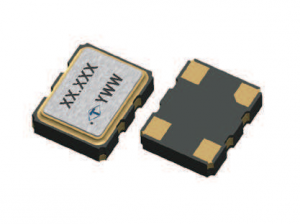

FEATURES PETERMANN TECHNIK - HIGH RELIABILITY FOR LOW COST Time & Frequency Components - SMALL DIMENSIONS - AVAILABLE WITH SUPPLY VOLTAGE OF 2.6 VOLT - LOW POWER CONSUMPTION - NEW STANDARD FOR SMALL LOW COST SMD-VCTCXO'S AND SMD-TCXO's - CHEAPEST AVAILABLE SMD-VCTCXO AND SMD-TCXO IN CERAMIC PACKAGE SMD-VCTCXO-0507 SMD-TCXO-0507 PACKAGE CERAMIC PACKAGE 7 x 5 x 1.9 mm 10.000 MHz ~ 28.000 MHz FREQUENCY RANGE 10.000 MHz; 10.245 MHz; 12.800 MHz; 13.000 MHz; STANDARD FREQUENCIES 13.5625 MHz; 14.400 MHz; 15.360 MHz; 16.800 MHz; 19.200 MHz; 19.440 MHz; 19.800 MHz; 20.000 MHz MAXIMUM OPERATING TEMPERATURE RANGE -40/+85°C -30/+85°C STANDARD OPERATING TEMPERATURE RANGE STORAGE TEMPERATURE RANGE -40/+85°C 2.6 ~ 5.5 VDC SUPPLY VOLTAGE RANGE STANDARD SUPPLY VOLTAGES 3.0 VDC +-5% / 3.3 VDC +-5% / 5.0 VDC +-5% CURRENT CONSUMPTION 2 mA MAX. (LOAD 10 k Ω / 10 pF) +-0.5 ppm @ 25°C +-2 °C INITIAL FREQUENCY ACCURACY +-2.5 ppm max. (-30/+85°C refered to +25°C) VS. TEMPERATURE FREQUENCY VS. AGING +-1 ppm max. first year STABILITY +-0.3 ppm max. (3.0 VDC +-5%) VS. VOLTAGE CHANGE VS. LOAD CHANGE +-0.3 ppm max. (10 k Ω +-10% / 10 pF +-10%) FREQUENCY CHANGE AFTER REFLOW +-1 ppm max. 10 kΩ / 10 pF OUTPUT LOAD OUTPUT VOLTAGE 0.8 ~ 1.0 Vp-p MIN. OUTPUT SIGNAL CLIPPED SINE WAVE FREQUENCY TUNING RANGE +-4 to +-16 ppm FREQUENCY TUNING BY EXTERNAL VOLTAGE 1.5 VDC +-1 VDC (or depending the supply voltage) HARMONICS DISTORTION -8 dBc MAX. (-12 dBc TYP.) PHASE NOISE -120 dBc/Hz @ 1 kHz (-130 dBc TYP.) SERIES SMD-TCXO-0507 SMD-VCTCXO-0507 PIN 1 GROUND VOLTAGE CONTROL PIN 2 GROUND GROUND PIN 3 OUTPUT SIGNAL OUTPUT SIGNAL PIN PIN 4 SUPPLY VOLTAGE SUPPLY VOLTAGE CONNECTION PIN 5 NOT CONNECT NOT CONNECT PIN 6 NOT CONNECT NOT CONNECT PIN 7 NOT CONNECT NOT CONNECT PIN 8 NOT CONNECT NOT CONNECT DELIVERY FORM TAPE AND REEL MARKING JYEG + FREQUENCY MANUFACTURER TJE / CHINA (ISO-9001/14001 qualified) ORDERING CODE FOR SMD-VCTCXO SMD-VCTCXO-0507-FREQUENCY-T ORDERING CODE FOR SMD-TCXO SMD-TCXO-0507-FREQUENCY-T OTHER PARAMETERS ARE AVAILABLE ON REQUEST / CREATE HERE YOUR SPECIFICATION Page 1 / 4 PETERMANN-TECHNIK GmbH | Amselweg 8 | D-86916 Kaufering Fon: 00 49 (0) 81 91 / 30 53 95 | Fax: 00 49 (0) 81 91 / 30 53 97 http://www.petermann-technik.de | info@petermann-technik.de SERIES SMD-VCTCXO SMD-TCXO RECOMMENDED LAYOUT Page 2 / 4 PETERMANN TECHNIK Time & Frequency Components TEST CIRCUIT *2 *3 A #4 VCC 0.01uF #3 TOP VIEW #1 0.01uF ZL #2 Vcont ZL = Load Impedance * * Includes all stray and probe capacitance * ZL = 10 pF // 10 KOhm *2 Frequency Counter *3 Oscilloscope Page 3 / 4 PETERMANN-TECHNIK GmbH | Amselweg 8 | D-86916 Kaufering Fon: 00 49 (0) 81 91 / 30 53 95 | Fax: 00 49 (0) 81 91 / 30 53 97 http://www.petermann-technik.de | info@petermann-technik.de Solder Reflow Profile: Tp Ramp-up Critical Zone TL to Tp Ramp-down High Temperature Infrared /Convection Note:Temperature shown are applied to body of device Ts max to TL(Ramp-up Rate) Preheat Temperature Min(Ts Min) Temperature Typical( Ts Typ) Temperature Max.(Ts Max) Time(ts) Ram-up Rate(TL to Tp) Time Maintained Above: --Temperature(TL) --Time(TL) Peak Temperature (Tp) Target Peak Temperature(Tp Target) Time within 5℃ of actual peak(tp) Ramp-down Rate Tune 25℃ to Peak Temperature(t) Moisture Sensitivity Level 3°C/second max. 150°C 175°C 200°C 60-180 seconds 3°C/second Max 217°C 60-150 seconds 260°C max. seconds 250°C+0/-5°C 20-40 seconds 6°C/seconds Max 8 minutes Max Level 1 for 10 High Temperature Manual Soldering Note:Temperature shown are applied to body of device 260°C max. for 5 seconds max., 2 times max. Page 4 / 4 Temperature(T) TL Ts Max Ts Min Ts Preheat t 25℃ to Peak tL tp Time (t)
