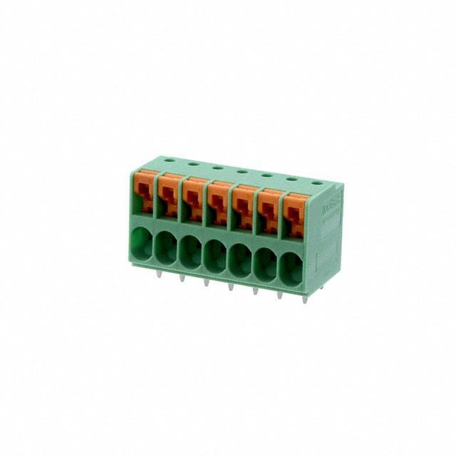

2018-04-23 Product version 00 Data sheet Document revision 00 Order No.: 1017508 Type: TDPT 2,5/ 7-SP-5,08 PCB terminal block, Wave soldering, Push-in spring connection Main features      No. of pos. Conductor cross section Color Pitch Connection method 7 2.5 mm² green 5.08 mm Push-in spring connection     Nominal current Nominal voltage Connection direction Type of packaging 32 A 400 V 0° packed in cardboard   1   The figure shows a 10-position version of the product Easy to adapt, thanks to their identical size and the same pinning for Push-in spring connections as for screw connections   Your advantages Time saving push-in connection, tools not required Defined contact force ensures that contact remains stable over the long term Intuitive use through colour coded actuation lever Make sure you always use the latest documentation. It can be downloaded at: phoenixcontact.net/product/1017508 © PHOENIX CONTACT 2018 2 2018-04-23 Product version 00 Main features........................................................................................................................... 1 2 Your advantages ..................................................................................................................... 1 3 Table of contents ..................................................................................................................... 2 4 3D model in PDF can be activated (Acrobat Reader only)....................................................... 3 5 item properties......................................................................................................................... 4 5.1 Connection capacity ............................................................................................................. 4 5.2 Material data ...................................................................................................................... 4 6 Dimensions.............................................................................................................................. 4 6.1 Dimensions for the product .................................................................................................... 4 6.2 Dimensions for PCB design .................................................................................................... 5 7 Series drawing......................................................................................................................... 6 8 Packaging information ............................................................................................................. 7 9 Application............................................................................................................................... 7 9.1 Processing notes ................................................................................................................. 7 9.2 Temperature limit values ....................................................................................................... 7 9.3 Termination and connection method ......................................................................................... 7 9.4 Pull-out test ........................................................................................................................ 7 10 Electrical tests ......................................................................................................................... 8 10.1 Electrical data ..................................................................................................................... 8 10.2 Air clearances and creepage distances ..................................................................................... 8 10.3 Short-time withstand current test ............................................................................................. 8 10.4 Aging test (climatic impact and corrosion testing)......................................................................... 8 10.5 Insulation resistance ............................................................................................................. 8 10.6 Mechanical connection test for the PCB terminal block ................................................................. 9 10.7 Temperature-rise test ........................................................................................................... 9 11 Current carrying capacity/derating curves ............................................................................. 10 12 Environmental and durability tests ......................................................................................... 11 12.1 Assessment of fire risk (glow wire test) .................................................................................... 11 12.2 Vibration test .................................................................................................................... 11 13 Approvals .............................................................................................................................. 11 14 Commercial Data................................................................................................................... 12 15 Accessories ........................................................................................................................... 12 REF 1017503 PHOENIX CONTACT 2 / 12   Table of contents 1   3   Document revision 00 © PHOENIX CONTACT 2018 1017508 TDPT 2,5/ 7-SP-5,08 2018-04-23 Product version 00 1017508 TDPT 2,5/ 7-SP-5,08 3D model in PDF can be activated (Acrobat Reader only) © PHOENIX CONTACT 2018       4 Document revision 00 REF 1017503 PHOENIX CONTACT 3 / 12 2018-04-23 Product version 00 1017508 TDPT 2,5/ 7-SP-5,08 5 Document revision 00 item properties Order No. 1017508 Type TDPT 2,5/ 7-SP-5,08 Range of articles TDPT 2,5/..-SP Pitch 5.08 mm Number of positions 7 Connection method Push-in spring connection Mounting type Wave soldering Pin layout Linear double pinning 5.1 Connection capacity Conductor cross section, solid 0.2 mm² to 4 mm² Conductor cross section, flexible 0.2 mm² to 4 mm² Conductor cross section AWG/kcmil 24 to 12 Conductor cross section flexible, with ferrule without plastic sleeve 0.2 mm² to 2.5 mm² Conductor cross section flexible, with ferrule with plastic sleeve 0.2 mm² to 2.5 mm² 2 conductors with same cross section, stranded, with TWIN ferrules with plastic sleeve 0.5 mm² to 0.75 mm² Stripping length 10 mm 5.2 Material data Material of metal parts WEEE/RoHS-compliant, whisker-free acc. to IEC 60068-2-82/JEDEC JESD 201 Contact material Cu alloy Terminal point surface Soldering area surface Surface characteristics   Note Sn 10 µm ... 16 µm Sn 10 µm ... 16 µm Tin-plated Housing Actuation element PA PA   Insulating material data Insulating material CTI according to IEC 60112 600 600 Flammability rating according to UL 94 V0 V0 green (6021) Glow wire flammability index GWFI according to EN 60695-2-12 850 Glow wire ignition temperature GWIT according to EN 60695-2-13 775 Temperature for the ball pressure test according to EN 60695-10-2 125 °C 6 Dimensions 6.1 Dimensions for the product Length 18 mm Width 36.36 mm Height (without solder pin) 19 mm Total height 22.5 mm Solder pin [P] 3.5 mm Dimension a 30.48 mm REF 1017503 © PHOENIX CONTACT 2018   Color PHOENIX CONTACT 4 / 12 2018-04-23 Product version 00 1017508 TDPT 2,5/ 7-SP-5,08 6.2 Document revision 00 Dimensions for PCB design 1.4 mm Pin dimensions 1 x 0,6 mm Pin spacing 8.7 mm © PHOENIX CONTACT 2018       Hole diameter REF 1017503 PHOENIX CONTACT 5 / 12 2018-04-23 Product version 00 1017508 TDPT 2,5/ 7-SP-5,08 Series drawing © PHOENIX CONTACT 2018       7 Document revision 00 REF 1017503 PHOENIX CONTACT 6 / 12 2018-04-23 Product version 00 1017508 TDPT 2,5/ 7-SP-5,08 8 Document revision 00 Packaging information Type of packaging packed in cardboard Pieces per package 50 9 Application 9.1 Processing notes Process Wave soldering Specification Following IEC 61760-1:2006-04 Specification Following IEC 60068-2-54:2006-04 9.2 Temperature limit values Ambient temperature (storage/transport) -40 °C ... 70 °C Ambient temperature (assembly) -5 °C ... 105 °C Ambient temperature (operation) -40 °C (Depending on the current carrying capacity/derating curve) 9.3 Termination and connection method Specification IEC 60999-1:1999-11 Check for damage to conductor or loosening Test passed Pull-out test   9.4 Specification IEC 60999-1:1999-11 Result Test passed Conductor cross section/conductor type/tractive force actual value 0.2 mm² / solid / > 10 N Conductor cross section/conductor type/tractive force actual value 0.2 mm² / stranded / > 10 N 4 mm² / solid / > 60 N Conductor cross section/conductor type/tractive force actual value 4 mm² / stranded / > 60 N © PHOENIX CONTACT 2018   Conductor cross section/conductor type/tractive force actual value   Termination and connection method: pull-out test REF 1017503 PHOENIX CONTACT 7 / 12 2018-04-23 Product version 00 1017508 TDPT 2,5/ 7-SP-5,08 10 Electrical tests 10.1 Electrical data Rated current / conductor cross section Document revision 00 32 A / 2.5 mm² Rated insulation voltage (III/2) 400 V Rated surge voltage (III/2) 4 kV Contact resistance 1.13 mΩ Degree of pollution 2 10.2 Air clearances and creepage distances Specification IEC 60947-1:2007-06 + A1:2010-12 Mains type unearthed mains Insulating material group I Comparative tracking index (IEC 60112:2003-01) CTI 600 Rated insulation voltage 320 V 400 V 630 V Rated surge voltage 4 kV 4 kV 4 kV Degree of pollution 3 2 2 Overvoltage category III III II Minimum clearance case A (inhomogeneous field) 3 mm 3 mm 3 mm Minimum value of the creepage path requirement in acc. with table 4 mm 3 mm 3.2 mm Specification IEC 60947-7-4:2013-08 Result Test passed Conductor cross section/short-time current 4 mm² / 144 A Specification IEC 60947-7-4:2013-08 Result Test passed Contact resistance R1 1.13 mΩ / 4 mm² Test sequence 1: low temperature storage -40 °C / 2 h Test sequence 2: heat storage 168 h/105 °C Test sequence 3: noxious gas storage (ISO 6988) KFW 0.2 S/1 cycle Contact resistance R2 1.13 mΩ / 4 mm² Rated impulse voltage at sea level Voltage waveform ≥ (1.2/50 μs) 4.8 kV Power-frequency withstand voltage Voltage waveform ≥ (50/60 Hz) 3.1 kV 10.5   Aging test (climatic impact and corrosion testing)   10.4   Short-time withstand current test © PHOENIX CONTACT 2018 10.3 Insulation resistance Specification IEC 60512-3-1:2002-02 Result Test passed REF 1017503 PHOENIX CONTACT 8 / 12 2018-04-23 Product version 00 1017508 TDPT 2,5/ 7-SP-5,08 10.6 Document revision 00 Mechanical connection test for the PCB terminal block Specification IEC 60947-7-4:2013-08 Result Test passed 10.7 Temperature-rise test IEC 60947-7-4:2013-08 Result Test passed © PHOENIX CONTACT 2018       Specification REF 1017503 PHOENIX CONTACT 9 / 12 2018-04-23 Product version 00 1017508 TDPT 2,5/ 7-SP-5,08 11 Document revision 00 Current carrying capacity/derating curves Specification IEC 60512-5-2:2002-02 Reduction factor 1 Number of positions 4 Current strength [A] Type: TDPT 2,5/...-SP-5,08 56 52 48 44 40 36 32 28 24 20 16 12 8 4 0 = 4 mm² solid 0 10 20 30 40 50 60 70 80 90 100 110 © PHOENIX CONTACT 2018       Ambient temperature [°C] REF 1017503 PHOENIX CONTACT 10 / 12 2018-04-23 Product version 00 1017508 TDPT 2,5/ 7-SP-5,08 12 Environmental and durability tests 12.1 Assessment of fire risk (glow wire test) Document revision 00 Specification IEC 60695-2-10:2013-04 Result Test passed Temperature 850 °C Time of exposure 5s 12.2 Vibration test Specification IEC 60068-2-6:2007-12 Result Test passed Frequency 10 - 150 - 10 Hz Sweep speed 1 octave/min Amplitude 0.35 mm (10 - 60.1 Hz) Acceleration 5 g (60.1 - 150 Hz) Test duration per axis 2.5 h Test directions X-, Y- and Z-axis Contact interruption Shock Specification IEC 60068-2-27:2008-02 Result Test passed Pulse shape Semi-sinusoidal Peak acceleration 30g Shock duration 18 ms Number of shocks per direction 3 Test directions X-, Y- and Z-axis (pos. and neg.)   Specification   Contact interruption Specification WN-CS 21-1:2010-09 Result Test passed Testing Inspection for substances that impair surface wetting according to VW/AUDI test specification 3.10.7 February 2005 Approvals © PHOENIX CONTACT 2018 13   Test for materials that impair paint application REF 1017503 PHOENIX CONTACT 11 / 12 2018-04-23 Product version 00 1017508 TDPT 2,5/ 7-SP-5,08 14 Document revision 00 Commercial Data Order No. 1017508 Type TDPT 2,5/ 7-SP-5,08 Pieces per package 50 Net weight 8.48 g GTIN 4055626501420 Information that applies locally, see link on page 1 Country of origin 15 Information that applies locally, see link on page 1 Accessories Description Order No. Type SZF 2-0,8X4,0 © PHOENIX CONTACT 2018       Actuation tool, for ST terminal blocks, also suitable for use as a bladed 1204520 screwdriver, size: 0.8 x 4.0 x 100 mm, 2-component grip, with non-slip grip REF 1017503 PHOENIX CONTACT GmbH & Co. KG • 32823 Blomberg • Germany phoenixcontact.com PHOENIX CONTACT 12 / 12

物料型号:1017508,TDPT 2,5/7-SP-5,08
器件简介: - 适用于2.5mm²导线截面,最大32A电流,400V电压 - 符合IEC标准 - 7个位置,间距5.08mm,绿色,推入式弹簧连接
引脚分配:线性双排针布局
参数特性: - 额定电流32A,额定电压400V,额定浪涌电压4kV - 接触电阻1.13mΩ - 空气间隙和爬电距离符合IEC60947-1:2007标准
功能详解: - 易于适应,尺寸一致,推入式和螺钉式连接具有相同的引脚 - 推入式连接节省时间,无需工具 - 通过颜色编码的操作杆直观易用
应用信息: - 波峰焊接处理,符合IEC 61760-1:2006和IEC 60068-2-54:2006标准 - 存储和运输的环境温度范围为-40°C至70°C - 操作环境温度根据电流承载能力/降额曲线而定
封装信息: - 包装在纸板箱中,每箱50件
