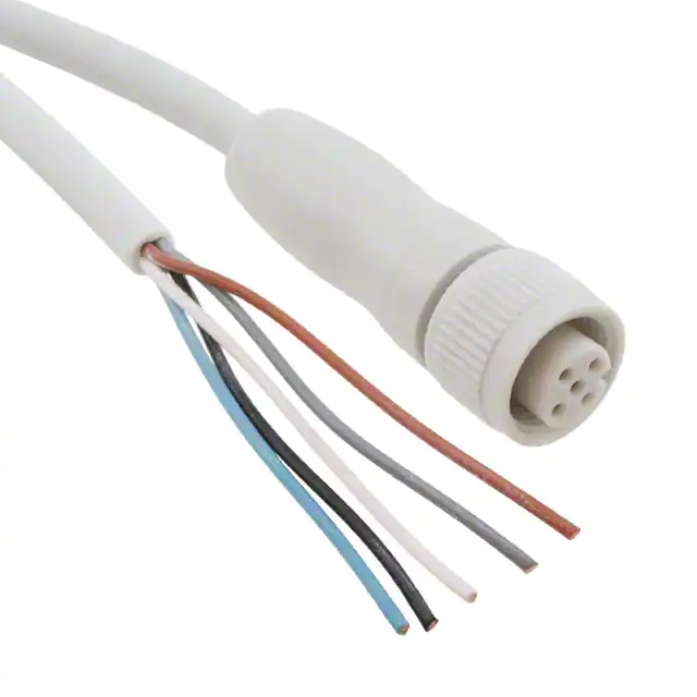

    CBL ASSY 5POS SOCKET-WIRE 1.5M
1404083 数据手册
https://www.phoenixcontact.com/us/produkte/1404083 Sensor/Actuator cable - SAC-5P-1,5-600/M12FS FB - 1404083 Please be informed that the data shown in this PDF Document is generated from our Online Catalog. Please find the complete data in the user's documentation. Our General Terms of Use for Downloads are valid (http://download.phoenixcontact.com) Sensor/Actuator cable, 5-position, PP-EPDM halogen-free, Gray RAL 7035, Free cable end, on Socket straight M12, A-coded, Cable length: 1.5 m, Hygienic design, with plastic knurl   Key commercial data Packing unit 0 Minimum order quantity 1 GTIN Custom tariff number 85444290 Country of origin POLAND Technical data General data Rated current at 40°C 4A Rated voltage 60 V Number of positions 5 Volume resistance ≤ 5 mΩ Insulation resistance ≥ 100 MΩ Length of cable 1.5 m Ambient temperature (operation) -40 °C ... 105 °C (Male connector / female connector) General characteristics Standards/regulations M12 plug-in connector IEC 61076-2-101 Coding A - standard Surge voltage category II Pollution degree 3 Degree of protection IP65/IP68/IP69K Insertion/withdrawal cycles ≥ 100 Torque 0.4 Nm (M12 plug-in connector) Contact material CuSn Contact surface material Ni/Au Contact carrier material PP 18.01.2013   Page 1 / 6 https://www.phoenixcontact.com/us/produkte/1404083 Sensor/Actuator cable - SAC-5P-1,5-600/M12FS FB - 1404083 Technical data General characteristics Material of grip body PP Material, knurls PP Sealing material FKM Status display No Conductor data Cable type Halogen-free PP gray Cable type (abbreviation) 600 Cable abbreviation Li9Y9Y Conductor cross section 5x 0.34 mm² (signal line) AWG signal line 22 Conductor structure signal line 42x 0.10 mm Core diameter including insulation 1.27 mm ±0.02 mm (signal line) Thickness, insulation ≥ 0.21 mm (Core insulation) Wire colors Brown, white, blue, black, gray Overall twist 5 cores, twisted Length of twist, overall twist 55 mm External sheath, color Gray RAL 7035 Outer sheath thickness Approx. 0.7 mm External cable diameter D 5 mm ±0.15 mm Minimum bending radius, fixed installation 5xD Minimum bending radius, flexible installation 10 x D Cable weight 34 kg/km Outer sheath, material PP-EPDM Material conductor insulation PP Conductor material Bare Cu litz wires Conductor resistance 58 Ω/km (At an ambient temperature of 20°C) Nominal voltage, conductor ≤ 300 V AC Test voltage, conductor ≥ 3000 V AC Special properties FDA compliant Halogen-free in accordance with DIN VDE 0472 part 815 Ambient temperature (operation) -40 °C ... 105 °C (cable, fixed installation) Classifications ETIM ETIM 3.0 EC001855 ETIM 4.0 EC001855 ETIM 5.0 EC001855 UNSPSC UNSPSC 11 31251501 UNSPSC 12.01 31251501 18.01.2013   Page 2 / 6 https://www.phoenixcontact.com/us/produkte/1404083 Sensor/Actuator cable - SAC-5P-1,5-600/M12FS FB - 1404083 Classifications UNSPSC UNSPSC 13.2 31251501 UNSPSC 6.01 31251501 UNSPSC 7.0901 31251501 eCl@ss eCl@ss 4.0 27060306 eCl@ss 4.1 27060306 eCl@ss 5.0 27061801 eCl@ss 5.1 27061801 eCl@ss 6.0 27061801 eCl@ss 7.0 27061801 Accessories Accessories Tools Cable-cutting tool - CUTFOX-S VDE - 1212207 Diagonal cutter for copper and aluminum conductors, VDE-tested     Stripping tool - WIREFOX SAC - 1212623 Stripping pliers, for halogen-free sensor/actuator cables (SAC cables), with PUR and PVC insulation, from Ø of 4.4 to 7 mm, any stripping length     Stripping tool - WIREFOX 10 - 1212150 Stripping tool, for cables and conductors from 0.02 - 10 mm², self-adjusting, stripping length of up to 18 mm, cutting capacity of up to 10 mm² stranded/1.5 mm² solid, replaceable stripping blade     Drawings 18.01.2013   Page 3 / 6 https://www.phoenixcontact.com/us/produkte/1404083 Sensor/Actuator cable - SAC-5P-1,5-600/M12FS FB - 1404083 Schematic diagram 3 Cable cross section 4 5 2 1 Pin assignment M12 socket, 5-pos., A-coded, socket side view Halogen-free PP gray [600] Circuit diagram 1 BN 2 WH 4 BK 3 BU 5 GY Contact assignment of the M12 socket 18.01.2013   Page 4 / 6 https://www.phoenixcontact.com/us/produkte/1404083 Sensor/Actuator cable - SAC-5P-1,5-600/M12FS FB - 1404083 Dimensioned drawing Ø14,8 M12 Ø13,4 44 M12 x 1 female connector, straight 18.01.2013   Page 5 / 6 https://www.phoenixcontact.com/us/produkte/1404083 © Phoenix Contact 2012 - all rights reserved http://www.phoenixcontact.com 18.01.2013   Page 6 / 6
