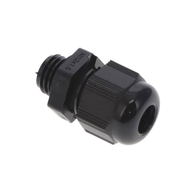

    线缆密封套 聚酰胺(PA),尼龙 M12x1.5 黑色
1424535 数据手册
https://www.phoenixcontact.com/us/products/1424535 Cable gland - G-INVEN-M12-M67N-PNES-BK - 1424535 Please be informed that the data shown in this PDF Document is generated from our Online Catalog. Please find the complete data in the user's documentation. Our General Terms of Use for Downloads are valid (http://phoenixcontact.com/download) Cable gland, Cable gland material: PA, External cable diameter 4 mm ... 8 mm, Shielding: No, Connecting thread: M12 Product Description Cable gland with pressure compensation element and flat gasket Why buy this product  reduces the formation of condensation   Key Commercial Data Packing unit 1 GTIN GTIN 4055626374406 Custom tariff number 39269097 Technical data Dimensions Length 33 mm Wrench size, union nut 19 mm Wrench size, support 19 mm Length of the connecting thread 8 mm Feed-through hole diameter 12.1 mm ... 12.2 mm External cable diameter 4 mm ... 8 mm 4 mm ... 8 mm (for UL 514 B) 04/10/2017   Page 1 / 3 https://www.phoenixcontact.com/us/products/1424535 Cable gland - G-INVEN-M12-M67N-PNES-BK - 1424535 Technical data Ambient conditions Degree of protection IP67 IP66 Ambient temperature (operation) -20 °C ... 100 °C (static) General Cable gland material PA Cable seal material CR Shielded No Thread type on connection side M12 Thread pitch 1.5 mm Torque 2 Nm (Union nut) 2 Nm (Support) 2 Nm (for UL514 B: union nut / support) Flammability rating according to UL 94 V2 Impact category 5 Execution of the strain relief A Manufacturer BIMED Manufacturer Designation BMVG-2S Standards and Regulations Flammability rating according to UL 94 V2 Drawings Dimensional drawing !33 22 M12 8 19 19 Dimensional drawing Approvals Approvals 04/10/2017   Page 2 / 3 https://www.phoenixcontact.com/us/products/1424535 Cable gland - G-INVEN-M12-M67N-PNES-BK - 1424535 Approvals Approvals UL Recognized / cUL Recognized / EAC / cULus Recognized Ex Approvals Approval details UL Recognized    http://database.ul.com/cgi-bin/XYV/template/LISEXT/1FRAME/index.htm  E199260 cUL Recognized    http://database.ul.com/cgi-bin/XYV/template/LISEXT/1FRAME/index.htm  E199260 EAC      EAC-Zulassung cULus Recognized    http://database.ul.com/cgi-bin/XYV/template/LISEXT/1FRAME/index.htm   Phoenix Contact 2017 © - all rights reserved http://www.phoenixcontact.com 04/10/2017   Page 3 / 3
