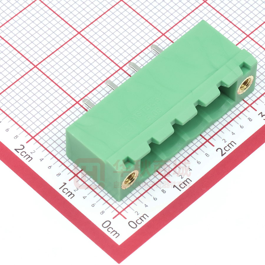

COMBICON Plugs and Headers as a „high current“ (HC) Version for Currents up to 16 A, 5.0 or 5.08 mm Pitch Tuning for the MSTB classic The proven COMBICON MSTB plug connector is now available as a "high current" (HC) version for currents up to 16 A. On top of the familiar MSTB features, a double steel spring guarantees extra safety for higher power transmission. The HC family is available with 2 to 12 positions and in pitches of 5.0 and 5.08 mm. Only the MSTB 2,5 HC headers provided are allowed to be used for carrying the higher current load of 16 A. Headquarters: © Phoenix Contact GmbH & Co. KG• Flachsmarktstraße 8 • 32825 Blomberg • Germany Phone +49-(0) 52 35-3-00 • Fax +49-(0) 52 35-3-4 12 0 • http://www.phoenixcontact.com PHOENIX CONTACT page 1 of 13 MSTB 2,5 HC/…-ST(-5,08) 5.0 or 5.08 mm Pitch The designation "HC" is printed in red to provide clear identification of "high current" plugs and headers. Only the MSTB 2,5 HC headers provided are allowed to be used for carrying the higher current load of 16 A. Note: Only actuate COMBICON plug connectors when under no load condition. If for operating reasons small loads must be switched, experimental values are available upon request. Description COMBICON HC plugs, 5.0 mm pitch color: green COMBICON HC plugs, 5.08 mm pitch color: green Dim. a [mm] Type Order No. Pcs./Pkt. 2 3 4 5 10 15 MSTB 2,5 HC/2-ST MSTB 2,5 HC/3-ST MSTB 2,5 HC/4-ST 19 11 85 5 19 11 86 8 19 11 87 1 50 5 6 7 20 25 30 MSTB 2,5 HC/5-ST MSTB 2,5 HC/6-ST MSTB 2,5 HC/7-ST 19 11 88 4 19 11 89 7 19 11 90 7 8 9 10 35 40 45 MSTB 2,5 HC/8-ST MSTB 2,5 HC/9-ST MSTB 2,5 HC/10-ST 19 11 91 0 19 11 92 3 19 11 93 6 11 12 50 55 MSTB 2,5 HC/11-ST MSTB 2,5 HC/12-ST 19 11 94 9 19 11 95 2 2 3 4 5.08 10.16 15.24 MSTB 2,5 HC/2-ST-5,08 MSTB 2,5 HC/3-ST-5,08 MSTB 2,5 HC/4-ST-5,08 19 11 96 5 19 11 97 8 19 11 98 1 5 6 7 20.32 25.40 30.48 MSTB 2,5 HC/5-ST-5,08 MSTB 2,5 HC/6-ST-5,08 MSTB 2,5 HC/7-ST-5,08 19 11 99 4 19 12 00 3 19 12 01 6 8 9 10 35.56 40.64 45.72 MSTB 2,5 HC/8-ST-5,08 MSTB 2,5 HC/9-ST-5,08 MSTB 2,5 HC/10-ST-5,08 19 12 02 9 19 12 03 2 19 12 04 5 11 12 50.80 55.88 MSTB 2,5 HC/11-ST-5,08 MSTB 2,5 HC/12-ST-5,08 19 12 05 8 19 12 06 1 CP-MSTB 17 34 63 4 No. of pos. (1) Coding profile, is inserted into the groove on the plug, red insulating material (2) Marker card, with 12 pcs. 10-section marker strips, white, self-adhesive, for 120 terminal blocks SK 5/3,8 or SK 5,08/3,8 (see COMBICON catalog) Technical data Dimensions Pitch [mm] Hole diameter [mm| Pin dimensions [mm]x[mm] Technical data in accordance with IEC/ DIN VDE Insulating material group – Surge voltage category / contamination class –/– Rated voltage [V] Rated surge voltage [kV] Nominal current / cross section [A]/[mm2] Maximum load current / cross section [A]/[mm2] Capacity connection Solid / stranded / conductor sizes [mm2]/[mm2]/AWG Stranded with ferrule without / with plastic sleeve [mm2] Multiple connection (2 conductors with same cross section) Solid / stranded [mm2] Stranded with ferrule with plastic sleeve [mm2] Stranded with TWIN ferrule with plastic sleeve [mm2] Stripping length [mm] Internal cylindrical gauge (IEC 60 947-1) Thread Torque [Nm] Insulating material Inflammability class in acc. with UL 94 PHOENIX CONTACT page 2 of 13 see description on page 13 5 / 5.08 – – III / 3 250 4 I III / 2 320 4 16 / 2.5 16 / 2.5 II / 2 630 4 0.2 - 2.5 / 0.2 - 2.5 / 24 - 12 0.25 - 2.5 / 0.25 - 2.5 0.2 - 1 / 0.2 - 1.5 0.25 - 1 0.5 - 1.5 7 A3 M3 0.5 - 0.6 PA V0 50 100 MSTB 2,5 HC/…-STF(-5,08) with Srew Flange 5.0 or 5.08 mm Pitch The designation "HC" is printed in red to provide clear identification of "high current" plugs and headers. Only the MSTB 2,5 HC headers provided are allowed to be used for carrying the higher current load of 16 A. Note: Only actuate COMBICON plug connectors when under no load condition. If for operating reasons small loads must be switched, experimental values are available upon request. Description COMBICON HC plugs, 5.0 mm pitch, with screw flange, color: green COMBICON HC plugs, 5.08 mm pitch, with screw flange, color: green Dim. a [mm] Type Order No. Pcs./Pkt. 2 3 4 5 10 15 MSTB 2,5 HC/2-STF MSTB 2,5 HC/3-STF MSTB 2,5 HC/4-STF 19 12 07 4 19 12 08 7 19 12 09 0 50 5 6 7 20 25 30 MSTB 2,5 HC/5-STF MSTB 2,5 HC/6-STF MSTB 2,5 HC/7-STF 19 12 10 0 19 12 11 3 19 12 12 6 8 9 10 35 40 45 MSTB 2,5 HC/8-STF MSTB 2,5 HC/9-STF MSTB 2,5 HC/10-STF 19 12 13 9 19 12 14 2 19 12 15 5 11 12 50 55 MSTB 2,5 HC/11-STF MSTB 2,5 HC/12-STF 19 12 16 8 19 12 17 1 2 3 4 5.08 10.16 15.24 MSTB 2,5 HC/2-STF-5,08 MSTB 2,5 HC/3-STF-5,08 MSTB 2,5 HC/4-STF-5,08 19 12 18 4 19 12 19 7 19 12 20 7 5 6 7 20.32 25.40 30.48 MSTB 2,5 HC/5-STF-5,08 MSTB 2,5 HC/6-STF-5,08 MSTB 2,5 HC/7-STF-5,08 19 12 21 0 19 12 22 3 19 12 23 6 8 9 10 35.56 40.64 45.72 MSTB 2,5 HC/8-STF-5,08 MSTB 2,5 HC/9-STF-5,08 MSTB 2,5 HC/10-STF-5,08 19 12 24 9 19 12 25 2 19 12 26 5 11 12 50.80 55.88 MSTB 2,5 HC/11-STF-5,08 MSTB 2,5 HC/12-STF-5,08 19 12 27 8 19 12 28 1 CP-MSTB 17 34 63 4 No. of pos. (1) Coding profile, is inserted into the groove on the plug, red insulating material (2) Marker card, with 12 pcs. 10-section marker strips, white, self-adhesive, for 120 terminal blocks SK 5/3,8 or SK 5,08/3,8 (see COMBICON catalog) Technical data Dimensions Pitch [mm] Hole diameter [mm| Pin dimensions [mm]x[mm] Technical data in accordance with IEC/ DIN VDE Insulating material group – Surge voltage category / contamination class –/– Rated voltage [V] Rated surge voltage [kV] Nominal current / cross section [A]/[mm2] Maximum load current / cross section [A]/[mm2] Capacity connection Solid / stranded / conductor sizes [mm2]/[mm2]/AWG Stranded with ferrule without / with plastic sleeve [mm2] Multiple connection (2 conductors with same cross section) Solid / stranded [mm2] Stranded with ferrule with plastic sleeve [mm2] Stranded with TWIN ferrule with plastic sleeve [mm2] Stripping length [mm] Internal cylindrical gauge (IEC 60 947-1) Thread Torque [Nm] Insulating material Inflammability class in acc. with UL 94 PHOENIX CONTACT page 3 of 13 see description on page 13 5 / 5.08 – – III / 3 250 4 I III / 2 320 4 16 / 2.5 16 / 2.5 II / 2 630 4 0.2 - 2.5 / 0.2 - 2.5 / 24 - 12 0.25 - 2.5 / 0.25 - 2.5 0.2 - 1 / 0.2 - 1.5 0.25 - 1 0.5 - 1.5 7 A3 M3 0.5 - 0.6 PA V0 50 100 MSTBT 2,5 HC/…-ST 5.0 mm Pitch The designation "HC" is printed in red to provide clear identification of "high current" plugs and headers. Only the MSTB 2,5 HC headers provided are allowed to be used for carrying the higher current load of 16 A. Note: Only actuate COMBICON plug connectors when under no load condition. If for operating reasons small loads must be switched, experimental values are available upon request. Description COMBICON HC plugs, 5.0 mm pitch, color: green Dim. a [mm] Type Order No. Pcs./Pkt. 2 3 4 5 10 15 MSTBT 2,5 HC/2-ST MSTBT 2,5 HC/3-ST MSTBT 2,5 HC/4-ST 19 26 35 8 19 26 24 8 19 26 25 1 50 5 6 7 20 25 30 MSTBT 2,5 HC/5-ST MSTBT 2,5 HC/6-ST MSTBT 2,5 HC/7-ST 19 26 26 4 19 26 27 7 19 26 28 0 8 9 10 35 40 45 MSTBT 2,5 HC/8-ST MSTBT 2,5 HC/9-ST MSTBT 2,5 HC/10-ST 19 26 29 3 19 26 30 3 19 26 31 6 11 12 50 55 MSTBT 2,5 HC/11-ST MSTBT 2,5 HC/12-ST 19 26 32 9 19 26 33 2 CP-MSTB 17 34 63 4 No. of pos. (1) Coding profile, is inserted into the groove on the plug, red insulating material (2) Marker card, with 12 pcs. 10-section marker strips, white, self-adhesive, for 120 terminal blocks SK 5/3,8 (see COMBICON catalog) Technical data Dimensions Pitch [mm] Hole diameter [mm| Pin dimensions [mm]x[mm] Technical data in accordance with IEC/ DIN VDE Insulating material group – Surge voltage category / contamination class –/– Rated voltage [V] Rated surge voltage [kV] Nominal current / cross section [A]/[mm2] Maximum load current / cross section [A]/[mm2] Capacity connection Solid / stranded / conductor sizes [mm2]/[mm2]/AWG Stranded with ferrule without / with plastic sleeve [mm2] Multiple connection (2 conductors with same cross section) Solid / stranded [mm2] Stranded with ferrule with plastic sleeve [mm2] Stranded with TWIN ferrule with plastic sleeve [mm2] Stripping length [mm] Internal cylindrical gauge (IEC 60 947-1) Thread Torque [Nm] Insulating material Inflammability class in acc. with UL 94 see description on page 13 5 – – I III / 2 320 4 16 / 2.5 16 / 2.5 III / 3 250 4 II / 2 630 4 0.2 - 2.5 / 0.2 - 2.5 / 24 - 12 0.25 - 2.5 / 0.25 - 2.5 0.2 - 1 / 0.2 - 1.5 0.25 - 1 0.5 - 1.5 7 A3 M3 0.5 - 0.6 PA V0 a+5 15 18,2 8,3 2,5 5 a PHOENIX CONTACT page 4 of 13 100 MVSTBR 2,5 HC/…-ST(-5,08) Vertical Plugs 5.0 or 5.08 mm Pitch The designation "HC" is printed in red to provide clear identification of "high current" plugs and headers. Only the MSTB 2,5 HC headers provided are allowed to be used for carrying the higher current load of 16 A. Note: Only actuate COMBICON plug connectors when under no load condition. If for operating reasons small loads must be switched, experimental values are available upon request. Description COMBICON HC plugs, 5.0 mm pitch, plug-in direction vertical to the conductor axis, connection point facing the smooth wall (R) of the header, color: green COMBICON HC plugs, 5.08 mm pitch, plug-in direction vertical to the conductor axis, connection point facing the smooth wall (R) of the header, color: green Dim. a [mm] Type Order No. Pcs./Pkt. 2 3 4 5 10 15 MVSTBR 2,5 HC/2-ST MVSTBR 2,5 HC/3-ST MVSTBR 2,5 HC/4-ST 19 12 29 4 19 12 30 4 19 12 31 7 50 5 6 7 20 25 30 MVSTBR 2,5 HC/5-ST MVSTBR 2,5 HC/6-ST MVSTBR 2,5 HC/7-ST 19 12 32 0 19 12 33 3 19 12 34 6 8 9 10 35 40 45 MVSTBR 2,5 HC/8-ST MVSTBR 2,5 HC/9-ST MVSTBR 2,5 HC/10-ST 19 12 35 9 19 12 36 2 19 12 37 5 11 12 50 55 MVSTBR 2,5 HC/11-ST MVSTBR 2,5 HC/12-ST 19 12 38 8 19 12 39 1 2 3 4 5.08 10.16 15.24 MVSTBR 2,5 HC/2-ST-5,08 MVSTBR 2,5 HC/3-ST-5,08 MVSTBR 2,5 HC/4-ST-5,08 19 12 40 1 19 12 41 4 19 12 42 7 5 6 7 20.32 25.40 30.48 MVSTBR 2,5 HC/5-ST-5,08 MVSTBR 2,5 HC/6-ST-5,08 MVSTBR 2,5 HC/7-ST-5,08 19 12 43 0 19 12 44 3 19 12 45 6 8 9 10 35.56 40.64 45.72 MVSTBR 2,5 HC/8-ST-5,08 MVSTBR 2,5 HC/9-ST-5,08 MVSTBR 2,5 HC/10-ST-5,08 19 12 46 9 19 12 47 2 19 12 48 5 11 12 50.80 55.88 MVSTBR 2,5 HC/11-ST-5,08 MVSTBR 2,5 HC/12-ST-5,08 19 12 49 8 19 12 50 8 CP-MSTB 17 34 63 4 No. of pos. (1) Coding profile, is inserted into the groove on the plug, red insulating material (2) Marker card, with 12 pcs. 10-section marker strips, white, self-adhesive, for 120 terminal blocks SK 5/3,8 or SK 5,08/3,8 (see COMBICON catalog) Technical data Dimensions Pitch [mm] Hole diameter [mm| Pin dimensions [mm]x[mm] Technical data in accordance with IEC/ DIN VDE Insulating material group – Surge voltage category / contamination class –/– Rated voltage [V] Rated surge voltage [kV] Nominal current / cross section [A]/[mm2] Maximum load current / cross section [A]/[mm2] Capacity connection Solid / stranded / conductor sizes [mm2]/[mm2]/AWG Stranded with ferrule without / with plastic sleeve [mm2] Multiple connection (2 conductors with same cross section) Solid / stranded [mm2] Stranded with ferrule with plastic sleeve [mm2] Stranded with TWIN ferrule with plastic sleeve [mm2] Stripping length [mm] Internal cylindrical gauge (IEC 60 947-1) Thread Torque [Nm] Insulating material Inflammability class in acc. with UL 94 PHOENIX CONTACT page 5 of 13 see description on page 13 5 / 5.08 – – III / 3 250 4 I III / 2 320 4 16 / 2.5 16 / 2.5 II / 2 630 4 0.2 - 2.5 / 0.2 - 2.5 / 24 - 12 0.25 - 2.5 / 0.25 - 2.5 0.2 - 1 / 0.2 - 1.5 0.25 - 1 0.5 - 1.5 7 A3 M3 0.5 - 0.6 PA V0 50 100 MVSTBR 2,5 HC/…-STF(-5,08) Vertical Plugs with Screw Flange 5.0 or 5.08 mm Pitch The designation "HC" is printed in red to provide clear identification of "high current" plugs and headers. Only the MSTB 2,5 HC headers provided are allowed to be used for carrying the higher current load of 16 A. Note: Only actuate COMBICON plug connectors when under no load condition. If for operating reasons small loads must be switched, experimental values are available upon request. Description COMBICON HC plugs, 5.0 mm pitch, with screw flange, color: green, connection point facing the smooth wall (R) of the header COMBICON HC plugs, 5.08 mm pitch, with screw flange, color: green, connection point facing the smooth wall (R) of the header Dim. a [mm] Type Order No. Pcs./Pkt. 2 3 4 5 10 15 MVSTBR 2,5 HC/2-STF MVSTBR 2,5 HC/3-STF MVSTBR 2,5 HC/4-STF 19 12 51 1 19 12 52 4 19 12 53 7 50 5 6 7 20 25 30 MVSTBR 2,5 HC/5-STF MVSTBR 2,5 HC/6-STF MVSTBR 2,5 HC/7-STF 19 12 54 0 19 12 55 3 19 12 56 6 8 9 10 35 40 45 MVSTBR 2,5 HC/8-STF MVSTBR 2,5 HC/9-STF MVSTBR 2,5 HC/10-STF 19 12 57 9 19 12 58 2 19 12 59 5 11 12 50 55 MVSTBR 2,5 HC/11-STF MVSTBR 2,5 HC/12-STF 19 12 60 5 19 12 61 8 2 3 4 5.08 10.16 15.24 MVSTBR 2,5 HC/2-STF-5,08 MVSTBR 2,5 HC/3-STF-5,08 MVSTBR 2,5 HC/4-STF-5,08 19 12 62 1 19 12 63 4 19 12 64 7 5 6 7 20.32 25.40 30.48 MVSTBR 2,5 HC/5-STF-5,08 MVSTBR 2,5 HC/6-STF-5,08 MVSTBR 2,5 HC/7-STF-5,08 19 12 65 0 19 12 66 3 19 12 67 6 8 9 10 35.56 40.64 45.72 MVSTBR 2,5 HC/8-STF-5,08 MVSTBR 2,5 HC/9-STF-5,08 MVSTBR 2,5 HC/10-STF-5,08 19 12 68 9 19 12 69 2 19 12 70 2 11 12 50.80 55.88 MVSTBR 2,5 HC/11-STF-5,08 MVSTBR 2,5 HC/12-STF-5,08 19 12 71 5 19 12 72 8 CP-MSTB 17 34 63 4 No. of pos. (1) Coding profile, is inserted into the groove on the plug, red insulating material (2) Marker card, with 12 pcs. 10-section marker strips, white, self-adhesive, for 120 terminal blocks SK 5/3,8 or SK 5,08/3,8 (see COMBICON catalog) Technical data Dimensions Pitch [mm] Hole diameter [mm| Pin dimensions [mm]x[mm] Technical data in accordance with IEC/ DIN VDE Insulating material group – Surge voltage category / contamination class –/– Rated voltage [V] Rated surge voltage [kV] Nominal current / cross section [A]/[mm2] Maximum load current / cross section [A]/[mm2] Capacity connection Solid / stranded / conductor sizes [mm2]/[mm2]/AWG Stranded with ferrule without / with plastic sleeve [mm] Multiple connection (2 conductors with same cross section) Solid / stranded [mm2] Stranded with ferrule with plastic sleeve [mm2] Stranded with TWIN ferrule with plastic sleeve [mm2] Stripping length [mm] Internal cylindrical gauge (IEC 60 947-1) Thread Torque [Nm] Insulating material Inflammability class in acc. with UL 94 PHOENIX CONTACT page 6 of 13 see description page 13 5 / 5.08 – – III / 3 250 4 I III / 2 320 4 16 / 2.5 16 / 2.5 II / 2 630 4 0.2 - 2.5 / 0.2 - 2.5 / 24 - 12 0.25 - 2.5 / 0.25 - 2.5 0.2 - 1 / 0.2 - 1.5 0.25 - 1 0.5 - 1.5 7 A3 M3 0.5 - 0.6 PA V0 50 100 MVSTBW 2,5 HC/…-ST(-5,08) Vertical Plugs 5.0 or 5.08 mm Pitch The designation "HC" is printed in red to provide clear identification of "high current" plugs and headers. Only the MSTB 2,5 HC headers provided are allowed to be used for carrying the higher current load of 16 A. Note: Only actuate COMBICON plug connectors when under no load condition. If for operating reasons small loads must be switched, experimental values are available upon request. Description COMBICON HC plugs, 5.0 mm pitch, plug-in direction vertical to the conductor axis, connection point facing the rippled wall (W) of the header, color: green COMBICON HC plugs, 5.08 mm pitch, plug-in direction vertical to the conductor axis, connection point facing the rippled wall (W) of the header, color: green Dim. a [mm] Type Order No. Pcs./Pkt. 2 3 4 5 10 15 MVSTBW 2,5 HC/2-ST MVSTBW 2,5 HC/3-ST MVSTBW 2,5 HC/4-ST 19 12 73 1 19 12 74 4 19 12 75 7 50 5 6 7 20 25 30 MVSTBW 2,5 HC/5-ST MVSTBW 2,5 HC/6-ST MVSTBW 2,5 HC/7-ST 19 12 76 0 19 12 77 3 19 12 78 6 8 9 10 35 40 45 MVSTBW 2,5 HC/8-ST MVSTBW 2,5 HC/9-ST MVSTBW 2,5 HC/10-ST 19 12 79 9 19 12 80 9 19 12 81 2 11 12 50 55 MVSTBW 2,5 HC/11-ST MVSTBW 2,5 HC/12-ST 19 12 82 5 19 12 83 8 2 3 4 5.08 10.16 15.24 MVSTBW 2,5 HC/2-ST-5,08 MVSTBW 2,5 HC/3-ST-5,08 MVSTBW 2,5 HC/4-ST-5,08 19 12 84 1 19 12 85 4 19 12 86 7 5 6 7 20.32 25.40 30.48 MVSTBW 2,5 HC/5-ST-5,08 MVSTBW 2,5 HC/6-ST-5,08 MVSTBW 2,5 HC/7-ST-5,08 19 12 87 0 19 12 88 3 19 12 89 6 8 9 10 35.56 40.64 45.72 MVSTBW 2,5 HC/8-ST-5,08 MVSTBW 2,5 HC/9-ST-5,08 MVSTBW 2,5 HC/10-ST-5,08 19 12 90 6 19 12 91 9 19 12 92 2 11 12 50.80 55.88 MVSTBW 2,5 HC/11-ST-5,08 MVSTBW 2,5 HC/12-ST-5,08 19 12 93 5 19 12 94 8 CP-MSTB 17 34 63 4 No. of pos. (1) Coding profile, is inserted into the groove on the plug, red insulating material (2) Marker card, with 12 pcs. 10-section marker strips, white, self-adhesive, for 120 terminal blocks SK 5/3,8 or SK 5,08/3,8 (see COMBICON catalog) Technical data Dimensions Pitch [mm] Hole diameter [mm| Pin dimensions [mm]x[mm] Technical data in accordance with IEC/ DIN VDE Insulating material group – Surge voltage category / contamination class –/– Rated voltage [V] Rated surge voltage [kV] Nominal current / cross section [A]/[mm2] Maximum load current / cross section [A]/[mm2] Capacity connection Solid / stranded / conductor sizes [mm2]/[mm2]/AWG Stranded with ferrule without / with plastic sleeve [mm2] Multiple connection (2 conductors with same cross section) Solid / stranded [mm2] Stranded with ferrule with plastic sleeve [mm2] Stranded with TWIN ferrule with plastic sleeve [mm2] Stripping length [mm] Internal cylindrical gauge (IEC 60 947-1) Thread Torque [Nm] Insulating material Inflammability class in acc. with UL 94 PHOENIX CONTACT page 7 of 13 see description on page 13 5 / 5.08 – – III / 3 250 4 I III / 2 320 4 16 / 2.5 16 / 2.5 II / 2 630 4 0.2 - 2.5 / 0.2 - 2.5 / 24 - 12 0.25 - 2.5 / 0.25 - 2.5 0.2 - 1 / 0.2 - 1.5 0.25 - 1 0.5 - 1.5 7 A3 M3 0.5 - 0.6 PA V0 50 100 MVSTBW 2,5 HC/…-STF(-5,08) Vertical Plugs with Screw Flange 5.0 or 5.08 mm Pitch The designation "HC" is printed in red to provide clear identification of "high current" plugs and headers. Only the MSTB 2,5 HC headers provided are allowed to be used for carrying the higher current load of 16 A. Note: Only actuate COMBICON plug connectors when under no load condition. If for operating reasons small loads must be switched, experimental values are available upon request. Description COMBICON HC plugs, 5.0 mm pitch, with screw flange, color: green, connection point facing the rippled wall (W) of the header COMBICON HC plugs, 5.08 mm pitch, with screw flange, color: green, connection point facing the rippled wall (W) of the header Dim. a [mm] Type Order No. Pcs./Pkt. 2 3 4 5 10 15 MVSTBW 2,5 HC/2-STF MVSTBW 2,5 HC/3-STF MVSTBW 2,5 HC/4-STF 19 12 95 1 19 12 96 4 19 12 97 7 50 5 6 7 20 25 30 MVSTBW 2,5 HC/5-STF MVSTBW 2,5 HC/6-STF MVSTBW 2,5 HC/7-STF 19 12 98 0 19 12 99 3 19 13 00 2 8 9 10 35 40 45 MVSTBW 2,5 HC/8-STF MVSTBW 2,5 HC/9-STF MVSTBW 2,5 HC/10-STF 19 13 01 5 19 13 02 8 19 13 03 1 11 12 50 55 MVSTBW 2,5 HC/11-STF MVSTBW 2,5 HC/12-STF 19 13 04 4 19 13 05 7 2 3 4 5.08 10.16 15.24 MVSTBW 2,5 HC/2-STF-5,08 MVSTBW 2,5 HC/3-STF-5,08 MVSTBW 2,5 HC/4-STF-5,08 19 13 06 0 19 13 07 3 19 13 08 6 5 6 7 20.32 25.40 30.48 MVSTBW 2,5 HC/5-STF-5,08 MVSTBW 2,5 HC/6-STF-5,08 MVSTBW 2,5 HC/7-STF-5,08 19 13 09 9 19 13 10 9 19 13 11 2 8 9 10 35.56 40.64 45.72 MVSTBW 2,5 HC/8-STF-5,08 MVSTBW 2,5 HC/9-STF-5,08 MVSTBW 2,5 HC/10-STF-5,08 19 13 12 5 19 13 13 8 19 13 14 1 11 12 50.80 55.88 MVSTBW 2,5 HC/11-STF-5,08 MVSTBW 2,5 HC/12-STF-5,08 19 13 15 4 19 13 16 7 CP-MSTB 17 34 63 4 No. of pos. (1) Coding profile, is inserted into the groove on the plug, red insulating material (2) Marker card, with 12 pcs. 10-section marker strips, white, self-adhesive, for 120 terminal blocks SK 5/3,8 or SK 5,08/3,8 (see COMBICON catalog) Technical data Dimensions Pitch [mm] Hole diameter [mm| Pin dimensions [mm]x[mm] Technical data in accordance with IEC/ DIN VDE Insulating material group – Surge voltage category / contamination class –/– Rated voltage [V] Rated surge voltage [kV] Nominal current / cross section [A]/[mm2] Maximum load current / cross section [A]/[mm2] Capacity connection Solid / stranded / conductor sizes [mm2]/[mm2]/AWG Stranded with ferrule without / with plastic sleeve [mm2] Multiple connection (2 conductors with same cross section) Solid / stranded [mm2] Stranded with ferrule with plastic sleeve [mm2] Stranded with TWIN ferrule with plastic sleeve [mm2] Stripping length [mm] Internal cylindrical gauge (IEC 60 947-1) Thread Torque [Nm] Insulating material Inflammability class in acc. with UL 94 PHOENIX CONTACT page 8 of 13 see description on page 13 5 / 5.08 – – III / 3 250 4 I III / 2 320 4 16 / 2.5 16 / 2.5 II / 2 630 4 0.2 - 2.5 / 0.2 - 2.5 / 24 - 12 0.25 - 2.5 / 0.25 - 2.5 0.2 - 1 / 0.2 - 1.5 0.25 - 1 0.5 - 1.5 7 A3 M3 0.5 - 0.6 PA V0 50 100 MSTBA 2,5 HC/…-G(-5,08) 5.0 or 5.08 mm Pitch The designation "HC" is printed in red to provide clear identification of "high current" plugs and headers. Only the MSTB 2,5 HC headers provided are allowed to be used for carrying the higher current load of 16 A. Note: Only actuate COMBICON plug connectors when under no load condition. If for operating reasons small loads must be switched, experimental values are available upon request. Description Dim. a [mm] Type Order No. Pcs./Pkt. 2 3 4 5 10 15 MSTBA 2,5 HC/2-G MSTBA 2,5 HC/3-G MSTBA 2,5 HC/4-G 19 23 75 9 19 23 76 2 19 23 77 5 50 5 6 7 20 25 30 MSTBA 2,5 HC/5-G MSTBA 2,5 HC/6-G MSTBA 2,5 HC/7-G 19 23 78 8 19 23 79 1 19 23 80 1 8 9 10 35 40 45 MSTBA 2,5 HC/8-G MSTBA 2,5 HC/9-G MSTBA 2,5 HC/10-G 19 23 81 4 19 23 82 7 19 23 83 0 11 12 50 55 MSTBA 2,5 HC/11-G MSTBA 2,5 HC/12-G 19 23 84 3 19 23 85 6 2 3 4 5.08 10.16 15.24 MSTBA 2,5 HC/2-G-5,08 MSTBA 2,5 HC/3-G-5,08 MSTBA 2,5 HC/4-G-5,08 19 23 86 9 19 23 87 2 19 23 88 5 5 6 7 20.32 25.40 30.48 MSTBA 2,5 HC/5-G-5,08 MSTBA 2,5 HC/6-G-5,08 MSTBA 2,5 HC/7-G-5,08 19 23 89 8 19 23 90 8 19 23 91 1 8 9 10 35.56 40.64 45.72 MSTBA 2,5 HC/8-G-5,08 MSTBA 2,5 HC/9-G-5,08 MSTBA 2,5 HC/10-G-5,08 19 23 92 4 19 23 93 7 19 23 94 0 11 12 50.80 55.88 MSTBA 2,5 HC/11-G-5,08 MSTBA 2,5 HC/12-G-5,08 19 12 95 3 19 12 96 6 CR-MSTB 17 34 40 1 No. of pos. COMBICON HC headers, 5.0 mm pitch, plug-in direction parallel to the p.c.b., color: green COMBICON HC headers, 5.08 mm pitch, plug-in direction parallel to the p.c.b., color: green (1) Coding section, inserted into the recess in the header, red insulating material (2) Marker card, with 12 pcs. 10-section marker strips, white, self-adhesive, for 120 terminal blocks SK 5/3,8 or SK 5,08/3,8 (see COMBICON catalog) Technical data Dimensions Pitch Hole diameter Pin dimensions Technical data in accordance with IEC/ DIN VDE Insulating material group Surge voltage category / contamination class Rated voltage Rated surge voltage Nominal current / cross section Maximum load current / cross section Insulating material Inflammability class in acc. with UL 94 see description 5 / 5.08 1.4 1x1 [mm] [mm| [mm]x[mm] – –/– [V] [kV] [A]/[mm2] [A]/[mm2] IIIa III / 2 320 4 16 / – 16 / – PBT V0 III / 3 250 4 II / 2 400 4 22 12 a 3,5 (3,54) 3,5 PHOENIX CONTACT page 9 of 13 8,6 15 a+7 (a+7,08) 1,4 2 5 (5,08) 2 3,5 (3,54) 5 (5,08) a 50 100 MSTBVA 2,5 HC/…-G(-5,08) 5.0 or 5.08 mm Pitch The designation "HC" is printed in red to provide clear identification of "high current" plugs and headers. Only the MSTB 2,5 HC headers provided are allowed to be used for carrying the higher current load of 16 A. Note: Only actuate COMBICON plug connectors when under no load condition. If for operating reasons small loads must be switched, experimental values are available upon request. Description Dim. a [mm] Type Order No. Pcs./Pkt. 2 3 4 5 10 15 MSTBVA 2,5 HC/2-G MSTBVA 2,5 HC/3-G MSTBVA 2,5 HC/4-G 19 24 19 8 19 24 20 8 19 24 21 1 50 5 6 7 20 25 30 MSTBVA 2,5 HC/5-G MSTBVA 2,5 HC/6-G MSTBVA 2,5 HC/7-G 19 24 22 4 19 24 23 7 19 24 24 0 8 9 10 35 40 45 MSTBVA 2,5 HC/8-G MSTBVA 2,5 HC/9-G MSTBVA 2,5 HC/10-G 19 24 25 3 19 24 26 6 19 24 27 9 11 12 50 55 MSTBVA 2,5 HC/11-G MSTBVA 2,5 HC/12-G 19 24 28 2 19 24 29 5 2 3 4 5.08 10.16 15.24 MSTBVA 2,5 HC/2-G-5,08 MSTBVA 2,5 HC/3-G-5,08 MSTBVA 2,5 HC/4-G-5,08 19 24 30 5 19 24 31 8 19 24 32 1 5 6 7 20.32 25.40 30.48 MSTBVA 2,5 HC/5-G-5,08 MSTBVA 2,5 HC/6-G-5,08 MSTBVA 2,5 HC/7-G-5,08 19 24 33 4 19 24 34 7 19 24 35 0 8 9 10 35.56 40.64 45.72 MSTBVA 2,5 HC/8-G-5,08 MSTBVA 2,5 HC/9-G-5,08 MSTBVA 2,5 HC/10-G-5,08 19 24 36 3 19 24 37 6 19 24 38 9 11 12 50.80 55.88 MSTBVA 2,5 HC/11-G-5,08 MSTBVA 2,5 HC/12-G-5,08 19 24 39 2 19 24 40 2 CR-MSTB 17 34 40 1 No. of pos. COMBICON HC headers vertical, 5.0 mm pitch, color: green, plug-in direction vertical to the p.c.b. COMBICON HC headers vertical, 5.08 mm pitch, color: green, plug-in direction vertical to the p.c.b. (1) Coding section, inserted into the recess in the header, red insulating material (2) Marker card, with 12 pcs. 10-section marker strips, white, self-adhesive, for 120 terminal blocks SK 5/3,8 or SK 5,08/3,8 (see COMBICON catalog) Technical data Dimensions Pitch Hole diameter Pin dimensions Technical data in accordance with IEC/ DIN VDE Insulating material group Surge voltage category / contamination class Rated voltage Rated surge voltage Nominal current / cross section Maximum load current / cross section Insulating material Inflammability class in acc. with UL 94 see description 5 / 5.08 1.4 1x1 [mm] [mm| [mm]x[mm] – –/– [V] [kV] [A]/[mm2] [A]/[mm2] I III / 2 320 4 16 / – 16 / – PA V0 III / 3 250 4 II / 2 400 4 12,6 15 a a+7 (a+7,08) 3,9 12 29,5 22 3,5 (3,54) 1,4 3,8 5 (5,08) 3,8 8,6 PHOENIX CONTACT page 10 of 13 3,5 (3,54) 5 (5,08) a 50 100 MSTB 2,5 HC/…-GF(-5,08) with Screw Flange 5.0 or 5.08 mm Pitch The designation "HC" is printed in red to provide clear identification of "high current" plugs and headers. Only the MSTB 2,5 HC headers provided are allowed to be used for carrying the higher current load of 16 A. Note: Only actuate COMBICON plug connectors when under no load condition. If for operating reasons small loads must be switched, experimental values are available upon request. Description Dim. a [mm] Type Order No. Pcs./Pkt. 2 3 4 5 10 15 MSTB 2,5 HC/2-GF MSTB 2,5 HC/3-GF MSTB 2,5 HC/4-GF 19 23 97 9 19 23 98 2 19 23 99 5 50 5 6 7 20 25 30 MSTB 2,5 HC/5-GF MSTB 2,5 HC/6-GF MSTB 2,5 HC/7-GF 19 24 00 4 19 24 01 7 19 24 02 0 8 9 10 35 40 45 MSTB 2,5 HC/8-GF MSTB 2,5 HC/9-GF MSTB 2,5 HC/10-GF 19 24 03 3 19 24 04 6 19 24 05 9 11 12 50 55 MSTB 2,5 HC/11-GF MSTB 2,5 HC/12-GF 19 24 06 2 19 24 07 5 2 3 4 5.08 10.16 15.24 MSTB 2,5 HC/2-GF-5,08 MSTB 2,5 HC/3-GF-5,08 MSTB 2,5 HC/4-GF-5,08 19 24 08 8 19 24 09 1 19 24 10 1 5 6 7 20.32 25.40 30.48 MSTB 2,5 HC/5-GF-5,08 MSTB 2,5 HC/6-GF-5,08 MSTB 2,5 HC/7-GF-5,08 19 24 11 4 19 24 12 7 19 24 13 0 8 9 10 35.56 40.64 45.72 MSTB 2,5 HC/8-GF-5,08 MSTB 2,5 HC/9-GF-5,08 MSTB 2,5 HC/10-GF-5,08 19 24 14 3 19 24 15 6 19 24 16 9 11 12 50.80 55.88 MSTB 2,5 HC/11-GF-5,08 MSTB 2,5 HC/12-GF-5,08 19 24 17 2 19 24 18 5 CR-MSTB 17 34 40 1 No. of pos. COMBICON HC headers, 5.0 mm pitch, color: green, with threaded flange, plug-in direction parallel to the p.c.b. COMBICON HC headers, 5.08 mm pitch, color: green, with threaded flange plug-in direction parallel to the p.c.b. (1) Coding section, inserted into the recess in the header, red insulating material (2) Marker card, with 12 pcs. 10-section marker strips, white, self-adhesive, for 120 terminal blocks SK 5/3,8 or SK 5,08/3,8 (see COMBICON catalog) Technical data Dimensions Pitch Hole diameter Pin dimensions Technical data in accordance with IEC/ DIN VDE Insulating material group Surge voltage category / contamination class Rated voltage Rated surge voltage Nominal current / cross section Maximum load current / cross section Insulating material Inflammability class in acc. with UL 94 a 5 (5,08) – –/– [V] [kV] [A]/[mm2] [A]/[mm2] IIIa III / 2 320 4 16 / – 16 / – PBT V0 III / 3 250 4 12 a+15 (a+15,24) 3,5 2,5 8,6 15 2 II / 2 400 4 22 7,5 (7,62) 1,4 5 (5,08) see description 5 / 5.08 1.4 1x1 [mm] [mm| [mm]x[mm] 2,4 PHOENIX CONTACT page 11 of 13 2,5 2 5 (5,08) 5 (5,08) 7,5 a (7,62) 50 100 MSTBV 2,5 HC/…-GF(-5,08) with Screw Flange 5.0 or 5.08 mm Pitch The designation "HC" is printed in red to provide clear identification of "high current" plugs and headers. Only the MSTB 2,5 HC headers provided are allowed to be used for carrying the higher current load of 16 A. Note: Only actuate COMBICON plug connectors when under no load condition. If for operating reasons small loads must be switched, experimental values are available upon request. Description Dim. a [mm] Type Order No. Pcs./Pkt. 2 3 4 5 10 15 MSTBV 2,5 HC/2-GF MSTBV 2,5 HC/3-GF MSTBV 2,5 HC/4-GF 19 24 41 5 19 24 42 8 19 24 43 1 50 5 6 7 20 25 30 MSTBV 2,5 HC/5-GF MSTBV 2,5 HC/6-GF MSTBV 2,5 HC/7-GF 19 24 44 4 19 24 45 7 19 24 46 0 8 9 10 35 40 45 MSTBV 2,5 HC/8-GF MSTBV 2,5 HC/9-GF MSTBV 2,5 HC/10-GF 19 24 47 3 19 24 48 6 19 24 49 9 11 12 50 55 MSTBV 2,5 HC/11-GF MSTBV 2,5 HC/12-GF 19 24 50 9 19 24 51 2 2 3 4 5.08 10.16 15.24 MSTBV 2,5 HC/2-GF-5,08 MSTBV 2,5 HC/3-GF-5,08 MSTBV 2,5 HC/4-GF-5,08 19 24 52 5 19 24 53 8 19 24 54 1 5 6 7 20.32 25.40 30.48 MSTBV 2,5 HC/5-GF-5,08 MSTBV 2,5 HC/6-GF-5,08 MSTBV 2,5 HC/7-GF-5,08 19 24 55 4 19 24 56 7 19 24 57 0 8 9 10 35.56 40.64 45.72 MSTBV 2,5 HC/8-GF-5,08 MSTBV 2,5 HC/9-GF-5,08 MSTBV 2,5 HC/10-GF-5,08 19 24 58 3 19 24 59 6 19 24 60 6 11 12 50.80 55.88 MSTBV 2,5 HC/11-GF-5,08 MSTBV 2,5 HC/12-GF-5,08 19 24 61 9 19 24 62 2 CR-MSTB 17 34 40 1 No. of pos. COMBICON HC headers vertical, 5.0 mm pitch, color: green, with threaded flange, plug-in direction vertical to the p.c.b. COMBICON HC headers vertical, 5.08 mm pitch, color: green, with threaded flange plug-in direction vertical to the p.c.b. (1) Coding section, inserted into the recess in the header, red insulating material (2) Marker card, with 12 pcs. 10-section marker strips, white, self-adhesive, for 120 terminal blocks SK 5/3,8 or SK 5,08/3,8 (see COMBICON catalog) Technical data Dimensions Pitch Hole diameter Pin dimensions Technical data in accordance with IEC/ DIN VDE Insulating material group Surge voltage category / contamination class Rated voltage Rated surge voltage Nominal current / cross section Maximum load current / cross section Insulating material Inflammability class in acc. with UL 94 – –/– [V] [kV] [A]/[mm2] [A]/[mm2] I III / 2 320 4 16 / – 16 / – PA V0 III / 3 250 4 II / 2 400 4 15 a 5 (5,08) 7,5 (7,62) 1,4 3,9 12 22 a+15 (a+15,24) 2,4 3,8 5 (5,08) see description 5 / 5.08 1.4 1x1 [mm] [mm| [mm]x[mm] 3,8 8,6 PHOENIX CONTACT page 12 of 13 5 (5,08) 7,5 5 (5,08) (7,62) a 50 100 Descriptions a+5 (a+5,08) 18,2 4,9 a+5 (a+5,08) 15 15 18,2 8,3 2,5 (2,54) 5 (5,08) a MSTB 2,5 HC/…-ST(-5,08) 5 (5,08) a MSTB 2,5 HC/…-STF(-5,08) a+5 (a+5,08) 12,6 4,5 (4,58) a+6 (a+6,08) 8,3 8,3 26 26 12,6 5 (5,08) 8,3 2,5 (2,54) 5 (5,08) a 5 (5,08) MVSTBR 2,5 HC/…-ST(-5.08) MVSTBR 2,5 HC/…-STF(-5,08) a+6 (a+6,08) 12,6 4,5 (4,58) 12,6 2,5 (2,54) 5 (5,08) a 8,3 8,3 26 26 a+5 (a+5,08) 5 (5,08) a 5 (5,08) MVSTBW 2,5 HC/…-STF(-5,08)  PHOENIX CONTACT 15.03.01 TNR: 5099553-01 http://www.phoenixcontact.com MVSTBW 2,5 HC/…-STF(-5,08) 5 (5,08) a PHOENIX CONTACT page 13 of 13

物料型号: - 该文档描述了PHOENIX CONTACT公司生产的COMBICON系列的"high current" (HC)版本的MSTB连接器,适用于高达16A的电流。
器件简介: - COMBICON MSTB插头连接器现在提供了"高电流"(HC)版本,除了熟悉的MSTB特性外,双钢弹簧提供了额外的安全性,以实现更高的功率传输。
引脚分配: - HC系列提供2到12个位置的配置,并提供5.0和5.08毫米的节距。 - 只有MSTB 2.5 HC头文件允许用于承载16A的更高电流负载。
参数特性: - 技术数据符合IEC/DIN VDE标准。 - 额定电压、冲击电压、名义电流/截面积、最大负载电流/截面积等参数均有详细说明。
功能详解: - 特别指出,只有在无负载条件下才应操作COMBICON插头连接器。如果由于操作原因必须切换小负载,可以提供实验值。
应用信息: - 适用于需要高电流传输的应用场合,例如工业自动化、电力系统等。
封装信息: - 提供了不同位置数量和不同节距的HC插头和头文件的封装信息,包括尺寸和颜色(绿色)。
