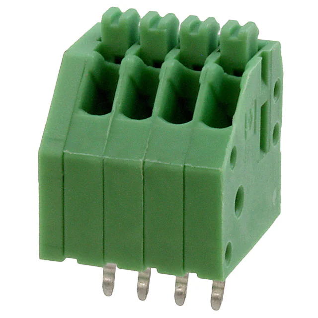

COMBICON compact; Spring-Cage PCB Termination Blocks PTSA 0,5/... with a 2.5 mm Pitch PTSA 1,5/… with a 3.5 mm Pitch The PTSA spring-cage PCB terminal block range is characterized by an easy-to-operate angled springcage connection. It clamps solid and stranded conductors up to 0.5 or 1.5 mm2 with the pitches 2.5 and 3.5 mm. Due to the small pitches and the compact outer dimensions, this range is particularly suitable for applications in which space is critical. Typical applications include in particular lighting engineering and telecommunications. The PTSA range can be supplied as a termination block either with solder pins arranged in a row at the front, or with offset solder pins Z pinning serves to increase the voltage values up to 400 V or 630 V. Pitch spacers and different color versions make it easy to put together customized termination blocks. It is possible to intermix the pitches. Individual labeling of these products is possible. COMBICON Select The COMBICON search engine with CAD downloading COMBICON Select – the printed circuit board connection software supports your workflow from the PCB and housing layout to the ordering process with: –Systematic and fast selection of products –Universal Internet aided engineering with extensive CAD downloading –Easy-to-use e-shopping functions. select.phoenixcontact.com/combicon Phoenix Contact GmbH & Co. KG • 32823 Blomberg, Germany Phone +49 52 35 3-00 • Fax +49 52 35 3-4 12 00 • www.phoenixcontact.com Local Contact: www.phoenixcontact.com/salesnetwork PCB Termination Blocks PTSA 0,5/…-2,5-Z 2.5 mm Pitch Description PCB termination blocks, offset pins, 2.5 mm pitch, color: green No. of pos. Dim. a [mm] 2 3 4 Type Order No. Pcs./Pkt. 2.5 5 7.5 PTSA 0,5/2-2,5-Z PTSA 0,5/3-2,5-Z PTSA 0,5/4-2,5-Z 19 90 00 9 19 90 01 2 19 90 02 5 250 250 250 5 6 7 10 12.5 15 PTSA 0,5/5-2,5-Z PTSA 0,5/6-2,5-Z PTSA 0,5/7-2,5-Z 19 90 03 8 19 90 04 1 19 90 05 4 100 100 100 8 9 10 17.5 20 22.5 PTSA 0,5/8-2,5-Z PTSA 0,5/9-2,5-Z PTSA 0,5/10-2,5-Z 19 90 06 7 19 90 07 0 19 90 08 3 100 100 100 11 12 13 25 27.5 30 PTSA 0,5/11-2,5-Z PTSA 0,5/12-2,5-Z PTSA 0,5/13-2,5-Z 19 90 09 6 19 90 10 6 19 90 11 9 50 50 50 14 15 16 32.5 35 37.5 PTSA 0,5/14-2,5-Z PTSA 0,5/15-2,5-Z PTSA 0,5/16-2,5-Z 19 90 12 2 19 90 13 5 19 90 14 8 50 50 50 17 18 19 40 42.5 45 PTSA 0,5/17-2,5-Z PTSA 0,5/18-2,5-Z PTSA 0,5/19-2,5-Z 19 90 15 1 19 90 16 4 19 90 17 7 50 50 50 20 21 22 47.5 50 52.5 PTSA 0,5/20-2,5-Z PTSA 0,5/21-2,5-Z PTSA 0,5/22-2,5-Z 19 90 18 0 19 90 19 3 19 90 20 3 50 50 50 23 24 55 57.5 PTSA 0,5/23-2,5-Z PTSA 0,5/24-2,5-Z 19 90 22 9 19 90 23 2 50 50 Technical data Dimensions Pitch [mm] Hole diameter [mm] Pin dimensions [mm]x[mm] Technical data in accordance with IEC/ DIN VDE Insulating material group – Surge voltage category / contamination class –/– Rated voltage [V] Rated surge voltage [kV] Nominal current / cross section [A]/[mm2] Maximum load current / cross section [A]/[mm2] Connection capacity Solid / stranded / conductor sizes [mm2]/[mm2]/AWG Stranded with ferrule without / with plastic sleeve [mm2] Stripping length [mm] Insulating material Inflammability class in acc. with UL 94 Approval data (UL/CUL and CSA) Nominal voltage / current / conductor sizes UL/CUL: [V]/[A]/AWG CSA: [V]/[A]/AWG see description 2.5 1 0.4 x 0.75 III / 3 160 2.5 I III / 2 250 2.5 2 / 0.5 2 / 0.5 II / 2 400 2.5 0.14 - 0.5 / 0.2 - 0.5 / 24 - 20 –– 8 PA V0 –– –– Zick-zack-pinning begins at the right position. Other pinning options upon request. a + 2 ,5 1 ,5 1 2 1 1 ,5 a PHOENIX CONTACT page 2 of 5 5 3 ,6 5 2 ,3 2 ,5 1 3 ,1 1 2 ,3 2 ,5 Print-Klemmblöcke PCB Termination Blocks PTSA 1,5/…-3,5-Z 0,5/…-2,5-F im 2.5 Raster mm Pitch 3,5 mm Description PCB termination blocks, pins at the front, 2.5 mm pitch, color: green No. of pos. Dim. a [mm] 2 3 4 Type Order No. Pcs./Pkt. 2.5 5 7.5 PTSA 0,5/2-2,5-F PTSA 0,5/3-2,5-F PTSA 0,5/4-2,5-F 19 89 74 8 19 89 75 1 19 89 76 4 250 250 250 5 6 7 10 12.5 15 PTSA 0,5/5-2,5-F PTSA 0,5/6-2,5-F PTSA 0,5/7-2,5-F 19 89 77 7 19 89 78 0 19 89 79 3 100 100 100 8 9 10 17.5 20 22.5 PTSA 0,5/8-2,5-F PTSA 0,5/9-2,5-F PTSA 0,5/10-2,5-F 19 89 80 3 19 89 81 6 19 89 82 9 100 100 100 11 12 13 25 27.5 30 PTSA 0,5/11-2,5-F PTSA 0,5/12-2,5-F PTSA 0,5/13-2,5-F 19 89 83 2 19 89 84 5 19 89 85 8 50 50 50 14 15 16 32.5 35 37.5 PTSA 0,5/14-2,5-F PTSA 0,5/15-2,5-F PTSA 0,5/16-2,5-F 19 89 86 1 19 89 87 4 19 89 88 7 50 50 50 17 18 19 40 42.5 45 PTSA 0,5/17-2,5-F PTSA 0,5/18-2,5-F PTSA 0,5/19-2,5-F 19 89 89 0 19 89 90 0 19 89 91 3 50 50 50 20 21 22 47.5 50 52.5 PTSA 0,5/20-2,5-F PTSA 0,5/21-2,5-F PTSA 0,5/22-2,5-F 19 89 92 6 19 89 93 9 19 89 94 2 50 50 50 23 24 55 57.5 PTSA 0,5/23-2,5-F PTSA 0,5/24-2,5-F 19 89 95 5 19 89 99 7 50 50 Technical data Dimensions Pitch [mm] Hole diameter [mm] Pin dimensions [mm]x[mm] Technical data in accordance with IEC/ DIN VDE Insulating material group – Surge voltage category / contamination class –/– Rated voltage [V] Rated surge voltage [kV] Nominal current / cross section [A]/[mm2] Maximum load current / cross section [A]/[mm2] Connection capacity Solid / stranded / conductor sizes [mm2]/[mm2]/AWG Stranded with ferrule without / with plastic sleeve [mm2] Stripping length [mm] Insulating material Inflammability class in acc. with UL 94 Approval data (UL/CUL and CSA) Nominal voltage / current / conductor sizes UL/CUL: [V]/[A]/AWG CSA: [V]/[A]/AWG see description 2.5 1 0.4 x 0.75 III / 3 63 2.5 II / 2 250 2.5 0.14 - 0.5 / 0.2 - 0.5 / 24 - 20 –– 8 PA V0 –– –– 1 ,5 a + 2 ,5 1 2 a PHOENIX CONTACT page 3 of 5 3 ,6 7 ,3 7 ,3 2 ,5 1 3 ,1 1 1 1 ,5 2 ,5 I III / 2 250 2.5 2 / 0.5 2 / 0.5 PCB Termination Blocks PTSA 1,5/…-3,5-Z 3.5 mm Pitch No. of pos. Description PCB termination blocks, offset pins, 3.5 mm pitch, color: green Dim. a [mm] Type Order No. Pcs./Pkt. 2 3 4 3.5 7 10.5 PTSA 1,5/2-3,5-Z PTSA 1,5/3-3,5-Z PTSA 1,5/4-3,5-Z 19 85 19 5 19 85 20 5 19 85 21 8 250 250 250 5 6 7 14 17.5 21 PTSA 1,5/5-3,5-Z PTSA 1,5/6-3,5-Z PTSA 1,5/7-3,5-Z 19 85 22 1 19 85 23 4 19 85 24 7 100 100 100 8 9 10 24.5 28 31.5 PTSA 1,5/8-3,5-Z PTSA 1,5/9-3,5-Z PTSA 1,5/10-3,5-Z 19 85 25 0 19 85 26 3 19 85 27 6 100 100 100 11 12 13 35 38.5 42 PTSA 1,5/11-3,5-Z PTSA 1,5/12-3,5-Z PTSA 1,5/13-3,5-Z 19 85 28 9 19 85 29 2 19 85 30 2 50 50 50 14 15 16 45.5 49 52.5 PTSA 1,5/14-3,5-Z PTSA 1,5/15-3,5-Z PTSA 1,5/16-3,5-Z 19 85 31 5 19 85 32 8 19 85 33 1 50 50 50 17 18 19 56 59.5 63 PTSA 1,5/17-3,5-Z PTSA 1,5/18-3,5-Z PTSA 1,5/19-3,5-Z 19 85 34 4 19 85 35 7 19 85 36 0 50 50 50 20 21 22 66.5 70 73.5 PTSA 1,5/20-3,5-Z PTSA 1,5/21-3,5-Z PTSA 1,5/22-3,5-Z 19 85 37 3 19 85 38 6 19 85 39 9 50 50 50 23 24 77 80.5 PTSA 1,5/23-3,5-Z PTSA 1,5/24-3,5-Z 19 85 40 9 19 85 41 2 50 50 Technical data Dimensions Pitch [mm] Hole diameter [mm] Pin dimensions [mm]x[mm] Technical data in accordance with IEC/ DIN VDE Insulating material group – Surge voltage category / contamination class –/– Rated voltage [V] Rated surge voltage [kV] Nominal current / cross section [A]/[mm2] Maximum load current / cross section [A]/[mm2] Connection capacity Solid / stranded / conductor sizes [mm2]/[mm2]/AWG Stranded with ferrule without / with plastic sleeve [mm2] Stripping length [mm] Insulating material Inflammability class in acc. with UL 94 Approval data (UL/CUL and CSA) Nominal voltage / current / conductor sizes UL/CUL: [V]/[A]/AWG CSA: [V]/[A]/AWG see description 3.5 1 0.4 x 0.,75 I III / 2 400 4 2 / 1.5 2 / 1.5 III / 3 250 4 II / 2 630 4 0.5 - 1.5 / 0.5 - 1.5 / 20 - 16 0.5 - 1.0 / 0.5 8 PA V2 300 / 2 / 24 - 16 Zick-zack-pinning begins at the right position. Other pinning options upon request. 1 1 ,5 1 2 a + 3 ,5 2 ,3 3 ,5 a PHOENIX CONTACT page 4 of 5 5 3 ,6 5 1 3 ,1 1 1 ,5 2 ,3 3 ,5 PCB Termination Blocks PTSA 1,5/…-3,5-F 3.5 mm Pitch No. of pos. Description PCB termination blocks, pins at the front, 3.5 mm pitch, color: green Dim. a [mm] Type Order No. Pcs./Pkt. 2 3 4 3.5 7 10.5 PTSA 1,5/2-3,5-F PTSA 1,5/3-3,5-F PTSA 1,5/4-3,5-F 19 84 96 3 19 94 97 6 19 84 98 9 250 250 250 5 6 7 14 17.5 21 PTSA 1,5/5-3,5-F PTSA 1,5/6-3,5-F PTSA 1,5/7-3,5-F 19 84 99 2 19 85 00 1 19 85 01 4 100 100 100 8 9 10 24.5 28 31.5 PTSA 1,5/8-3,5-F PTSA 1,5/9-3,5-F PTSA 1,5/10-3,5-F 19 85 02 7 19 85 03 0 19 85 04 3 100 100 100 11 12 13 35 38.5 42 PTSA 1,5/11-3,5-F PTSA 1,5/12-3,5-F PTSA 1,5/13-3,5-F 19 85 05 6 19 85 06 9 19 85 07 2 50 50 50 14 15 16 45.5 49 52.5 PTSA 1,5/14-3,5-F PTSA 1,5/15-3,5-F PTSA 1,5/16-3,5-F 19 85 08 5 19 85 09 8 19 85 10 8 50 50 50 17 18 19 56 59.5 63 PTSA 1,5/17-3,5-F PTSA 1,5/18-3,5-F PTSA 1,5/19-3,5-F 19 85 11 1 19 85 12 4 19 85 13 7 50 50 50 20 21 22 66.5 70 73.5 PTSA 1,5/20-3,5-F PTSA 1,5/21-3,5-F PTSA 1,5/22-3,5-F 19 85 14 0 19 85 15 3 19 85 16 6 50 50 50 23 24 77 80.5 PTSA 1,5/23-3,5-F PTSA 1,5/24-3,5-F 19 85 17 9 19 85 18 2 50 50 Technical data I III / 2 200 4 2 / 1.5 2 / 1.5 II / 2 400 4 0.5 - 1.5 / 0.5 - 1.5 / 20 - 16 0.5 - 1.0 / 0.5 8 PA V2 1 2 a + 3 ,5 1 1 ,5 7 ,3 3 ,5 a PHOENIX CONTACT page 5 of 5 1 3 ,1 1 ,5 TNR: 5127357-02/30.04.05 300 / 2 / 24 - 16 –– 3 ,6 1 III / 3 200 4 7 ,3 3 ,5 see description 3.5 1 0.4 x 0.75  Phoenix Contact 2005 Dimensions Pitch [mm] Hole diameter [mm] Pin dimensions [mm]x[mm] Technical data in accordance with IEC/ DIN VDE Insulating material group – Surge voltage category / contamination class –/– Rated voltage [V] Rated surge voltage [kV] Nominal current / cross section [A]/[mm2] Maximum load current / cross section [A]/[mm2] Connection capacity Solid / stranded / conductor sizes [mm2]/[mm2]/AWG Stranded with ferrule without / with plastic sleeve [mm2] Stripping length [mm] Insulating material Inflammability class in acc. with UL 94 Approval data (UL/CUL and CSA) Nominal voltage / current / conductor sizes UL/CUL: [V]/[A]/AWG CSA: [V]/[A]/AWG
1985218
物料型号:PTSA 0.5/...-2.5-Z 和 PTSA 1.5/...-3.5-Z,分别代表2.5mm和3.5mm间距的PCB接线端子。
器件简介:PTSA系列是COMBICON品牌的紧凑型弹簧笼式PCB接线端子,具有易于操作的斜角弹簧笼连接方式,适用于空间受限的应用场合,如照明工程和电信。
引脚分配:PTSA系列提供不同位数的引脚分配,从2位到24位不等,且有偏移引脚和前端引脚两种类型。
参数特性:接线端子适用于2.5mm和3.5mm的间距,可以夹持0.5或1.5mm²的单股或多股导线。Z型插针用于提高电压等级至400V或630V。
功能详解:COMBICON Select软件支持从PCB和外壳布局到订购流程的工作流程,提供系统化和快速的产品选择、全面的互联网辅助工程、易于使用的电子购物功能。
应用信息:PTSA系列特别适用于照明工程和电信等空间受限的应用。
封装信息:提供了不同位数的尺寸信息,从2位到24位,以及相应的尺寸参数。
技术数据:包括间距、孔径、引脚尺寸、额定电压、额定冲击电压、额定电流/截面积、最大负载电流/截面积、连接容量、导线尺寸等详细信息。
