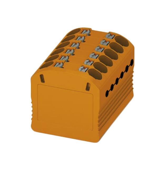

PTFIX 12X1,5-G OG - Distribution block 3002904 https://www.phoenixcontact.com/us/products/3002904 Please be informed that the data shown in this PDF document is generated from our online catalog. Please find the complete data in the user documentation. Our general terms of use for downloads are valid. Distribution block, bridged internally, nom. voltage: 450 V, nominal current: 17.5 A, number of connections: 12, connection method: Push-in connection, cross section: 0.14 mm2 - 2.5 mm2, mounting type: adhesive, color: orange Your advantages • Space-saving, thanks to the compact design • Flexible use, thanks to DIN rail and direct mounting • Space-saving potential distribution, thanks to compact micro potential distributors • Convenient test options, thanks to test openings at every terminal point • Clear arrangement thanks to marking of all terminal points Commercial data Item number 3002904 Packing unit 1 pc Minimum order quantity 20 pc Sales key BE09 Product key BEA114 Catalog page Page 432 (C-1-2019) GTIN 4055626433097 Weight per piece (including packing) 11.31 g Weight per piece (excluding packing) 9.99 g Customs tariff number 85369010 Country of origin PL Jan 8, 2024, 10:15 AM Page 1 (18) PTFIX 12X1,5-G OG - Distribution block 3002904 https://www.phoenixcontact.com/us/products/3002904 Technical data Notes General the blocks can be bridged with one another via the conductor shaft, for corresponding plug-in bridges, see accessories Product properties Product type Distributor terminal block Number of connections 12 Number of rows 1 Potentials 1 Insulation characteristics Overvoltage category III Degree of pollution 3 Electrical properties Rated surge voltage 6 kV Maximum power dissipation for nominal condition 0.56 W Connection data Number of connections per level 12 Nominal cross section 1.5 mm² Rated cross section AWG 14 Stripping length 8 mm ... 10 mm Internal cylindrical gage A1 / B1 Connection in acc. with standard IEC 60998-2-2 Conductor cross section rigid 0.14 mm² ... 2.5 mm² Cross section AWG 26 ... 14 (converted acc. to IEC) Conductor cross section flexible 0.14 mm² ... 1.5 mm² Conductor cross section, flexible [AWG] 26 ... 16 (converted acc. to IEC) Conductor cross-section flexible (ferrule without plastic sleeve) 0.14 mm² ... 1.5 mm² Flexible conductor cross section (ferrule with plastic sleeve) 0.14 mm² ... 1.5 mm² Nominal current 17.5 A Maximum load current 22 A Maximum total current 26 A Nominal voltage 450 V Connection cross sections directly pluggable Conductor cross section rigid 0.34 mm² ... 2.5 mm² Conductor cross section, rigid [AWG] 26 ... 14 (converted acc. to IEC) Conductor cross-section flexible (ferrule without plastic sleeve) 0.34 mm² ... 1.5 mm² Flexible conductor cross section (ferrule with plastic sleeve) 0.34 mm² ... 1.5 mm² Dimensions Jan 8, 2024, 10:15 AM Page 2 (18) PTFIX 12X1,5-G OG - Distribution block 3002904 https://www.phoenixcontact.com/us/products/3002904 Width 24.9 mm Height 21.6 mm Depth 18.7 mm Material specifications Color orange Flammability rating according to UL 94 V0 Insulating material group I Insulating material PA Static insulating material application in cold -60 °C Temperature index of insulation material (DIN EN 60216-1 (VDE 0304-21)) 130 °C Relative insulation material temperature index (Elec., UL 746 B) 130 °C Fire protection for rail vehicles (DIN EN 45545-2) R22 HL 1 - HL 3 Fire protection for rail vehicles (DIN EN 45545-2) R23 HL 1 - HL 3 Fire protection for rail vehicles (DIN EN 45545-2) R24 HL 1 - HL 3 Fire protection for rail vehicles (DIN EN 45545-2) R26 HL 1 - HL 3 Calorimetric heat release NFPA 130 (ASTM E 1354) 28 MJ/kg Surface flammability NFPA 130 (ASTM E 162) passed Specific optical density of smoke NFPA 130 (ASTM E 662) passed Smoke gas toxicity NFPA 130 (SMP 800C) passed Mechanical properties Mechanical data Open side panel No Mechanical tests Attachment on the carrier DIN rail/fixing support NS 35/NS 15 Result Test passed Note When aligning several blocks, it is recommended to either place a DIN rail adapter underneath the connection point or a flange element between the blocks. For versions with 6 or 7 connections, it is enough to place one DIN rail adapter centrally per block and place flange elements after every other block. When using the DIN rail adapter PTFIX-NS35, an aligned block must not protrude by more than a half. Environmental and real-life conditions Aging Temperature cycles 192 Needle-flame test Time of exposure 30 s Jan 8, 2024, 10:15 AM Page 3 (18) PTFIX 12X1,5-G OG - Distribution block 3002904 https://www.phoenixcontact.com/us/products/3002904 Result Test passed Ambient conditions Ambient temperature (storage/transport) -25 °C ... 60 °C (for a short time, not exceeding 24 h, -60 °C to +70 °C) Ambient temperature (assembly) -5 °C ... 70 °C Ambient temperature (actuation) -5 °C ... 70 °C Permissible humidity (storage/transport) 30 % ... 70 % Standards and regulations Connection in acc. with standard IEC 60998-2-2 Mounting Mounting type adhesive Jan 8, 2024, 10:15 AM Page 4 (18) PTFIX 12X1,5-G OG - Distribution block 3002904 https://www.phoenixcontact.com/us/products/3002904 Drawings Circuit diagram Jan 8, 2024, 10:15 AM Page 5 (18) PTFIX 12X1,5-G OG - Distribution block 3002904 https://www.phoenixcontact.com/us/products/3002904 Approvals To download certificates, visit the product detail page: https://www.phoenixcontact.com/us/products/3002904 DNV Approval ID: TAE00002TT-04  Nominal voltage UN Nominal current IN Cross section AWG Cross section mm2 500 V 24 A - - Nominal voltage UN Nominal current IN Cross section AWG Cross section mm2 300 V 20 A 26 - 12 - 150 V 20 A 26 - 12 - 300 V 10 A 26 - 12 - Nominal voltage UN Nominal current IN Cross section AWG Cross section mm2 450 V 17.5 A - - 1.5 Nominal current IN Cross section AWG Cross section mm2 CSA Approval ID: 13631 Use group B Use group C Use group D IECEE CB Scheme   Approval ID: DE1-63083 EAC Approval ID: RU C-DE.BL08.B.00644 LR   Approval ID: LR2002627TA BV Approval ID: 59146/A0 BV   VDE Zeichengenehmigung Approval ID: 40047798 cULus Recognized Approval ID: E60425 Nominal voltage UN Use group B Jan 8, 2024, 10:15 AM Page 6 (18) PTFIX 12X1,5-G OG - Distribution block 3002904 https://www.phoenixcontact.com/us/products/3002904 300 V 20 A 26 - 12 - 150 V 20 A 26 - 12 - 500 V 20 A 26 - 12 - 300 V 10 A 26 - 12 - Use group C Use group F Use group D Jan 8, 2024, 10:15 AM Page 7 (18) PTFIX 12X1,5-G OG - Distribution block 3002904 https://www.phoenixcontact.com/us/products/3002904 Classifications ECLASS ECLASS-11.0 27141120 ECLASS-13.0 27250118 ETIM ETIM 9.0 EC000897 UNSPSC UNSPSC 21.0 39121400 Jan 8, 2024, 10:15 AM Page 8 (18) PTFIX 12X1,5-G OG - Distribution block 3002904 https://www.phoenixcontact.com/us/products/3002904 Environmental product compliance China RoHS Environmentally friendly use period: unlimited = EFUP-e No hazardous substances above threshold values Jan 8, 2024, 10:15 AM Page 9 (18) PTFIX 12X1,5-G OG - Distribution block 3002904 https://www.phoenixcontact.com/us/products/3002904 Accessories Note: Applying some accessories below might limit this product. FBS 2-4 - Plug-in bridge 3030116 https://www.phoenixcontact.com/us/products/3030116 Plug-in bridge, pitch: 4.2 mm, number of positions: 2, color: red Max. current carrying capacity: 17.5 A FBS 2-4 GY - Plug-in bridge 3030118 https://www.phoenixcontact.com/us/products/3030118 Plug-in bridge, pitch: 4.2 mm, number of positions: 2, color: gray Max. current carrying capacity: 17.5 A Jan 8, 2024, 10:15 AM Page 10 (18) PTFIX 12X1,5-G OG - Distribution block 3002904 https://www.phoenixcontact.com/us/products/3002904 FBS 2-4 BU - Plug-in bridge 3030117 https://www.phoenixcontact.com/us/products/3030117 Plug-in bridge, pitch: 4.2 mm, number of positions: 2, color: blue Max. current carrying capacity: 17.5 A SK 3,8 REEL P4,15 WH CUS - Marker card 0825990 https://www.phoenixcontact.com/us/products/0825990 Marker card, can be ordered: by card, white, labeled according to customer specifications, mounting type: adhesive, for terminal block width: 4.15 mm, lettering field size: continuous x 3.8 mm Jan 8, 2024, 10:15 AM Page 11 (18) PTFIX 12X1,5-G OG - Distribution block 3002904 https://www.phoenixcontact.com/us/products/3002904 TML (EX3,8)R - Marker strip 0801837 https://www.phoenixcontact.com/us/products/0801837 Marker strip, Roll, white, unlabeled, can be labeled with: THERMOMARK E.300 (D)/600 (D), THERMOMARK ROLL 2.0, THERMOMARK ROLL, THERMOMARK ROLL X1, THERMOMARK ROLLMASTER 300/600, THERMOMARK X1.2, mounting type: adhesive, lettering field size: continuous x 3.8 mm, Number of individual labels: 12 TML (104X3,8)R - Marker strip 0801833 https://www.phoenixcontact.com/us/products/0801833 Marker strip, Roll, white, unlabeled, can be labeled with: THERMOMARK E.300 (D)/600 (D), THERMOMARK ROLL 2.0, THERMOMARK ROLL, THERMOMARK ROLL X1, THERMOMARK ROLLMASTER 300/600, THERMOMARK X1.2, mounting type: adhesive, for terminal block width: 104 mm, lettering field size: 104 x 3.8 mm, Number of individual labels: 2500 Jan 8, 2024, 10:15 AM Page 12 (18) PTFIX 12X1,5-G OG - Distribution block 3002904 https://www.phoenixcontact.com/us/products/3002904 ISH 1,5/0,2 - Insulating sleeve 3206131 https://www.phoenixcontact.com/us/products/3206131 Insulating sleeve, color: white ISH 1,5/0,5 - Insulating sleeve 3031034 https://www.phoenixcontact.com/us/products/3031034 Insulating sleeve, color: gray Jan 8, 2024, 10:15 AM Page 13 (18) PTFIX 12X1,5-G OG - Distribution block 3002904 https://www.phoenixcontact.com/us/products/3002904 TML (104X2,8)R - Marker strip 0801832 https://www.phoenixcontact.com/us/products/0801832 Marker strip, Roll, white, unlabeled, can be labeled with: THERMOMARK E.300 (D)/600 (D), THERMOMARK ROLL 2.0, THERMOMARK ROLL, THERMOMARK ROLL X1, THERMOMARK ROLLMASTER 300/600, THERMOMARK X1.2, mounting type: adhesive, for terminal block width: 104 mm, lettering field size: 104 x 2.8 mm, Number of individual labels: 2500 TML (EX2,8)R - Marker strip 0801836 https://www.phoenixcontact.com/us/products/0801836 Marker strip, Roll, white, unlabeled, can be labeled with: THERMOMARK E.300 (D)/600 (D), THERMOMARK ROLL 2.0, THERMOMARK ROLL, THERMOMARK ROLL X1, THERMOMARK ROLLMASTER 300/600, THERMOMARK X1.2, mounting type: adhesive, for terminal block width: 30000 mm, lettering field size: continuous x 2.8 mm, Number of individual labels: 14 Jan 8, 2024, 10:15 AM Page 14 (18) PTFIX 12X1,5-G OG - Distribution block 3002904 https://www.phoenixcontact.com/us/products/3002904 SK 2,8 REEL P4,15 WH CUS - Marker card 8199987 https://www.phoenixcontact.com/us/products/8199987 Marker card, can be ordered: by card, white, labeled according to customer specifications, mounting type: adhesive, for terminal block width: 4.15 mm, lettering field size: continuous x 2.8 mm US-TML (104X3,8) - Marker for terminal blocks 0830768 https://www.phoenixcontact.com/us/products/0830768 Marker for terminal blocks, Card, white, unlabeled, can be labeled with: BLUEMARK ID COLOR, BLUEMARK ID, THERMOMARK PRIME, THERMOMARK CARD 2.0, THERMOMARK CARD, mounting type: adhesive, lettering field size: 104 x 3.8 mm, Number of individual labels: 22 Jan 8, 2024, 10:15 AM Page 15 (18) PTFIX 12X1,5-G OG - Distribution block 3002904 https://www.phoenixcontact.com/us/products/3002904 US-TML (104X2,8) - Marker for terminal blocks 0830767 https://www.phoenixcontact.com/us/products/0830767 Marker for terminal blocks, Card, white, unlabeled, can be labeled with: BLUEMARK ID COLOR, BLUEMARK ID, THERMOMARK PRIME, THERMOMARK CARD 2.0, THERMOMARK CARD, mounting type: adhesive, lettering field size: 104 x 2.8 mm, Number of individual labels: 26 SK U/3,8 WH:UNBEDRUCKT - Marker card 0803906 https://www.phoenixcontact.com/us/products/0803906 Marker card, Din A4, white, unlabeled, can be labeled with: PLOTMARK, CMSP1-PLOTTER, Office printing systems, mounting type: adhesive, for terminal block width: 210 mm, lettering field size: 186 x 3.8 mm, Number of individual labels: 1440 Jan 8, 2024, 10:15 AM Page 16 (18) PTFIX 12X1,5-G OG - Distribution block 3002904 https://www.phoenixcontact.com/us/products/3002904 SK U/2,8 WH:UNBEDRUCKT - Marker card 0803883 https://www.phoenixcontact.com/us/products/0803883 Marker card, Din A4, white, unlabeled, can be labeled with: PLOTMARK, CMSP1-PLOTTER, Office printing systems, mounting type: adhesive, for terminal block width: 210 mm, lettering field size: 186 x 2.8 mm, Number of individual labels: 3600 MM-TML (EX3,8)R C1 WH/BK - Label 1092026 https://www.phoenixcontact.com/us/products/1092026 Label, Roll, white/black, unlabeled, can be labeled with: THERMOFOX, THERMOMARK GO, THERMOMARK GO.K, mounting type: adhesive, lettering field size: continuous x 2.8 mm, Number of individual labels: 1 Jan 8, 2024, 10:15 AM Page 17 (18) PTFIX 12X1,5-G OG - Distribution block 3002904 https://www.phoenixcontact.com/us/products/3002904 MPS-MT 1-S4-B RD - Accessories 1982800 https://www.phoenixcontact.com/us/products/1982800 Test plug terminal block, Accessories Phoenix Contact 2024 © - all rights reserved https://www.phoenixcontact.com Phoenix Contact USA 586 Fulling Mill Road Middletown, PA 17057, United States (+717) 944-1300 info@phoenixcon.com Jan 8, 2024, 10:15 AM Page 18 (18)

物料型号:3002904
器件简介:这是一个内部桥接的分线端子块,具有紧凑的设计,适用于节省空间的安装。它支持DIN导轨和直接安装,具有多种安装和测试优势。
引脚分配:该分线端子块共有12个连接点,排成1行,每个连接点都清晰标记。
参数特性: - 额定冲击电压:6kV - 最大功率耗散(额定条件下):0.56W - 额定电流:17.5A - 最大负载电流:22A - 最大总电流:26A - 额定电压:450V
功能详解:分线端子块提供了方便的测试选项,每个端点都有测试开口,并且所有端点都进行了标记,以便于清晰安排。
应用信息:适用于多种电气连接和分配任务,特别是在需要节省空间和灵活安装的场合。
封装信息: - 宽度:24.9 mm - 高度:21.6 mm - 深度:18.7 mm - 材料颜色:橙色 - 材料规格:包括绝缘材料组、耐温性能等详细信息
