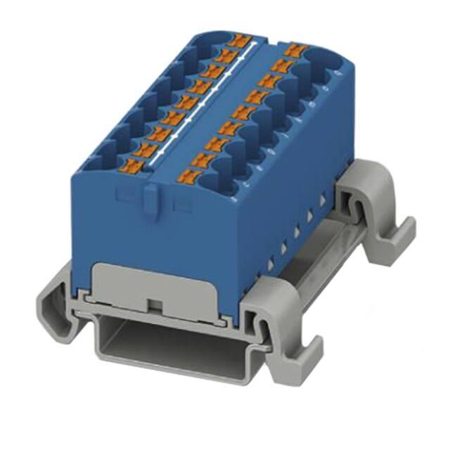

PTFIX 18X4-NS35A BU - Distribution block 3273704 https://www.phoenixcontact.com/us/products/3273704 Please be informed that the data shown in this PDF document is generated from our online catalog. Please find the complete data in the user documentation. Our general terms of use for downloads are valid. Distribution block, Block with horizontal alignment, nom. voltage: 800 V, nominal current: 32 A, number of connections: 18, connection method: Push-in connection, cross section: 0.2 mm2 - 6 mm2, mounting type: NS 35/7,5, NS 35/15, color: blue Your advantages • Space savings of up to 50 % on the DIN rail, thanks to transverse mounting • Flexible use, thanks to DIN rail mounting, direct mounting or adhesive mounting • Clear wiring, thanks to eleven different color variants • Time savings of up to 80 %, thanks to ready-to-mount blocks without manual bridging • Time-saving conductor connection, thanks to tool-free Push-in direct connection technology Commercial data Item number 3273704 Packing unit 1 pc Minimum order quantity 8 pc Sales key BE09 Product key BEA115 Catalog page Page 449 (C-1-2019) GTIN 4055626646718 Weight per piece (including packing) 46.92 g Weight per piece (excluding packing) 22.22 g Customs tariff number 85369010 Country of origin PL Jan 8, 2024, 10:20 AM Page 1 (19) PTFIX 18X4-NS35A BU - Distribution block 3273704 https://www.phoenixcontact.com/us/products/3273704 Technical data Notes General the blocks can be bridged with one another via the conductor shaft, for corresponding plug-in bridges, see accessories General Note The maximum load current of a single clamping unit must not be exceeded. Product properties Product type Distributor terminal block Number of connections 18 Number of rows 1 Potentials 1 Insulation characteristics Overvoltage category III Degree of pollution 3 Electrical properties Rated surge voltage 6 kV Maximum power dissipation for nominal condition 1.02 W Connection data Number of connections per level 18 Nominal cross section 4 mm² Rated cross section AWG 10 Stripping length 10 mm ... 12 mm Internal cylindrical gage A4 Connection in acc. with standard IEC 60947-7-1 Conductor cross section rigid 0.2 mm² ... 6 mm² Cross section AWG 24 ... 10 (converted acc. to IEC) Conductor cross section flexible 0.2 mm² ... 4 mm² Conductor cross section, flexible [AWG] 24 ... 12 (converted acc. to IEC) Conductor cross-section flexible (ferrule without plastic sleeve) 0.2 mm² ... 4 mm² Flexible conductor cross section (ferrule with plastic sleeve) 0.2 mm² ... 4 mm² 2 conductors with the same cross section, flexible, with TWIN ferrule with plastic sleeve 0.5 mm² ... 1 mm² Nominal current 32 A Maximum load current 41 A Maximum total current 63 A Nominal voltage 800 V Connection cross sections directly pluggable Conductor cross section rigid 0.5 mm² ... 6 mm² Jan 8, 2024, 10:20 AM Page 2 (19) PTFIX 18X4-NS35A BU - Distribution block 3273704 https://www.phoenixcontact.com/us/products/3273704 Conductor cross section, rigid [AWG] 20 ... 10 (converted acc. to IEC) Conductor cross-section flexible (ferrule without plastic sleeve) 0.75 mm² ... 4 mm² Flexible conductor cross section (ferrule with plastic sleeve) 0.5 mm² ... 4 mm² Dimensions Width 55.4 mm Height 45.7 mm Depth on NS 35/7,5 30.9 mm Material specifications Color blue Flammability rating according to UL 94 V0 Insulating material group I Insulating material PA Static insulating material application in cold -60 °C Temperature index of insulation material (DIN EN 60216-1 (VDE 0304-21)) 130 °C Relative insulation material temperature index (Elec., UL 746 B) 130 °C Fire protection for rail vehicles (DIN EN 45545-2) R22 HL 1 - HL 3 Fire protection for rail vehicles (DIN EN 45545-2) R23 HL 1 - HL 3 Fire protection for rail vehicles (DIN EN 45545-2) R24 HL 1 - HL 3 Fire protection for rail vehicles (DIN EN 45545-2) R26 HL 1 - HL 3 Calorimetric heat release NFPA 130 (ASTM E 1354) 28 MJ/kg Surface flammability NFPA 130 (ASTM E 162) passed Specific optical density of smoke NFPA 130 (ASTM E 662) passed Smoke gas toxicity NFPA 130 (SMP 800C) passed Electrical tests Surge voltage test Test voltage setpoint 9.8 kV Result Test passed Temperature-rise test Requirement temperature-rise test Increase in temperature ≤ 45 K Result Test passed Short-time withstand current 4 mm² 0.48 kA Short-time withstand current 6 mm² 0.72 kA Result Test passed Power-frequency withstand voltage Test voltage setpoint 2 kV Result Test passed Mechanical properties Mechanical data Jan 8, 2024, 10:20 AM Page 3 (19) PTFIX 18X4-NS35A BU - Distribution block 3273704 https://www.phoenixcontact.com/us/products/3273704 Open side panel No Mechanical tests Mechanical strength Result Test passed Attachment on the carrier DIN rail/fixing support NS 35/NS 15 Test force setpoint 5N Result Test passed Note When aligning several blocks, it is recommended to either place a DIN rail adapter underneath the connection point or a flange element between the blocks. For versions with 6 or 7 connections, it is enough to place one DIN rail adapter centrally per block and place flange elements after every other block. When using the DIN rail adapter PTFIX-NS35, an aligned block must not protrude by more than a half. Test for conductor damage and slackening Rotation speed 10 rpm Revolutions 135 Conductor cross section/weight 0.2 mm² / 0.2 kg 4 mm² / 0.9 kg 6 mm² / 1.4 kg Result Test passed Environmental and real-life conditions Aging Temperature cycles 192 Result Test passed Needle-flame test Time of exposure 30 s Result Test passed Oscillation/broadband noise Specification DIN EN 50155 (VDE 0115-200):2008-03 Spectrum Service life test category 2, bogie-mounted Frequency f1 = 5 Hz to f2 = 250 Hz ASD level 6.12 (m/s²)²/Hz Acceleration 3.12g Test duration per axis 5h Test directions X-, Y- and Z-axis Result Test passed Shocks Jan 8, 2024, 10:20 AM Page 4 (19) PTFIX 18X4-NS35A BU - Distribution block 3273704 https://www.phoenixcontact.com/us/products/3273704 Specification DIN EN 50155 (VDE 0115-200):2008-03 Pulse shape Half-sine Acceleration 30g Shock duration 18 ms Number of shocks per direction 3 Test directions X-, Y- and Z-axis (pos. and neg.) Result Test passed Ambient conditions Ambient temperature (storage/transport) -25 °C ... 60 °C (for a short time, not exceeding 24 h, -60 °C to +70 °C) Ambient temperature (assembly) -5 °C ... 70 °C Ambient temperature (actuation) -5 °C ... 70 °C Permissible humidity (storage/transport) 30 % ... 70 % Standards and regulations Connection in acc. with standard IEC 60947-7-1 Mounting Mounting type NS 35/7,5 NS 35/15 Jan 8, 2024, 10:20 AM Page 5 (19) PTFIX 18X4-NS35A BU - Distribution block 3273704 https://www.phoenixcontact.com/us/products/3273704 Drawings Circuit diagram Jan 8, 2024, 10:20 AM Page 6 (19) PTFIX 18X4-NS35A BU - Distribution block 3273704 https://www.phoenixcontact.com/us/products/3273704 Approvals To download certificates, visit the product detail page: https://www.phoenixcontact.com/us/products/3273704 DNV Approval ID: TAE00002TT-04  Nominal voltage UN Nominal current IN Cross section AWG Cross section mm2 500 V 24 A - - Nominal voltage UN Nominal current IN Cross section AWG Cross section mm2 600 V 32 A 24 - 10 - 600 V 32 A 24 - 10 - Nominal voltage UN Nominal current IN Cross section AWG Cross section mm2 800 V 32 A - -4 Nominal voltage UN Nominal current IN Cross section AWG Cross section mm2 600 V 32 A 24 - 10 - CSA Approval ID: 13631 Use group B Use group C IECEE CB Scheme   Approval ID: DE1-62701 EAC Approval ID: RU C-DE.BL08.B.00644 LR   Approval ID: LR2002627TA BV Approval ID: 59146/A0 BV   VDE Zeichengenehmigung Approval ID: 40047797 cULus Recognized Approval ID: E60425 Use group B Use group C Jan 8, 2024, 10:20 AM Page 7 (19) PTFIX 18X4-NS35A BU - Distribution block 3273704 https://www.phoenixcontact.com/us/products/3273704 600 V 32 A 24 - 10 - Jan 8, 2024, 10:20 AM Page 8 (19) PTFIX 18X4-NS35A BU - Distribution block 3273704 https://www.phoenixcontact.com/us/products/3273704 Classifications ECLASS ECLASS-11.0 27141120 ECLASS-13.0 27250118 ETIM ETIM 9.0 EC000897 UNSPSC UNSPSC 21.0 39121400 Jan 8, 2024, 10:20 AM Page 9 (19) PTFIX 18X4-NS35A BU - Distribution block 3273704 https://www.phoenixcontact.com/us/products/3273704 Environmental product compliance China RoHS Environmentally friendly use period: unlimited = EFUP-e No hazardous substances above threshold values Jan 8, 2024, 10:20 AM Page 10 (19) PTFIX 18X4-NS35A BU - Distribution block 3273704 https://www.phoenixcontact.com/us/products/3273704 Accessories FBS 2-6 - Plug-in bridge 3030336 https://www.phoenixcontact.com/us/products/3030336 Plug-in bridge, pitch: 6.2 mm, number of positions: 2, color: red FBS 2-6 GY - Plug-in bridge 3032237 https://www.phoenixcontact.com/us/products/3032237 Plug-in bridge, pitch: 6.2 mm, number of positions: 2, color: gray Jan 8, 2024, 10:20 AM Page 11 (19) PTFIX 18X4-NS35A BU - Distribution block 3273704 https://www.phoenixcontact.com/us/products/3273704 FBS 2-6 BU - Plug-in bridge 3036932 https://www.phoenixcontact.com/us/products/3036932 Plug-in bridge, pitch: 6.2 mm, number of positions: 2, color: blue SK 6,2/3,8:FORTL.ZAHLEN - Marker card 0804374 https://www.phoenixcontact.com/us/products/0804374 Marker card, white, labeled, horizontal: consecutive numbers 1 ... 10, 11 ... 20, etc. up to 91 ... (99)100, mounting type: adhesive, for terminal block width: 6.2 mm, lettering field size: 6.2 x 3.8 mm Jan 8, 2024, 10:20 AM Page 12 (19) PTFIX 18X4-NS35A BU - Distribution block 3273704 https://www.phoenixcontact.com/us/products/3273704 SK 6,2/3,8:FORTL.ZAHLEN 1-10 - Marker for terminal blocks 0804374:0001 https://www.phoenixcontact.com/us/products/0804374:0001 Marker card, self-adhesive, horizontally labeled with the consecutive numbers: 1 ... 10, 10-section marker strips with 12 identical decades, white, for terminal block width: 6.2 mm, mounting type: adhesive SK 6,2/3,8:FORTL.ZAHLEN 11-20 - Marker for terminal blocks 0804374:0011 https://www.phoenixcontact.com/us/products/0804374:0011 Marker card, self-adhesive, horizontally labeled with the consecutive numbers: 11 ... 20, 10-section marker strips with 12 identical decades, white, for terminal block width: 6.2 mm, mounting type: adhesive Jan 8, 2024, 10:20 AM Page 13 (19) PTFIX 18X4-NS35A BU - Distribution block 3273704 https://www.phoenixcontact.com/us/products/3273704 SK 6,2/3,8:FORTL.ZAHLEN 21-30 - Marker for terminal blocks 0804374:0021 https://www.phoenixcontact.com/us/products/0804374:0021 Marker card, self-adhesive, horizontally labeled with the consecutive numbers: 21 ... 30, 10-section marker strips with 12 identical decades, white, for terminal block width: 6.2 mm, mounting type: adhesive SK 6,2/3,8:FORTL.ZAHLEN 31-40 - Marker for terminal blocks 0804374:0031 https://www.phoenixcontact.com/us/products/0804374:0031 Marker card, self-adhesive, horizontally labeled with the consecutive numbers: 31 ... 40, 10-section marker strips with 12 identical decades, white, for terminal block width: 6.2 mm, mounting type: adhesive Jan 8, 2024, 10:20 AM Page 14 (19) PTFIX 18X4-NS35A BU - Distribution block 3273704 https://www.phoenixcontact.com/us/products/3273704 SK 6,2/3,8:FORTL.ZAHLEN 41-50 - Marker for terminal blocks 0804374:0041 https://www.phoenixcontact.com/us/products/0804374:0041 Marker card, self-adhesive, horizontally labeled with the consecutive numbers: 41 ... 50, 10-section marker strips with 12 identical decades, white, for terminal block width: 6.2 mm, mounting type: adhesive US-TML (104X3,8) - Marker for terminal blocks 0830768 https://www.phoenixcontact.com/us/products/0830768 Marker for terminal blocks, Card, white, unlabeled, can be labeled with: BLUEMARK ID COLOR, BLUEMARK ID, THERMOMARK PRIME, THERMOMARK CARD 2.0, THERMOMARK CARD, mounting type: adhesive, lettering field size: 104 x 3.8 mm, Number of individual labels: 22 Jan 8, 2024, 10:20 AM Page 15 (19) PTFIX 18X4-NS35A BU - Distribution block 3273704 https://www.phoenixcontact.com/us/products/3273704 US-TML (104X2,8) - Marker for terminal blocks 0830767 https://www.phoenixcontact.com/us/products/0830767 Marker for terminal blocks, Card, white, unlabeled, can be labeled with: BLUEMARK ID COLOR, BLUEMARK ID, THERMOMARK PRIME, THERMOMARK CARD 2.0, THERMOMARK CARD, mounting type: adhesive, lettering field size: 104 x 2.8 mm, Number of individual labels: 26 SK U/3,8 WH:UNBEDRUCKT - Marker card 0803906 https://www.phoenixcontact.com/us/products/0803906 Marker card, Din A4, white, unlabeled, can be labeled with: PLOTMARK, CMSP1-PLOTTER, Office printing systems, mounting type: adhesive, for terminal block width: 210 mm, lettering field size: 186 x 3.8 mm, Number of individual labels: 1440 Jan 8, 2024, 10:20 AM Page 16 (19) PTFIX 18X4-NS35A BU - Distribution block 3273704 https://www.phoenixcontact.com/us/products/3273704 SK U/2,8 WH:UNBEDRUCKT - Marker card 0803883 https://www.phoenixcontact.com/us/products/0803883 Marker card, Din A4, white, unlabeled, can be labeled with: PLOTMARK, CMSP1-PLOTTER, Office printing systems, mounting type: adhesive, for terminal block width: 210 mm, lettering field size: 186 x 2.8 mm, Number of individual labels: 3600 TML (EX3,8)R - Marker strip 0801837 https://www.phoenixcontact.com/us/products/0801837 Marker strip, Roll, white, unlabeled, can be labeled with: THERMOMARK E.300 (D)/600 (D), THERMOMARK ROLL 2.0, THERMOMARK ROLL, THERMOMARK ROLL X1, THERMOMARK ROLLMASTER 300/600, THERMOMARK X1.2, mounting type: adhesive, lettering field size: continuous x 3.8 mm, Number of individual labels: 12 Jan 8, 2024, 10:20 AM Page 17 (19) PTFIX 18X4-NS35A BU - Distribution block 3273704 https://www.phoenixcontact.com/us/products/3273704 TML (104X3,8)R - Marker strip 0801833 https://www.phoenixcontact.com/us/products/0801833 Marker strip, Roll, white, unlabeled, can be labeled with: THERMOMARK E.300 (D)/600 (D), THERMOMARK ROLL 2.0, THERMOMARK ROLL, THERMOMARK ROLL X1, THERMOMARK ROLLMASTER 300/600, THERMOMARK X1.2, mounting type: adhesive, for terminal block width: 104 mm, lettering field size: 104 x 3.8 mm, Number of individual labels: 2500 TML (104X2,8)R - Marker strip 0801832 https://www.phoenixcontact.com/us/products/0801832 Marker strip, Roll, white, unlabeled, can be labeled with: THERMOMARK E.300 (D)/600 (D), THERMOMARK ROLL 2.0, THERMOMARK ROLL, THERMOMARK ROLL X1, THERMOMARK ROLLMASTER 300/600, THERMOMARK X1.2, mounting type: adhesive, for terminal block width: 104 mm, lettering field size: 104 x 2.8 mm, Number of individual labels: 2500 Jan 8, 2024, 10:20 AM Page 18 (19) PTFIX 18X4-NS35A BU - Distribution block 3273704 https://www.phoenixcontact.com/us/products/3273704 TML (EX2,8)R - Marker strip 0801836 https://www.phoenixcontact.com/us/products/0801836 Marker strip, Roll, white, unlabeled, can be labeled with: THERMOMARK E.300 (D)/600 (D), THERMOMARK ROLL 2.0, THERMOMARK ROLL, THERMOMARK ROLL X1, THERMOMARK ROLLMASTER 300/600, THERMOMARK X1.2, mounting type: adhesive, for terminal block width: 30000 mm, lettering field size: continuous x 2.8 mm, Number of individual labels: 14 MM-TML (EX3,8)R C1 WH/BK - Label 1092026 https://www.phoenixcontact.com/us/products/1092026 Label, Roll, white/black, unlabeled, can be labeled with: THERMOFOX, THERMOMARK GO, THERMOMARK GO.K, mounting type: adhesive, lettering field size: continuous x 2.8 mm, Number of individual labels: 1 Phoenix Contact 2024 © - all rights reserved https://www.phoenixcontact.com Phoenix Contact USA 586 Fulling Mill Road Middletown, PA 17057, United States (+717) 944-1300 info@phoenixcon.com Jan 8, 2024, 10:20 AM Page 19 (19)

物料型号:3273704
器件简介:这是一个Phoenix Contact品牌的分布式块,具有18个连接点,适用于额定电压800V和额定电流32A的应用。
引脚分配:文档中没有明确提供引脚分配图,但提到每个连接点可以连接0.2mm²至6mm²的导线。
参数特性: - 额定冲击电压:6kV - 最大功率耗散:1.02W - 额定电流:32A - 最大负载电流:41A - 最大总电流:63A - 额定电压:800V
功能详解:该分布式块可以通过导线轴相互桥接,并且支持使用Push-in直接连接技术进行无需工具的导线连接。
应用信息:适用于需要节省空间、灵活使用、清晰布线和节省时间的应用场景。
封装信息:分布式块的宽度为55.4mm,高度为45.7mm,安装在NS 35/7.5上的深度为30.9mm。颜色为蓝色,材料为PA,具有UL 94 V0的阻燃等级。
