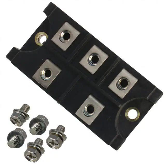

    DIODE MOD 3PH BRDG 800V 100A
ME500810 数据手册
ME500810 Powerex, Inc., 200 Hillis Street, Youngwood, Pennsylvania 15697-1800 (724) 925-7272 Three-Phase Diode Bridge Modules 100 Amperes/800 Volts Description: Powerex Three-Phase Diode Bridge Modules are designed for use in three-phase bridge application. The modules are isolated consisting of six rectifier diodes. A B G G M - DIA. (2 TYP.) J + C H - Features: K N - M5 THD (5 TYP.) D E M Isolated Mounting M Planar Chips L F ME500810 Three-Phase Diode Bridge Modules 100 Amperes/800 Volts Applications: M Inverters M DC Power Supplies M AC Motor Control Front End Outline Drawing Dimension A B Inches 3.15 2.677±0.010 Millimeters 80 68±0.25 Ordering Information: Select the complete eight digit module part number you desire from the table below. Example: ME500810 is an 800 Volt, 100 Ampere ThreePhase Diode Bridge Module. C 1.57 40 D 1.18 30 Type E 1.16 29.5 ME50 F 1.04 26.5 G 0.79 20 H 0.45 11.5 J 0.41 10.5 K 0.39 10 L 0.31 M 0.216 Dia. N M5 Metric Voltage Volts (x100) Current Rating Amperes (x10) 08 10 8 Dia. 5.5 M5 D-79 Powerex, Inc., 200 Hillis Street, Youngwood, Pennsylvania 15697-1800 (724) 925-7272 ME500810 Three-Phase Diode Bridge Modules 100 Amperes/800 Volts Absolute Maximum Ratings Characteristics Symbol Peak Reverse Blocking Voltage VRRM VRSM Transient Peak Reverse Blocking Voltage (Non-Repetitive), t < 5ms DC Reverse Blocking Voltage DC Output Current, TC = 102°C Peak One-Cycle Surge (Non-Repetitive) On-State Current (60Hz) Peak One-Cycle Surge (Non-Repetitive) On-State Current (50Hz) I2t (for Fusing), 8.3 milliseconds Storage Temperature Operating Temperature Maximum Mounting Torque M6 Mounting Screw Units 800 Volts 960 Volts 640 Volts 100 Amperes IFSM IFSM 1000 Amperes 910 Amperes I2t 4200 A2sec TSTG Tj -40 to 125 °C — -40 to 150 26 °C in.-lb. Maximum Mounting Torque M5 Terminal Screw — 17 in.-lb. Module Weight (Typical) — 220 Grams V Isolation D-80 VR(DC) IO ME500810 VRMS 2500 Volts Powerex, Inc., 200 Hillis Street, Youngwood, Pennsylvania 15697-1800 (724) 925-7272 ME500810 Three-Phase Diode Bridge Modules 100 Amperes/800 Volts Electrical and Thermal Characteristics, Tj = 25°C unless otherwise specified Characteristics Symbol Test Conditions ME500810 Units Blocking State Maximums Reverse Leakage Current, Peak IRRM Tj = 150°C, VRRM = Rated 10 mA Conducting State Maximums Peak On-State Voltage VFM IFM = 100A 1.2 Ru(J-C) Ru(C-S) Per Module 0.2 °C/Watt Per Module 0.06 °C/Watt Thermal Maximums Thermal Resistance, Junction-to-Case Thermal Resistance, Case-to-Sink (Lubricated) Volts D-81 Powerex, Inc., 200 Hillis Street, Youngwood, Pennsylvania 15697-1800 (724) 925-7272 ME500810 Three-Phase Diode Bridge Modules 100 Amperes/800 Volts 1.8 1.6 1.4 1.2 1.0 0.8 102 1000 800 600 400 200 0 100 0.6 101 103 TRANSIENT THERMAL IMPEDANCE, Zu(J-C)(t), (oC/WATT) MAXIMUM POWER DISSIPATION, PAV(MAX), (WATTS) 300 250 200 150 100 50 0 40 60 80 100 DC OUTPUT CURRENT, IO, (AMPERES) 102 120 0.25 0.20 0.15 0.10 0.05 0 10-3 10-2 10-1 TIME, t, (SECONDS) 160 150 140 130 120 110 100 90 80 0 0 20 40 60 80 100 DC OUTPUT CURRENT, IO, (AMPERES) TRANSIENT THERMAL IMPEDANCE CHARACTERISTICS (JUNCTION-TO-CASE) MAXIMUM ON-STATE POWER DISSIPATION 20 101 CYCLES AT 60 HZ INSTANTANEOUS ON-STATE CURRENT, IFM, (AMPERES) 0 MAXIMUM ALLOWABLE CASE TEMPERATURE, TC, (oC) Tj = 25oC MAXIMUM PEAK SURGE (NON-REPETITIVE) CURRENT, IFSM, (AMPERES) INSTANTANEOUS ON-STATE VOLTAGE, VFM, (VOLTS) 1200 2.0 100 D-82 MAXIMUM ALLOWABLE CASE TEMPERATURE MAXIMUM ALLOWABLE PEAK SURGE (NON-REPETITIVE) CURRENT MAXIMUM ON-STATE CHARACTERISTICS 100 101 120
