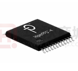

PFS7628C-TL
PFS7628C-TL
    POWERINT(帕沃英蒂格盛)
    InSOP-24B
    功率因数修正(PFC) InSOP-24B 22kHz~123kHz
PFS7628C-TL 数据手册
HiperPFS-4 Family PFC Controller with Integrated 600 V MOSFET and Diode Option Optimized for High PF and Efficiency Across Load Range Key Benefits • High efficiency and power factor across load range • >95% efficiency from 10% load to 100% load • 0.95 achievable at 20% load for H and L packages • Programmable Power Good (PG) signal • Digital line peak detection for robust performance even with distorted input voltage from UPS or generators • Digital power factor enhancer compensates for EMI filter and bridge distortion • Spread-spectrum across >60 kHz window simplifies EMI filtering • Protection features include: UVLO, UV, OV, OTP, brown-in/out, cycleby-cycle current limit and power limiting for overload protection • Withstands 305 VAC steady-state and 410 VAC abnormal input • Eliminates insulating pad/heat-spreader D + HiperPFS-4 VCC PG VCC CONTROL FB C AC IN DC OUT PGT S V G REF PI-7965-100318 Figure 1a. Typical Application Schematic without Integrated Diode. Applications • • • • • PC Printer LCD TV Video game consoles 80 Plus™ Platinum designs D • High-power adaptors K + • High-power LED lighting VCC PG • Industrial and appliance VCC • Generic PFC converters CONTROL FB C AC IN DC OUT PGT HiperPFS-4 S V G REF PI-7224a-042720 Figure 1b. Typical Application Schematic with Integrated Diode. InSOP-24B (C Package) eSIP-16D (H Package) eSIP-16G (L Package) Figure 2. Package Options. Body Dimensions: 10.8 mm x 9.4 mm for C Package and 16.53 mm x 8.25 mm for H & L Packages. www.power.com August 2020 This Product is Covered by Patents and/or Pending Patent Applications. PFS7x23-7x29/7633-7636 Output Power Table Universal Input Devices (C Package) Without Integrated Diode Product Continuous Output Power at 90 VAC PFS7623C 75 W PFS7624C 90 W PFS7626C 105 W PFS7628C 110 W Universal Input Devices (H and L Packages) Without Integrated Diode Product Continuous Output Power at 90 VAC Peak Output Power PFS7623H/L 110 W 120 W PFS7624H/L 130 W 150 W PFS7625H/L 185 W 205 W PFS7626H/L 230 W 260 W PFS7627H/L 290 W 320 W PFS7628H/L 350 W 385 W PFS7629H/L 405 W 450 W High-Line Input Only Devices (H Package) Without Integrated Diode Continuous Output Power at 180 VAC Peak Output Power PFS7633H 255 W 280 W PFS7634H 315 W 350 W PFS7635H 435 W 480 W PFS7636H 550 W 610 W Product Universal Input Devices With Integrated Diode Product Maximum Continuous Output Power Rating at 90 VAC (Full Power Mode) Peak Output Power (Full Power Mode) PFS7723L/H 110 W 120 W PFS7724L/H 130 W 150 W PFS7725L/H 185 W 205 W 260 W PFS7726H 230 W PFS7727H 290 W 320 W PFS7728H 350 W 385 W PFS7729H 405 W 450 W Table 1. Output Power Table (See Table 2 on page 12 for Maximum Continuous Output Power Ratings.) 2 Rev. F 08/20 www.power.com PFS7x23-7x29/7633-7636 Description The HiperPFS™-4 devices incorporate a continuous conduction mode (CCM) boost PFC controller, gate driver and 600 V power MOSFET in a single, low-profile (GROUND pin connected) power package. HiperPFS-4 devices eliminate need for external current sense resistors and their associated power loss, and use an innovative control technique that adjusts the switching frequency over output load, input line voltage, and input line cycle. This control technique maximizes efficiency over the entire load range, particularly at light loads. Additionally, it minimizes the EMI filtering requirements due to its wide bandwidth spread spectrum effect. The HiperPFS-4 uses advanced digital techniques for line monitoring, line feed-forward scaling, and power factor enhancement; while using analog techniques for the core controller in order to maintain extremely low no-load power consumption. The HiperPFS-4 also features an integrated non-linear error amplifier for enhanced load transient response, a user programmable Power Good (PG) signal as well as user selectable power limit functionality. HiperPFS-4 includes Power Integrations’ standard set of comprehensive protection features, such as UV, OV, brown-in/out, and hysteretic thermal shutdown. HiperPFS-4 also provides cycle-by-cycle current limit and Safe Operating Area (SOA) protection of the power MOSFET, output power limiting for overload protection, and pin-to-pin short-circuit protection HiperPFS-4’s innovative variable frequency continuous conduction mode operation (VF-CCM) minimizes switching losses by maintaining a low average switching frequency, while modulating the switching frequency in order to suppress EMI, the traditional challenge with continuous conduction mode solutions. Systems using HiperPFS-4 typically reduce the total X and Y capacitance requirements of the converter, the inductance of both the boost choke and EMI noise suppression chokes, thereby reducing overall system size and cost. Additionally, HiperPFS-4 devices dramatically reduce component count and board footprint while simplifying system design and enhancing reliability, when compared with designs that use discrete MOSFETs and controllers. The innovative variable frequency, continuous conduction mode controller enables the HiperPFS-4 to realize all of the benefits of continuous conduction mode operation while leveraging low-cost, small, simple EMI filters. Many regions mandate high power factor for many electronic products with high power requirements. These rules are combined with numerous application-specific standards that require high power supply efficiency across the entire load range, from full load to as low as 10% load. High efficiency at light load is a challenge for traditional PFC solutions where fixed MOSFET switching frequencies cause fixed switching losses on each cycle, even at light loads. In addition to featuring flat efficiency across the load range, HiperPFS-4 also enables a high power factor of >0.95 at 20% load. HiperPFS-4 simplifies compliance with new and emerging energy-efficiency standards over a broad market space in applications such as PCs, LCD TVs, notebooks, appliances, pumps, motors, fans, printers and LED lighting. HiperPFS-4’s advanced power packaging technology and high efficiency simplify the complexity of mounting the IC and thermal management, while providing very high power capabilities in a single compact package; these devices are suitable for PFC applications with maximum continuous power from 75 W to 405 W universal (550 W high-line only). Product Highlights Protected Power Factor Correction Solution • Incorporates 600 V power MOSFET, controller and gate driver. • EN61000-3-2 Class C and Class D compliance. • Integrated protection features reduce external component count • Accurate built-in brown-in/out protection. • • • • • • Accurate built-in undervoltage (UV) protection. Accurate built-in overvoltage (OV) protection. Hysteretic thermal shutdown (OTP). Internal power limiting function for overload protection. Cycle-by-cycle power-switch current limit. Internal non-linear error amplifier for enhanced load transient response • No external current sense resistor required. • Provides ‘lossless’ internal sensing via sense-FET. • Reduces component count and system losses. • Minimizes high current gate drive loop area. • Minimizes output overshoot and stresses during start-up • Integrated power limit. • Improved dynamic response. • Digitally controlled input line feed-forward gain adjustment for flattened loop gain across entire input voltage range. • Eliminates up to 39 discrete components for higher reliability and lower cost. Solution for High Efficiency, Low EMI and High PF • Continuous conduction mode PFC uses novel constant amp-second [on-time] volt-second [off-time] control. • High efficiency across load. • High power factor across load. • Frequency sliding technique for light load efficiency improvements. • >95% efficiency from 10% load to full load achievable at nominal input voltages. • Variable switching frequency to simplify EMI filter design. • Varies over line input voltage to maximize efficiency and minimize EMI filter requirements. • Varies with input line cycle voltage by >60 kHz to maximize spread spectrum effect. Advanced Package for High Power Applications (H & L Packages) • Up to 450 W [universal], 610 W [high-line only] peak output power capability in a highly compact package. • Simple adhesive or clip mounting to heat sink. • No insulation pad required and can be directly connected to heat sink. • Staggered pin arrangement allows simple routing of board traces and to meet high-voltage creepage requirements. • Single package solution for PFC converter reduces assembly costs and layout size. SMD Package (C Package) • Allows the elimination of metal heat sink. • Use PCB copper foil for heat dissipation. Pin Functional Description BIAS POWER (VCC) Pin This is a 10.2-15 VDC [12 V typical] bias supply used to power the IC. The bias voltage must be externally clamped to prevent the BIAS POWER pin from exceeding 15 VDC to ensure long-term reliability REFERENCE (REF) Pin This pin is connected to an external bypass capacitor and is used to program the IC for either FULL or EFFICIENCY power mode. The external capacitor is connected between the REFERENCE and SIGNAL GROUND [G] pins. Note: the return trace to the ground pin must not be shared with other return traces that may pass large return currents during surge events. The REFERENCE pin has two valid capacitor values to select ‘Full’ (1.0 mF ±20%) or ‘Efficiency’ (0.1 mF ±20%) power modes. SIGNAL GROUND (G) Pin Discrete components used in the feedback circuit, including loop compensation, decoupling capacitors for the BIAS POWER (VCC), REFERENCE (REF) and VOLTAGE MONITOR (V) must be referenced to 3 www.power.com Rev. F 08/20 PFS7x23-7x29/7633-7636 the SIGNAL GROUND (G) pin. The SIGNAL GROUND pin is also connected to the tab of the device. The SIGNAL GROUND pin should not be tied directly to the SOURCE pin external to the IC. VOLTAGE MONITOR (V) Pin The VOLTAGE MONITOR pin is tied to the rectified high-voltage DC rail through a 100:1, 1% high-impedance resistor divider to minimize power dissipation and standby power consumption. The recommended resistance value is between 8 MW and 16 MW. Changing this divider ratio affects peak power limit, brown-in/out thresholds and will degrade input current quality (reduce power factor and increase THD). A small ceramic capacitor forming an 80 ms nominal timeconstant must be connected between the VOLTAGE MONITOR pin to the SIGNAL GROUND pin to bypass any switching noise present on the rectified DC bus. This pin also features brown-in/out detection thresholds and incorporates a weak current source that acts as a pull-down in the event of an open circuit condition. COMPENSATION (C) Pin This pin is used for loop pole/zero compensation of the OTA error amplifier via the connection of a network of capacitors and a resistor between the COMPENSATION pin and SIGNAL GROUND pin. The COMPENSATION pin connects internally to the output of the OTA error amplifier and the input to the on-time and off-time controllers. FEEDBACK (FB) Pin This pin is connected to the main voltage regulation feedback resistor divider network and is also used for fast over and undervoltage protection. This pin also detects the presence of the feedback voltage divider network at start-up and during operation. The divider ratio should be the same as the VOLTAGE MONITOR pin for proper H Package (eSIP-16D) (Front View) and optimized power limit and power factor. A large upper resistor between 8 MW and 16 MW ±1% is recommended. A small ceramic capacitor between FEEDBACK and SIGNAL GROUND, forming a nominal 80 ms time-constant with the bottom resistor, is required. POWER GOOD (PG) Pin Use of the PG function is optional. The POWER GOOD pin is an active low, open-drain connection which sinks current when the output voltage is in regulation. At start-up, once the FEEDBACK pin voltage has risen to ~95% of the internal reference voltage, the POWER GOOD pin is asserted low. After start-up, the output voltage threshold at which the PG signal becomes high-impedance depends on the threshold programmed by the POWER GOOD THRESHOLD pin resistor. When not used, the POWER GOOD pin is left unconnected. POWER GOOD THRESHOLD (PGT) Pin This pin is used to program the output voltage threshold at which the PG signal becomes high-impedance representing the PFC stage falling out of regulation. The low threshold for the PG signal is programmed with a resistor between the POWER GOOD THRESHOLD and SIGNAL GROUND pins. Tying the POWER GOOD THRESHOLD to the REFERENCE pin disables the power good function (i.e. POWER GOOD pin remains high impedance). SOURCE (S) Pins These pins are the source connection of the power switch as well as the negative bulk capacitor terminal connection. DRAIN (D) Pin This is the drain connection of the internal power switch. Boost Diode Cathode (K) Pin This is the cathode connection of the internal Qspeed diode. H Package (eSIP-16D) (Back View) Pin 1 I.D. G L Package (eSIP-16G) (Front View) Exposed Pad (Backside of Both H and L Packages) Internally Connected to GROUND (G) Pin G Pin 1 I.D. NC S 14 16 NC/K 13 D 9 11 PGT S 24 S D 16-19 7 FB VCC REF G V C FB PG PGT S S D NC NC/K C Package (InSOP-24B) (Top View) 8 10 PG 1 5 V NC/K NC D S S PGT PG FB C V G REF VCC 16 14 13 1110 9 8 7 6 5 4 3 NC 13 NC 14 NC 15 3 6 C 3 4 5 6 7 8 910 11 1314 16 REF 1 4 G VCC 1 Exposed Pad (Backside) Not Shown Note pin 16 is NC for PFS76xx and K pin for PFS772x. C Package (InSOP-24B) (Bottom View) 12 11 10 9 8 7 6 5 4 3 2 1 G NC NC NC PGT PG FB C V REF G VCC Exposed Pad Connected to DRAIN (D) Pin PI-8616-081320 Figure 3. Pin Configuration. 4 Rev. F 08/20 www.power.com PFS7x23-7x29/7633-7636 DRAIN (D) BOOST DIODE CATHODE (K) BIAS POWER (VCC) VOLTAGE MONITOR (V) INPUT LINE INTERFACE VV 12 V GATE DRIVER REF SERIES/SHUNT REGULATOR + - PEAK DETECTOR ADC BROWN-IN/ OUT DETECT UVLO Integrated Qspeed Ultrafast Diode (Diode option in PFS772xH/L only) BO, BI HL/LL MON(PFE) IOCP VCC MOFF × (VFB - VV) ~(VO-VIN) LOW/HIGH LINE DETECT VBRST FBREF VPG(H) FBUV FBOFF FBOV Off-Time Controller CINT PF ENHANCER + REFERENCE (REF) IPGT REFERENCE AND BAND GAP PON FEEDBACK Pin OV/UV/OFF Power MOSFET ISNS IOCP + VCC Latch LEB - TIMER SUPERVISOR senseFET + VOFF + VOFF VOFF is a function of the error-voltage (VE) and is used to reduce the average operating frequency as a function of output power Frequency Slide HL/LL Non-Linear OTA + + OCP - - FBREF FEEDBACK (FB) OTA - POWER LIMIT SOA RAMP Feedback UV VBRST - Feedback OFF On-Time Controller CINT FBUV - FBOFF + PON × MON(PFE) × ISNS MON(PFE) is the switch current sense scale factor which is a function of the peak input voltage Buffer and De-Glitch Filter + + HL/LL FBOV + VE VE Feedback OV VFB + VPG(H) REF - START-UP, FMEA CHECKS SOURCE (S) SIGNAL GROUND (G) IPGT POWER GOOD THRESHOLD (PGT) POWER GOOD (PG) COMPENSATION (C) PI-7969a-081920 Figure 4. Functional Block Diagram. Functional Description The HiperPFS-4 family are variable switching frequency boost PFC devices. It employs a constant amp-second on-time and constant volt-second off-time control algorithm. This algorithm is used to regulate the output voltage and shape the input current to comply with regulatory harmonic current limits (high power factor). Integrating the switch current and controlling it to have a constant amp-sec product over the on-time of the switch allows the average input current to follow the input voltage. Integrating the difference between the output and input voltage maintains a constant voltsecond balance dictated by the electro-magnetic properties of the boost inductor and thus regulates the output voltage and power. More specifically, the control technique sets constant volt-seconds for the off-time (tOFF). The off-time is controlled such that: ^ V O - V IN h # t OFF = K 1 (1) (2) Since the volt-seconds during the on-time must equal the voltseconds during the off-time, to maintain flux equilibrium in the PFC choke, the on-time (tON) is controlled such that V IN # t ON = K 1 The controller also sets a constant value of charge delivered during each on-cycle of the power MOSFET. The charge per cycle is varied gradually over many switching cycles in response to load changes so it can be considered constant for a half line cycle. With this constant charge (or amp-second) control, the following relationship is therefore also true: I IN # t ON = K 2 Substituting tON from (2) into (3) gives: V IN # K 2 I IN = (3) (4) K1 The relationship of (4) demonstrates that by controlling a constant amp-second on-time and constant volt-second off-time, the input current IIN is proportional to the input voltage VIN, therefore providing the fundamental requirement of power factor correction. This control produces a continuous mode power switch current waveform that varies both in frequency and peak current value across a line half-cycle to produce an input current proportional to the input voltage. 5 www.power.com Rev. F 08/20 PFS7x23-7x29/7633-7636 Control Engine The controller features a low bandwidth, high gain OTA error-amplifier of which its non-inverting terminal is connected to an internal voltage reference of 3.85 V. The inverting terminal of the error-amplifier is available on the external FEEDBACK pin which connects to the output voltage divider network with a divider ratio of 1:100 to regulate the output voltage to 385 V nominally. The FEEDBACK pin connects directly to the divider network for fast transient load response. The internally sensed FET switch current is scaled by the input voltage peak detector current sense gain (MON) then integrated and compared with the error-amplifier signal (VE) to determine the cycle on-time. Internally the difference between the input and output voltage is derived and the resultant is scaled, integrated, and compared to a voltage reference (VOFF) to determine the cycle off-time. Careful selection of the internal scaling factors produce input current waveforms with very low distortion and high power factor. Line Feed-Forward Scaling Factor (MON) and PF Enhancer The VOLTAGE MONITOR (V) pin voltage is sampled and converted by a Δ-Σ ADC to a quantized digital value. A digital line cycle peak detector, with dynamic time constants and multi-cycle filtering, derives and smooths the peak of the input line voltage. This peak is used internally to scale the gain of the current sense signal through the MON variable. This contribution is required to reduce the dynamic range of the control feedback signal as well as flatten the loop gain over the operating input line range. The line-sense feed-forward gain adjustment is proportional to the square of the peak rectified AC line voltage and is adjusted as a function of the VOLTAGE MONITOR pin voltage. At high-line and light load, the feed-forward MON variable is dynamically adjusted across the line cycle in order to compensate for the line current distortion through the EMI filter and full bridge network, and improve power factor. VE Latch RESET IS dt VOFF Latch SET (VOUT-VIN)dt Gate Drive (Q) Maximum ON-time Minimum OFF-time Timing Supervisor PI-5335-061615 The line-sense feed-forward gain is also important in providing a switch power limit over the input line range. This characteristic is optimized to maintain a relatively constant internal error-voltage level at full load from an input line of 90 to 230 VAC. Beyond the specified peak power rating of the device, the internal power limit will regulate the output voltage below the set regulation threshold as a function of output overload to maintain constant output power. Figure 6 illustrates the typical regulation characteristic as a function of load. Below the brown-in threshold (VBR+) the power limit is reduced when the device is operated in the ‘Full’ power mode as shown in Figure 7. As the input line voltage is reduced toward the brown-out threshold (VBR-) and if the load exceeds the power limit derating, the boost output voltage will drop out of regulation in accordance with Figure 6. The rated peak power shown in Table 1 is not derated for voltages below the brown-in threshold when the device is operated in the ‘Efficiency’ mode. Start-Up with Pin-to-Pin Short-Circuit Protection At start-up, the engine performs a sequence of operational checks and pin short/open evaluations, as shown in Figure 8, prior to the commencement of switching. When the input voltage peak is above brown-in, the engine enables switching. The OTA error amplifier provides a non-linear amplifier (NLA) mechanism to overcome the inherently slow feedback loop response when the sensed output voltage on the FEEDBACK pin is outside its regulation window. This allows the error amplifier function to limit the maximum overshoot and undershoot during load transient events. To reduce switch and output diode current stress at start-up, the HiperPFS-4 calculates off-time based upon output voltage (VOUT) during start-up, resulting in a relatively soft controlled start-up. Once the applied VCC is above the VCCUVLO+ threshold, and the output of the on-chip VREF regulator is above REFUV+, the value of the REFERENCE pin capacitor is detected and the full or efficiency power mode is latched. The pin open/short tests are performed, and if the FEEDBACK pin voltage is valid the over-temperature OTP is checked to be false. Once the preceding checks are satisfied the input voltage is monitored via the VOLTAGE MONITOR pin until it exceeds the VBR+ threshold [but the peak detector is not saturated]. It is at this point that switching is enabled. Timing Supervisor and Operating Frequency Range The controller operates with a variable switching frequency over the line frequency half-cycle, typically spanning a range of 22 – 123 kHz when operating in CCM, the controller also features a timing supervisor function which monitors and limits the maximum switch on-time and off-time as well as ensures a minimum cycle on-time. Figure 9(a) shows the typical half-line frequency profile of the device switching frequency as a function of input voltage at peak load conditions. Figure 9(b) shows for a given line condition of 115 VAC, the effect of EcoSmart™ on the switching frequency as a function of load. Figure 5. Idealized Converter Waveforms. 6 Rev. F 08/20 www.power.com 0.8 0.6 0.4 0.2 0.0 0.0 0.2 0.4 0.6 0.8 1.0 1.2 Normalized to Peak Output Power Rating Figure 6. Typical Normalized Output Voltage Characteristics as Function of Normalized Peak Load Rating for eSIP Package. 1.2 PI-7544a-112216 1.0 Normalized Minimum Power Limit 1.2 PI-7227-061615 Normalized to Set Output Voltage Regulation Threshold PFS7x23-7x29/7633-7636 1.0 0.8 0.6 0.4 0.2 0 PFS7623-29 70 PFS7633-39 160 75 80 170 85 90 180 95 100 190 Input Voltage (VAC) Figure 7. Normalized Minimum Power Limit as Function of Input Voltage for H and L Packages. Start NO YES NO Apply Current to C Pin for 65 µs VCC > UVLO+ and REF > REFUV+? YES Reference Capacitor Valid? (C > 2.5 V) or Feedback < FBOFF NO Remove Current Source on C Pin, Short C to G YES Capacitor Reset: Short C to G for 230 µs YES NO Feedback > FBOFF YES Remove Short on C Pin OTP Fault NO NO Peak Valid and Peak > VBR+ YES Remove C to G Short, Start Switching PI-7249-061615 Figure 8. Start-Up Flow Chart. 7 www.power.com Rev. F 08/20 PFS7x23-7x29/7633-7636 EcoSmart The HiperPFS-4 includes an EcoSmart function wherein the internal error signal (VE) is used to detect the converter output power. This sets the average switching frequency as a function of output power. currents constitute the majority of the load. Higher output voltage ripple at light load is an artifact of efficient burst mode operation. Power Good Signal (PG) The HiperPFS-4 features a ‘power good’ (PG) circuit which comprises an internal comparator that turns ‘on’ an open-drain switch during start-up when the sensed output voltage on the FEEDBACK pin rises to ~95% (VPG+) of the output voltage threshold. During start-up, prior to the output voltage reaching VPG+, the PG signal is in a high-impedance state (internal switch is in off-state). As shown in Figure 10, the off-time integrator control reference (VOFF) is controlled with respect to the internal error-voltage level (output power) to allow the converter to maintain output voltage regulation and relatively flat conversion efficiency from 20% to 100% of rated load, which is essential to meet many efficiency directives. The degree of frequency slide is also controlled as a function of input line voltage. The lower VOFF slope as a function of input voltage reduces the average frequency extremes for high input line operation. 135 VAC 230 VAC 180 VAC 90 VAC 115 VAC Peak Load 45 0 90 135 180 130 120 110 100 90 80 70 60 50 40 30 20 10 0 VIN = 115 VAC 100% Peak Load d Expected Frequency Range at Peak Rated Load P k Load L d 75% Peak 50% Peak a Load 25% Peak Load 0 Line Conduction Angle (°) 45 90 135 Line Conduction Angle (°) Figure 9. (a) Frequency Variation over Line Half-Cycle as a Function of Input Voltage (b) Frequency Variation over Line Half-Cycle as a Function of Load. Note: Frequency Profiles Shown were Analytically Derived and Reflect CCM Operation Across the Entire Line Cycle. VA VB VOFF(MAX) VOFF VA VIN < 140 VAC VB VIN > 170 VAC 4.0 V (Full Power) VE 4 V 5.2 V 140 VAC VIN 170 VAC PI-7228-061615 Figure 10. EcoSmart Frequency Slide VOFF vs. VE and VOFF(MAX) vs. Input Voltage. 8 Rev. F 08/20 PI-7232-0616154 130 120 110 100 90 80 70 60 50 40 30 20 10 0 PI-7231-061615 Frequency (kHz) Burst-Mode for No-Load Power Consumption Reduction Under no-load conditions the HiperPFS-4 engine is architected to enter a burst mode which gates the power switch on and off between fixed error voltage levels. This ensures low power consumption by switching in bursts in order to maintain regulation when leakage Frequency (kHz) The power good signal transitions from ‘on’ to off-state when the sensed output voltage on the FEEDBACK pin falls to a user selected threshold, programmed via resistor on the POWER GOOD THRESHOLD (PGT) pin. The POWER GOOD THRESHOLD pin sources a fixed current IPGT. This current combined with the power good threshold resistor sets the threshold when the power good signal transitions from the on-state to the high-impedance off-state as the PFC output falls out of regulation. www.power.com 180 PFS7x23-7x29/7633-7636 The power good comparator has an internal 81 µs de-glitch filter (tPGD) to prevent noise events from falsely triggering the programmed VPGthreshold. In the event a load fault prevents the boost from achieving regulation (above ~95% of the set output voltage threshold) the PG function will remain in the high-impedance state and will not indicate when an output voltage has fallen below the user programmed VPG- threshold. The VPG- user programmed threshold is enabled once the VPG+ threshold has been reached. If the POWER GOOD THRESHOLD programming pin is tied to REFERENCE pin, the power good function is disabled and PG remains in the high-impedance (‘off’) state. This is the preferred configuration when PG is not in use. If the POWER GOOD THRESHOLD pin is shorted to the SIGNAL GROUND pin, the PG signal will transition to the on-state at VPG+ and remain low (‘on’) until the PFC output voltage has fallen below the VFB_UV threshold for greater than tFB_UV seconds. Similar to the disable condition described above, if the value of the PGT resistor is such that the VPG- threshold is greater than the VPG+ threshold, the PG signal will latch off and remain in the high-impedance off-state. The Power Good function is not valid under the following conditions: A. VCC or VREF are not in a valid range of operation. VCC below UVLOor VREF below REFUV- the power good function is not valid with the POWER GOOD pin in a high-impedance state. B. Power Good will go to high-impedance state when a soft shutdown is initiated by an over-temperature fault to provide early indication to secondary circuits of an OT fault. C. PGT is outside the valid programming range of between 225 V and 360 V. PGT voltages above this range, including PGT floating, will prevent PG from transitionning to active pull-down. PGT voltages below this range result in PG deassertion at the output undervoltage (VFB_UV) threshold. D. Once the start-up sequence check has passed and the converter goes into start-up, if PGT is opened, then the PG signal will remain latched in the high-impedance state until the controller is reset. Selectable Power Limit The capacitor on the REFERENCE pin allows user selection between ’full’ and ‘efficiency’ power limit for each device. The ‘efficiency’ power mode will permit user selection of a larger device for a given output power requirement for increased conversion efficiency. In ‘full’ power mode the REFERENCE pin capacitor is 1.0 mF ±20% and the ‘efficiency’ power limit mode is selected with a 0.1 mF ±20% capacitor. If the REFERENCE pin is accidentally shorted to ground, the IC will disable switching and remain disabled until all conditions for the start-up sequence are satisfied.. If the REFERENCE pin is open-circuit, the absence of a bypass capacitor will prevent start-up. During operation, an open-circuit may result in enough REFERENCE pin noise to result in a VREF REFUV- shutdown. Protection Modes Brown-In Protection (VBR+) The VOLTAGE MONITOR pin has an input line undervoltage detection to limit the minimum start-up voltage. This detection threshold will inhibit the device from starting at input voltages below brown-in and above input peak voltages of 400 VPK. Brown-Out Protection (VBR-) The VOLTAGE MONITOR pin features a brown-out protection mode wherein the HiperPFS-4 will turn-off when the VOLTAGE MONITOR pin voltage is below the line undervoltage threshold (VBR-) for a period exceeding tBRWN_OUT (brown-out debounce period). In the event a single half-line cycle is missing (normal operating line frequency is 47 Hz to 63 Hz) the brown-out detection will not be initiated. Once brown-out has been triggered, the HiperPFS-4 soft-shutdown gradually reduces the internal error-voltage to zero volts over a period of 1 ms to ramp the power MOSFET on-time to zero. The onset of this soft-shutdown is aligned to the next line cycle zero crossing to minimize reactive component di/dt transients and allow time for the energy stored within the boost choke as well as the input EMI filter to dissipate. This helps minimize voltage transients after the bridge rectifier, which helps to prevent false restarts. The device will enter Set internally by VPG+ 100% VOUT (385 V) 95% VOUT (365 V) Output Voltage Rising 87.5% VOUT (337 V) Set externally by RPGT R PG = 0.875 # 3.85 = 3.37 V = 337 kX I PG 10 nA tPGD tPGD PG = High Impedance PG = On-State tPG Output Voltage Falling PG = High Impedance PI-7229-061615 Figure 11. Power Good Function Description. 9 www.power.com Rev. F 08/20 PFS7x23-7x29/7633-7636 After a brown-in event, until after the tSTARTUP timer has expired, the line voltage brown-out threshold is reduced to VBR-NTC and the brown-out timer is extended to tBRWN_OUT_NTC to allow for the drop in line voltage due to an in-rush limiting negative temperature coefficient (NTC) thermistor in series with the input line. If the tBRWN_OUT_NTC debounce timer is triggered by the sensed line voltage dropping below the VBR-NTC threshold but the line voltage recovers to above the VBR-NTC threshold before the tBRWN_OUT_NTC expires, then the tSTARTUP timer will be re-started.If the line does not recover above the VBR-NTC threshold before the tBRWN_OUT_NTC debounce timer expires a shutdown will occur. After the tSTARTUP timer has expired, if the VOLTAGE MONITOR pin voltage rises above VBR-NTC, the brown-out debounce timer will switch to normal period (tBRWN_OUT) and the brown-out threshold will switch to VBR-. If the VOLTAGE MONITOR pin voltage is not qualified above VBR- after the subsequent tBRWN_OUT timer has expired then a brown-out shutdown will occur. HiperPFS-4 incorporates input waveform discrimination to determine if the line signal peak-to-average ratio is more representative of a sine wave or a high duty cycle square wave. The brown-out threshold is reduced to VBR_SQ when a high duty cycle (UPS) square wave is detected. VCC Undervoltage Protection (UVLO) The BIAS POWER (VCC) pin has an undervoltage lock-out protection which inhibits the IC from starting unless the applied VCC voltage is above the VCCUVLO+ threshold. The IC initiates a start-up once the BIAS POWER pin voltage exceeds the VCCUVLO+ threshold. After start-up the IC will continue to operate until the BIAS POWER pin voltage has fallen below the VCCUVLO- level. The absolute maximum voltage on the BIAS POWER pin is 17.5 V which must be externally limited to prevent long term damage to the IC. Line Dependent Over Current Protection (OCP) limit The device includes a cycle-by-cycle over-current protection mechanism which protects the device in the event of a fault. The intent of OCP protection in this device is protection of the internal power MOSFET and is not specifically intended to protect the converter from output short-circuit or overload fault conditions. For universal line input parts, the OCP limit is set as a function of the input line voltage, one setting for low-line voltages and another setting for high-line voltages. This helps to bound power limit into short-circuits as well as helps to minimize the stress on the switch due to current overloads at higher input line conditions. Figure 12 illustrates the hysteretic adjustment of the OCP levels as a function of VOLTAGE MONITOR pin line-sensing. This equates to selecting the low-line OCP (the greater of the two settings) when the peak of the input line voltage drops below 140 VAC for 3 consecutive half-cycles and selecting the high-line OCP level (the lesser of the two settings) when the input line voltage rises above 170 VAC for 1 half-cycle, (except in follower mode, as described in the subsequent sections). The HiperPFS-4 utilizes a high input line OCP after detecting the VOLTAGE MONITOR pin above the high-line threshold, VHIGH+. The controller reverts back to low-line OCP (as well as low-line frequency slide) only after 3 consecutive half-line cycle peak values that are IOCP(LL) IOCP an auto-restart, including FMEA pin fault checks and other start-up qualifications prior to checking for the line voltage being above the brown-in voltage by virtue of the VOLTAGE MONITOR pin being above VBR+. IOCP(HL) ~140 VAC VIN ~170 VAC PI-7255-061615 Figure 12. Line Dependent OCP. below the low-line threshold VHIGH-. In the event of a line drop-out, the controller may revert from high-line to low-line parameters if the drop-out exceeds 37 ms (nominal). High-line only input parts use a single fixed OCP threshold. A follower-mode feature updates the controller to high-line status rapidly, as soon as the input voltage exceeds VHIGH+. This feature has particular benefit for high-line hard-start conditions after a long AC line drop-out where the peak detector may initially indicate a low input line condition. A leading edge blanking circuit inhibits the current limit comparator for a short time (tLEB) after the power MOSFET is turned on. This leading edge blanking time is set so that switch current spikes caused by drain capacitance and rectifier reverse recovery time will not cause premature termination of the MOSFET conduction period. Safe Operating Area (SOA) Mode Since the cycle-by-cycle OCP mechanism described above does not prevent the possibility of inductor current ‘stair-casing’, an SOA mode is also featured. Rapid build-up of the switch current can occur in the event of inductor saturation or when the input and output voltage differential is small combined with too little inductor reset time. The SOA mode is triggered whenever the switch current reaches current limit (IOCP) and the on-time is less than tSOA. The SOA mode forces an off-time equal to tOFF(SOA) and pulls the internal error-voltage (VE) down by 1/2 of its maximum value in order to ensure the switch remains within its SOA. Fast Output Voltage Overvoltage Protection (FBOV) The HiperPFS-4 features a voltage feedback threshold comparator on the FEEDBACK pin which detects an output voltage overvoltage condition to allow rapid response, independent of the COMPENSATION pin response, to prevent hazardous voltage conditions from occurring. The overvoltage protection is hysteretic – the voltage on the FEEDBACK pin must drop by 0.1 V (equating to an output voltage drop of 10 V) before switching is re-started. FEEDBACK to COMPENSATION Pin Short Detection Safeguard The PFC controller continuously monitors the FEEDBACK and COMPENSATION pins to ensure that there are no potential short conditions between the adjacent FEEDBACK and COMPENSATION pins, which could result in output overvoltage conditions if not detected. In the event a potential short is detected, a rapid short check is performed and a shutdown is executed in the event that a suspected short is validated. 10 Rev. F 08/20 www.power.com PFS7x23-7x29/7633-7636 Open FEEDBACK Pin Protection The FEEDBACK pin continuously sinks a static current of IFBPD [VCC >VCCUVLO+] to protect against a fault related to an open FEEDBACK pin or incomplete feedback divider network. The internal current sink introduces a small static offset to the output regulation which can be accounted for in selecting the output feedback regulation components (FEEDBACK pin divider). Hysteretic Thermal Shutdown The thermal shutdown circuit senses the controller die temperature which is well coupled to the heat sink through the exposed, grounded pad. The threshold is set at 117 °C typical with a 36 °C hysteresis. When the controller die temperature rises above this threshold (OTP), the controller initiates a soft-shutdown and remains disabled until the controller die temperature falls by ~36 °C, at which point the device will re-initiate the start-up sequence. The maximum time delay for soft-shutdown to occur after an OTP event is detected is tOTP beyond the next zero-crossing. HiperPFS-4 Additional Features and Changes HiperPFS-4 (eSIP) maintains similar pin-out as HiperPFS-3. • The breakdown voltage rating of the PFC MOSFET and diode has been increased to 600 V. • PFC output voltage can be designed for up to 440 VDC output to allow operation with 277 VAC line voltage. 11 www.power.com Rev. F 08/20 PFS7x23-7x29/7633-7636 Output Power Table for H, L and C Packages eSIP Package Without Integrated Diode Efficiency Power Mode CREF = 0.1 mF Product Maximum Continuous Output Power Rating at 90 VAC2 Full Power Mode CREF = 1.0 mF Maximum Continuous Output Power Rating at 90 VAC2 Peak Output Power Rating at 90 VAC4 Minimum3 Peak Output Power Rating at 90 VAC4 Minimum3 Maximum PFS7623H/L 65 W 90 W 100 W 85 W 110 W 120 W PFS7624H/L 80 W 110 W 125 W 100 W 130 W 150 W PFS7625H/L 110 W 150 W 170 W 140 W 185 W 205 W PFS7626H/L 140 W 190 W 215 W 180 W 230 W 260 W PFS7627H/L 175 W 235 W 265 W 220 W 290 W 320 W PFS7628H/L 210 W 285 W 320 W 270 W 350 W 385 W PFS7629H/L 245 W 335 W 375 W 300 W 405 W 450 W Efficiency Power Mode CREF = 0.1 mF Product Maximum Continuous Output Power Rating at 180 VAC2 Minimum3 Maximum PFS7633H 155 W 205 W PFS7634H 200 W PFS7635H 275 W PFS7636H 350 W 460 W Maximum Full Power Mode CREF = 1.0 mF Maximum Continuous Output Power Rating at 180 VAC2 Peak Output Power Rating at 180 VAC4 Peak Output Power Rating at 180 VAC4 Minimum3 Maximum 230 W 195 W 255 W 260 W 290 W 240 W 315 W 350 W 360 W 400 W 335 W 435 W 480 W 510 W 415 W 550 W 610 W 280 W InSOP Package Without Integrated Diode Full Power Mode CREF = 1.0 mF Maximum Continuous Output Power Rating at 90 VAC2 Product Maximum PFS7623C 75 W PFS7624C 90 W PFS7626C 105 W PFS7628C 110 W eSIP Package With Integrated Diode Efficiency Power Mode CREF = 0.1 mF Product Maximum Continuous Output Power Rating at 90 VAC2 Minimum3 Peak Output Power Rating at 90 VAC4 Maximum Full Power Mode CREF = 1.0 mF Maximum Continuous Output Power Rating at 90 VAC2 Minimum3 Peak Output Power Rating at 90 VAC4 Maximum PFS7723L/H 65 W 90 W 100 W 85 W 110 W 120 W PFS7724L/H 80 W 110 W 125 W 100 W 130 W 150 W PFS7725L/H 110 W 150 W 170 W 140 W 185 W 205 W 260 W PFS7726H 140 W 190 W 215 W 180 W 230 W PFS7727H 175 W 235 W 265 W 220 W 290 W 320 W PFS7728H 210 W 285 W 320 W 270 W 350 W 385 W PFS7729H 245 W 335 W 375 W 300 W 405 W 450 W Table 2. Output Power Table. Notes: 1. See Key Application considerations. 2. Maximum practical continuous power in an open-frame design with adequate heat sinking, measured at 50 °C ambient. 3. Recommended “efficiency power mode” for best light load efficiency. 4. Internal output power limit. 12 Rev. F 08/20 www.power.com PFS7x23-7x29/7633-7636 Application Example for H and L Packages coil reverse voltage during de-assertion transitions. Resistor R5 limits the current to the diode in the optocoupler. IC U3 provides optocoupler isolation through connector J2 for a power-good output signal if required. A High Efficiency, 275 W, 385 VDC Universal Input PFC The circuit shown in Figure 13 is designed using a device from the HiperPFS-4 family of integrated PFC controllers. This design is rated for a continuous output power of 275 W and provides a regulated output voltage of 385 VDC nominal, maintaining a high input power factor and overall efficiency from light load to full load. Capacitor C15 is used for reducing the loop length and area of the output circuit to reduce EMI and overshoot of voltage across the drain and source of the MOSFET inside U1 at each switching edge. The PFS7627H IC requires a regulated supply of 12 V for operation (15 V max). Resistors R6, R7, R8, Zener diode VR1, and transistor Q2 form a series pass regulator that prevents the supply voltage to IC U1 from exceeding 15 V. Capacitors C8, and C9 filter the supply voltage and provide bypassing and decoupling to ensure reliable operation of IC U1. Diode D3 provides reverse polarity protection. Fuse F1 provides protection to the circuit and isolates it from the AC supply in the event of a fault. Diode bridge BR1 rectifies the AC input voltage. Capacitors C1-C7 together with inductors L2 and L3 form the EMI filter which reduces the common mode and differential mode noise. Resistors R1, R2 and CAPZero-2, IC U2 are required to discharge the EMI filter capacitors once the circuit is disconnected. CAPZero-2 eliminates static losses in R1 and R2 by only connecting these components across the input when AC is removed. Resistor R15 programs the output voltage level [via the POWER GOOD THRESHOLD (PGT) pin] below which the POWER GOOD [PG] pin will go into a high-impedance state. Capacitor C14 provides noise immunity on the POWER GOOD THRESHOLD pin. Metal oxide varistor (MOV) RV1 protects the circuit during line surge events by effectively clamping the input voltage seen by the power supply. IC U1 is configured in full power mode by capacitor C10 which is connected to the REFERENCE pin. Inductor L1 and boost diode D4 in conjunction with HiperPFS-4 IC U1, form the boost converter stage, controlling the input current of the power supply while simultaneously regulating the output DC voltage. Diode D2 prevents a resonant buildup of output voltage at start-up by bypassing inductor L1 while simultaneously charging output capacitor C18. The rectified AC input voltage of the power supply is sensed by IC U1 using resistors R10-R13. These resistors values are large to minimize power consumption. Capacitor C11 connected in parallel with the bottom resistor R13 filters noise coupled into the VOLTAGE MONITOR pin. Output voltage divider network comprising resistors R16 – R19 are used to scale the output voltage and provide feedback to the IC. Capacitor C16 in parallel with resistor R19 attenuates high frequency noise. Thermistor RT1 limits the inrush input current of the circuit at start-up and prevents saturation of L1. However in the highest efficiency designs, an electro-mechanical relay RL1 will be used to bypass the thermistor once the output voltage is in regulation as indicated by a power good signal (asserted low). Resistors R3 and R4, and transistor Q1, drive relay RL1 and optocoupler U3. Diode D1 clamps the relay Components R14, C12 and C13 are required for shaping the loop response of the feedback network. D2 1N5408-T D4 LXA06T600 C3 330 nF 275 VAC F1 5A L RT1 2.5 Ω t C1 680 pF 250 VAC 90 - 264 VAC E BR1 GBU8K-BP 800 V O R1 510 kΩ C5 680 pF 250 VAC D1 L2 9 mH CAPZero U2 CAP200DG C2 680 pF 250 VAC C4 330 nF 275 V RV1 520 VAC R10 6.2 MΩ 1% R16 3.74 MΩ 1% PG VCC R11 6.2 MΩ 1% CONTROL D2 R2 510 kΩ FB C R12 3.74 MΩ 1% PGT HiperPFS-4 U1 PFS7627H S N V G REF L3 330 µH R4 16.2 kΩ 1% R3 10 kΩ 1% Q1 MMBT4403 J4-1 R6 1Ω 1% Q2 MMBT4401LT1G R14* 30.1 kΩ 1% Power Good J2-1 U3 LTV817A D1 S1AB-13-F 1 VCC Supply 2 4 R7 1Ω 1% RL1 J4-2 C8 47 µF 50 V C10 1 µF 50 V VR1 BZX384-B13,115 13 V + C15 10 nF 1 kV R15 332 kΩ 1% R8 2.21 kΩ 1% DC OUT 3 D3 S1AB-13-F J2-2 C18 180 µF 450 V R13 162 kΩ 1% + R5 3.01 kΩ 1% + J3-1 R17 6.2 MΩ 1% R18 6.2 MΩ 1% D C7 680 nF 630 V C6 680 pF 250 VAC VO L1 400 µH C9 1 µF 35 V C12* 100 nF 25 V C13* 1 µF 50 V C14 1 nF 50 V C16 470 pF 50 V R19 162 kΩ 1% C11 470 pF 50 V VO PI-8054a-120418 J3-3 Figure 13. 275 W PFC using PFS7627H (*Note: Use R14 = 20 kW, C13 = 2.2 mF, C12 = 150 nF When Designing with PFS7626C and PFS7628C). 13 www.power.com Rev. F 08/20 PFS7x23-7x29/7633-7636 Design, Assembly, and Layout Considerations Power Table The data sheet power table as shown in Table 2 represents the maximum practical continuous output power based on the following conditions: For the universal input devices (PFS7x23L/H – PFS7629H): 1. An input voltage range of 90 VAC to 264 VAC. 2. Overall efficiency of at least 93% at the lowest operating voltage. 3. 385 V nominal output. 4. Sufficient heat sinking to keep device temperature ≤100 ºC. Operation beyond the limits stated above will require de-rating. Operation at elevated temperatures could result in reduced MTBF and performance degradation, e.g. reduced efficiency, reduced power limit, PF, and potential of observing hysteretic brown-out, etc., and is not recommended. HiperPFS-4 Selection Selection of the optimum HiperPFS-4 part depends on required maximum output power, PFC efficiency and overall system efficiency (when used with a second stage DC-DC converter), heat sinking constraints, system requirements and cost goals. The HiperPFS-4 part used in a design can be easily replaced with the next higher or lower part in the power table to optimize performance, improve efficiency or for applications where there are thermal design constraints. Minor adjustments to the inductance value and EMI filter components may be necessary in some designs when the next higher or the next lower HiperPFS-4 part is used in an existing design for performance optimization. Every HiperPFS-4 family part has an optimal load level where it offers the most value. Operating frequency of a part will change depending on load level. Change of frequency will result in change in peak to peak current ripple in the inductance used. Change in current ripple will affect input PF and total harmonic distortion of input current. Input Fuse and Protection Circuit The input fuse should be rated for a continuous current above the input current at which the PFC turns-off due to input undervoltage. This voltage is referred to as the brown-out voltage. The fuse should also have sufficient I2t rating in order to avoid nuisance failures during start-up. At start-up a large current is drawn from the input as the output capacitor charges to the peak of the applied voltage. The charging current is only limited by any inrush limiting thermistors, impedance of the EMI filter inductors and the forward resistance of the input rectifier diodes. A MOV will typically be required to protect the PFC from line surges. Selection of the MOV rating will depend on the energy level (EN1000-4-5 Class level) which the PFC is required to withstand. A suitable NTC thermistor should be used on the input side to provide inrush current limiting. Choice of this thermistor should depend on the inrush current specification for the power supply. NTC thermistors may not be placed in any other location in the circuit as they fail to limit the stress on the part in the event of line transients and also fail to limit the inrush current in a predictable manner. The example in Figure 13 shows the circuit configuration that has the inrush limiting NTC thermistor on the input side which is bypassed with a relay after PFC start-up. This arrangement ensures that a consistent inrush limiting performance is achieved by the circuit. Input EMI Filter The variable switching frequency of the HiperPFS-4 effectively modulates the switching frequency and reduces conducted EMI peaks associated with the harmonics of the fundamental switching frequency. This is particularly beneficial for the average detection mode used in EMI measurements. The PFC is a switching converter and will need an EMI filter at the input in order to meet the requirements of most safety agency standards for conducted and radiated EMI. Typically a common mode filter with X capacitors connected across the line will provide the required attenuation of high frequency components of input current to an acceptable level. The leakage reactance of the common mode filter inductor and the X capacitors form a low pass filter. In some designs, additional differential filter inductors may have to be used to supplement the differential mode inductance of the commonmode choke. A filter capacitor with low ESR and high ripple current capability should be connected at the output of the input bridge rectifier. This capacitor reduces the generation of the switching frequency components of the input current ripple and simplifies EMI filter design. Typically, 0.33 mF per 100 W should be used for universal input designs and 0.15 mF per 100 W of output power should be used for 230 VAC only designs. It is often possible to use a higher value of capacitance after the bridge rectifier and reduce the X capacitance in the EMI filter. For applications where PF at light load is important, be aware that all capacitors prior to the boost stage are not corrected for PF and thus the larger the capacitor value may degrade PF performance at light load Regulatory requirements require use of a discharge resistor to be connected across the input X capacitance on the AC side of the bridge rectifier. This is to ensure that residual charge is dissipated after the input voltage is removed when the capacitance is higher than 0.1 mF. Use of CAPZero-2 integrated circuits from Power Integrations, helps eliminate the steady-state losses associated with the use of discharge resistors connected permanently across the X capacitors. Inductor Design For ferrite inductors the optimal design has KP of 0.3 to 0.45. (KP is defined as the current peak-to-peak value divided by the peak value at minimum AC voltage and 90° phase angle, full load). KP 0.45 tends towards excessive winding AC resistance losses due to large high-frequency AC currents, especially since most ferrite inductor designs will require >3 winding layers. Flux density at maximum current limit should be 2.42 V 2.6 2.8 3.0 VV < 2 V 4.5 4.8 5.1 V V > 2.42 V 3.0 3.3 3.5 VV < 2 V 6.8 7.2 7.5 V V > 2.42 V 4.6 4.9 5.25 3.15 3.33 3.47 PFS7628C di/dt = 250 mA/ms TJ(C) = 25 °C A 24 Rev. F 08/20 www.power.com PFS7x23-7x29/7633-7636 Parameter Symbol Conditions SOURCE = 0 V; VCC = 12 V, -40 °C < TJ(C) < 125 °C (Note C) (Unless Otherwise Specified) Min Typ Max VV < 2 V 3.8 4.1 4.3 V V > 2.42 V 2.6 2.8 3.0 VV < 2 V 4.5 4.8 5.1 V V > 2.42 V 3.0 3.3 3.5 VV < 2 V 5.5 5.9 6.2 V V > 2.42 V 3.6 4.0 4.4 VV < 2 V 6.8 7.2 7.5 V V > 2.42 V 4.6 4.9 5.25 VV < 2 V 8.0 8.4 8.8 V V > 2.42 V 5.35 5.8 6.2 VV < 2 V 9.0 9.5 9.9 V V > 2.42 V 6.0 6.5 7.1 VV < 2 V 10 10.5 11 V V > 2.42 V 6.7 7.2 7.7 PFS7633H di/dt = 250 mA/ms TJ(C) = 25 °C 3.8 4.1 4.3 PFS7634H di/dt = 300 mA/ms TJ(C) = 25 °C 4.5 4.8 5.1 PFS7635H di/dt = 400 mA/ms TJ(C) = 25 °C 5.5 5.9 6.2 PFS7636H di/dt = 500 mA/ms TJ(C) = 25 °C 6.8 7.2 7.5 Units Current Limit/Circuit Protection (cont.) PFS7x23H/L di/dt = 250 mA/ms TJ(C) = 25 °C PFS7x24H/L di/dt = 300 mA/ms TJ(C) = 25 °C PFS7x25H/L di/dt = 400 mA/ms TJ(C) = 25 °C PFS7x26H di/dt = 500 mA/ms TJ(C) = 25 °C PFS7x27H di/dt = 650 mA/ms TJ(C) = 25 °C Over-Current Protection IOCP PFS7x28H di/dt = 800 mA/ms TJ(C) = 25 °C PFS7x29H di/dt = 920 mA/ms TJ(C) = 25 °C Normalized Frequency at Power Limit FLIM SOA Protection Fixed Off-Time ±7 0 °C < TJ(C) < 100 °C ±10 200 250 % tOFF(SOA) TJ(C) = 25 °C tLEB TJ(C) = 25 °C See Note A 220 ns tON_OCP(MIN) TJ(C) = 25 °C 400 ns Leading Edge Blanking (LEB) Time Period Minimum On-Time in IOCP CREF = 1.0 µF TJ(C) = 25 °C A 300 ms VCC Auxiliary Power Supply VCC Operating Range Start-Up VCC (Rising Edge) VCC VCCUV(LO+) 0 °C < TJ(C) < 100 °C UVLO+ 12 15 V 9.6 9.85 10.1 V 25 www.power.com Rev. F 08/20 PFS7x23-7x29/7633-7636 Parameter Symbol Conditions SOURCE = 0 V; VCC = 12 V, -40 °C < TJ(C) < 125 °C (Note C) (Unless Otherwise Specified) Min Typ Max Units VCC Auxiliary Power Supply (cont.) Shutdown VCC (Falling Edge) VCCUV(LO-) 0 °C < TJ(C) < 100 °C 9.05 9.3 9.55 V VCC Hysteresis VCC(HYS) 0 °C < TJ(C) < 100 °C 0.50 0.57 0.65 V UVLO Shutdown Delay Timer tUV(LO-) See Note A 500 Time From VCC > VCCUVLO+ Until Device Commences Switching tRESET V > VBR+ See Note A 60 75 ms REFERENCE Pin Voltage VREF 0 °C < TJ(C) < 100 °C 4.95 5.25 5.50 V REFERENCE Pin Required Capacitance CREF Full Power Mode 0.8 1.0 Efficiency Mode 0.08 0.1 ns Series Regulator 0.2 μF REFERENCE Pin UVLO Rising Edge REFUV+ 0 °C < TJ(C) < 100 °C See Note A REFERENCE Pin UVLO Falling Edge REFUV- 0 °C < TJ(C) < 100 °C See Note A 4.4 Power Good Deassertion Threshold Output Reference Current IPG(T) 0 °C < TJ(C) < 100 °C; VPGT = 3.0 V -10.65 Power Good Delay Time (From FB > VPG+ to PG < 1 V) tPG 0 °C < TJ(C) < 100 °C; PG = 20 kW Pull-Up to VCC, See Note A Power Good Deglitch Time tPG(D) See Note A 57 81 108 ms Power Good Internal Assertion Threshold VPG(+) 0 °C < TJ(C) < 100 °C 3.55 3.65 3.75 V Power Good Relative Threshold VPG+REL(FB) 0 °C < TJ(C) < 100 °C VFBREF -0.24 VFBREF -0.20 VFBREF -0.16 VPG(-) V (PGT) = 3 V 0 °C < TJ(C) < 100 °C 2.94 V (PGT) ±30 mV 3.06 V POWER GOOD Pin Leakage Current in Off-State IOZHPG FB < VPG(-) 0 °C < TJ(C) < 100 °C 500 nA POWER GOOD Pin On-State Voltage VOLPG 0 °C < TJ(C) < 100 °C IPG = 2.0 mA; FB = 3.85 V 2 V Controller Junction Temperature (TJ(C)) for Shutdown TOTP+ See Note A 117 °C Controller Junction Temperature (TJ(C)) for Restart TOTP- See Note A 81 °C TOTP(HYST) V > VBR+ See Note A 36 °C 5.0 V V Power Good Power Good Deassertion Threshold -10 -9.35
