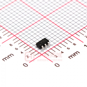

05150 SRV05-4 STEERING DIODE/ TVS ARRAY COMBO APPLICATIONS ✔ Ethernet - 10/100/1000 Base T ✔ Cellular Phones ✔ Handheld & Portable Electronics ✔ Video/Graphics Card ✔ USB 2.0 Interface ✔ DVI Interface IEC COMPATIBILITY ( EN61000-4) ✔ 61000-4-2 (ESD): Air - 15kV, Contact - 8kV ✔ 61000-4-4 (EFT): 40A - 5/50ns ✔ 61000-4-5 (Surge): 24A, 8/20µs - Level 2(Line-Gnd) & Level 3(Line-Line) SOT-23-6 FEATURES ✔ ✔ ✔ ✔ ✔ ✔ 500 Watts Peak Pulse Power per Line (tp=8/20µs) ESD Protection > 40 kilovolts Low Clamping Voltage Protects 4 Lines Ultra Low Capacitance: 3.5pF Typical RoHS Compliant MECHANICAL CHARACTERISTICS ✔ ✔ ✔ ✔ Molded JEDEC SOT-23-6 Package Weight 16 milligrams (Approximate) Available in Lead-Free Nickel-Paladium-Gold Plating Solder Reflow Temperature: Nickel-Paladium-Gold (Ni/Pd/Au) - Sn/Ag/Cu, 96/3.5/0.5: 260-270°C ✔ Consult Factory for Leaded Device Availability ✔ Flammability Rating UL 94V-0 ✔ 8mm Tape and Reel Per EIA Standard 481 ✔ Marking: Marking Code & Pin One Defined By DOT on Package PIN CONFIGURATION I/O 1 1 2 3 6 5 4 I/O 4 GND REF I/O 2 I/O 3 05150.R8 5/07 1 www.protekdevices.com SRV05-4 DEVICE CHARACTERISTICS MAXIMUM RATINGS @ 25°C Unless Otherwise Specified PARAMETER Peak Pulse Power (tp = 8/20µs) - See Figure 1 Operating Temperature Storage Temperature Forward Surge Rating(5ms @ 25°C, IF = 10mA) Peak Pulse Current (tp = 8/20µs) SYMBOL PPP TL TSTG VF IPP VALUE 500 -55 to 150 -55 to 150 0.5 Min. to 1.2 Max. 43 UNITS Watts °C °C Volts Amps ELECTRICAL CHARACTERISTICS PER LINE PART NUMBER DEVICE MARKING RATED STAND-OFF VOLTAGE (See Note 1) MINIMUM BREAKDOWN VOLTAGE (See Note 1) @ 1mA V(BR) VOLTS @ 25°C Unless Otherwise Specified MAXIMUM CLAMPING VOLTAGE (See Fig. 2) (See Note 1) @ IP = 5A VC VOLTS MAXIMUM LEAKAGE CURRENT (See Note 1) @VWM ID µA TYPICAL CAPACITANCE (See Note 1) V WM VOLTS MAXIMUM CLAMPING VOLTAGE (See Fig. 2) (See Note 1) @ IP = 1A VC VOLTS 0V @ 1 MHz Cj(SD) pF SRV05-4 S5 5.0 6.0 12.0 15.0 5 3.5 Note 1: From I/O pin to ground. FIGURE 1 PEAK PULSE POWER VS PULSE TIME 10,000 IPP - Peak Pulse Current - % of IPP PPP - Peak Pulse Current - Watts 120 100 80 60 40 20 0 tf FIGURE 2 PULSE WAVE FORM Peak Value IPP TEST WAVEFORM PARAMETERS tf = 8µs td = 20µs 1,000 500W, 8/20µs Waveform e-t 100 td = t I /2 PP 10 0.01 1 10 100 td - Pulse Duration - µs 1,000 10,000 0 5 10 15 20 t - Time - µs 25 30 05150.R8 5/07 2 www.protekdevices.com SRV05-4 GRAPHS 100 80 % Of Rated Power FIGURE 3 POWER DERATING CURVE Peak Pulse Power 8/20µs 60 40 20 Average Power 0 0 25 50 75 100 125 TL - Lead Temperature - °C 150 FIGURE 4 OVERSHOOT & CLAMPING VOLTAGE 35 5 Volts per Division 25 15 5 -5 ESD Test Pulse: 25 kilovolt, 1/30ns (waveshape) 05150.R8 5/07 3 www.protekdevices.com SRV05-4 SOT-23-6 PACKAGE OUTLINE & DIMENSIONS PACKAGE OUTLINE D E SOT-23-6 6 5 4 K 0° - 8° PACKAGE DIMENSIONS DIM MILLIMETERS MIN MAX 2.80 1.50 0.90 0.35 0.85 1.70 0.90 0.09 2.60 0.20 TYP 0.35 3.05 1.75 1.30 0.50 1.05 2.10 1.45 0.20 3.00 0.20 TYP 0.55 3 2 1 L J B M INCHES MIN MAX 0.110 0.059 0.036 0.014 0.033 0.067 0.036 0.003 0.102 0.007 TYP 0.014 0.120 0.070 0.051 0.020 0.040 0.083 0.057 0.008 0.118 0.007 TYP 0.022 F A G C A B C D E F G J K L M NOTES MOUNTING PAD TYPICAL DIM Millimeters Inches 1 2 3 4 5 0.70 1.90 0.95 2.40 1.00 0.028 0.074 0.037 0.094 0.039 4 1. Dimensioning and tolerances per ANSI Y14.5M, 1985. 2. Controlling Dimension: Inches 3. Dimensions are exclusive of mold flash and metal burrs. 3 2 1 5 TAPE & REEL/BULK ORDERING NOMENCLATURE 1. Surface mount product is taped and reeled in accordance with EIA-481. 2. Suffix -T7 = 7 Inch Reel - 3,000 pieces per 8mm tape, i.e., SRV05-4-T7 3. Suffix - P = Lead-Free, Nickel-Paladium-Gold Plating, i.e., SRV05-4-P-T7. Outline & Dimensions: Rev 2 - 10/05, 06013 Tape & Reel Specifications (Dimensions in millimeters) Reel Dia. 178mm (7”) Tape Width 8mm A0 B0 K0 D E F W P0 P2 P tmax 0.25 3.20 ± 0.10 3.20 ± 0.10 1.65 ± 0.10 1.50 ± 0.10 1.75 ± 0.10 3.50 ± 0.05 8.00 ±0.30 4.00 ±0.10 2.00 ±0.05 4.00 ±0.10 P0 t D P2 10 Pitches Cumulative Tolerance on Tape. ± 0.2 E Top cover tape A0 K0 B0 Pin 1 Indicated by Dot F W P User Direction of Feed ProTek Devices 2929 South Fair Lane, Tempe, AZ 85282 Tel: 602-431-8101 Fax: 602-431-2288 E-Mail: sales@protekdevices.com Web Site: www.protekdevices.com www.protekdevices.com COPYRIGHT © ProTek Devices 2007 SPECIFICATIONS: ProTek reserves the right to change the electrical and or mechanical characteristics described herein without notice (except JEDEC). DESIGN CHANGES: ProTek reserves the right to discontinue product lines without notice, and that the final judgement concerning selection and specifications is the buyer’s and that in furnishing engineering and technical assistance, ProTek assumes no responsibility with respect to the selection or specifications of such products. 05150.R8 5/07 4

1. 物料型号: - 型号:SRV05-4
2. 器件简介: - 该器件是一款用于保护线路免受电压冲击的瞬态电压抑制二极管阵列,适用于以太网、手机、手持便携电子设备、视频/图形卡、USB 2.0接口和DVI接口等应用。
3. 引脚分配: - 引脚配置图显示了SOT-23-6封装的引脚排列,具体引脚功能未在文档中详细说明。
4. 参数特性: - 该器件符合IEC 61000-4系列标准,包括静电放电(ESD)、电快速瞬变(EFT)和浪涌保护。 - 能够承受500W的峰值脉冲功率每线。 - 具有超过40千伏的ESD保护能力,低钳位电压,保护4线路,超低电容:典型值为3.5pF。
5. 功能详解: - 提供了详细的电气特性,包括额定隔离电压、最小击穿电压、最大钳位电压和最大漏电流等参数。
6. 应用信息: - 适用于需要高速数据传输和信号完整性保护的应用场合,如以太网、手机、手持设备等。
7. 封装信息: - 采用JEDEC SOT-23-6封装,重量约为16毫克,提供无铅镍钯金镀层,符合RoHS标准。 - 可提供有铅设备,具体需咨询工厂。 - 符合UL 94V-0阻燃等级,遵循EIA标准481的8mm胶带和卷轴包装。 - 标记代码和第一脚位置由DOT在封装上定义。
