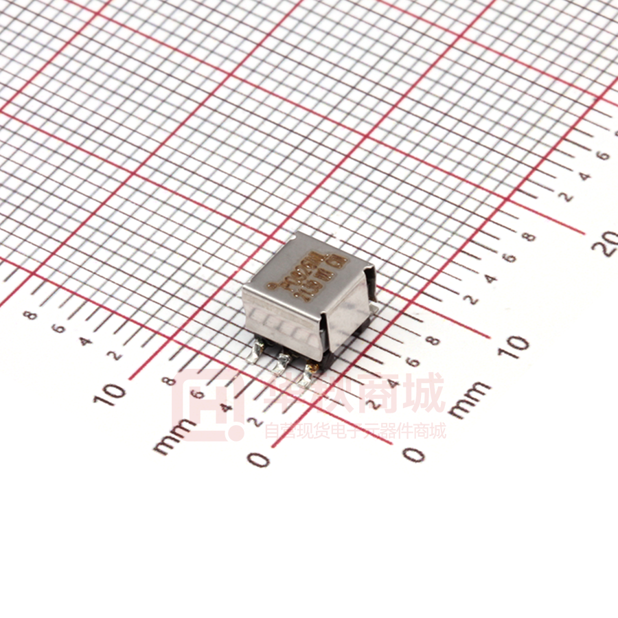

P0926NL 数据手册
SMT Gate Drive Transformers >1500VDC Basic and Functional Insulation >1500VDC isolation (380Vrms continuous) Basic insulation (1.4mm creepage/ clearance) and functional available Operating frequency: 50kHz and up Turns Ratio Part Number3,4 Electrical Specifications @ 25°C - Operating Temperature -40°C to +130°C5 Primary Leakage2 DCR Pri-Sec MAX1 Inductance Inductance Primary Isolation V*μsec (μH MIN) (μH MAX) (Ω MAX) DCR Secondary (Ω MAX) Package Size (L x W x H) (mm MAX) Functional Insulation PE-68386NL 1:1 1500 Vdc 9.7 785 P0926NL 1:1:1 1500 Vdc 23.8 300 P0544NL 1:1:1 1500 Vdc 45.1 3300 PA0264NL 1:1:1 1000 Vrms 12.7 1140 PA1323NL 1:1 1500 Vrms 21.7 600 Basic Insulation (1.4mm creepage and clearance between Primary and Secondary) PA0173NL 1:1:1 1500 Vrms 17.2 980 PA0185NL 1:1 1500 Vrms 17.2 980 PA0184NL 1:1 1500 Vrms 27.2 1200 PA0297NL 2:1:1 1500 Vrms 27.2 1200 PA2777NL 1:1 1500 Vrms 9.3 335.2 PA0510NL 2.5:1:1 1500 Vrms 27.2 1200 PA3493NL 1.25:1 1650 Vrms 23 656 Notes: 1. The Maximum volt-μsec rating limits the peak flux density to 2200 Gauss when used in a unipolar drive application. For bi-polar drive applications, a maximum volt-sec of two times this rating is acceptable (ie: 2* (volt*μsec rating) = (voltage applied to the primary) * dutycycle / Frequency = V * alpha / Freq_Hz = V * μsec 2. Leakage inductance is measured at primary terminals with all secondaries shorted. 3. Optional Tape & Reel packaging can be ordered by adding a “T” suffix to the part number (i.e. P0544NL becomes P0544NLT). Pulse complies to industry standard tape and reel specification EIA481. 4. The “NL” suffix indicates an RoHS-compliant part number. 1 power.pulseelectronics.com 5. 6. 0.46 0.50 0.80 0.65 2.0 0.60 2.00 1.25 0.75 1.25 0.60 2.00 1.25 0.75 1.25 8.6 x 6.7 x 2.5 8.0 x 6.6 x 5.3 9.0 x 8.6 x 7.6 8.6 x 6.7 x 3.6 9.5 x 7.1 x 5.3 0.75 0.75 0.50 0.60 0.36 0.68 0.62 0.88 0.91 0.91 0.70 0.91 0.88 0.62 0.91 0.46 0.70 0.380 11.8 x 8.8 x 4.0 11.8 x 8.8 x 4.0 9.0 x 8.6 x 7.6 9.0 x 8.6 x 7.6 7.1 x 6.1 x 5.5 9.0 x 8.6 x 7.6 1.3 1.03 0.85 10.9 x 9.7 x 2.7 The temperature of the component (ambient plus temperature rise) must be within the stated operating temperature range. Continuous isolation voltage confirmed by 125°C/1000hrs accelerated aging with the bias voltage applied between primary and secondary windings. SPM2007_61 (01/20) http://www.power.pulseelectronics.com/contact SMT Gate Drive Transformers >1500VDC Basic and Functional Insulation Mechanicals Schematics PE-68386NL 1 3 N1 N2 2 SUGGESTED PAD LAYOUT Mechanicals 4 Weight ...........................0.28grams Tape & Reel .......................1500/reel Tube .....................................60/tube Dimensions: .Inches mm Unless otherwise specified, .010 all tolerances are: ±.0,25 Schematics PA0264NL NL Weight ...........................0.28grams Tape & Reel .......................1500/reel Tube ......................................60/tube Dimensions: .Inches mm Unless otherwise specified, .010 all tolerances are: ±.0,25 Mechanicals Schematics P0926NL NL Weight ...........................0.48grams Tape & Reel .......................1000/reel Tray .....................................120/tray Dimensions: .Inches mm Unless otherwise specified, .010 all tolerances are: ±.0,25 2 power.pulseelectronics.com SPM2007_61 (01/20) http://www.power.pulseelectronics.com/contact SMT Gate Drive Transformers >1500VDC Basic and Functional Insulation Mechanicals (continued) Schematics P0544NL P0544NL Weight ...........................0.60grams Tape & Reel ........................400/reel Tube ......................................50/tube Dimensions: .Inches mm Unless otherwise specified, .010 all tolerances are: ±.0,25 Mechanicals Schematics PA0297NL, PA0510NL, PA0184NL PA0297NL / PA0510NL PA0184NL Weight ...........................0.60grams Tape & Reel ........................400/reel Tube ......................................50/tube Dimensions: .Inches mm Unless otherwise specified, .010 all tolerances are: ±.0,25 * for PA0184 the pads for pins 3 and 6 in the suggested pad layout should not be used in the layout 3 power.pulseelectronics.com SPM2007_61 (01/20) http://www.power.pulseelectronics.com/contact SMT Gate Drive Transformers >1500VDC Basic and Functional Insulation Mechanicals Schematics (continued) PA0173NL, PA0185NL PA0173NL PART NUMBER PA0185NL SUGGESTED PAD LAYOUT Weight ...........................0.48grams Tape & Reel ........................900/reel Tube ......................................60/tube Dimensions: .Inches mm Unless otherwise specified, .010 all tolerances are: ±.0,25 Schematics Mechanicals PA3493NL mm mm 0$; mm mm mm 0$; 3 mm PA3493NL DATE CODE CTRY OF MFG mm mm 4 ______________ 6 1 ______________ ______________ ______________ SUGGESTED FOOTPRINT 1 3 N1 2 N2 Weight ............................0.31grams Tape & Reel .......................1250/reel Tube ......................................50/tube Dimensions: mm Unless otherwise specified, all tolerances are: ±0.25 4 mm 0$;  685)$&(6 4 power.pulseelectronics.com SPM2007_61 (01/20) http://www.power.pulseelectronics.com/contact SMT Gate Drive Transformers >1500VDC Basic and Functional Insulation Schematics Mechanicals (continued) PA2777NL 6.3 6.3mm MAX 5.9mm MAX 8X 0.76 8X 0.508mm 8X 1.52 8X 0.89mm 7.4mm MAX .15 4.45 0.127 4.06±.25mm 3X 1.27mm 6.22 Weight ...........................0.32grams Tape & Reel ........................850/reel Tube .....................................120/tube Dimensions: mm Unless otherwise specified, all tolerances are: ±0.25 3X 1.27 BOTTOM VIEW SUGGESTED LAND PATTERN TOP VIEW FINAL OUTLINE Mechanicals Schematics PA1323NL 1 3 N1 N2 2 7.11mm MAX 4 5.33mm MAX 0.127 1.27mm .609X.254 (4X)2.54mm REF 1.27mm 5.08mm 2.54mm 9.52mm MAX 9.52mm 5.08mm REF Weight ..............................0.4grams Tape & Reel ........................700/reel Tray ....................................225/tray Dimensions: mm Unless otherwise specified, all tolerances are: ±0.25 5 power.pulseelectronics.com SPM2007_61 (01/20) http://www.power.pulseelectronics.com/contact SMT Gate Drive Transformers >1500VDC Basic and Functional Insulation TAPE & REEL INFO A W K0 G P1 USER DIRECTION OF FEED For More Information Pulse Worldwide Headquarters 15255 Innovation Drive Ste 100 San Diego, CA 92128 U.S.A. Tel: 858 674 8100 Fax: 858 674 8262 SURFACE MOUNTING TYPE, REEL/TAPE LIST PART NUMBER REEL SIZE (mm) A G TAPE SIZE (mm) W K0 QTY PCS/REEL P1 PE-68386NLT Ø330 16.4 12 16 3.05 1500 P0926NLT Ø330 16.4 12 16 5.33 1000 P0544NLT Ø330 24.4 16 24 8.13 400 PA0264NLT Ø330 24.4 16 24 3.81 800 PA1323NLT Ø330 16.4 12 16 5.55 870 PA0173NLT Ø330 24.4 16 24 4.32 900 PA0185NLT Ø330 24.4 16 24 4.32 900 PA0184NLT Ø330 24.4 16 24 8.13 400 PA0297NLT Ø330 24.4 16 24 8.13 400 PA2777NLT Ø330 16.4 12 16 6.10 850 PA0510NLT Ø330 24.4 16 24 8.13 400 PA3493NLT Ø330 24.4 16 24 2.80 1250 Pulse Europe Pulse Electronics GmbH Am Rottland 12 58540 Meinerzhagen Germany Pulse China Headquarters Pulse Electronics (ShenZhen) CO., LTD D708, Shenzhen Academy of Aerospace Technology, The 10th Keji South Road, Nanshan District, Shenzhen, P.R. China 518057 Pulse North China Room 2704/2705 Super Ocean Finance Ctr. 2067 Yan An Road West Shanghai 200336 China Pulse South Asia 3 Fraser Street 0428 DUO Tower Singapore 189352 Pulse North Asia 1F., No.111 Xiyuan Road Zhongli District Taoyuan City 32057 Taiwan (R.O.C) Tel: 49 2354 777 100 Fax: 49 2354 777 168 Tel: 86 755 33966678 Fax: 86 755 33966700 Tel: 86 21 62787060 Fax: 86 2162786973 Tel: 65 6287 8998 Fax: 65 6280 0080 Tel: 886 3 4356768 Fax: 886 3 4356820 Performance warranty of products offered on this data sheet is limited to the parameters specified. Data is subject to change without notice. Other brand and product names mentioned herein may be trademarks or registered trademarks of their respective owners. © Copyright, 2020. Pulse Electronics, Inc. All rights reserved. 6 power.pulseelectronics.com SPM2007_61 (01/20) http://www.power.pulseelectronics.com/contact
