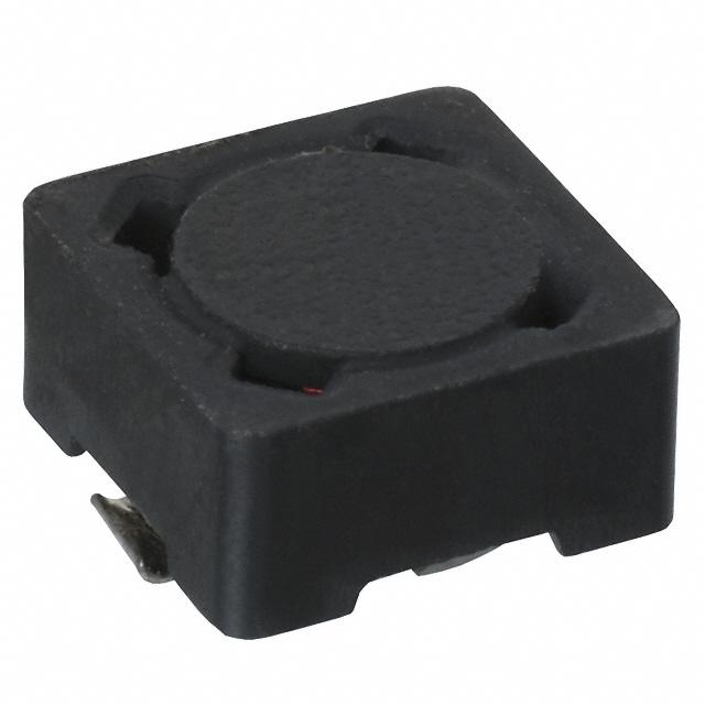

    2.7 µH 屏蔽 绕线 电感器 3.5 A 16 毫欧最大 非标准
P1167.272T 数据手册
SMT POWER INDUCTORS Shielded Drum Core - P1167 Series Height: 4.8mm Max Footprint: 7.5mm x 7.5mm Max Current Rating: up to 3.5A Inductance Range: 1.8µH to 750µH Electrical Specifications @ 25°C — Operating Temperature -40°C to +130°C Saturation 6 Inductance Inductance DCR (m Ω ) Part Irated 5 @0A DC @Irated Current Number (A DC ) (μH ±20%) (μH) MIN TYP MAX -25% (A) P1167.272 2.7* 1.8 3.5 13 16 3.5 P1167.362 3.6* 2.3 3.1 15 20 3.1 P1167.452 4.5* 2.9 2.6 25 30 2.9 P1167.542 5.4* 3.5 2.5 27 33 2.7 P1167.632 6.3* 4.1 2.4 30 35 2.5 P1167.103 10 7.5 2.0 42 50 2.1 P1167.123 12 9.0 1.9 46 57 1.9 P1167.153 15 11.3 1.7 53 66 1.7 P1167.183 18 13.5 1.5 59 73 1.5 P1167.223 22 16.5 1.4 87 105 1.4 P1167.273 27 20.3 1.2 100 130 1.2 P1167.333 33 24.8 1.1 139 170 1.1 P1167.393 39 29.3 1.0 156 200 1.0 P1167.473 47 35.3 0.94 173 220 0.94 P1167.563 56 42 0.86 225 270 0.86 P1167.683 68 51 0.78 251 310 0.78 P1167.823 82 61.5 0.7 282 350 0.7 P1167.104 100 75 0.63 317 390 0.63 P1167.124 120 90 0.57 418 530 0.57 P1167.154 150 113 0.52 497 610 0.52 P1167.184 180 135 0.47 635 820 0.47 P1167.224 220 165 0.43 745 930 0.43 P1167.274 270 203 0.39 840 1040 0.39 P1167.334 330 248 0.35 1162 1470 0.35 P1167.394 390 293 0.32 1237 1570 0.32 P1167.474 470 353 0.29 1688 2180 0.29 P1167.564 560 420 0.26 2240 2960 0.26 P1167.684 680 510 0.23 2402 3180 0.23 P1167.824 820 615 0.21 2702 3500 0.21 P1167.105 1000 750 0.19 3703 4930 0.19 * I n d u c t a n c e a t 0 A DC t o l e r a n c e o n i n d i c a t e d p a r t n u m b e r s i s ± 3 0 % ; t o l e r a n c e i s ± 2 0 % o n a l l o t h e r p a r t s . Schematic Mechanical .197 5,00 .177 MAX 4,50 .297 7,54 2 MAX XXX .297 MAX 7,54 Weight . . . . . . . . 0.9 grams Tape & Reel . . . . . . 900/reel .083 2,11 1 1 SUGGESTED PAD LAYOUT 1 .083 2,11 2 .197 5,00 .287 7,29 .220 5,60 .301 7,65 Heating 7 Core Loss 8 SRF Current Factor (MHz) +40°C(A) (K2) 3.6 590 >40 3.4 690 >40 2.6 770 >40 2.5 840 >40 2.4 900 36 2.0 1100 26 1.9 1200 24 1.8 1300 20 1.7 1400 18 1.4 1700 17 1.3 1800 15 1.1 2000 13 1.0 2200 12 1.0 2400 10 0.86 2600 9.2 0.81 2900 8.8 0.77 3200 8.0 0.72 3500 6.2 0.63 3900 6.1 0.58 4300 5.6 0.51 4800 4.5 0.47 5200 4.3 0.44 5700 3.8 0.38 6400 3.0 0.37 6900 2.8 0.31 7600 2.6 0.27 8300 2.4 0.26 9300 2.1 0.25 10000 2.0 0.21 11000 1.8 NOTES FROM TABLE: (See page 43) 2 .472 12,00 Dimensions: Inches mm Unless otherwise specified, all tolerances are ± .010 0,25 .630 16,00 TAPE & REEL LAYOUT USA 858 674 8100 • Germany 49 7032 7806 0 • Singapore 65 6287 8998 • Shanghai 86 21 54643211 / 2 • China 86 755 33966678 • Taiwan 886 3 4641811 www.pulseeng.com 35 SPM2006 (7/07) SMT POWER INDUCTORS Shielded Drum Core Series Notes from Tables (pages 27 - 42) 8. In high volt*time (Et) or ripple current applications, additional heating in the component can occur due to core losses in the inductor which may necessitate derating the current in order to limit the temperature rise of the component. In order to determine the approximate total loss (or temperature rise) for a given application, both copper losses and core losses should be taken into account. 1. Unless otherwise specified, all testing is made at 100kHz, 0.1VAC. 2. Optional Tape & Reel packaging can be ordered by adding a "T" suffix to the part number (i.e. P1166.102 becomes P1166.102T). Pulse complies with industry standard Tape and Tape & Reel specification EIA481. 3. To order RoHS compliant part, add the suffix "NL" to the part number (i.e. P1166.102 becomes P1166.102NL and P1166.102T becomes P1166.102NLT). Estimated Temperature Rise: 4. Temperature of the component (ambient plus temperature rise) must be within specified operating temperature range. Trise = [Total loss (mW) / K0].833 (oC ) Total loss = Copper loss + Core loss (mW) 5. The rated current (Irated) as listed is either the saturation current or the heating current depending on which value is lower. Copper loss = IRMS2 x DCR (Typical) (mW) 6. The saturation current, Isat, is the current at which the component inductance drops by the indicated percentage (typical) at an ambient temperature of 25°C. This current is determined by placing the component in the specified ambient environment and applying a short duration pulse current (to eliminate self-heating effects) to the component. Irms = [IDC2 + ΔI2/12]1/2 (A) Core loss = K1 x f (kHz)1.23 x Bac(Ga)2.38 (mW) Bac (peak to peak flux density) = K2 x ΔI (Ga) [= K2/L(µH) x Et(V-µSec) (Ga)] where f varies between 25kHz and 1MHz, and Bac is less than 2500 Gauss. K2 is a core size and winding dependant value and is given for each p/n in the proceeding datasheets. K0 & K1 are platform and material dependant constants and are given in the table below for each platform. Part No. PG0085/86 PG0087 PG0040/41 P1174 PF0601 PF0464 PF0465 P1166 P1167 PF0560NL P1168/69 P1170/71 P1172/73 PF0552NL PF0553NL Trise Factor (K0 ) 2.3 5.8 0.8 0.8 4.6 3.6 3.6 1.9 2.1 5.5 4.8 4.3 5.6 8.3 7.1 Core Loss Factor (K1) 5.29E-10 15.2E-10 2.80E-10 6.47E-10 14.0E-10 24.7E-10 33.4E-10 29.6E-10 42.2E-10 136E-10 184E-10 201E-10 411E-10 201E-10 411E-10 Core Loss / K1 (mW) 7. The heating current, Idc, is the DC current required to raise the component temperature by the indicated delta (approximately). The heating current is determined by mounting the component on a typical PCB and applying current for 30 minutes. The temperature is measured by placing the thermocouple on top of the unit under test. CoreLoss/K1 Vs Flux Density 3.00E+10 100KHz 2.50E+10 200KHz 2.00E+10 300KHz 1.50E+10 400KHz 1.00E+10 500KHz 700KHz 0.50E+10 0 1.0MHz 0 500 1000 1500 DB (Gauss) 2000 2500 where DB = K2 x DI [= K2/L(µH) x Et(V-µSec)] Take note that the component's temperature rise varies depending on the system condition. It is suggested that the component be tested at the system level, to verify the temperature rise of the component during system operation. USA 858 674 8100 • Germany 49 7032 7806 0 • Singapore 65 6287 8998 • Shanghai 86 21 54643211 / 2 • China 86 755 33966678 • Taiwan 886 3 4641811 www.pulseeng.com 43 SPM2006 (7/07)
