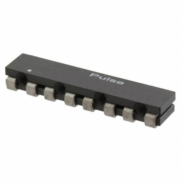

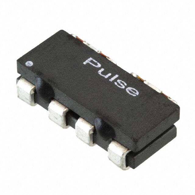

smt POWer inductors Power Beads - PA131xNL Series Coupled Inductors Gen 1.0 Coupled Inductors (2,3,4 and 5 phases) For use only with Volterra chipsets Coupled Inductors enable: • Phase ripple current reduction due to AC magnetic field cancellation within the inductor core • Improved efficiency due to lower peak currents • Reduction in required output capacitance Halogen Free Electrical Specifications @ 25°C — Operating Temperature -40°C to +130°C Pulse Part No. Number of Coupled Phases Equlavent 1 Transient Inductance per Phase (nH ±20%) Irated 2 per Phase (Adc) Open Circuit Ind. per Phase 3 nH ±20%, 0Adc Open Circuit Ind. per Phase 3 nH Min, 5Adc DCR/Phase 4 (mW) L1 L2 L3 L4 L5 L1 L2 L3 L4 L5 (1-2) (3-4) (5-6) (7-8) (9-10) (1-2) (3-4) (5-6) (7-8) (9-10) PA1312NL 2 50 40 310 310 − − − 240 240 − − − PA1313NL 3 50 40 370 450 370 − − 285 350 285 − − PA1314NL 4 50 40 370 490 490 370 − 285 385 385 285 − PA1315NL 5 50 40 370 470 490 470 390 285 365 385 365 285 Notes 1. In a non-coupled multi-phase topology, the power supply sees the same inductance during transient and steady-state conditions. As a result, any attempt to lower the inductance to improve transient response has the negative result of increasing ripple and peak currents throughout the system during steady-state operation. However, in a coupled inductor multi-phase topology, the interaction of magnetic fields from each phase enables an overall reduction in ripple current during steady-state operation and a lower equivalent inductance during transient operation. The equivalent transient inductance per phase, as listed, represents the actual value of inductance that would be required in an non-coupled topology to realize the same transient performance. This value is achieved by core and winding geometry and is not directly MAX 0.425 0.5 measured by Pulse. For more information on the operation of the coupled inductor topology, please contact Volterrra. 2. The rated current per phase is based on Volterra’s testing of the Pulse coupled inductors. 3. The open-circuit inductance per phase is the measured inductance (at specified current) across each phase when all other phases are open-circuit. The open circuit inductance is equal to the magnetizing inductance per phase (Lm) plus the equivalent transient inductance (Lk). 4. The nominal value of DCR/phase is for reference only. For production testing, the maximum limit is used. Schematic Mechanical PA1312NL TYP Weight . . . . . . 3.0 grams Tape & Reel . . . . 650/reel Tray . . . . . . . . . . . 60/tray Dimensions: Inches mm PA1312AHL Unless otherwise specified, all tolerances are ± .010 0,25 ����� ����� ����� ����� ������������ ������������ ���� ���� ������������������ ���� ���� ����� ����� ���������������������� USA 858 674 8100 ● Germany 49 7032 7806 0 ● Singapore 65 6287 8998 ● Shanghai 86 21 54643211 / 2 ● China 86 755 33966678 ● Taiwan 886 3 4641811 www.pulseelectronics.com 53 SPM2007 (1/11) smt POWer inductors Power Beads - PA131xNL Series Coupled Inductors Schematic Mechanical PA1313NL Weight . . . . . . 4.5 grams Tape & Reel . . . . 650/reel Tray . . . . . . . . . . . 45/tray ������������� ������������ ����� ����� ������������ ������������ ����������� ������ ���� ���� ���� ���� ����� ����� ���������������������� PA1314NL Weight . . . . . . 4.5 grams Tape & Reel . . . . 550/reel Tray . . . . . . . . . . . 30/tray 1.348 34,25 1.811 46,00 2.835 ± .012 72,00 ± 0,30 PA1315NL Weight . . . . . . 7.5 grams Tape & Reel . . . . 500/reel Tray . . . . . . . . . . . 30/tray 1.348 34,25 1.811 46,00 All Part Numbers Dimensions: Inches mm 2.835 ± .012 72,00 ± 0,30 Unless otherwise specified, all tolerances are ± .010 0,25 USA 858 674 8100 ● Germany 49 7032 7806 0 ● Singapore 65 6287 8998 ● Shanghai 86 21 54643211 / 2 ● China 86 755 33966678 ● Taiwan 886 3 4641811 www.pulseelectronics.com 54 SPM2007 (1/11)
