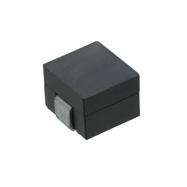

    72 nH 无屏蔽 电感器 31 A 0.27 毫欧 非标准
PA1512.700NLT 数据手册
SMT POWER INDUCTORS Power Beads - PA1512 Series High frequency VRM10.0 applications Current Rating: Over 50Apk Inductance Range: 72nH to 150nH Footprint: 7.0 x 7.0mm Max Height: 4.96mm Max Frequency Range: up to 2MHz Electrical Specifications @ 25°C — Operating Temperature -40°C to +130°C Part Number Inductance @Irated (nH ±20%) PA1512 SERIES - 7.0MM X 7.0MM X 5.0MM PA1512.700T 72 PA1512.101T 102 PA1512.151T 134 Saturation Current 5 (ADC) Irated 4 (ADC) DCR 1, 2 (mΩ ±6%) Inductance 3 @0ADC (nH ±20%) 25°C 100°C Heating 6 Current (A) 31 31 28 0.27 0.27 0.27 72 105 150 50+ 48 32 50+ 42 28 31 31 31 NOTES: 1. The nominal DCR has a tolerance of ±6%. This tolerance is guaranteed by design, but is not a manufacturing production test. The nominal DCR is measured from point a to point b , as shown below on the mechanical drawing. 2. For manufacturing production test, a maximum DCR value of 0.5mΩ is used. 3. The inductance has a tolerance of ±9%. This tolerance is guaranteed by design, but is not a manufacturing production test. For manufacturing production test, a tolerance of ±20% is used. 4. The rated current as listed is either the saturation current or the heating current depending on which value is lower. 5. The saturation current is the current which causes the inductance to drop by 20% at the stated ambient temperatures (25°C and 100°C). This current is determined by placing the component in the specified ambient environment and applying a short duration pulse current (to eliminate self-heating effects) to the component. 6. The heating current is the DC current which causes the part temperature to increase by approximately 40°C. This current is determined by soldering the component on a typical application PCB, and then applying the current to the device for 30 minutes without any forced air cooling. 7. In high volt*time applications, additional heating in the component can occur due to core losses in the inductor which may neccessitate derating the current in order to limit the temperature rise of the component. To determine the approximate total losses (or temperature rise) for a given application, the coreloss and temperature rise curves can be used. 8. Pulse complies with industry standard tape and reel specification EIA481. Schematic Mechanical A MAX PA1512.XXX Date Code Country of Origin .157 4,00 .205 5,21 .276 7,00 MAX .079 2,00 .069 1,75 1 D E C 2 TAPE & REEL LAYOUT .195 4,96 MAX a b .080 2X 2,03 .098 2,49 .120 3,05 B .100 2X 2,54 SUGGESTED PAD LAYOUT .295 7,49 .472 12,00 Dim. A inches/mm .276/7,00 B .091/2,30 C .300/7,62 D .295/7,49 E .630*/16,00** *±.012 inches **±0,30 mm USER DIRECTION OF FEED Weight 0.94 grams Tape & Reel .....1000/reel Dimensions: Inches mm Unless otherwise specified, all tolerances are ± .010 0,25 US 858 674 8100 • UK 44 1483 401 700 • France 33 3 84 35 04 04 • Singapore 65 6287 8998 • Taiwan 886 2 2698 0228 • Hong Kong 852 2788 6588 • http://www.pulseeng.com P632.A (12/04) SMT POWER INDUCTORS Power Beads - PA1512 Series Inductance vs Current 180 160 Ind (nH) 140 120 100 80 60 .700 (25°C) .101 (25°C) .151 (25°C) 40 20 .700 (100°C) .101 (100°C) .151 (100°C) 0 0 5 10 15 20 25 30 35 40 45 Current (A) CoreLoss vs Flux Density 1.4 200kHz 400kHz 600kHz 800kHz 1.0MHz 1.4MHz 1.8MHz CoreLoss (W) 1.2 1.0 0.8 0.6 0.4 0.2 0.0 0 1000 500 1500 2000 2500 3000 Temp Rise above Ambient (C) (Trise = 72.8 * Total Power Dissipation.833) DB (gauss) where DB = .86 * L(nH) * DI Temp Rise vs Power Dissipation 120 100 80 60 40 20 0 0 0.2 0.4 0.6 0.8 1.0 1.2 1.4 1.6 1.8 Total Power Dissipation (W) = CopperLoss + CoreLoss CopperLoss = Irms 2 * Rdc (mW) / 1000 CoreLoss = (from graph) For More Information: UNITED STATES (Worldwide) UNITED KINGDOM (Northern Europe) FRANCE (Southern Europe) SINGAPORE (Southern Asia) TAIWAN, R.O.C. (Northern Asia) HONG KONG (China/Hong Kong) 12220 World Trade Drive San Diego, CA 92128 U.S.A. http://www.pulseeng.com TEL: 858 674 8100 FAX: 858 674 8262 3 Huxley Road Surrey Research Park Guildford, Surrey GU2 5RE United Kingdom TEL: 44 1483 401700 FAX: 44 1483 401701 Zone Industrielle F-39270 Orgelet France TEL: 33 3 84 35 04 04 FAX: 33 3 84 25 46 41 150 Kampong Ampat #07-01/02 KA Centre Singapore 368324 TEL: 65 6287 8998 FAX: 65 6280 0080 3F-4, No. 81, Sec. 1 HsinTai Wu Road Hsi-Chih, Taipei Hsien Taiwan, R.O.C. Tel: 886 2 2698 0228 FAX: 886 2 2698 0948 Unit 11, 11/F Wah Lai Industrial Centre 10-14 Kwei Tei Street, Fotan, Shatin, Hong Kong TEL: 852 2788 6588 FAX: 852 2776 1055 DISTRIBUTOR Performance warranty of products offered on this data sheet is limited to the parameters specified. Data is subject to change without notice. Other brand and product names mentioned herein may be trademarks or registered trademarks of their respective owners. ©2004, Pulse Engineering, Inc. All Rights Reserved. P632.A (12/04)
