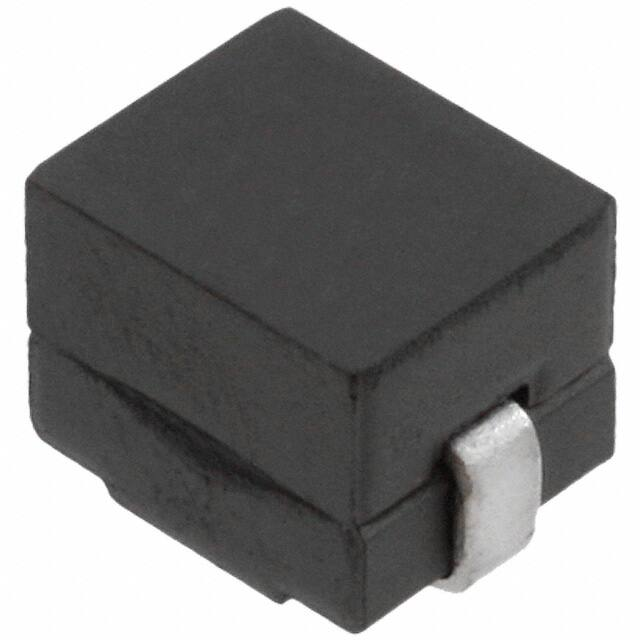

    固定电感器 Nonstandard 300nH ±15% 27A 0.29mΩ
PA2607.301NLT 数据手册
SMT Power Inductor Power Beads - PA2607.XXXNL/PA2607.XXXAHL Series Current Rating: Over 90 Apk Inductance Range: 115nH to 300nH Height: 7.5mm and 7.6mm Max Footprint: 10.4mm x 7.9mm Max Electrical Specifications @ 25°C — Operating Temperature -40°C to +130°C7 Saturation Current4 (A TYP) Commerical Inductance1 @ 0ADC (nH +/- 15%) Inductance @Irated (nH TYP) Irated2 (ADC) 25°C 100°C PA2607.121NL 115 115 41 94 80 PA2607.151NL 150 150 41 72 61 PA2607.181NL 175 175 41 62 53 48 41 Part Number DCR3 (mΩ nominal) 0.29 +/- 7% (.XXNL) 0.29 +/- 5% (.XXXAHL) PA2607.211NL 215 195 41 PA2607.231NL 230 208 37 43 37 PA2607.271NL 270 241 34 37 34 PA2607.301NL 300 260 28 32 28 NOTES: 1. Inductance measured at 100kHz, 100mVrms. 2. Inductance at Irated is the value of the inductance at 25°C at the listed rated current. 3. The nominal DCR is measured from point a to point b , as shown below on the mechanical drawing. The standard part (PA2607.XXXNL) has a DCR tolerance of +/-7%. A tighter DCR tolerance of +/-5% is available by changing the NL suffix to AHL (i.e. 7. PA2607.211NL becomes PA2607.211AHL). 4. The saturation current is the typical current which causes the inductance to drop by 20% at the stated ambient temperatures (25°C and 100°C). This current is determined 8. by placing the component in the specified ambient environment and applying a short duration pulse current(to eliminate self-heating effects) to the component. 5. The heating current is the DC current which causes the part temperature to increase by approximately 40°C. 6. In high volt*time applications, additional heating in the component can occur due to 1 power.pulseelectronics.com Heating Current6 (A TYP) Heigh mm* (inches) 7.4* (.291) 41 7.3* (.287) core losses in the inductor which may neccessitate derating the current in order to limit the temperature rise of the component. To determine the approximate total losses (or temperature rise) for a given application, the coreloss and temperature rise curves can be used. Optional Tape & Reel packaging can be ordered by adding a “T” suffix to the part number (i.e. PA2607.211NL becomes PA2607.211NLT). Pulse complies to industry standard tape and reel specification EIA481. The temperature of the component (ambient plus temperature rise) must be within the stated operating temperature range. P673. M (02/20) http://www.power.pulseelectronics.com/contact SMT Power Inductor Power Beads - PA2607.XXXNL/PA2607.XXXAHL Series Mechanical Schematic PA2607.XXXNL/PA2607.XXXHNL  PA2607 .XXXNL  D/C CTRY *Please note that marking shown is for the PA2607.XXXNL parts. Marking for AHL parts is the same except PA2607.XXXNL is replaced by PA2607.XXXAHL. Weight ..............................2.4grams Tape & Reel ........................400/reel Dimensions: Inches mm .008 0.2 Unless otherwise specified, all tolerances are ± .010 0,25 TAPE & REEL INFO Marking Marking K0 A W P1 G Direction of tape PART NUMBER SURFACE MOUNTING TYPE, REEL/TAPE LIST REEL SIZE (mm) TAPE SIZE (mm) A G P1 W K0 PA2607.XXXNL/PA2607.XXXHNL 2 power.pulseelectronics.com Ø330 24.4 P673. M (02/20) 16.0 24.0 8.1 QTY PCS/REEL 400 http://www.power.pulseelectronics.com/contact SMT Power Inductor Power Beads - PA2607.XXXNL/PA2607.XXXAHL Series B For More Information Pulse Worldwide Pulse Europe Headquarters Pulse Electronics GmbH 15255 Innovation Drive Ste 100 Am Rottland 12 San Diego, CA 92128 58540 Meinerzhagen U.S.A. Germany Tel: 858 674 8100 Fax: 858 674 8262 Tel: 49 2354 777 100 Fax: 49 2354 777 168 0.37 Pulse China Headquarters Pulse Electronics (ShenZhen) CO., LTD D708, Shenzhen Academy of Aerospace Technology, The 10th Keji South Road, Nanshan District, Shenzhen, P.R. China 518057 Pulse North China Room 2704/2705 Super Ocean Finance Ctr. 2067 Yan An Road West Shanghai 200336 China Pulse South Asia 3 Fraser Street 0428 DUO Tower Singapore 189352 Pulse North Asia 1F., No.111 Xiyuan Rd Zhongli City Taoyuan City 32057 Taiwan (R.O.C) Tel: 86 755 33966678 Fax: 86 755 33966700 Tel: 86 21 62787060 Fax: 86 2162786973 Tel: 65 6287 8998 Fax: 65 6280 0080 Tel: 886 3 4356768 Fax: 886 3 4356820 Performance warranty of products offered on this data sheet is limited to the parameters specified. Data is subject to change without notice. Other brand and product names mentioned herein may be trademarks or registered trademarks of their respective owners. © Copyright, 2020. Pulse Electronics, Inc. All rights reserved. 3 power.pulseelectronics.com P673. M (02/20) http://www.power.pulseelectronics.com/contact
