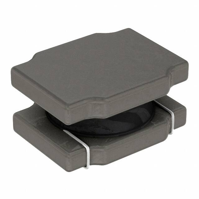

Pulse Jack Shielded Drum Core Inductor PA4330.XXXNLT Series Height: 1.0mm Max Electronics Footprint: 2.2mm x 1.8mm Max Current Rating: up to 3.1A Inductance Range: 0.47uH to 2.2uH Shielded magnetic circuit reduces leakage flux, Fe base metal core enables high saturation and metalized core termination results in excellent shock resistance Electrical Specifications @ 25°C — Operating Temperature -40°C to 125°C DC RESISTANCE MAX. TYP. INDUCTANCE 1MHz, 1V RATED CURRENT MIN. SELF-RESONANT FREQUENCY uH +/-20% A MHz mΩ mΩ PA4330.471NLT 0.47 3.1 102 49 PA4330.681NLT 0.68 2.8 77 PA4330.102NLT 1 2.35 PA4330.222NLT 2.2 1.7 PART NUMBER HEATING CURRENT SATURATION CURRENT (20°C) 20°C Rise 40°C Rise A A A 41 3.8 2.7 3.1 65 57 3.5 2.5 2.8 70 90 75 3.35 2.05 2.35 39 170 142 1.8 1.45 1.7 NOTES: 1. Actual temperature of the component during system operation (ambient plus temperature rise) must be within the standard operating range. ambient environment and applying a short duration pulse current (to eliminate self-heating effect) to the component. 2. The rated current as listed is either the saturation current (20°C) or the heating current (40°C Rise) depending on which value is lower. 4. The heating current is the DC current required to raise the component temperature by approximately 20°C or 40°C. Take note that the components’ performance varies depending on the system conditions. It is suggested that the component be tested at the system level, to verify the temperature rise of the component during system operation. 3. The saturation current is the current at which the initial inductance drops approximately 30% at the stated ambient temperature. This current is determined by placing the component in the specified 5. Maximum voltage across terminals to be limited to
