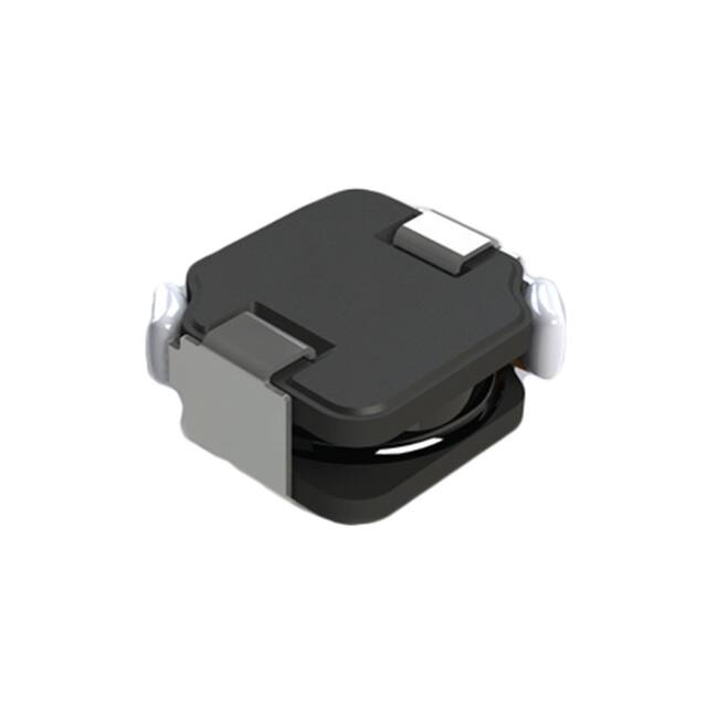

    固定电感器 Nonstandard 680nH ±20% 9.5A 8.7mΩ 57MHz
PA4333.681NLT 数据手册
SMT Power Inductor Shielded Drum Core - PA4333.XXXNLT Series Height: 3.2mm Max Footprint: 7.4mm x 6.8mm Max Current Rating: up to 14A Inductance Range: 0.22uH to 22uH Shielded magnetic circuit reduces leakage flux, Fe base metal core enables high saturation and metalized core termination results in excellent shock resistance. Electrical Specifications @ 25°C - Operating Temperature -40°C to +125°C Part Number PA4333.221NLT PA4333.331NLT PA4333.471NLT PA4333.681NLT PA4333.751NLT PA4333.102NLT PA4333.152NLT PA4333.222NLT PA4333.332NLT PA4333.472NLT PA4333.682NLT PA4333.822NLT PA4333.103NLT PA4333.153NLT PA4333.223NLT Inductance 1MHz, 1V Rated Current Min. Self-Resonant Frequency uH ±20% 0.22 0.33 0.47 0.68 0.75 1.0 1.5 2.2 3.3 4.7 6.8 8.2 10 15 22 A 14.00 12.40 11.00 9.50 9.50 9.50 6.00 5.65 4.60 3.80 3.20 3.10 3.00 2.50 1.70 MHz 108 78 71 57 55 41 37 24 23 15 14 13 12 11 8 Notes: 1. Actual temperature of the component during system operation (ambient plus temperature rise) must be within the standard operating range. 2. The rated current as listed is either the saturation current (@ 20°C) or the heating current (∆ T ~ 40°C) depending on which value is lower. 3. The saturation current is the current at which the initial inductance drops approximately 30% at the stated ambient temperature. This current is determined by placing the component in the specified ambient environment and applying a short duration pulse current (to eliminate self-heating effect) to the component. USA 858 674 8100 Germany 49 7032 7806 0 1 Singapore 65 6287 8998 pulseelectronics.com DC Resistance MAX. mΩ 4.0 5.1 6.6 8.7 8.7 8.7 13.8 18.0 30.5 43.5 64.0 69.0 77.4 127.0 177.0 Heating Current TYP. Saturation Current (20�C) ∆ T ≈ 40�C mΩ 3.3 4.3 5.5 7.3 7.3 7.3 11.5 15.0 25.5 36.5 53.5 58.0 64.5 106.0 148.0 A 18.00 17.00 16.50 12.80 11.50 9.50 8.00 6.50 4.60 3.80 3.20 3.20 3.00 3.00 1.70 A 14.00 12.40 11.00 9.50 9.50 9.50 6.00 5.65 4.60 3.80 3.20 3.10 3.00 2.50 2.00 4. The heating current is the DC current required to raise the component temperature by approximately 40°C. Take note that the components’ performance varies depending on the system condition. It is suggested that the component be tested at the system level, to verify the temperature rise of the component during system operation. 5. Maximum voltage across terminals to be limited to
