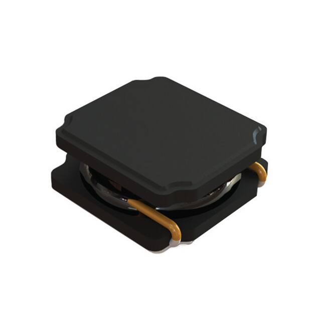

    固定电感器 Nonstandard 2.7µH ±20% 1.48A 110mΩ 54MHz
PA4334.272NLT 数据手册
SMT Power Inductor Shielded Drum Core - PA4334.XXXNLT Series Height: 1.2mm Max Footprint: 3.2mm x 3.2mm Max Current Rating: up to 3.0A Inductance Range: 0.22uH to 100uH Shielded magnetic circuit reduces leakage flux, Fe base metal core enables high saturation and metalized core termination results in excellent shock resistance. Electrical Specifications @ 25°C - Operating Temperature -40°C to +125°C Part Number PA4334.221NLT PA4334.821NLT PA4334.102NLT PA4334.122NLT PA4334.152NLT PA4334.182NLT PA4334.222NLT PA4334.242NLT PA4334.272NLT PA4334.332NLT PA4334.362NLT PA4334.392NLT PA4334.472NLT PA4334.682NLT PA4334.103NLT PA4334.123NLT PA4334.153NLT PA4334.183NLT PA4334.223NLT PA4334.273NLT USA 858 674 8100 Inductance 1MHz, 1V Rated Current Min. Self-Resonant Frequency uH 0.22 ± 30% 0.82 ± 30% 1.0 ± 30% 1.2 ± 30% 1.5 ± 30% 1.8 ± 30% 2.2 ± 30% 2.4 ± 30% 2.7 ± 20% 3.3 ± 20% 3.6 ± 20% 3.9 ± 20% 4.7 ± 20% 6.8 ± 20% 10 ± 20% 12 ± 20% 15 ± 20% 18 ± 20% 22 ± 20% 27 ± 20% A 3.00 2.05 1.87 2.01 1.62 1.30 1.20 1.15 1.14 1.05 1.05 1.00 0.90 0.75 0.60 0.48 0.45 0.43 0.42 0.35 MHz 328 107 89 83 71 65 55 47 54 46 36 53 31 30 23 20 22 16 22 12 Germany 49 7032 7806 0 1 Singapore 65 6287 8998 pulseelectronics.com DC Resistance MAX. mΩ 22 39 52 59 59 82 98 88 110 130 130 189 156 247 345 449 468 709 839 1131 Shanghai 86 21 62787060 Heating Current TYP. Saturation Current (20�C) ∆ T ≈ 40�C mΩ 17 30 40 45 45 63 75 68 85 100 100 145 120 190 265 345 360 545 645 870 A 5.30 2.05 1.87 2.22 1.62 1.30 1.20 1.15 1.14 1.05 1.05 1.00 0.90 0.75 0.60 0.48 0.45 0.43 0.42 0.35 A 3.00 2.47 2.20 2.01 2.01 1.65 1.55 1.60 1.48 1.36 1.36 1.24 1.24 0.98 0.83 0.73 0.71 0.58 0.53 0.47 China 86 755 33966678 Taiwan 886 3 4356768 P763.B (07/15) SMT Power Inductor Shielded Drum Core - PA4334.XXXNLT Series Electrical Specifications @ 25°C - Operating Temperature -40°C to +125°C Part Number PA4334.333NLT PA4334.363NLT PA4334.393NLT PA4334.473NLT PA4334.563NLT PA4334.683NLT PA4334.823NLT PA4334.104NLT Inductance 1MHz, 1V Rated Current Min. Self-Resonant Frequency uH 33 ± 20% 36 ± 20% 39 ± 20% 47 ± 20% 56 ± 20% 68 ± 20% 82 ± 20% 100 ± 20% A 0.36 0.34 0.37 0.27 0.26 0.24 0.17 0.21 MHz 12 10 10 11 9 7 7 5 Notes: 1. Actual temperature of the component during system operation (ambient plus temperature rise) must be within the standard operating range. 2. The rated current as listed is either the saturation current (@ 20°C) or the heating current (∆ T ~ 40°C) depending on which value is lower. 3. The saturation current is the current at which the initial inductance drops approximately 30% at the stated ambient temperature. This current is determined by placing the component in the specified ambient environment and applying a short duration pulse current (to eliminate self-heating effect) to the component. DC Resistance MAX. mΩ 1138 1235 1729 1885 1794 2171 3302 3718 Heating Current TYP. Saturation Current (20�C) ∆ T ≈ 40�C mΩ 875 950 1330 1450 1380 1670 2540 2860 A 0.36 0.34 0.30 0.27 0.26 0.24 0.17 0.21 A 0.46 0.44 0.37 0.35 0.28 0.33 0.27 0.25 4. The heating current is the DC current required to raise the component temperature by approximately 40°C. Take note that the components’ performance varies depending on the system condition. It is suggested that the component be tested at the system level, to verify the temperature rise of the component during system operation. 5. Maximum voltage across terminals to be limited to
