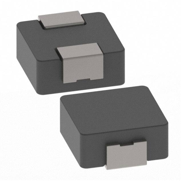

SMT Power Inductors High Current Molded Power Inductor - PA4341.XXXANLT Series Height: 3.0mm Max Footprint: 7.4mm x 6.8mm Max Current Rating: up to 30.0A Inductance Range: 0.15uH to 22.0uH Shielded construction and compact design High current, low DCR, and high efficiency Minimized acoustic noise and minimized leakage flux Electrical Specifications @ 25°C - Operating Temperature -55°C to +155°C Part Number PA4341.151ANLT PA4341.221ANLT PA4341.331ANLT PA4341.361ANLT PA4341.471ANLT PA4341.561ANLT PA4341.681ANLT PA4341.821ANLT PA4341.102ANLT PA4341.122ANLT PA4341.152ANLT PA4341.222ANLT PA4341.272ANLT PA4341.332ANLT PA4341.472ANLT PA4341.562ANLT PA4341.682ANLT PA4341.822ANLT PA4341.103ANLT PA4341.153ANLT PA4341.223ANLT 1 Inductance5 100KHz, 1V uH±20% 0.15* 0.22 0.33 0.36 0.47 0.56 0.68 0.82 1.0 1.2 1.5 2.2 2.7 3.3 4.7 5.6 6.8 8.2 10 15 22 Rated Current A 30 23 21 20 18 16.5 16 14 12 10 10 8 7.2 6.5 5.5 5.5 4.5 4.5 4 3 2.5 power.pulseelectronics.com DC Resistance TYP. mΩ 1.7 2.0 2.8 3.3 3.4 3.9 4.7 5.4 6.7 7.7 10.2 13.5 17.3 19 28 39 43 54 62 110 150 P820. D (07/18) MAX. mΩ 2.1 2.5 3.4 3.9 4 4.5 5.3 6 7.4 9.5 12.1 15 20 22 33 42 50 60 68 140 190 Saturation Current A 40 34 25 24 20 18 17 16 15 14 14 10 9.8 9.5 6.5 6 6 6 5.5 4.5 3 http://www.power.pulseelectronics.com/contact SMT Power Inductors High Current Molded Power Inductor - PA4341.XXXANLT Series Notes: 1. Actual temperature of the component during system operation (ambient plus temperature rise) must be within the standard operating range. 2. The saturation current is the current at which the initial inductance drops approximately 30% at the stated ambient temperature. This current is determined by placing the compnent in the specified ambient environment and applying a short duration pulse current (to eliminate self-heating effect) to the component. 3. The rated current is the DC current required to raise the component temperature by approximately 40�C. Take note that the components’ performanc varies depending on the system condition. It is suggested that the component be tested at the system level, to verify the temperature rise of the component during system operation. 4. The part temperature (ambient+temp rise) should not exceed 155�C under worst case operating conditions. Circuit design, PCB trace size and thickness, airflow and other cooling provisions all affect the part temperature. Part temperature should be verified in the end application. Inductance tolerance is ±20% for all parts except PA4341.151ANLT which is ±30%. Parts shown in bold are standard catalog parts and are available through sample stock and distribution. Parts in lighter font are available but are not necessarily held in sample stock or distribution and lead times may be longer. Please contact Pulse for availablity. 5. 6. Mechanical PA4341.XXXNLT C XXXANL D/C B D L H A A` E G T Final Layout SUGGESTED PAD LAYOUT Series A A` B C D E T L G H PA4341.XXXANLT 7.1±0.3 6.4±0.3 6.6±0.2 2.8±0.2 1.6±0.3 3.0±0.2 0~0.15 8.0 3.7 3.4 All Dimensions in mm. TAPE & REEL INFO Chip cavity Blank portions K0 A W Blank portions P1 200mm or more 400mm or more G Direction of tape SURFACE MOUNTING TYPE, REEL/TAPE LIST REEL SIZE (mm) A PA4341.XXXANLT 2 Ø330 power.pulseelectronics.com G TAPE SIZE (mm) P1 16.4+2/-0 12.0±0.1 QTY W K0 PCS/REEL 16±0.3 3.3±0.1 1000 P820. D (07/18) http://www.power.pulseelectronics.com/contact SMT Power Inductors High Current Molded Power Inductor - PA4341.XXXANLT Series For More Information Pulse Worldwide Pulse Europe Headquarters Pulse Electronics GmbH 15255 Innovation Drive Ste 100 Am Rottland 12 San Diego, CA 92128 58540 Meinerzhagen U.S.A. Germany Tel: 858 674 8100 Fax: 858 674 8262 Tel: 49 2354 777 100 Fax: 49 2354 777 168 Pulse China Headquarters Pulse Electronics (ShenZhen) CO., LTD D708, Shenzhen Academy of Aerospace Technology, The 10th Keji South Road, Nanshan District, Shenzhen, P.R. China 518057 Pulse North China Room 2704/2705 Super Ocean Finance Ctr. 2067 Yan An Road West Shanghai 200336 China Pulse South Asia 3 Fraser Street 0428 DUO Tower Singapore 189352 Pulse North Asia 1F., No.111 Xiyuan Rd Zhongli City Taoyuan City 32057 Taiwan (R.O.C) Tel: 86 755 33966678 Fax: 86 755 33966700 Tel: 86 21 62787060 Fax: 86 2162786973 Tel: 65 6287 8998 Fax: 65 6280 0080 Tel: 886 3 4356768 Fax: 886 3 4356820 Performance warranty of products offered on this data sheet is limited to the parameters specified. Data is subject to change without notice. Other brand and product names mentioned herein may be trademarks or registered trademarks of their respective owners. © Copyright, 2018. Pulse Electronics, Inc. All rights reserved. 3 power.pulseelectronics.com P820. D (07/18) http://www.power.pulseelectronics.com/contact
