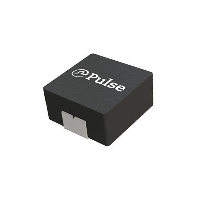

SMT Power Inductor High Current Molded Power Inductor - PA4343.XXXNLT & PM4343.XXXNLT Series Height: 6.5mm Max Footprint: 14.0mm x 12.8mm Max Current Rating: up to 55.0A Inductance Range: 0.15uH to 47.0uH Shielded construction and compact design High current, low DCR, and high efficiency Minimized acoustic noise and minimized leakage flux 200Vdc Isolation between terminal and core Electrical Specifications @ 25°C - Operating Temperature -55°C to +125°C Commercial6,7 Automotive6,7 DC Resistance Inductance5 100KHz, 1V Rated3 Current TYP. MAX. Saturation2 Current uH±20% A mΩ mΩ A Mechanical PA4343.151NLT PM4343.151NLT 0.15* 55 0.49 0.6 118 Footprint 1 PA4343.221NLT PM4343.221NLT 0.22 53 0.47 0.6 112 Footprint 1 PA4343.301NLT PM4343.301NLT 0.3 48 0.6 0.72 72 Footprint 1 PA4343.331NLT PM4343.331NLT 0.33 46 0.65 0.8 68 Footprint 1 PA4343.361NLT PM4343.361NLT 0.36 45 0.7 0.9 66 Footprint 1 PA4343.401NLT PM4343.401NLT 0.4 44 0.7 1 64 Footprint 1 PA4343.451NLT PM4343.451NLT 0.45 42 0.9 1.2 63 Footprint 1 PA4343.471NLT PM4343.471NLT 0.47 41 0.9 1.2 63 Footprint 1 PA4343.501NLT PM4343.501NLT 0.5 40 0.92 1.25 60 Footprint 1 PA4343.561NLT PM4343.561NLT 0.56 37 1.05 1.2 58 Footprint 1 PA4343.681NLT PM4343.681NLT 0.68 35 1.25 1.5 55 Footprint 1 PA4343.821NLT PM4343.821NLT 0.82 33 1.5 1.9 50 Footprint 1 PA4343.102NLT PM4343.102NLT 1 30 1.7 2.3 48 Footprint 1 PA4343.142NLT PM4343.142NLT 1.4 27 2.1 2.6 46 Footprint 1 PA4343.152NLT PM4343.152NLT 1.5 27 2.5 3 45 Footprint 1 PA4343.182NLT PM4343.182NLT 1.8 27 3.6 4 40 Footprint 2 PA4343.222NLT PM4343.222NLT 2.2 22 3.8 4.2 37 Footprint 2 PA4343.272NLT PM4343.272NLT 2.7 20 4.3 5.5 32 Footprint 2 PA4343.332NLT PM4343.332NLT 3.3 18 5.7 6.8 30 Footprint 2 PA4343.472NLT PM4343.472NLT 4.7 13.5 7 8.4 28 Footprint 2 PA4343.562NLT PM4343.562NLT 5.6 12.5 8.5 10 23 Footprint 2 PA4343.682NLT PM4343.682NLT 6.8 11.5 9.5 11.5 18 Footprint 2 PA4343.822NLT PM4343.822NLT 8.2 10.5 12 15.5 15.5 Footprint 2 1 Power.PulseElectronics.com P770.L (08/20) SMT Power Inductor High Current Molded Power Inductor - PA4343.XXXNLT & PM4343.XXXNLT Series Electrical Specifications @ 25°C - Operating Temperature -55°C to +125°C Commercial6,7 Automotive6,7 DC Resistance Inductance5 100KHz, 1V Rated3 Current TYP. MAX. Saturation2 Current uH±20% A mΩ mΩ A Mechanical PA4343.103NLT PM4343.103NLT 10 10 13.2 16.5 15.5 Footprint 2 PA4343.133NLT PM4343.133NLT 13 9 21 24 13 Footprint 2 PA4343.153NLT PM4343.153NLT 15 9 23.2 28 12.5 Footprint 2 PA4343.223NLT PM4343.223NLT 22 9 32.5 37 12 Footprint 2 PA4343.333NLT PM4343.333NLT 33 8 48 58 11 Footprint 2 PA4343.473NLT PM4343.473NLT 47 6.5 76 90 9.5 Footprint 2 Notes: 1. Actual temperature of the component during system operation (ambient plus temperature rise) must be within the standard operating range. 2. The saturation current is the current at which the initial inductance drops approximately 30% at the stated ambient temperature. This current is determined by placing the compnent in the specified ambient environment and applying a short duration pulse current (to eliminate self-heating effect) to the component. 3. The rated current is the DC current required to raise the component temperature by approximately 40�C. Take note that the components’ performanc varies depending on the system condition. It is suggested that the component be tested at the system level, to verify the temperature rise of the component during system operation. 4. The part temperature (ambient+temp rise) should not exceed 125�C under worst case operating conditions. Circuit design, PCB trace size and thickness, airflow and other cooling provisions all affect the part temperature. Part temperature should be 5. 6. 7. 8. verified in the end application. Please note that the inductance tolerance of all parts are +/-20% except those indicated with a * which are +/-30%. Parts shown in bold are standard catalog parts and are available through sample stock and distribution. Parts in lighter font are available but are not necessarily held in sample stock or distribution and lead times may be longer. Please contact Pulse for availablity. Both the PA and PM part numbers are AEC-Q200 qualified parts. The PM part numbers have full automotive IATF16949 certification. The PM part number dimensions are 100% tested in production but do not necessarily meet a product capability index (Cpk)> 1.33 and therefore may not strictly conform to PPAP. Special Characteristics Mechanical PA4343/PM4343 Final Layout SUGGESTED PAD LAYOUT Series Mechanical A B C D E F G H PA4343/PM4343 Footprint 1 14.0 Max 12.8 Max 6.5 Max (4.0) (8.9) (4.3) (3.1) (8.0) PA4343/PM4343 Footprint 2 14.0 Max 12.8 Max 6.5 Max (4.7) (8.9) (5.0) (3.1) (8.0) All Dimensions in mm. 2 Power.PulseElectronics.com P770.L (08/20) SMT Power Inductor High Current Molded Power Inductor - PA4343.XXXNLT & PM4343.XXXNLT Series  TAPE & REEL INFO SURFACE MOUNTING TYPE, REEL/TAPE LIST REEL SIZE (mm) PA4343/PM4343 TAPE SIZE (mm) QTY A G P1 W K0 PCS/REEL Ø330 24 16 24 7.0 500 Typical Performance Curves PA4343.XXXNLT and PM4343.XXXNLT PA4343.151NLT PA4343.221NLT PA4343.301NLT PA4343.331NLT PA4343.361NLT PA4343.401NLT 3 Power.PulseElectronics.com P770.L (08/20) SMT Power Inductor High Current Molded Power Inductor - PA4343.XXXNLT & PM4343.XXXNLT Series PA4343.451NLT PA4343.471NLT PA4343.501NLT PA4343.561NLT PA4343.681NLT PA4343.821NLT PA4343.102NLT PA4343.142NLT PA4343.152NLT PA4343.182NLT PA4343.222NLT PA4343.151NLT PA4343.272NLT PA4343.332NLT PA4343.472NLT PA4343.562NLT 4 Power.PulseElectronics.com P770.L (08/20) SMT Power Inductor High Current Molded Power Inductor - PA4343.XXXNLT & PM4343.XXXNLT Series PA4343.682NLT PA4343.822NLT PA4343.103NLT PA4343.133NLT PA4343.153NLT PA4343.223NLT PA4343.333NLT PA4343.473NLT For More Information: Americas - prodinfo_power@pulseelectronics.com | Europe - power-apps-europe@pulseelectronics.com | Asia - power-apps-asia@pulseelectronics.com Performance warranty of products offered on this data sheet is limited to the parameters specified. Data is subject to change without notice. Other brand and product names mentioned herein may be trademarks or registered trademarks of their respective owners. © Copyright, 2020. Pulse Electronics, Inc. All rights reserved. 5 Power.PulseElectronics.com P770.L (08/20)

物料型号: - PA4343.XXXNLT 和 PM4343.XXXNLT系列
器件简介: - 高电流成型功率电感器,具有屏蔽结构和紧凑设计,高电流、低直流电阻(DCR)、高效率,最小化了声学噪声和漏磁通。 - 200V直流隔离在端子和核心之间。
引脚分配: - 引脚分配信息在表格中列出,但未提供具体细节。
参数特性: - 工作温度范围:-55°C 至 +125°C - 电感范围:0.15uH 至 47.0uH - 饱和电流:根据型号不同,从27A至55A不等 - 额定电流:DC电流,使元件温度升高约40°C
功能详解: - 饱和电流是在指定环境温度下,初始电感下降约30%的电流。 - 额定电流是使元件温度升高约40°C的直流电流。
应用信息: - 适用于商业和汽车应用。
封装信息: - 封装尺寸:最大高度6.5mm,最大尺寸14.0mm x 12.8mm - 两种不同的封装尺寸(Footprint 1 和 Footprint 2)
其他信息: - 所有部件的电感公差为±20%,除了标有的为±30%。 - 突出显示的部分是标准目录部件,可通过样品库存和分销获得。 - PA和PM型号均符合AEC-Q200标准,PM型号具有完整的汽车IATF16949认证。
