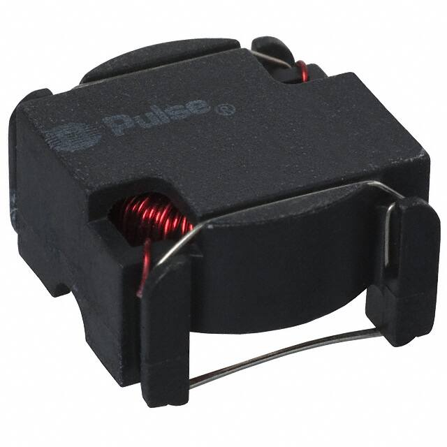

    固定电感器 Nonstandard 2.5µH 8A 8.3mΩ
PE-53661NLT 数据手册
SMT Power Inductors Toroid - SLIC Series Fifteen package sizes Current Rating: up to 23.8ADC Frequency Range: up to 1MHz Electrical Specifications @ 25°C - Operating Temperature -40°C to +130°C6 Pulse4,5 Part Number Inductance @ Irated (µH) Irated (A) DCR (mΩ) MAX Inductance @ 0ADC (µH) Reference ET (Volt -µsec) Flux Density Factor (K1) Core Loss Factor (K2) Temp. Rise Factor (K3) TYP PE-53630NL 1.01 3.40 9.35 11 1.1 0.53 5.43 3.29E-11 323.9 PE-53600NL 6.2 1.40 59.5 70 7 1.33 2.17 3.29E-11 323.9 PE-53601NL 17.6 1.00 106.25 125 22.7 2.4 1.21 3.29E-11 323.9 PE-53650NL 3.8 4.80 14.705 17.3 5.2 1.76 1.28 1.39E-10 148.0 PE-53631NL 9.4 2.80 36.89 43.4 12.3 2.7 0.83 1.39E-10 148.0 PE-53602NL 29.7 1.40 141.1 166 35.3 4.6 0.49 1.39E-10 148.0 PE-53606NL 114 0.94 365 405 167 10 0.23 1.39E-10 148.0 PE-53661NL 2.5 8.00 7.055 8.3 3.8 1.77 1.30 1.87E-10 114.2 PE-53651NL 5.1 5.40 15.045 17.7 7.5 2.51 0.92 1.87E-10 114.2 PE-53632NL 16.2 2.70 63 72 21.9 4.29 0.54 1.87E-10 114.2 PE-53604NL 58.1 1.30 246.5 290 73 7.83 0.29 1.87E-10 114.2 PE-53608NL 192 0.90 476 560 292 15.7 0.15 1.87E-10 114.2 PE-53611NL 383 0.72 732.7 862 672 23.5 0.10 1.87E-10 114.2 43.6 1.1 247.2 309 77 7.83 0.295 1.87E-10 114.23 PE-53662NL 4.9 7.80 10.54 12.4 7.9 3.04 0.67 3.35E-10 85.7 PE-53652NL 9 5.50 25 28 14 4.06 0.51 3.35E-10 85.7 PE-53633NL 29.1 2.70 85 100 40.5 6.9 0.30 3.35E-10 85.7 PE-53613NL 645 0.74 1062.5 1250 1134 36.5 0.06 3.35E-10 85.7 PE-53690NL 0.81 14.30 2.125 2.5 1.25 1.035 2.23 1.87E-10 114.2 PE-53680NL 1.32 11.50 3.4 4.0 2.1 1.33 1.74 1.87E-10 114.2 21.9 2.7 72.4 90.5 39.5 6.9 0.297 3.35E-10 85.71 LCI-20 LCI-30 LCI-37 LCCI-20 PE-53717NL LCI-44 HCI-37 LCCI-44 PE-53718NL 1 power.pulseelectronics.com SPM2007_44 (03/19) http://www.power.pulseelectronics.com/contact SMT Power Inductors Toroid - SLIC Series Electrical Specifications @ 25°C - Operating Temperature -40°C to +130°C6 Pulse4,5 Part Number Inductance @ Irated (µH) Irated (A) DCR (mΩ) MAX Inductance @ 0ADC (µH) Reference ET (Volt -µsec) Flux Density Factor (K1) Core Loss Factor (K2) Temp. Rise Factor (K3) TYP PE-53691*NL 1.68 13.90 3.06 3.6 2.8 1.83 1.12 3.35E-10 85.7 PE-53681NL 2.5 11.40 4.59 5.4 4.2 2.23 0.92 3.35E-10 85.7 PE-53663NL 9.3 7.20 15.895 18.7 16 4.92 0.41 4.52E-10 67.9 PE-53653NL 16.1 5.10 27.2 32.0 25.9 6.27 0.32 4.52E-10 67.9 PE-53634NL 50 2.60 113.05 133 72.9 10.5 0.19 4.52E-10 67.9 PE-53614NL 1070 0.71 1445 1700 1950 54.4 0.04 4.52E-10 67.9 4.025 6.4 18.4 23 6.575 3.135 0.638 4.52E-10 67.89 PE-53692*NL 3.5 12.40 5.61 6.6 6.5 3.1 0.64 4.52E-10 67.9 PE-53682NL 4.7 10.40 7.055 8.3 8.4 3.58 0.56 4.52E-10 67.9 0.53 23.8 1.0 3 0.88 1 2.020 3.35E-10 85.71 1.1 21 1.7 2.5 2.1 1.75 1.116 4.52E-10 67.89 PE-53700*NL 5.2 15.40 5.27 6.2 10.5 5.21 0.35 9.58E-10 44.6 PE-53683NL 9.4 10.90 10.455 12.3 17.6 6.84 0.27 9.58E-10 44.6 2.1 22.4 2.5 3.4 4 3.25 0.559 9.58E-10 4.56 HCI-44 LCI-50 LCCI-50 PE-53719NL** HCI-50 HCCI-44 PE-53361NL HCCI-50 PE-53362NL HCI-68 HCCI-68 PE-53363NL Notes: 1. 2. 3. Reference values are for an inductor with a 55°C temperature rise. The core loss is 10% of the copper loss at the ET listed and 500kHz. Core does not saturate abruptly. The ET and DC current are limited by the desired inductance and temperature rise. In high volt-time applications, additional heating in the component can occur due to core losses in the inductor which may necessitate derating the current in order to limit the temperature rise of the component. In order to determine the approximate total losses (or temperature rise) for a given application, both copper and core losses should be taken into account. 4. 5. 6. Optional Tape & Reel packaging can be ordered by adding a “T” suffix to the part number (i.e. P0595NL becomes PO595NLT). Pulse complies to industry standard tape and reel specification EIA481. The “NL” suffix indicates an RoHS-compliant part number. Non-NL suffixed parts are not necessarily RoHS compliant, but are electrically and mechanically equivalent to NL versions. If a part number does not have the “NL” suffix, but an RoHS compliant version is required, please contact Pulse for availability. The temperature of the component (ambient plus temperature rise) must be within the stated operating temperature range. ** Contact Pulse for availability Estimated Temperature Rise: Trise = K3 * (Coreloss (W) + Copperloss (W)).833 (C) CopperLoss = Irms2 * DCR_Typical (mΩ) / 1000 CopperLoss = K2 * (Freq_kHz)1.26 * (ΔB)2.11 ΔB = K1 * Volt-µsec * 100 2 power.pulseelectronics.com SPM2007_44 (03/19) http://www.power.pulseelectronics.com/contact SMT Power Inductors Toroid - SLIC Series Mechanical High Current Inductors (HCI) PKG A B C D E F HCI-37 .620 15,75 .605 15,37 .370 9,40 .500 12,70 .440 11,18 .500 12,70 HCI-44 .670 17,02 .670 17,02 .390* 9,91 .560 14,22 .490 12,45 .570 14,48 HCI-50 .740 18,80 .740 18,80 .390* 9,91 .630 16,00 .560 14,22 .640 16,26 HCI-68 .940 23,88 .940 23,88 .390* 9,91 .820 20,83 .700 17,78 .830 21,08 PKG A B C D E F LCI-20 .340 8,64 .340 8,64 .270 6,86 .260 6,60 .300 7,62 .270 6,86 LCI-30 .435 11,05 .440 11,18 .360 9,14 .350 8,89 .400 10,16 .360 9,14 LCI-37 .565 14,35 .570 14,48 .360 9,14 .450 11,43 .520 13,21 .460 11,68 LCI-44 .600 15,24 .620 15,75 .390 9,91 .500 12,70 .550 13,97 .500 12,70 LCI-50 .670 17,02 .700 17,78 .390 9,91 .580 14,73 .620 15,75 .590 14,99 * Dimension “C” is .400/10,16 for the marked models because of heavier wire gage. Mechanical Low Current Inductors (LCCI) 3 power.pulseelectronics.com SPM2007_44 (03/19) http://www.power.pulseelectronics.com/contact SMT Power Inductors Toroid - SLIC Series Mechanicals (continued) High Current Coupled Inductors (HCCI) Low Current Coupled Inductors (LCCI) Schematic Schematic 1 4 1 4 3 2 1:1 ±1% 3 2 Size Codes For More Information Pulse Worldwide Headquarters 15255 Innovation Drive Ste 100 San Diego, CA 92128 U.S.A. Tel: 858 674 8100 Fax: 858 674 8262 HCCI-44 HCCI-50 HCCI-68 LCCI-37 LCCI-44 LCCI-50 A .715/18,16 .800/20,32 1.000/25,40 .560/14,22 .590/14,99 .670/17,02 B .865/21,97 .910/23,11 1.110/28,19 .645/16,38 .715/18,16 .770/19,56 C .390/9,91 .390/9,91 .390/9,91 .350/8,89 .390/9,91 .390/9,91 D .760/10,30 .800/20,32 1.000/25,40 .520/13,21 .600/15,24 .650/16,51 E .360/9,14 .440/11,18 .620/15,75 .340/8,64 .370/9,40 .445/11,30 F .770/19,56 .810/20,57 1.010/13,46 .530/13,46 .610/15,49 .660/16,76 Pulse Europe Pulse Electronics GmbH Am Rottland 12 58540 Meinerzhagen Germany Pulse China Headquarters Pulse Electronics (ShenZhen) CO., LTD D708, Shenzhen Academy of Aerospace Technology, The 10th Keji South Road, Nanshan District, Shenzhen, P.R. China 518057 Pulse North China Room 2704/2705 Super Ocean Finance Ctr. 2067 Yan An Road West Shanghai 200336 China Pulse South Asia 3 Fraser Street 0428 DUO Tower Singapore 189352 Pulse North Asia 1F., No.111 Xiyuan Road Zhongli District Taoyuan City 32057 Taiwan (R.O.C) Tel: 49 2354 777 100 Fax: 49 2354 777 168 Tel: 86 755 33966678 Fax: 86 755 33966700 Tel: 86 21 62787060 Fax: 86 2162786973 Tel: 65 6287 8998 Fax: 65 6280 0080 Tel: 886 3 4356768 Fax: 886 3 4356820 Performance warranty of products offered on this data sheet is limited to the parameters specified. Data is subject to change without notice. Other brand and product names mentioned herein may be trademarks or registered trademarks of their respective owners. © Copyright, 2019. Pulse Electronics, Inc. All rights reserved. 4 power.pulseelectronics.com SPM2007_44 (03/19) http://www.power.pulseelectronics.com/contact
