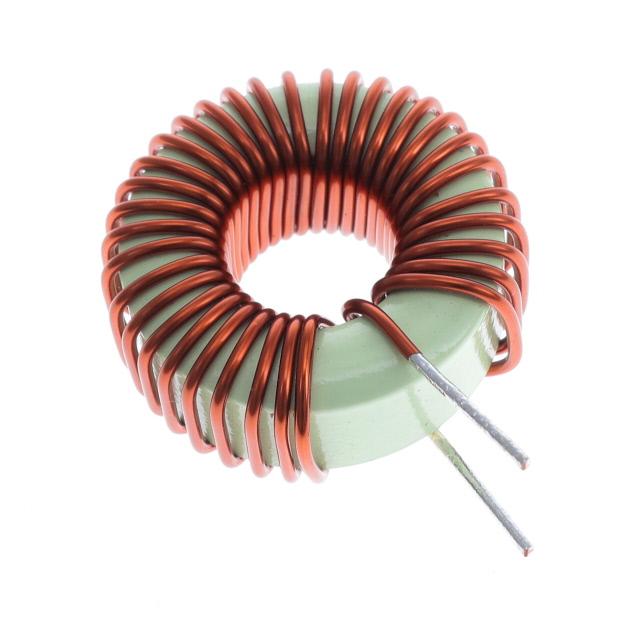

    100 µH 无屏蔽 环形 电感器 5 A 34 毫欧最大 径向,垂直(开放式)
PE-92112NL 数据手册
THT Power Inductors Toroid - Vertical, Low Profile and Klipmount™ Available in vertical, low profile and Klipmount™ SMPS averaging filter Characterized for general purpose use and ripple filters Single-layer designs Can be used as differential mode inductors in EMI filters3 Electrical Specifications @ 25°C - O perating Temperature -40°C to 130°C Design Control Values Reference Operating Values Vertical 6 Part Number Inductance 1 Typical (µH) IDC (AMPS) ETOP (V-µSec) Energy4 Storage (µJ) Inductance No DC (µH) (±20%) 20 kHz Test mV No DC DCR 5 (Ω MAX) Coil Size Code PE-51591NL 20 2.0 52 40 32.8 33 .060 H PE-92100NL 25 2.6 30 85 20.7 22 .043 A KM1 .020 Low Profile Part Number Klip* Mount Package Lead Diameter (in ± .003) .020 PE-92101NL PE-92401NL 50 2.6 50 169 45.7 45 .071 B KM2 .020 PE-92102NL PE-92402NL 100 2.6 90 338 94.1 90 .100 C KM3 .020 PE-92103NL 35 2.6 55 118 28.4 36 .037 B KM2 .025 PE-92104NL PE-92404NL 70 3.0 85 315 61.0 73 .052 C KM3 .025 PE-92105NL 145 3.0 140 653 141.8 140 .087 D KM4 .025 PE-92106NL 285 3.0 300 1283 264.1 340 .140 E KM5 .025 PE-92107NL 450 3.0 425 2025 436.3 500 .200 F PE-92108NL PE-92408NL 67 3.6 130 648 90.7 110 .045 D KM4 .032 PE-92109NL 165 4.0 240 1320 152.0 260 .070 E KM5 .032 PE-92110NL 270 4.0 350 2160 263.9 400 .100 F PE-92111NL 40 4.0 70 320 37.9 57 .027 C PE-51590NL 22 5.0 44 275 20.3 37 .020 G 100 5.0 200 1250 90.7 180 .034 E 170 5.0 300 2125 159.7 310 .050 F 35.6 5.0 100 688 55.6 88 .023 D 95 7.0 225 2328 96.0 200 .025 F 55 7.0 150 1348 49.1 100 .017 E 55 10.0 175 2750 55.9 120 .013 F PE-92112NL PE-92405NL PE-92412NL PE-92113NL PE-92114NL PE-92414NL PE-92115NL PE-92116NL PE-92416NL PE-92117NL .025 .032 KM3 .032 .032 KM5 .042 .042 KM4 .042 .051 KM5 .051 .064 * Parts available with KlipMount option can be ordered by adding a “K” suffix to the part number (i.e. PE-92100K). 1 pulseelectronics.com P635.B (02/15) THT Power Inductors Toroid - Vertical, Low Profile and Klipmount™ Relationships Between Reference and Operating Conditions Inductance vs. Operating ET Max. Operating ET vs. Frequency 1.75 Temp. Rise >40°C 1.50 1.25 1.00 .75 .50 .25 0 .25 .50 .75 1.00 1.25 1.50 (at reference IDC) 2.00 1.75 Temp. Rise >40°C 1.50 1.25 1.00 .75 .50 .25 0 OPERATING DC CURRENT REFERENCE IDC .25 .50 .75 1.00 1.25 1.50 OPERATING ET FOR 40°C TEMP. RISE REFERENCE ET 2.00 INDUCTANCE AT OPERATING ET INDUCTANCE AT REFERENCE ET INDUCTANCE AT OPERATING IDC REFERENCE IDC (at reference IDC) 2.00 1.75 1.50 1.25 1.00 .75 .50 .25 0 OPERATING ET REFERENCE ET 20 30 40 50 60 70 80 90 100 OPERATING FREQUENCY — kHz Mechanical Schematic Klipmount™ Package • Base material meets flammability requirements of UL 94V-0 • Mechanically rigid mount • PC Board - automatic insertability • Lowest cost Standard Package A B Maximum C 1 C D H EV) Typical KM-1 .340 8,64 .580 14,73 .650 16,51 .29 7,37 .110 2,79 KM-2 .450 11,43 .650 16,51 .700 17,78 .325 8,26 .150 3,81 KM-3 .450 11,43 .850 21,59 .950 24,13 .415 10,54 .150 3,81 KM-4 .620 15,50 .970 24,64 1.10 27,94 .475 12,07 .225 5,72 KM-5 .700 17,78 1.30 33,02 1.40 35,56 .625 15,88 .250 6,35 2 .130 ± .020 3,30 ,508 D B E 2E A Note: Units with large wire sizes may exceed B dimension. KLIPMOUNT™ is a trademark of Pulse Engineering, Inc. Dimensions: Inches Unless otherwise specified, all tolerances are ± .010 mm 0,25 2 pulseelectronics.com P635.B (02/15) THT Power Inductors Toroid - Vertical, Low Profile and Klipmount™ Mechanicals (continued) Vertical and Low Profile Package Vertical Package Size Code P (MAX) N (MAX) L (+.125/-.025) M K A .550 13,97 .250 6,35 .375 9,53 .180 4,57 B .700 17,78 .380 9,65 .375 9,53 .280 7,11 .530 ± .050 13,46 1,27 C .850 21,59 .410 10,41 .375 9,53 .280 7,11 .720 ± .050 18,29 1,27 D 1.050 26,67 .550 13,97 .375 9,53 .400 10,16 .840 ± .020 21,24 0,51 E 1.400 35,56 .700 17,78 .375 9,53 .500 12,7 1.100 ± .100 27,94 2,54 F 1.650 41,91 .700 17,78 .375 9,53 .500 12,7 G .850 21,59 .330 8,38 .330 8,38 .330 8,38 H .650 16,26 .280 7,11 .280 7,11 .280 7,11 P Notes: 1. Typical Inductance occures at I DC and ETOP values shown. 2. Design control test voltage is critical. Inductance increases with voltage. 3. For line filter applications, RMS line current is limited to specified reference DC current. 4. LI 2 rating is the ability of the inductor to store energy. 2 L M Low Profile Package N PE-924XX .375 ± .125 9,58 3,18 P K 5. DCR for vertical part measured close to coil. Add 10% more for low profile part. For More Information Pulse Worldwide Headquarters 12220 World Trade Drive San Diego, CA 92128 U.S.A. Pulse Europe Einsteinstrasse 1 D-71083 Herrenberg Germany Pulse China Headquarters Pulse North China Pulse South Asia Pulse North Asia B402, Shenzhen Academy of Room 2704/2705 135 Joo Seng Road 3F, No. 198 Aerospace TechnolSuper Ocean Finance #03-02 Zhongyuan Road ogy Bldg. Ctr. PM Industrial Bldg. Zhongli City 10th Kejinan Road 2067 Yan An Road Singapore 368363 Taoyuan County 320 High-Tech Zone West Taiwan R. O. C. Nanshan District Shanghai 200336 Tel: 886 3 4356768 Shenzen, PR China China Tel: 65 6287 8998 Fax: 886 3 4356823 (Pulse) Tel: 858 674 8100 Tel: 49 7032 78060 518057 Fax: 65 6287 8998 Fax: 886 3 4356820 (FRE) Fax: 858 674 8262 Fax: 49 7032 7806 135 Tel: 86 755 33966678 Tel: 86 21 62787060 Fax: 86 755 33966700 Fax: 86 2162786973 Performance warranty of products offered on this data sheet is limited to the parameters specified. Data is subject to change without notice. Other brand and product names mentioned herein may be trademarks or registered trademarks of their respective owners. © Copyright, 2015. Pulse Electronics, Inc. All rights reserved. 3 pulseelectronics.com P635.B (02/15)
