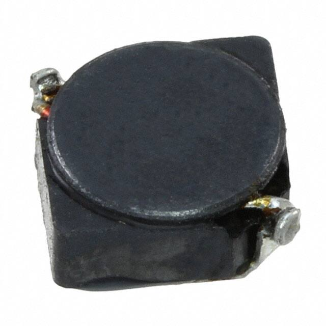

    固定电感器 Nonstandard 27µH ±20% 1.05A 132mΩ 19MHz
PF0464.273NL 数据手册
SMT Power Inductors Shielded Drum Core - PF0464NL/PF0465NL Series Height: PF0464: 3mm Max - PF0465: 4mm Max Footprint: 7.2mm x 7.2mm Max Current Rating: PF0464: up to 4.5A - PF0465: up to 3.5A Inductance Range: 1.5µH to 100µH Electrical Specifications @ 25°C - Operating Temperature -40°C to +125°C1,6 DCR (mΩ) Inductance @0ADC (µH ±20%) Inductance @ Irated (µH TYP) MAX Saturation6 Current ISAT -20% (A) Heating7 Current IDC +40°C (A) Core Loss8 Factor (K2) Irated (A) TYP SFR (MHz) PF0464.152NL 1.5 1.2 4.50 9 12 4.50 5.50 660 >40 PF0464.302NL 3.0 2.4 3.00 17 22 3.00 4.25 850 >40 PF0464.392NL * 3.9 3.1 2.60 19 25 2.60 3.80 990 >40 PF0464.502NL 5.0 4.0 2.40 24 30 2.40 3.55 1100 >40 PF0464.602NL 6.0 4.8 2.25 26 33 2.25 3.20 1300 >40 PF0464.732NL 7.3 5.8 2.10 36 45 2.10 3.10 1400 >40 PF0464.862NL * 8.6 6.9 1.85 38 48 1.85 2.95 1500 35 PF0464.103NL 10 8.0 1.70 41 52 1.70 2.90 1700 32 PF0464.123NL * 12 9.6 1.55 52 66 1.55 2.40 1800 26 PF0464.153NL 15 12.0 1.40 55 75 1.40 2.35 2000 24 PF0464.183NL 18 14.4 1.32 69 90 1.32 2.10 2200 22 PF0464.223NL 22 17.6 1.20 85 113 1.20 1.85 2500 21 PF0464.273NL * 27 21.6 1.05 104 132 1.05 1.70 2800 19 PF0464.333NL * 33 26.4 0.97 132 165 0.97 1.50 3000 18 PF0464.393NL * 39 31.2 0.86 142 180 0.86 1.45 3300 14 PF0464.473NL * 47 37.6 0.80 197 238 0.80 1.25 3600 14 PF0464.563NL * 56 44.8 0.73 216 270 0.73 1.15 3900 13 PF0464.683NL 68 54.4 0.65 235 300 0.65 1.10 4400 12 PF0464.823NL * 82 65.6 0.60 291 370 0.60 1.00 4800 11 PF0464.104NL * 100 80.0 0.54 401 505 0.54 0.85 5300 10.5 Part Number PF0464NL Series 2,3 5 Notes: 1. Inductance is measure, where applicable, with both primary windings connected in series (2 to 5, with 3 and 4 shorted). 2. Leakage inductance is measured with both primary windings connected in series (where applicable) with all other windings shorted. *Contact Pulse for availability 1 power.pulseelectronics.com SPM2007_21 (05/19) http://www.power.pulseelectronics.com/contact SMT Power Inductors Shielded Drum Core - PF0464NL/PF0465NL Series Electrical Specifications @ 25°C - Operating Temperature -40°C to +125°C1,6 DCR (mΩ) Inductance @0ADC (µH ±20%) Inductance @ Irated (µH TYP) MAX Saturation6 Current ISAT -20% (A) Heating7 Current IDC +40°C (A) Core Loss8 Factor (K2) Irated (A) TYP SFR (MHz) PF0465.332NL 3.3 2.6 3.50 16 20 3.50 4.65 790 >40 PF0465.502NL 5.0 4.0 2.90 19 24 2.90 4.10 970 >40 PF0465.622NL 6.2 5.0 2.50 21 26 2.50 3.90 1100 >40 PF0465.732NL 7.3 5.8 2.30 25 31 2.30 3.50 1200 >40 PF0465.862NL * 8.6 6.9 2.20 27 34 2.20 3.30 1300 35 PF0465.103NL 10 8.0 2.00 29 37 2.00 3.20 1400 32 PF0465.123NL 12 9.6 1.70 39 50 1.70 2.80 1600 26 PF0465.153NL 15 12.0 1.60 44 55 1.60 2.60 1700 24 PF0465.183NL * 18 14.4 1.50 62 78 1.50 2.25 1900 22 PF0465.223NL 22 17.6 1.30 68 86 1.30 2.10 2100 21 PF0465.273NL 27 21.6 1.20 75 95 1.20 2.00 2300 19 PF0465.333NL * 33 26.4 1.10 94 118 1.10 1.75 2500 18 PF0465.393NL 39 31.2 1.00 101 128 1.00 1.70 2800 17 PF0465.473NL 47 37.6 0.95 112 140 0.95 1.60 3000 14 PF0465.563NL * 56 44.8 0.85 154 195 0.85 1.35 3300 13 PF0465.683NL 68 54.4 0.75 188 234 0.75 1.25 3700 12 PF0465.823NL * 82 65.6 0.70 261 324 0.70 1.05 4000 11 PF0465.104NL 100 80.0 0.65 286 350 0.65 1.00 4500 10.5 Part Number PF0465NL Series 2,3 2 5 power.pulseelectronics.com SPM2007_21 (05/19) http://www.power.pulseelectronics.com/contact SMT Power Inductors Shielded Drum Core - PF0464NL/PF0465NL Series Mechanicals Schematic PF046X.XXXNL XXXNL PF0464 PF0465 Weight: ................................0.5 grams ................................0.7 grams Tape & Reel ...........................1200/reel ..................................900/reel “A” (height - in./mm) ......0.118/3.00 ................................0.158/4.00 PF0464 PF0465 “B” height: - (in./mm) ........0.5 grams ...............0.7 grams Notes: 1. Unless otherwise specified, all testing is made at 100kHz, 0.1VAC. 2. Optional Tape & Reel packaging can be ordered by adding a “T” suffix to the part number (i.e P1166.102NL becomes P1166.102NLT). Pulse complies with industry standard Tape and Tape & Reel specification EIA481. 3. The “NL” suffix indicates an RoHS-compliant part numer. Non-NL suffixed parts are not necessarily RoHS compliant, but are electrically and mechanically equivalent to NL versions. If a part number does not have the “NL” version, but an RoHS compliant version is required, please contact Pulse for availability. 4. Temperature of the component (ambient plus temperature rise) must be within specified operating temperature range. 5. The rated current (Irated) as listed is either the saturation current or the heating current depending on which value is lower. 6. The saturation current, Isat, is the current at which the component inductance drops by the indicated percentage (typical) at an ambient temperature of 25C. This current is determined by placing the component in the specified ambient environment and applying a short duration pulse current (to eliminate self-heating effects) to the component. 7. The heating current, Idc, is the DC current required to raise the component temperature by the indicated delta (approximately). The heating current isdetermined by mounting the component on a typical PCB and applying current for 30 minutes. The temperature is measured by placing the thermocouple on top of the unit under test. 3 power.pulseelectronics.com 8. Dimensions: .Inches mm Unless otherwise specified, .010 all tolerances are: ±.0,25 In high volt*time (Et) or ripple current applications, additional heating in the component can occur due to core losses in the inductor which may necessitate derating the current in order to limit the temperature rise of the component. In order to determine the approximate total loss (or temperature rise) for a given application, both copper losses and core losses should be taken into account. Estimated Temperature Rise: Trise = [Total loss (mW) / K0].833(°C) Total Loss = Copper loss + Core loss (mW) Copper loss = IRMS2 x DCR (Typical) (mW) Irms = [IDC2 + ΔI2 /12]1/2 (A) Core loss = K1 x f (kHz)1.23 x Bac (Ga)2.38 (mW) Bac (peak to peak flux density) = K2 x ΔI (Ga) [= K2/L (µH) x Et (V-µSec) (Ga)] where f varies between 25kHz and 1MHz, and Bac is less than 2500 Gauss. K2 is a core size and winding dependent value and is given for each p/n in the proceeding datasheets. K0 & K1 are platform and material dependant constants and are given in the table below for each platform. SPM2007_21 (05/19) http://www.power.pulseelectronics.com/contact SMT Power Inductors Shielded Drum Core - PF0464NL/PF0465NL Series Part No. Trise Factor (KO) Core Loss Factor (K1) PG0085/86 2.3 5.29E-10 PG0087 5.8 15.2E-10 PG0040/41 0.8 2.80E-10 P1174 0.8 6.47E-10 PF0601 4.6 14.0E-10 PF0464 3.6 24.7E-10 PF0465 3.6 33.4E-10 P1166 1.9 29.6E-10 P1167 2.1 42.2E-10 PF0560NL 5.5 136E-10 P1168/69 4.8 184E-10 P1170/71 4.3 201E-10 P1172/73 5.6 411E-10 PF0552NL 8.3 201E-10 PF0553NL 7.1 411E-10 Take note that the component’s temperature rise varies depending on the system condition. It is suggested that the component be tested at the system level, to verify the temperature rise of the component during system operation. For More Information Pulse Worldwide Headquarters 15255 Innovation Drive Ste 100 San Diego, CA 92128 U.S.A. Tel: 858 674 8100 Fax: 858 674 8262 Pulse Europe Pulse Electronics GmbH Am Rottland 12 58540 Meinerzhagen Germany Pulse China Headquarters Pulse Electronics (ShenZhen) CO., LTD D708, Shenzhen Academy of Aerospace Technology, The 10th Keji South Road, Nanshan District, Shenzhen, P.R. China 518057 Pulse North China Room 2704/2705 Super Ocean Finance Ctr. 2067 Yan An Road West Shanghai 200336 China Pulse South Asia 3 Fraser Street 0428 DUO Tower Singapore 189352 Pulse North Asia 1F., No.111 Xiyuan Road Zhongli District Taoyuan City 32057 Taiwan (R.O.C) Tel: 49 2354 777 100 Fax: 49 2354 777 168 Tel: 86 755 33966678 Fax: 86 755 33966700 Tel: 86 21 62787060 Fax: 86 2162786973 Tel: 65 6287 8998 Fax: 65 6280 0080 Tel: 886 3 4356768 Fax: 886 3 4356820 Performance warranty of products offered on this data sheet is limited to the parameters specified. Data is subject to change without notice. Other brand and product names mentioned herein may be trademarks or registered trademarks of their respective owners. © Copyright, 2019. Pulse Electronics, Inc. All rights reserved. 4 power.pulseelectronics.com SPM2007_21 (05/19) http://www.power.pulseelectronics.com/contact
